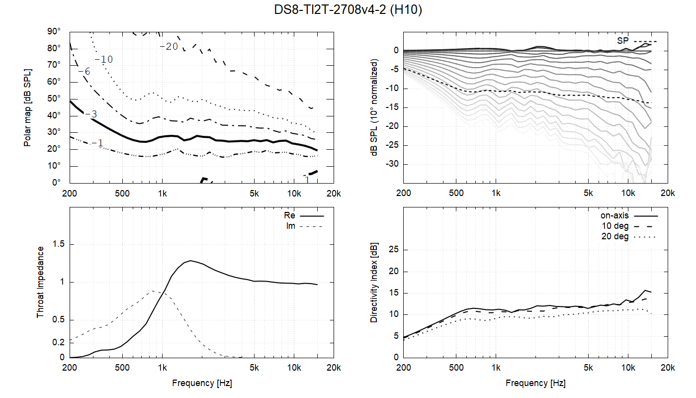

Could be post the config file or explain what to change to set a central conical section?Yes, you can do it with ATH. I haven't tried to optimize any but from the attempts I made it was pretty clear that it's simply worse.

You can ignore/omit SC. The H and V sections in Horn.Part are all OSSE sections (automatically connected together), so r0 and a0 have no use in this context (i.e. when k = 0) and can be left out. If k > 0 then both would have their meaning of course.
This makes a flat wall at the defined angle:
k = 0
s = 0
a = 40 ; wall angle [deg]
k = 0
s = 0

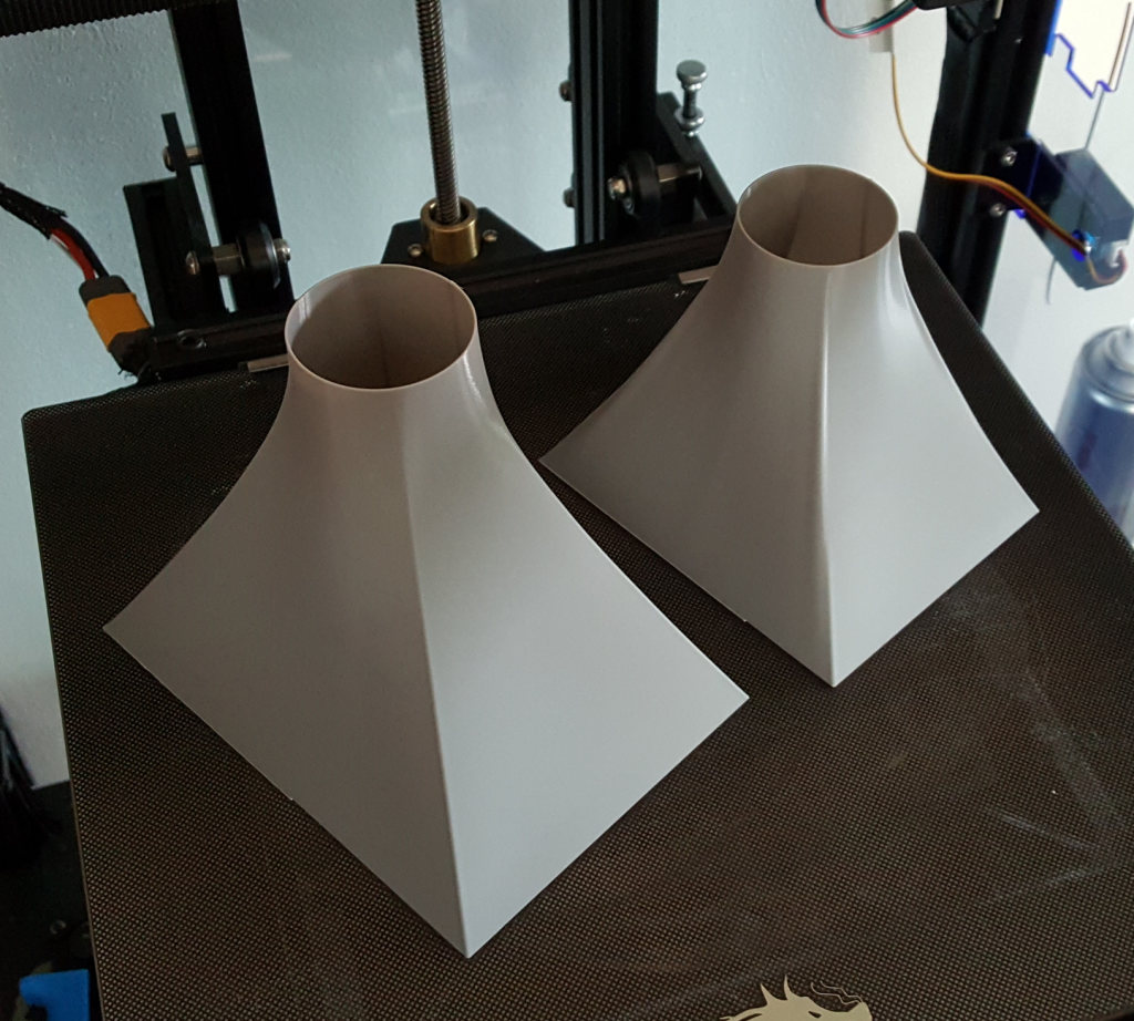

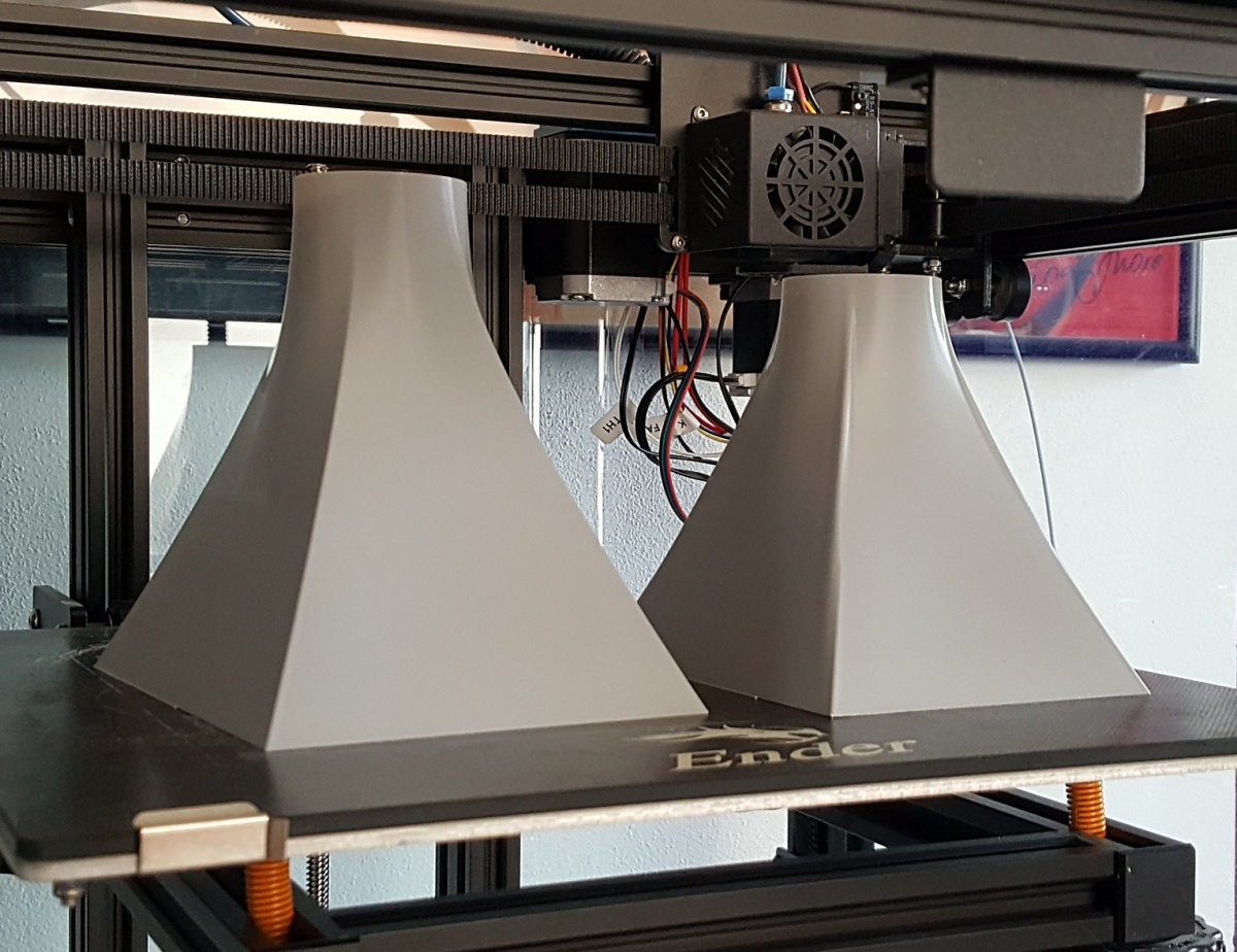

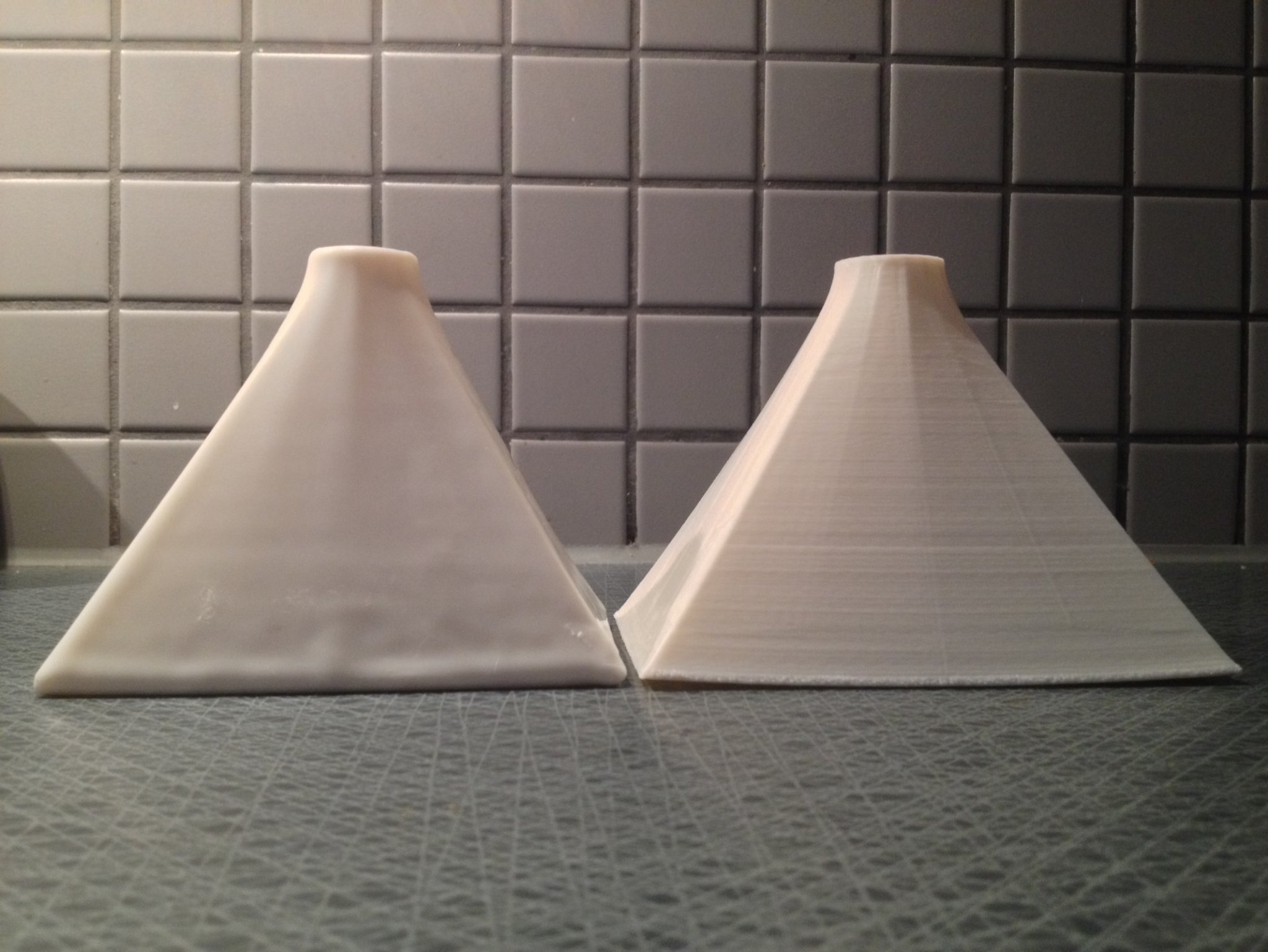

I’m not claiming that ours are the same but there’s definitely similarities.No, it's a regular print. It's just an OS-based shape, there's really no reason to use anything else I think. The continuously decreasing curvature being an advantage, it's almost zero at the exit.

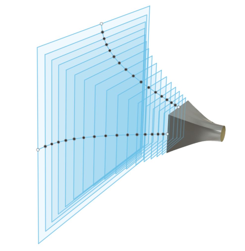

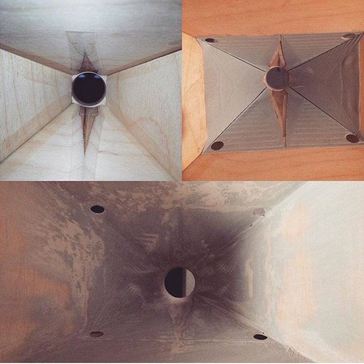

I made a approximation of the quadratic-throat waveguide in my synergy horn. (https://peaveycommercialaudio.com/w...atic-Throat-Waveguide-by-Charles-E-Hughes.pdf)
The opening angle starts at the mounting plate for the BMS 4550 and some wood was taken away by cnc and I printed thin plates in ABS where material was added.
Yea, I think this was mentioned already. It's similar in the same way as quadratic throat is similar to OS. QT is an approximation (simpler and less smooth). How much is it different acoustically would need to be tested. Since the QT discontinuity is still quite close to the throat (and spatially distributed in this case), I believe it doesn't necessarily mean much.
At this level, the driver's exit <> throat 'interface' is potentially more disturbing.
True, Olson made similar comments in the 1950s.
