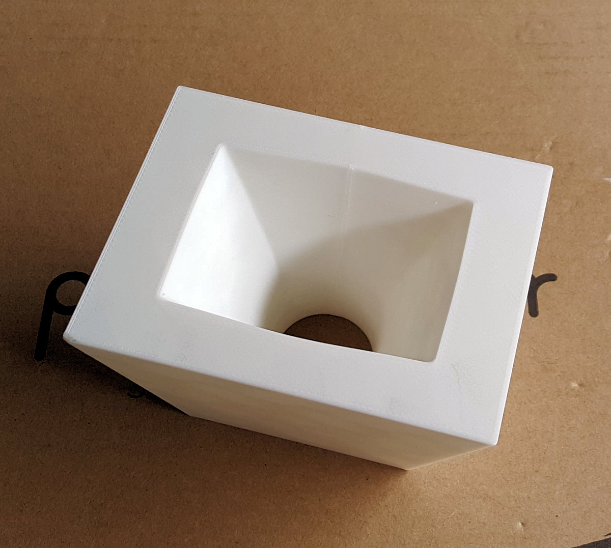

No, it's a regular print. It's just an OS-based shape, there's really no reason to use anything else I think. The continuously decreasing curvature being an advantage, it's almost zero at the exit.
That print quality is unreal. What size nozzle and filament?
The trick is in bad photo quality
- That was an easy (one-perimeter) print, 0.6 mm nozzle, 0.25 (0.2?) mm layer height. Standard PLA stuff.

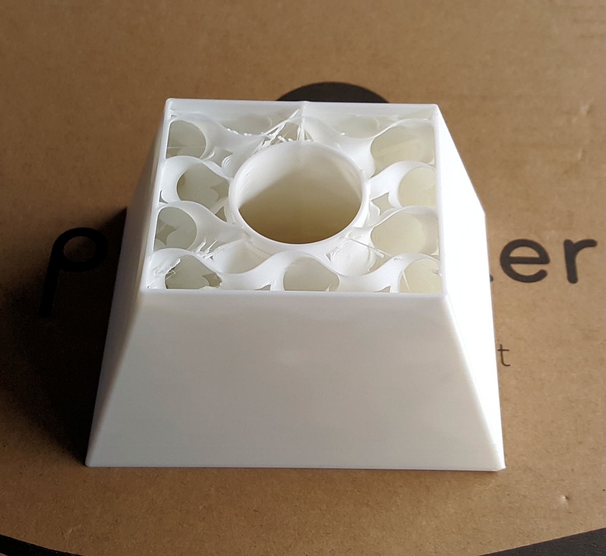

How do you plan to connect the print to the board? Add a lip on the print to help?
Yea, I should have explained it better. There's a seam (so not a vase mode) but it's one perimeter.So it was one perimeter print, but not vase mode?
- This was the fastest and easiest way to see&touch the actual shape in its scale. It's not the final form of course - that will have a mouting lip, etc.
As it is it could be already used as a mold basis I guess.
It's the "gyroid" infill (maybe 5%?) in Prusa slicer, PLA. Yeah, it's easy to fill.
Re filling - https://www.diyaudio.com/community/...-design-the-easy-way-ath4.338806/post-7063674
You can use anything that gets not too hot during curing... otherwise about anything will work I guess.
