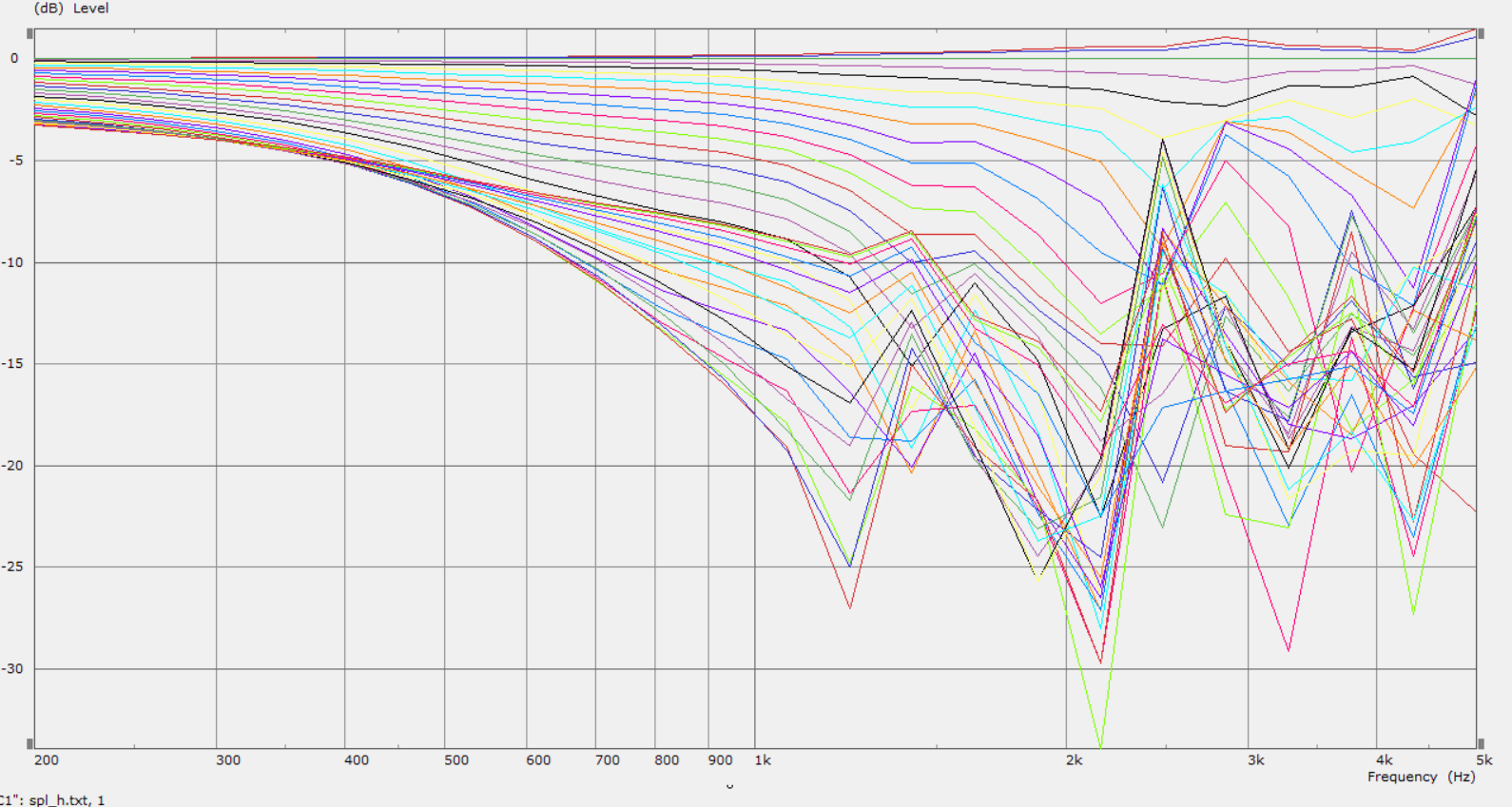

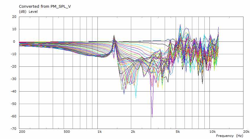

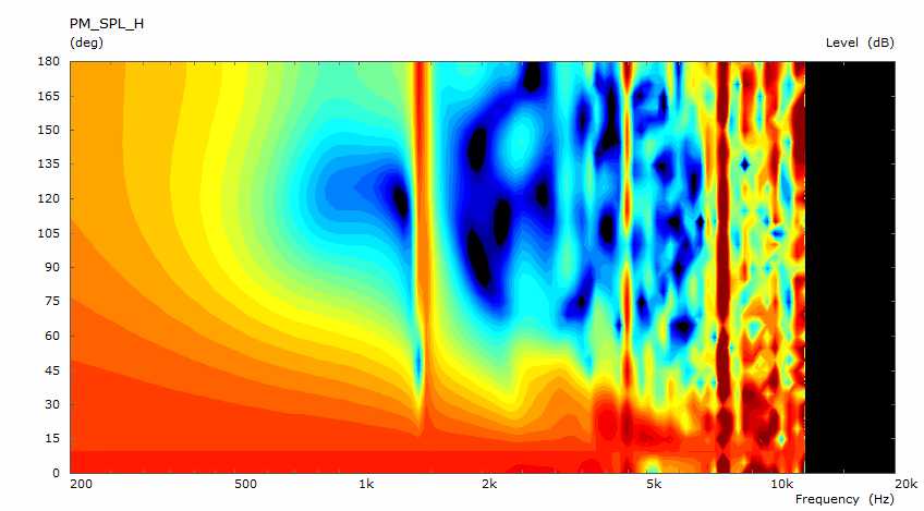

Very powerful tool indeed. Lets see if my laptop can eat the ABEC project over night, looks expensive to compute. Funky lookin device, could plow snow on the driveway with it 😀

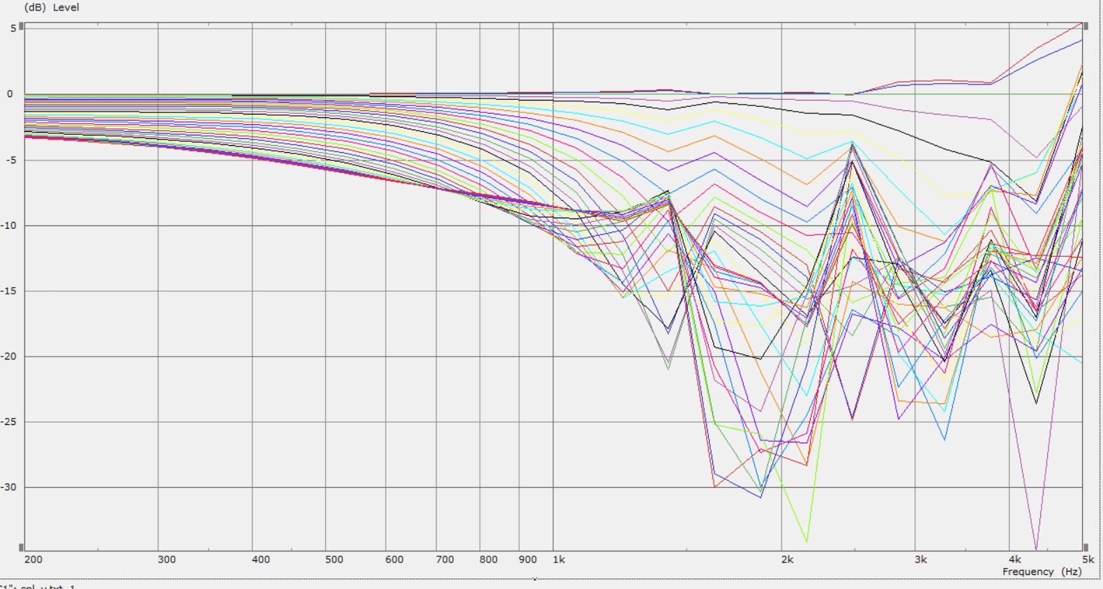

it took only10 minutes on my 12 core Ryzen and the results are not pretty. Trying again at higher resolution...Very powerful tool indeed. Lets see if my laptop can eat the ABEC project over night, looks expensive to compute. Funky lookin device, could plow snow on the driveway with it 😀
The provided model is kept within reasonable limits, it's still only 400 x 345 mm, under 4500 BEM elements.Lets see if my laptop can eat the ABEC project over night, looks expensive to compute.
- It may also not solve correctly simply due to some model issues. It's already quite a weird geometry that may require some adjustments. Unfortunately it's not always so simple.

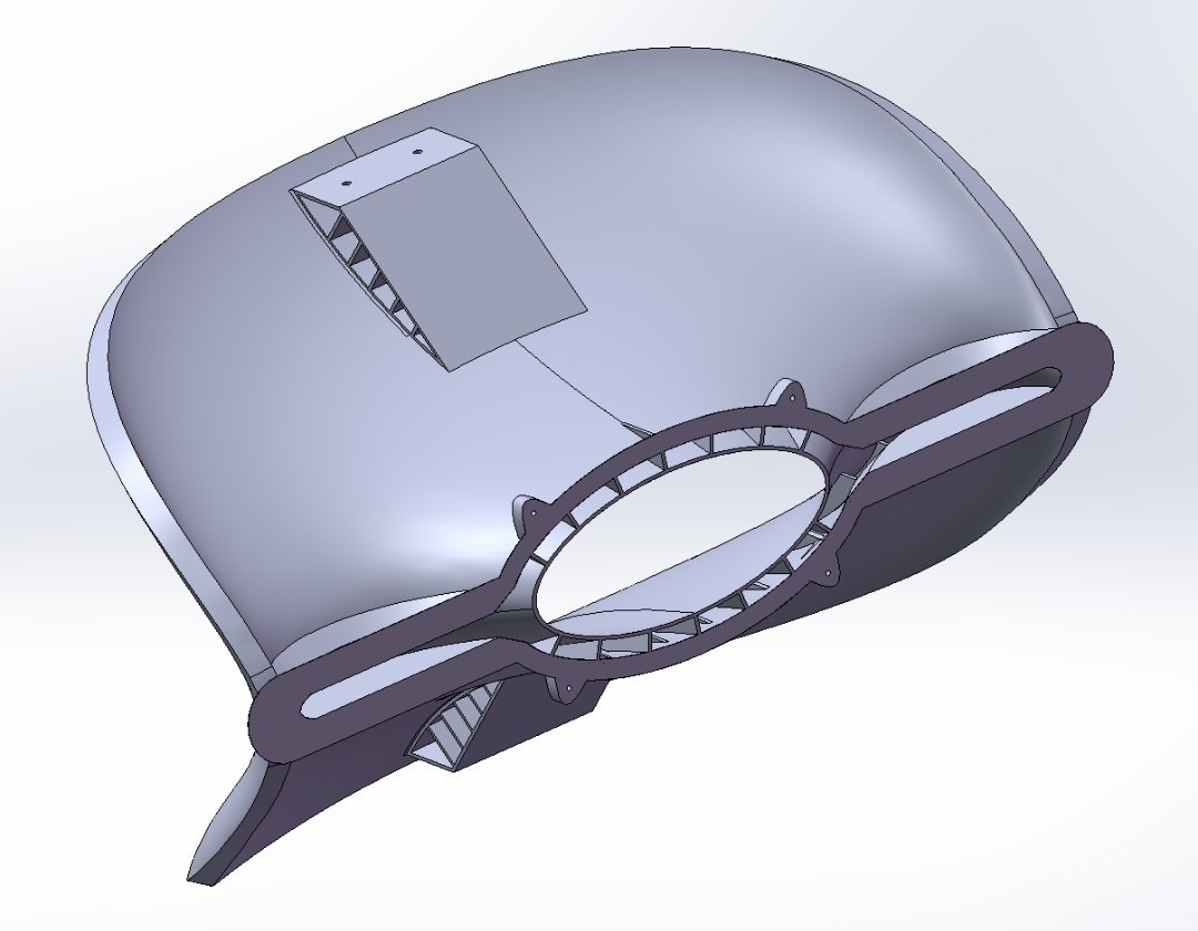

People think printing large horn (here Iwata 300) is easy. It is not - lot of hours to make it printable fast and inject concrete inside. I hope Jan Herich and his Chisel slicer will help use achieve light and stiff waveguides/horns/enclosures.
I'm actually extremely happy with the latest fillable quarter petal construction: https://www.diyaudio.com/community/...-design-the-easy-way-ath4.338806/post-7063036
It's still some manual work (it's a DIY after all) but I would even call it easy.
I've tried print the Iwata 300 throat plus 4 petals. Nightmare to glue, sand, smooth. 300Hz horns rings like bell. Small waveguides you make are different shape.
Anyway, good helper locks are essential for a smooth and easy assembly. With the petal side locks (https://www.diyaudio.com/community/...-design-the-easy-way-ath4.338806/post-7063067) together with the base jig (https://www.diyaudio.com/community/...-design-the-easy-way-ath4.338806/post-7022703) it's really a no-brainer now. Well, at least that is my experience. Of course it took me some time to get there, having a very little experience with 3D printing initially.
