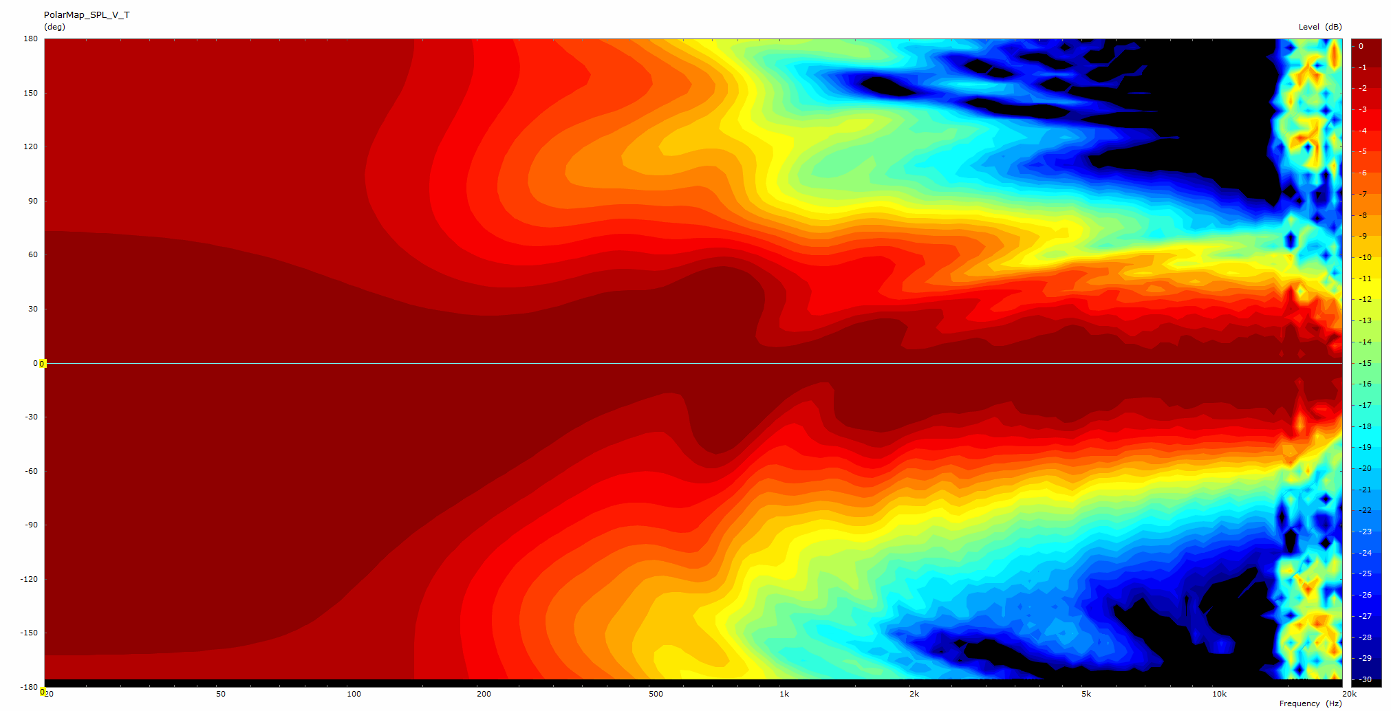

What is wrong here? I still get
error: polar map 'SPL_H_T' not found in the results
ABEC.Polars:SPL_H_W = {
MapAngleRange = -180,180,72
Distance = 2.0
NormAngle = 0
Offset = 66
FRDExport = {
NamePrefix = hor woofer
PhaseComp = -2.0 ;[m]
ABEC.Polars:SPL_V_W = {
Distance = 2.0
NormAngle = 0
Inclination = 90
Offset = 66
FRDExport = {
NamePrefix = ver woofer
ABEC.Polars:SPL_H_T = {
Distance = 2.0
NormAngle = 0
Offset = 66
FRDExport = {
NamePrefix = hor tweeter
ABEC.Polars:SPL_V_T = {
Distance = 2.0
NormAngle = 0
Inclination = 90
Offset = 66
FRDExport = {
NamePrefix = ver tweeter

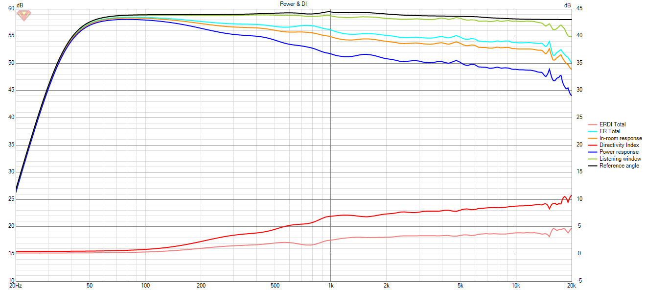

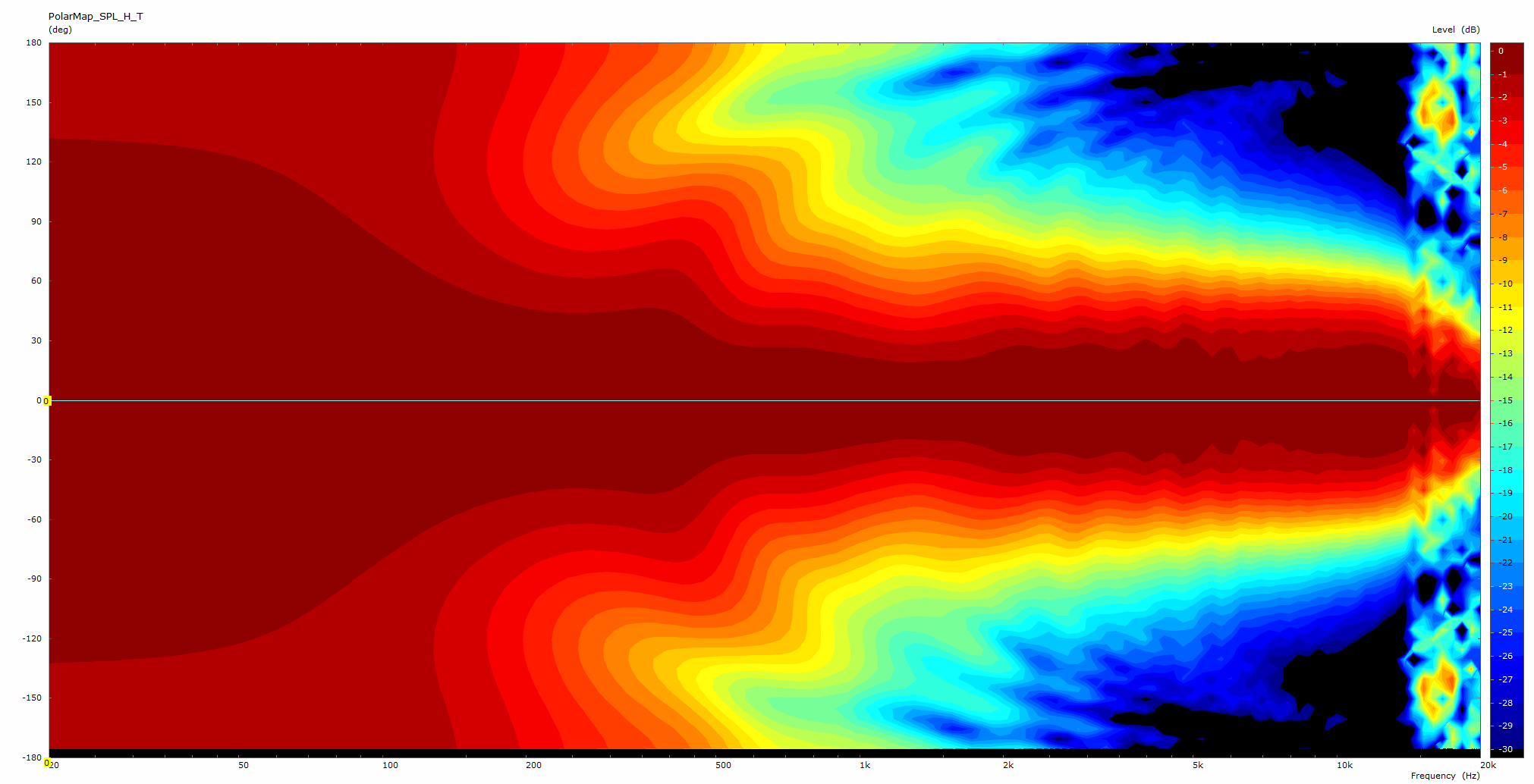

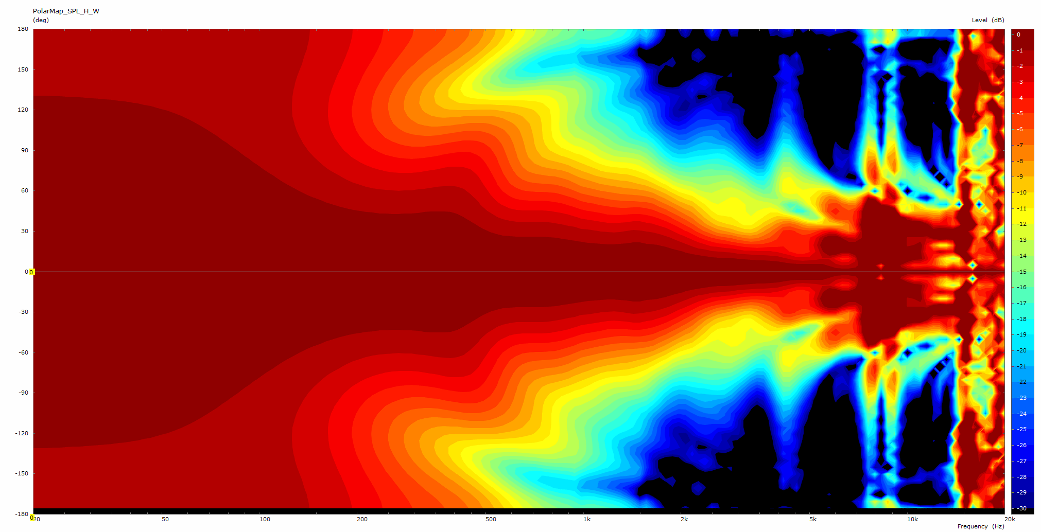

Took me a while to generate clean export. And some things have well changed:

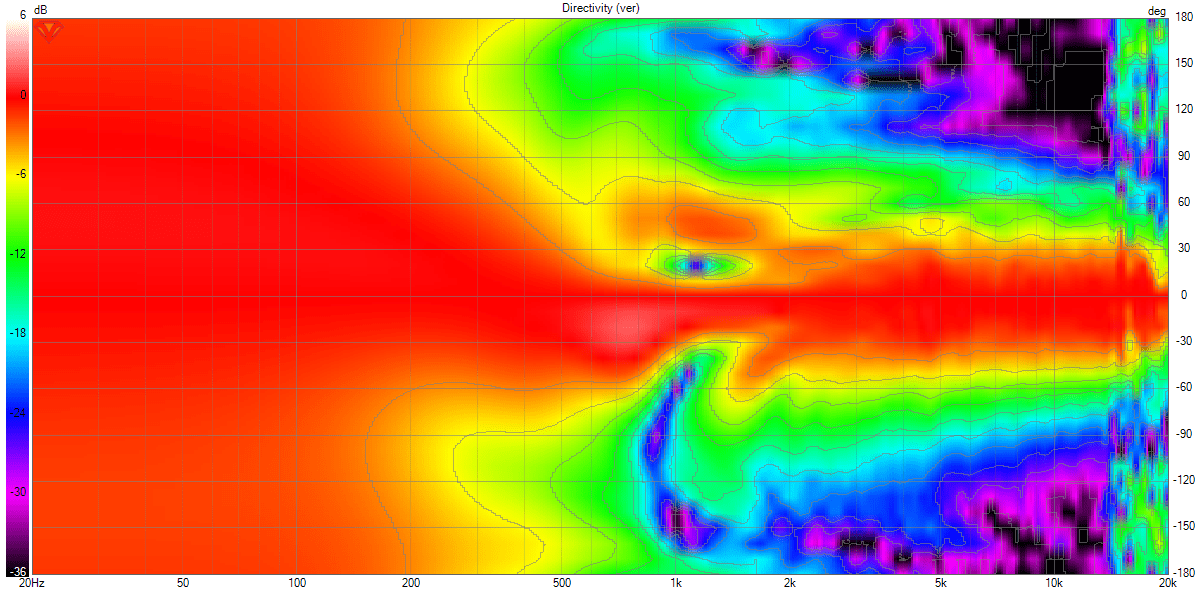

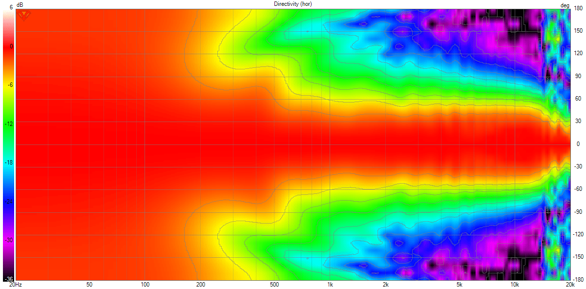

This is based on a LR24 LP @ 1.3k and a Bessel 24 HP @1.2k. XO is not even closely in phase, but gives the best summation for Power and DI with a flat LW. One thing that comes with this is that the axis center is actually shifted by about 10 degrees down, I do not really appreciate that:

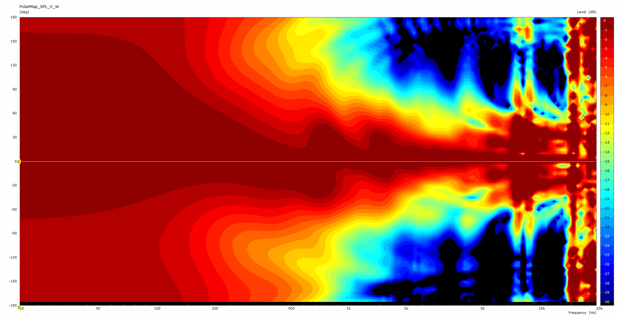

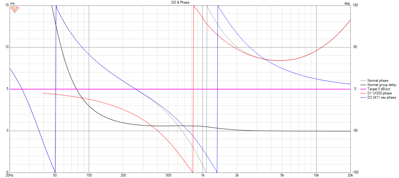

This is what it's all about. Forget about the phase itself, it only has to be correctly calculated&used. Whatever comes best in the overall amplitude and power, take it.

Looking at the picture, perhaps you could try to set an additional small delay for the WG source (manually in observation.txt) because with a CD there will be some additional delay due to the diaphragm to throat distance. With the woofer, I'm not sure.

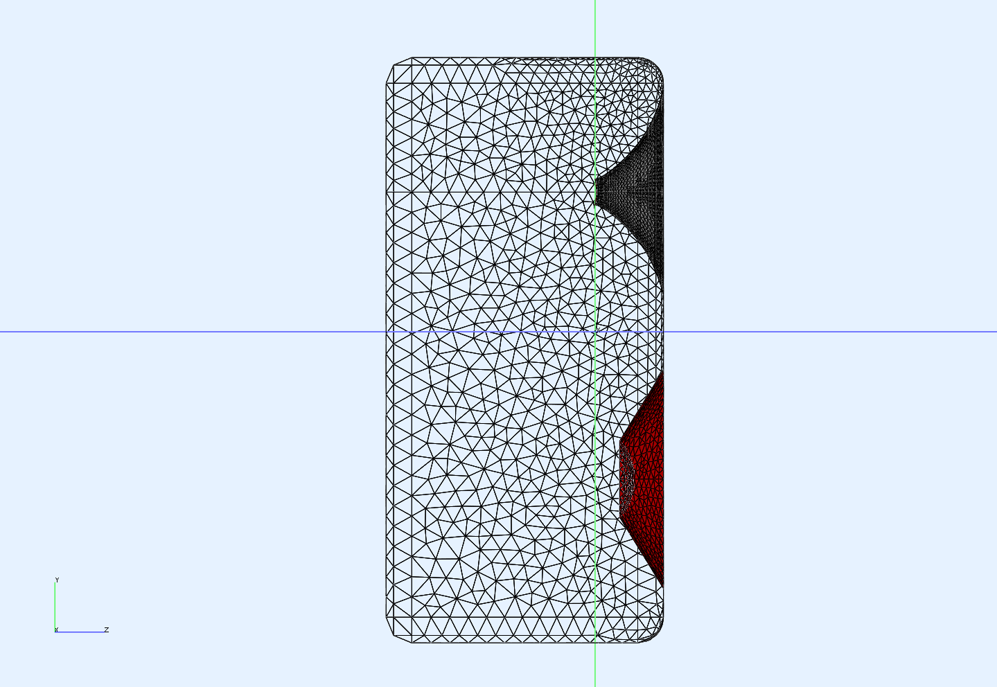

I have noted a little complication, when I had a look at the shifting of the reference axis due to my crossover attempt: Up is down and down is up! It is also visible (only now to me) from the VCAS output that I had posted in my previous post. Woofer axis is shifted upward, tweeter downward, where it should be the other way round. Muting the woofer in VCad shows the main vertical baffle diffraction caused by the downward enclosure pointing up:

Is there a way to solve this internally? To my eyes I figure that both woofer and tweeter are mirrored, I could rename them in this case. But I'd rather like to double check before I rely something on this.

Tick the Spectrum Hints item in the view options panel on the right, that will show you where the measurement is being taken from. The axis going through the speaker is about how the meshes are positioned.
Good to know. The Spectrum Hints follow the offset.

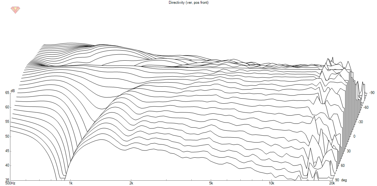

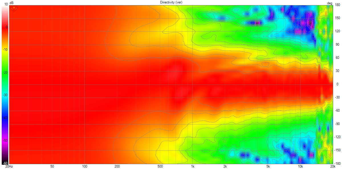

This visualization is dedicated to mabat, and his arguments against a baffled device. Negative angles in front, we are seeing the disruption of vertical respose due to the enclosure below the waveguide:
versus up
Obviously, this can still make for a good system performance, but from a perspective of absolute performance, the baffle obviously has a detrimental effects within a +- 90 degree window up to 20k.
Well the truth is that the vertical performance suffers even with a free standing WG. I already made some quick simulations, then I had to concentrate on other stuff. So it's not a universal cure. I don't know yet the extent to which it's better or worse than all-in-one box. This all is to be found out.
