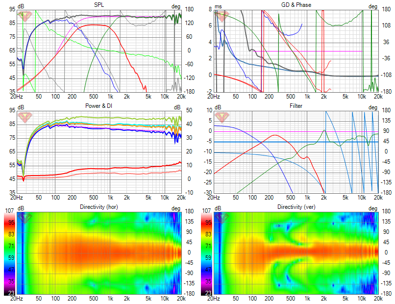

One could have narrow vertical pattern for both the woofer and the waveguide, which would then reduce the influence of the vertical lobing to system power response even though the destructive interference would be the same relatively (as in comparison if both had wide dispersion). This would also reduce vertical reflections. Hello to woofer arrays, or just MTM configuration.Maybe keep the waveguide pattern bit narrower than the woofer, then perhaps the "more power" on the woofer compensates some loss in interference which is now bit less as "less sound to sides" with narrower pattern waveguide, c-c adjust the rest.
I think I posted this earlier already but here again. With passive cardioid mid in MTM configuration, flat DI to very low frequency, but it is due to wider than tweeter hotizontal and narrower than tweeter vertical dispersion of the mid. Not sure if this sounds better, plan to try in the summer.

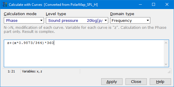

What is the correction step?
0.9873 = propagation path correction [m] (in this case 1m - 1/2")
There’s an example of using PEQ to create non-standard filter orders to reduce directivity error in the acoustic crossover region here:So perhaps only option is to use high order crossover? And of course adjusting the c-c where coincident would be ideal but we can get quite smooth with higher c-c as well, although main lobe is now quite narrow and nulls might point to first reflections depending on the listening setup in a room.
http://excelsior-audio.com/Publicat...tivity_Through_the_Crossover_Region_rev10.pdf

I have been doing that for at least 25 years.There’s an example of using PEQ to create non-standard filter orders to reduce directivity error in the acoustic crossover region here:
But what is he actually doing? I cannot read a literal description of the changes anywhere in the document. It looks like asymmetric slopes (let them be caused by PEQ), from the tilt in the vertical directivity plot between the nulls. Or is there more to it? Also, shifting the phase by delay can help to balance summation off-axis.
The idea is just to use all available degrees of freedom and not stick to some limited set with names like LR, Bessel, etc. My speakers have 1st order HP and third order LP, but with several PEQ bands in and near the crossover points so they don't look like anything with a name. It's all in the software.

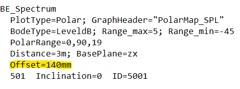

Here's a sample script. Note that the polars are normalized, including the phases - I haven't thought about that in depth, maybe that's not correct for more than one source, it's up to you to figure out. I can't think anymore today...
You have to set an explicit distance for the polars if you want to export them. This will be also the default delay compensation (which you can manually adjust with the PhaseComp value, that will be added to the Distance value).

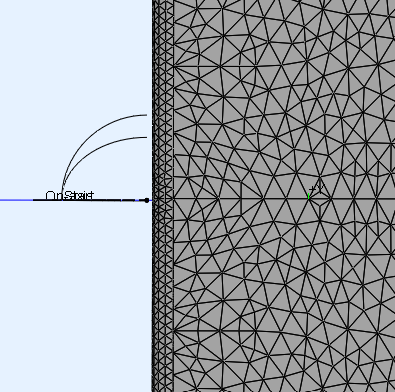

Code:
; Enclosure test
Throat.Diameter = 25.4
Throat.Angle = 10
Coverage.Angle = 45
Length = 60
Term.s = 1
Term.n = 4
OS.k = 1.0
Term.q = 0.98
Mesh.Enclosure = {
Spacing = 30,30,30,200
Depth = 200
EdgeRadius = 20
EdgeType = 1
FrontResolution = 8,8,16,16
BackResolution = 20,20,20,20
LFSource.Below = {
Spacing = 10
Radius = 75
DrivingWeight = 1
Mesh.VerticalOffset = 80
Mesh.Quadrants = 14 ; 1/2 symmetry
Mesh.LengthSegments = 24
Mesh.AngularSegments = 64
Mesh.ThroatResolution = 5
Mesh.MouthResolution = 8.0
Mesh.SubdomainSlices =
Mesh.ZMapPoints = 0.5,0.2,0.5,0.8
ABEC.SimType = 2 ; free space
ABEC.MeshFrequency = 1000
ABEC.NumFrequencies = 24
ABEC.f1 = 300
ABEC.f2 = 10000
ABEC.Polars:SPL_H = {
MapAngleRange = 0,90,10
NormAngle = 0
Distance = 2.0
FRDExport = {
NamePrefix = hor
PhaseComp = -2.0 ;[m]
ABEC.Polars:SPL_V = {
MapAngleRange = -90,90,19
NormAngle = 0
Inclination = 90
Distance = 2.0
FRDExport = {
NamePrefix = ver
Output.ABECProject = 1
Output.STL = 0
