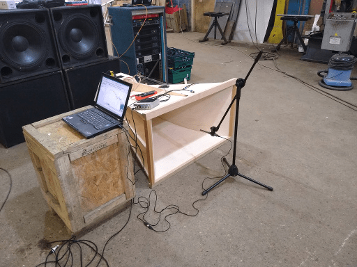

Good point about the throat impedance. I have a script for generating point clouds of simple round to square throat adapters that preserve the area expansion for which I would just need to write a new meshing algorithm (I tried meshlab but could not generate a satisfactory quality mesh from the point clouds). I think a separate throat adapter is sufficient for 4kHz but I would like to incorporate the round to rectangular transition into the whole first exponential part of the horn if I developed a higher frequency version. The construction plan is currently to 3D print the first exponential section with carbon fiber reinforced plastic and to build the conical sections out of ply, this does restrict me in that I can't have curves in the ply sections.
^You could do kerf bending or laminate multiple thin layers plywood to get curved profiles 😉
we did that for the midbass horn but it takes a long time to make all the jigs etc.

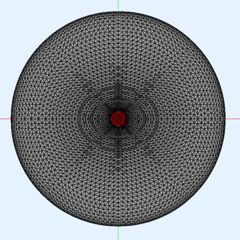

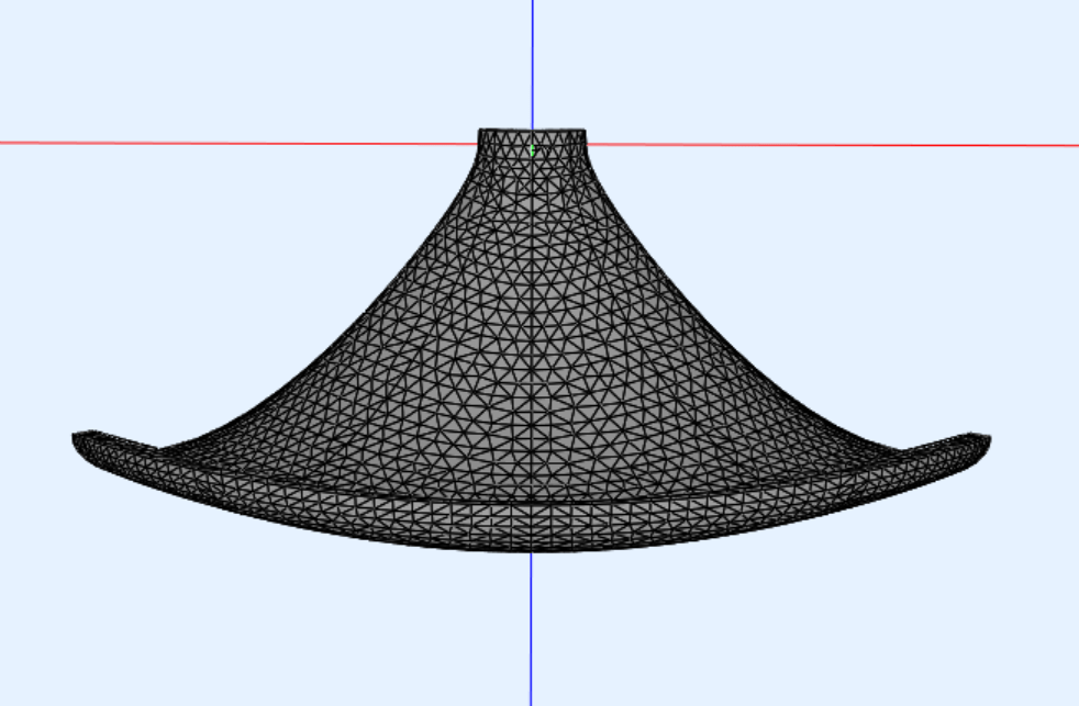

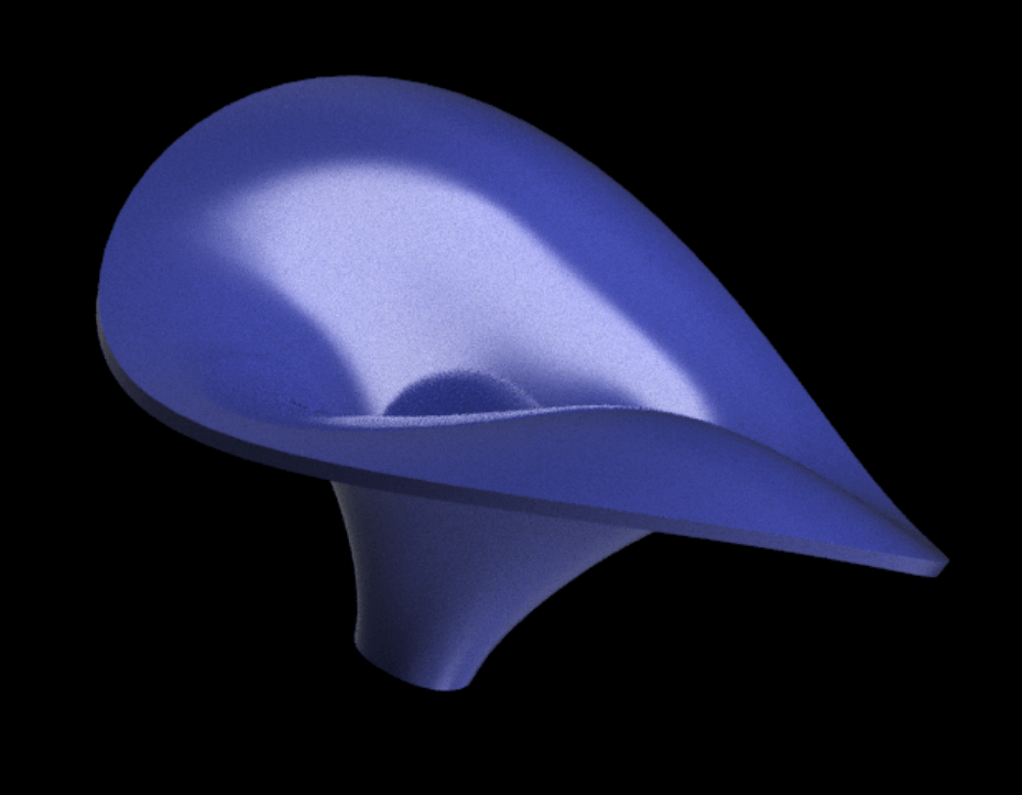

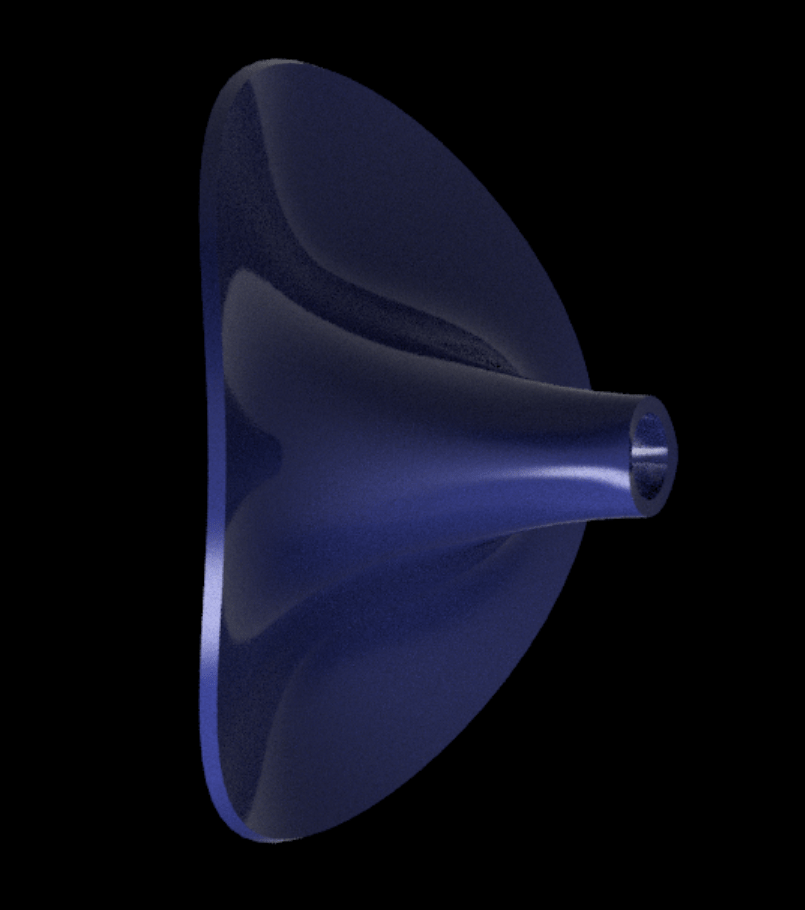

Creating a smooth solid in Fusion is surprisingly easy, could be printed right away -Here's an example with the 'k' varied around the horn
https://a360.co/3vcObMW
Only acoustically there's nothing to be much proud of.

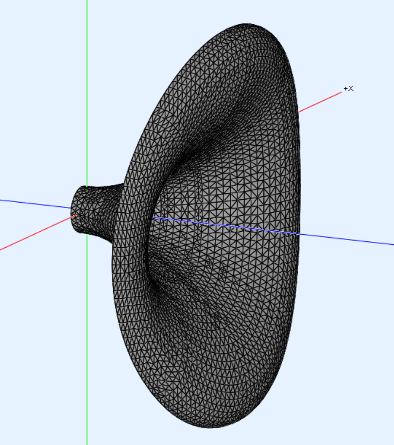

- This was just a small sample, ⌀240 x 120 mm, 1" throat.

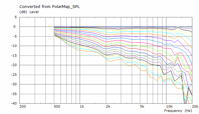

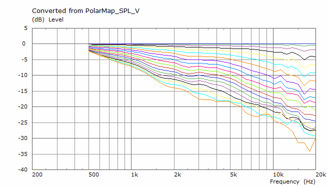

Horizontal, vertical, 0-90/5:

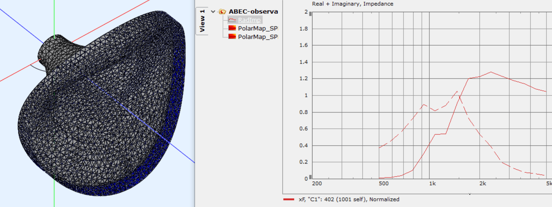

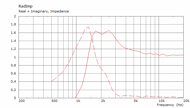

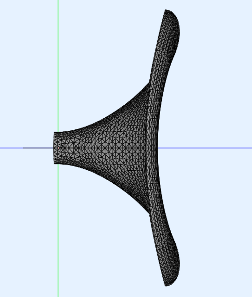

- What about the negative real part of the throat impedance? Does it make any sense? It keeps being negative below 1 kHz repeatedly with these shapes. What would that mean, is that an error?
Obvisouly it's an error. With a subdomain added the impedance is very different and reasonable -is that an error?
( I just hate how tricky this 3D modeling can be.)
