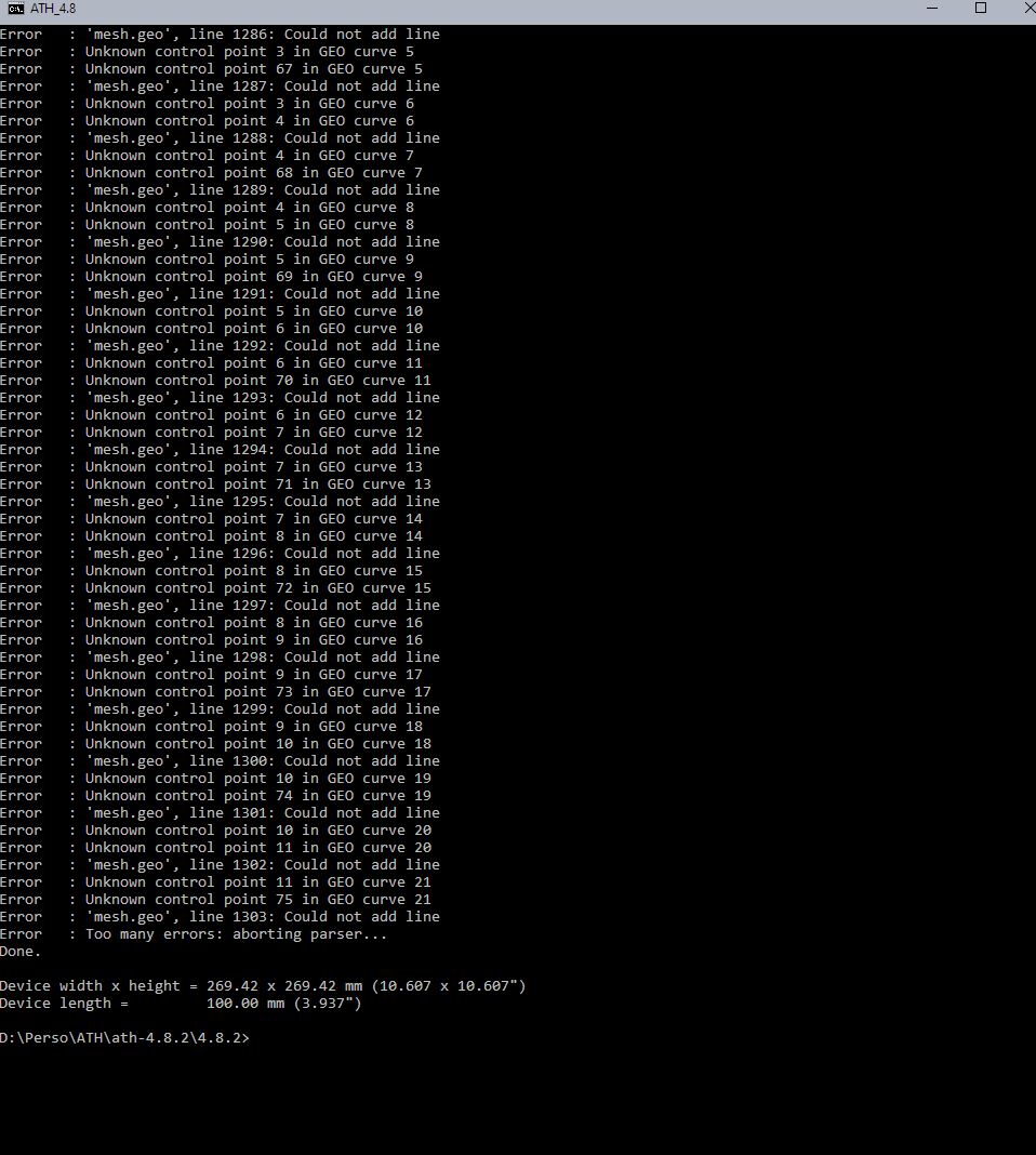

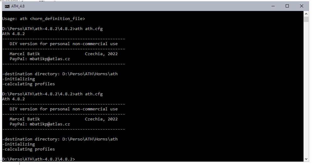

Hi All,

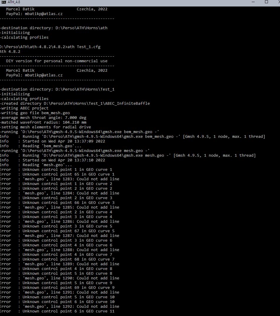

I'm training on ATH and can't get STL output.
May you please check my config file ?
Thanks.
Edit : I only get a mesh.geo file.
And attached is the return of CMD, no dimensions displayed.
  • ath.txt
    ath.txt
  • The first three lines from your script are for the ath.cfg which is a global config file. Use a different file for a WG project (the rest of your script).
  • For some reason STL is not correctly generated when Output.ABECProject=0. Try setting it to 1. I'll check that.
  • For axisymmetric devices there's a much better way - see ABEC.SimProfile=0.

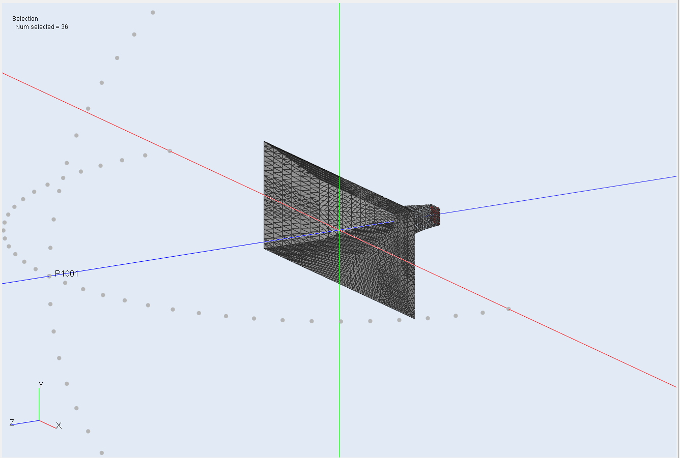

Flip the MapAngleRange to 180,-180, 72 and it should go the other way. Starting at plus 180 going round to -180.
I had thought so to, but ABEC does not accept this range and gives the following prompt under observation scripts:
Code:
PolarRange= values missing in "PolarRange"
Manually or through Ath change the Inclination to 180 in the observation script to flip it around.
Code:
BE_Spectrum
  PlotType=Polar; GraphHeader="V Polar Down"
  PolarRange=0,180,37
  Farfield=true; BasePlane=zy

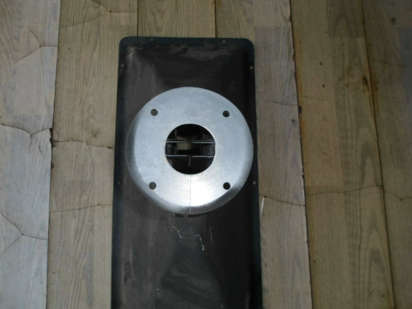

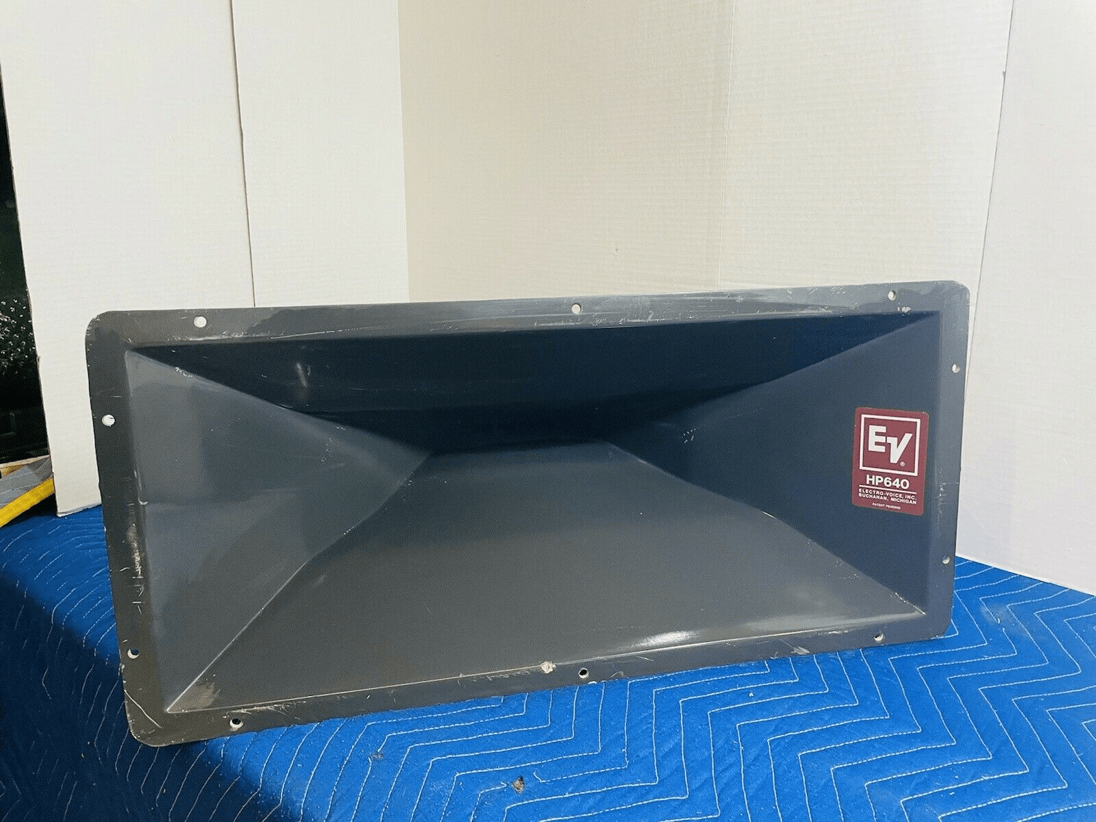

This is great, I wrote my own scripts to make the meshes for these types of horn in OCTAVE/MATLAB as they seem to be the only way to get wide coverage and good low frequency loading but my software is not as sophisticated as ATH4. This EV HP640 is a particularly sophisticated horn that makes used of a exponential-conic-conic expansion and has vanes in the throat to reduce the HF narrowing.
I was using -180, 180, 72, and changed it to 180, -180, 72. The first command works for a full spin, but gives reversed orientation, the second leads to the aforementioned complaint from ABEC.
This EV HP640 is a particularly sophisticated horn that ...
You mean: it's a diffraction horn?!

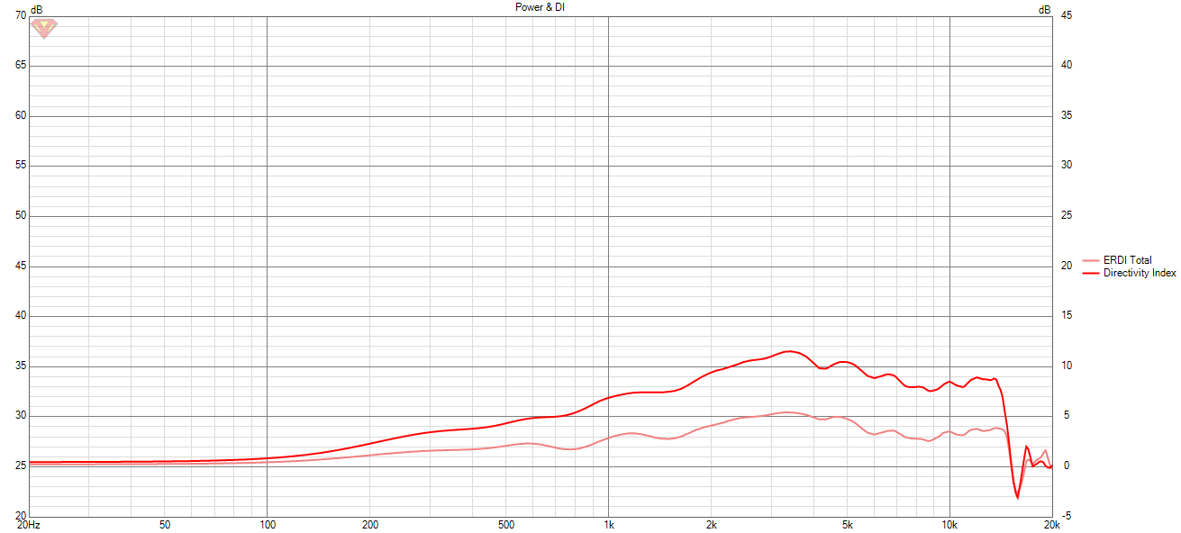

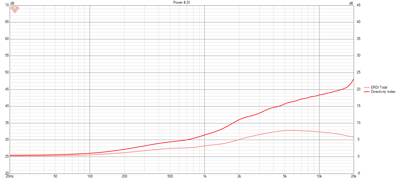

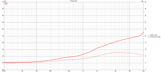

I also wanted to ask @kimmosto, here is another observation of the new ath capabilities:
First DI/ERDI curve is the product of VCad, combination of SPL Trace tool and Diffraction tool for a baffle of 57 cm by 32 cm with 4 cm edge rounding, for the woofer PHL 3411. Second DI/ERDI curve is based on the Sd of PHL 3411, converted into cicular radius and used in ath 4.8.3 beta for BEM simulation in an enclosure of 57 cm by 32 cm by 27 cm (HxWXD), with a 2.5 cm edge rounding. In both cases, positioning of the woofer is about the same. But quite a difference between 1 and 2k (the upper frequencies are of no concern). What to rely on?
I think starting at 0 makes the most sense and using the zy plane. In my example above the V up goes from on axis to 180 in the upper hemisphere and by flipping the inclination V down goes the other way. This is how I would measure the speaker.
I see hardly any difference that isn't due to the application of the traced on axis response. If you want to compare the difference between Vituix and the Ath generated woofer don't trace the on axis and just use the diffraction tool. If there is any real difference there it will be due to the depth of the cabinet which is not considered by Vituix, and therefore the full 3D simulation is more likely to be accurate in simulating the directivity.
I was testing this and the result is that differences are probably resulting from the added third dimension, depth. Especially the diffraction waves must be a result of enclosure depth, as well as the slightly lower DI.
