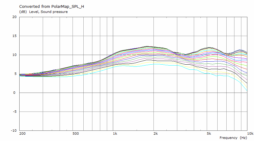

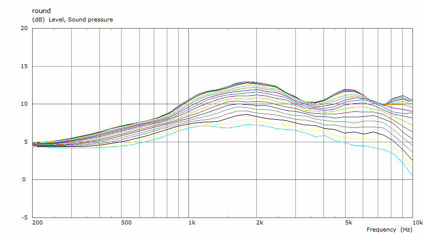

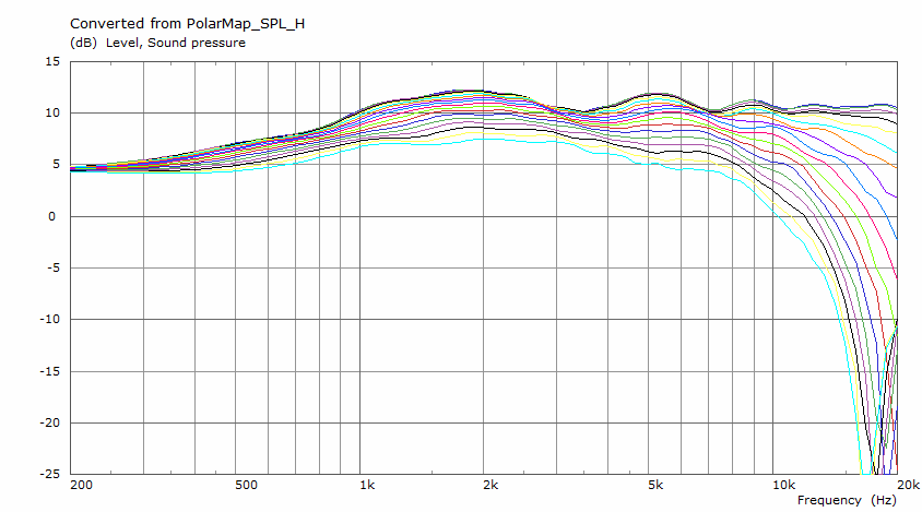

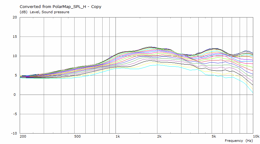

The last chart refers to?

That was only extended to 20 kHz.The last chart refers to?

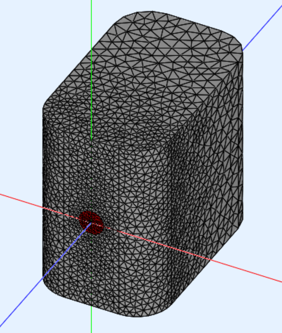

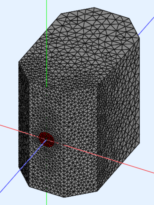

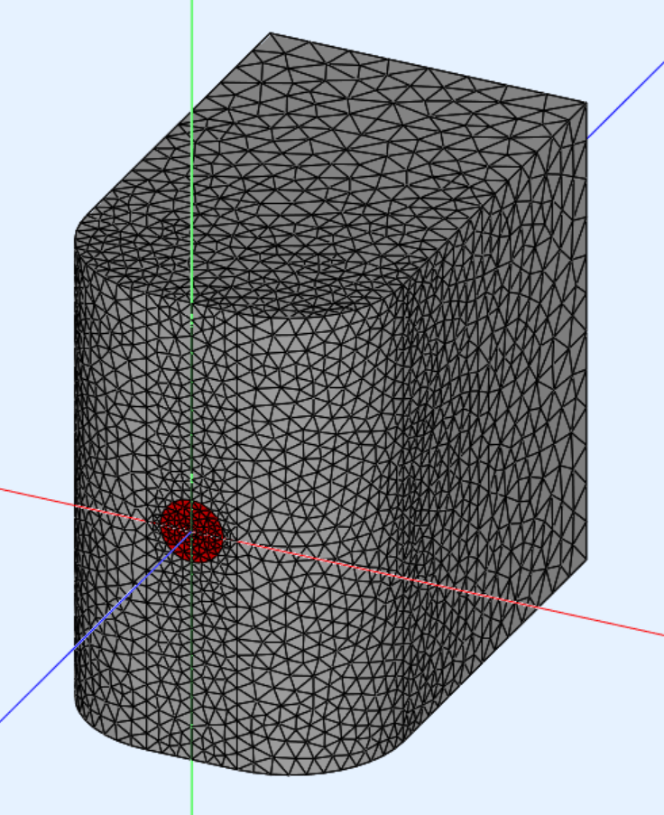

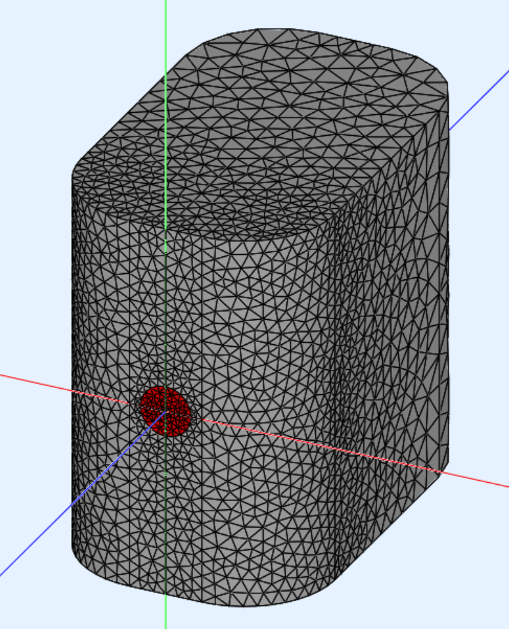

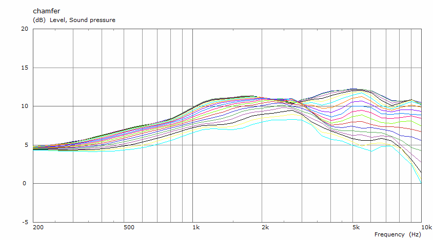

This is interesting. Will it be possible to try out a double chamfer and set individual angles? Clearly, the slanted edge produces a massive localization of diffraction effects higher up in the passband. Maybe something for a three way, but a two way would suffer dearly.Rounded vs chamfered edges:
View attachment 1036426 View attachment 1036427
View attachment 1036428 View attachment 1036429
