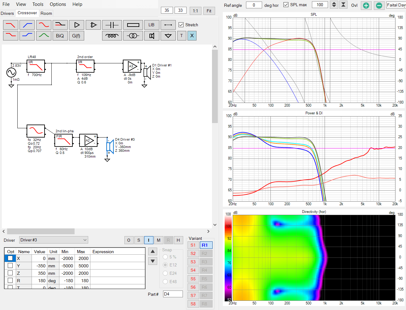

I thought you were wanting to go smaller with the cardioid construction but I see what you mean now, here is an example (active) of what you are describing. A 15" woofer in a box that is not as deep as it is wide gives almost the same response down to 300Hz at full output, the example below extends it to 100Hz but chews a lot of output, there is a 19dB difference in gain between the two drivers.Isn't it so that what's above 4.8 dB for a woofer in a monopole cabinet stays above that in a cardioid cabinet? That's my whole reasoning - I can't see how could it be lower.
So if the target DI is 10.0 or higher, then how do you match what you have shown to the HFs? Cross at 1.2 kHz?
Does that sim include the box diffraction? Doesn't look like it.
If the waveguide has a DI of 10 then yes or use a bigger woofer to match at a lower frequency, but why does it need to be 10? Your own NS15 is 8.6dB (according to the image on your website) which would match what is in the sim above at 800 to 900Hz and where you chose to cross it.So if the target DI is 10.0 or higher, then how do you match what you have shown to the HFs? Cross at 1.2 kHz?
I'm confused by your question as you already know the answer.
Yes but only basic edge diffraction.Does that sim include the box diffraction? Doesn't look like it.
I wasn't comparing it to anything in particular, only pointing out how it gets much harder to do with a higher DI. But just to be precise, the NS15 is more like 700 Hz. Xover, but that's hard to define when the crossover is asymmetric. Its much lower for the woofer than it is for the waveguide. And 8.6 in your example would be about 1 kHz, so our view of the numbers don't quite agree. And anyway your comparing sims to real data the two thing don't always agree. Does the edge diffraction take into account of the boxes total volume? Or just the edges? A sphere has no edges, but it still has diffraction.

I was only trying to give a frequency region where a reasonable directivity match would likely occur. With fully synthetic data it's still only an educated guess.our view of the numbers don't quite agree.
This is how the author describes itDoes the edge diffraction take into account of the boxes total volume? Or just the edges? A sphere has no edges, but it still has diffraction.
Simulation is based on simple ray theory: each driver is a point source sending 72 rays towards baffle edges with fixed 5 deg steps. Path lengths of shortest 1 st order diffractions are calculated and summed with delay i.e. phase information in a listening point. Magnitude of diffracted rays is frequency dependent. Weighting factors are calculated from radiator dimensions and edge radius
I have full 3D sims of 15" woofers in various cabinets where the responses are much more closely aligned with reality, but none of those include a cardioid component which was the point of the graph.
I'll try to prepare some open baffle (would rather not to call it cardioid beforehand) simulation. The idea that the DI can be lower than a monopole even where the source is already beaming is worth exploration. I still feel a little dubious about it.
