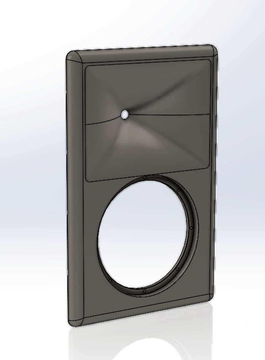

Or to glue in some tubes. Possible but it's easier to make the holes part of the model.It is best to "drill" the holes to the model - so that you have shell material around the bolts. If you drill through prints, the holes will not be good and will weaken the print.
I see what you mean - as this is not a solid. Hmm, I cant perform that 3D CAD work myself I'm afraid...I can twiddle in Sketchup - thats all... help pretty please??
Maybe I could glue in 8mm solid insets that holds the 5,2mm holes? - OK mabat suggested this also I see now

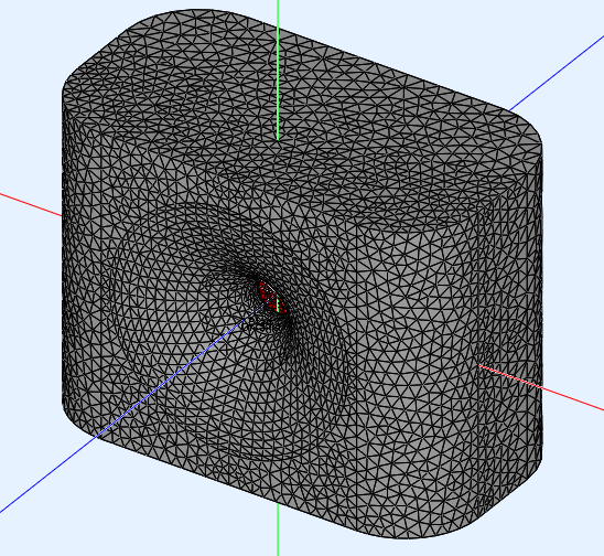

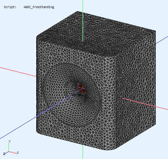

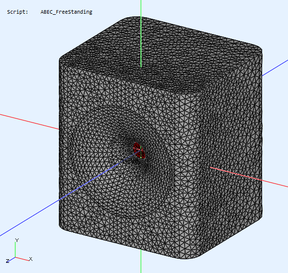

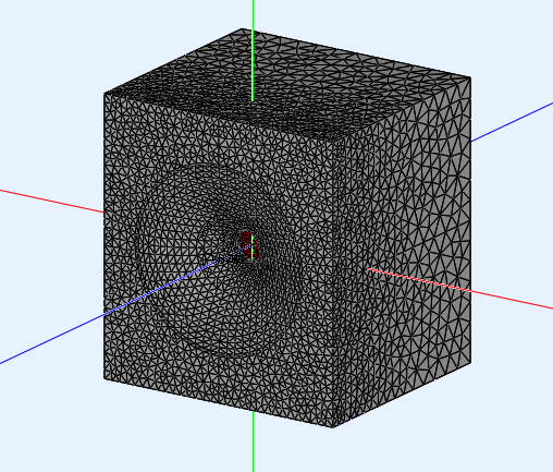

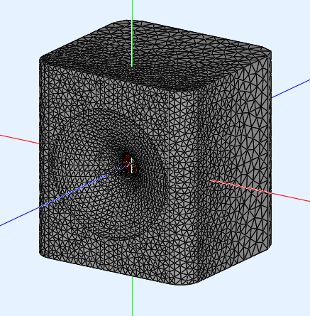

Scripted enclosures!?- A small step further in generating an enclosure:
View attachment 1035574 View attachment 1035575
View attachment 1035577 View attachment 1035579
Yes, of course. The third option being all edges rounded - that remains to be coded.
I do it as an exercise to prove that freestanding waveguides can't be easily beaten
(It will be possible to optimize the enclosure dimensions along with the waveguide - if there's anything to be gained with that. And also to see clearly the influence of different rounding of the edges.)

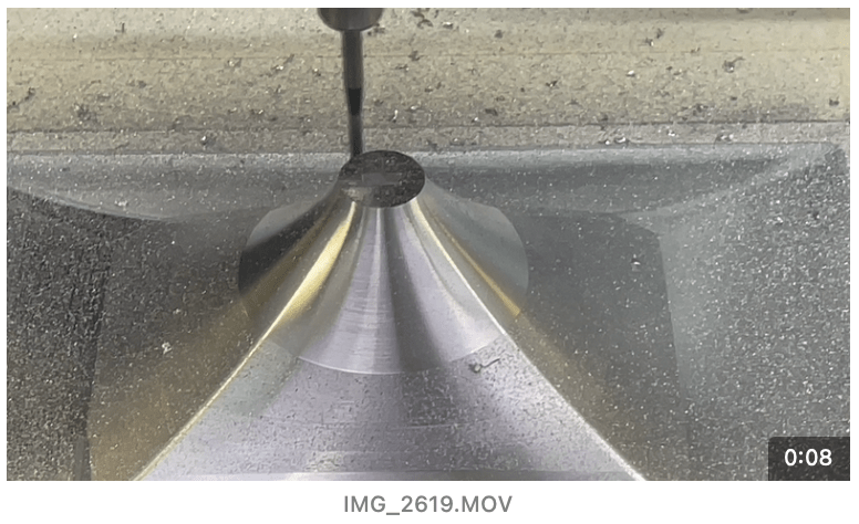

Here is the finish cut on my new boxed 400x290x100 round to rect WG. This section forms part of a full baffle mould tool. Most likekly GRP or carbon if I have any left from bike frame experiements. The corners of the WG blend out to 8mm radius with a baffle edge radius of 30mm. Render shown.

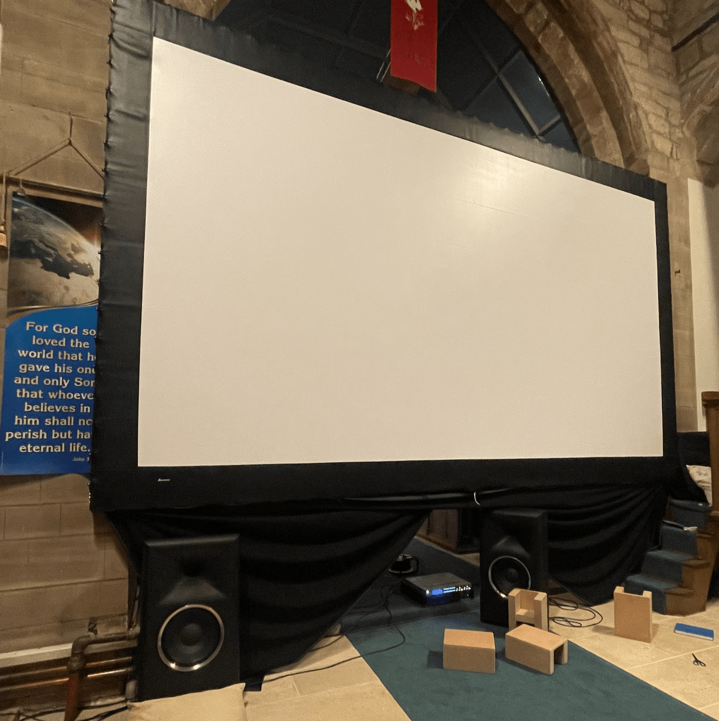

The previous DIY project using ATH4 was well received at a church cinema night. See the image below. Thanks mabat for your amazing tool. So many good words, especially the clarity of voices all round the nave.

Will it be possible to have the walls of the box not parallel?
Will it be possible to have a different radius for each edge?
That's exactly what can be done with the tool at the moment. It's never enoughIf it were me, but I would never do this myself, I would start OS - all the way around at the throat - and as gradually as possible morph to square at the mouth (including a flare.) This is likely the best that you can do with a round to square situation. [...]
I didn't plan that but can think about the non-parallel side walls, that should not be a big compilation.Awesome!

Wow, I wish I had those capabilities and tooling. Wonderful job, unrivaled.Here is the finish cut on my new boxed 400x290x100 round to rect WG. This section forms part of a full baffle mould tool. [..]

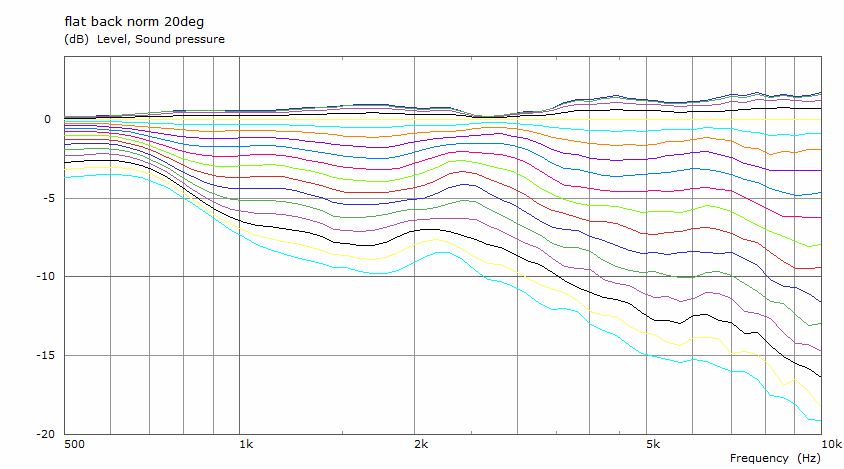

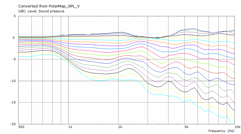

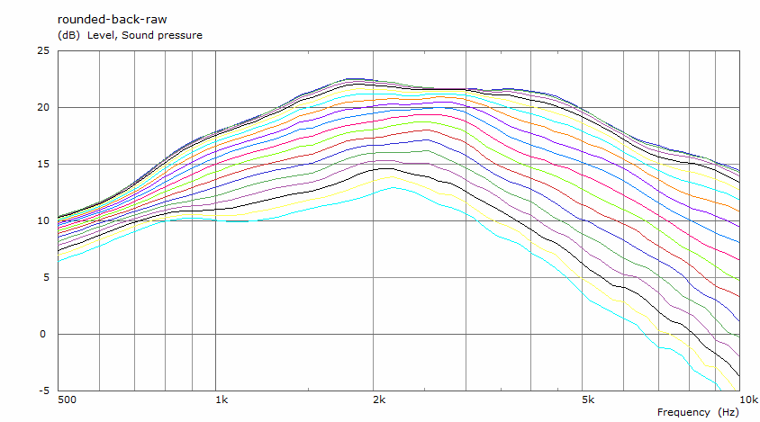

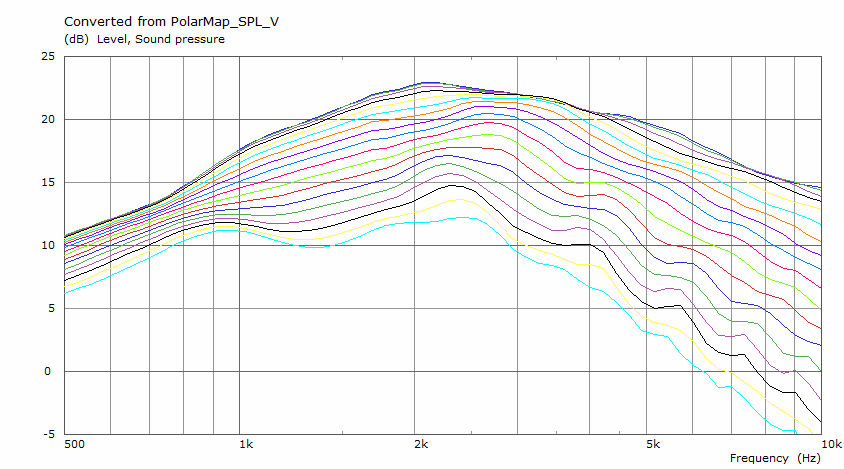

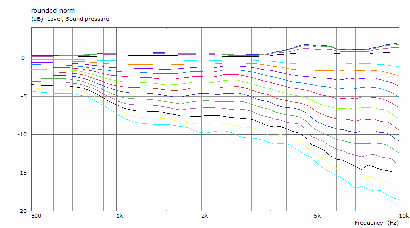

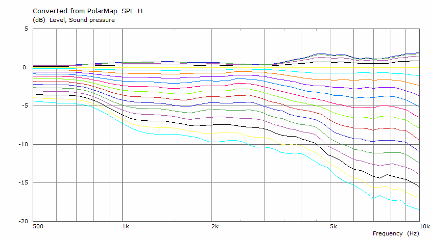

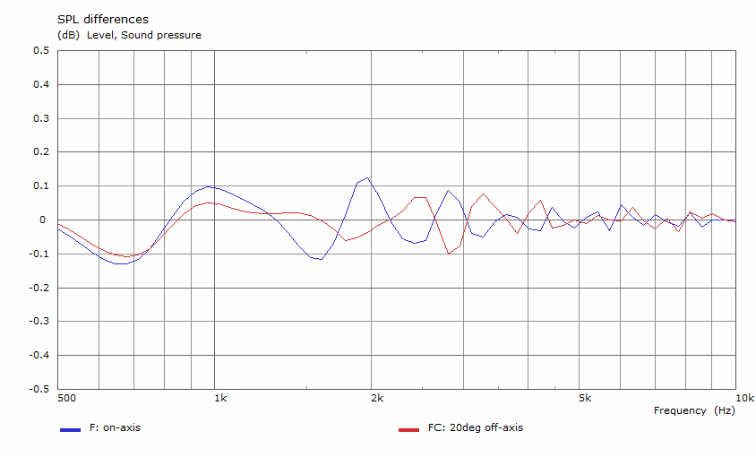

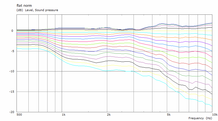

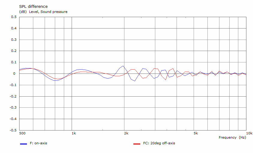

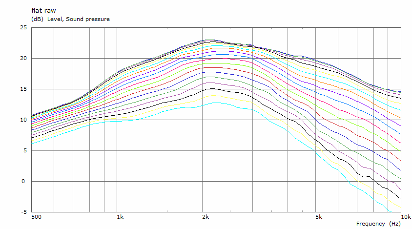

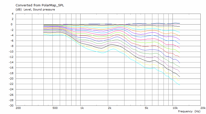

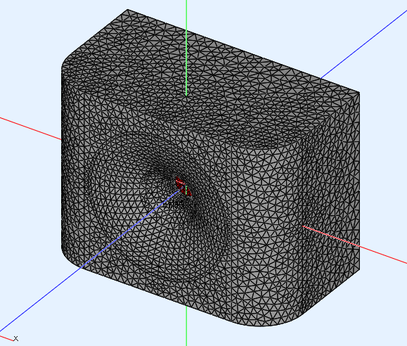

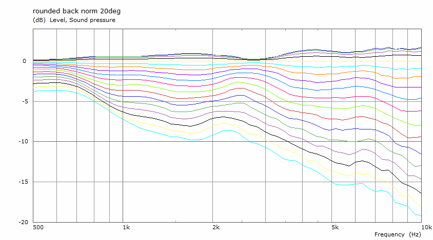

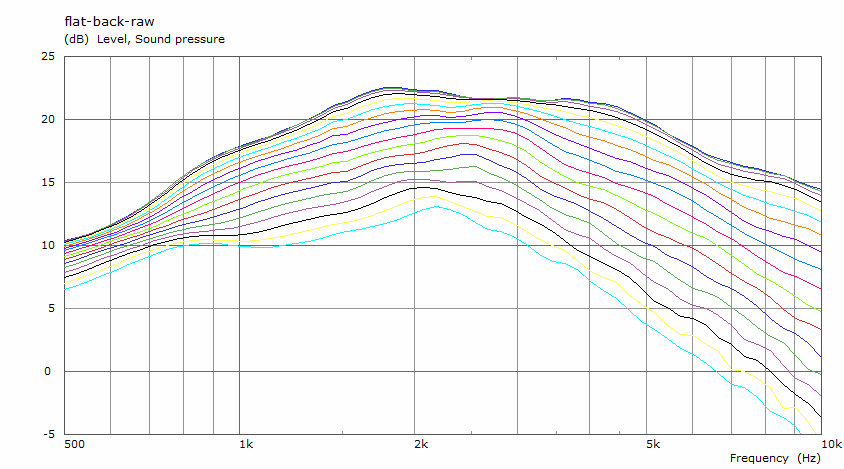

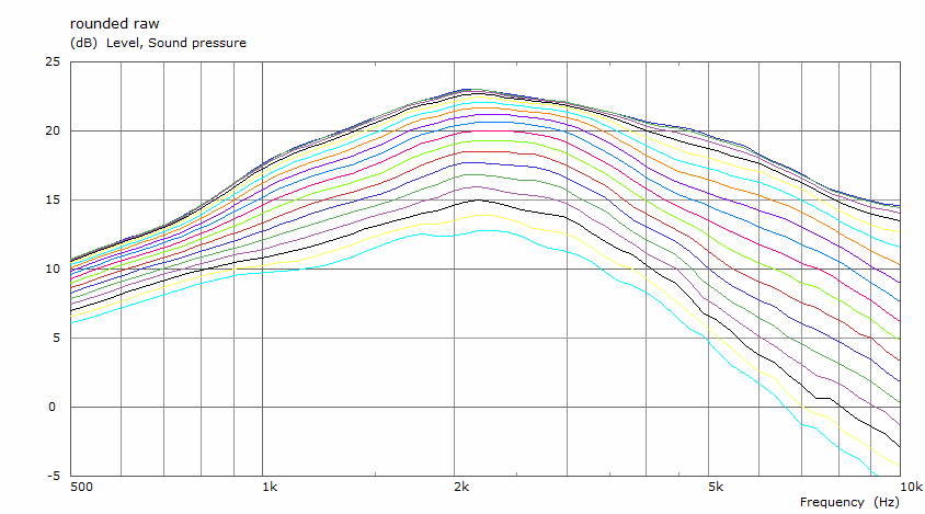

I think Earl once expressed a wish to see the influence of the back edge rounding. Now it's easily possible so here's a small example (box 245 x 264 x 200 mm). I only should probably chose a bigger rounding radius (and I'll do that again).
Flat back
Rounded back (R=25mm)
SPL differences on-axis and 20deg off-axis:
Flat back
Stunning work!I think Earl once expressed a wish to see the influence of the back edge rounding. Now it's easily possible so here's a small example (box 245 x 264 x 200 mm). I only should probably chose a bigger rounding radius (and I'll do that again).

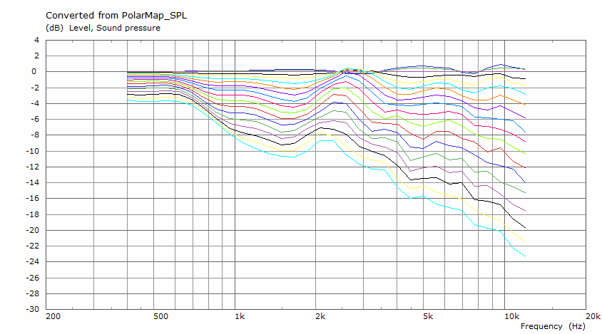

Equally very well controlled diffraction polars with the roundover of 50 mm. I wonder whether these improvements are a result of the increased radius only, or if the increased width (5 cm wider in total) and especially the decreased depth produce the more even polars. A wide but shallow baffle is not necessarily what I was looking for myself, but I am remembered of the GGNTKT M1/M2 speakers that feature a similar enclosure form.
Great work, really looking forward for this.

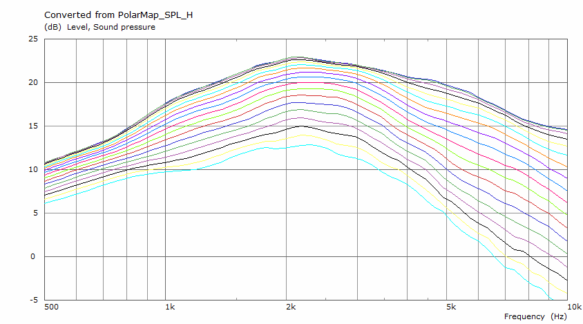

The previous box horizontally & vertically.
Horizontal:
View attachment 1035844 View attachment 1035845
Vertical:
View attachment 1035846 View attachment 1035847
Can you extend the bottom of the enclosure by 1x its length, to show a waveguide position in a two way enclosure, and make a vertical up and vertical down polar plot, or is this still too early with current scripting means? Hefty difference between 50 mm roundover versus none.
