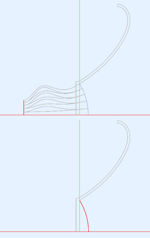

Have you tried to compare the results of simulating a pulsating sphere instead of the phase plug on the same horn?
Sure -

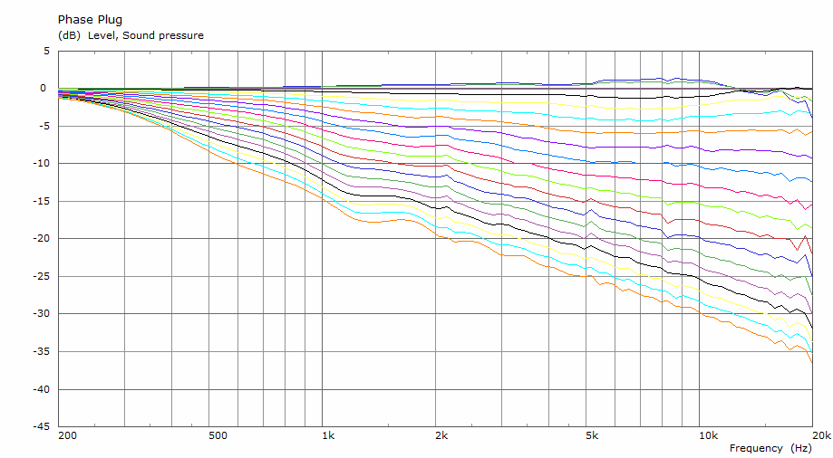

The "phase plug" (50x5V2), polars normalized to 10 deg, 0-90/5 deg:
The corresponding pulsating spherical cap (ø106 mm in this case - see the attached drawing):

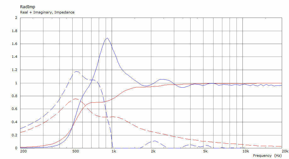

Normalized impedances (blue=phase plug):

To me this means that a waveguide optimized for a given spherical wavefront source will perform basically the same with the corresponding "phase plug" (still need to come up with a suitable name), i.e. it's possible to design it separately. At least the polar performace. The impedance (and the absolute SPL response) will still be affected by the details of the interface.

The radiation impedance has doubled, i.e. greater "loading", and yet there is no change in the radiated output. Looks like "loading" is not really a factor after all.
The polar output charts are normalised to the on-axis response in those most recent plots, so the increased loading at 800 Hz is possibly just 'masked' by the way the magnitude data is shown?

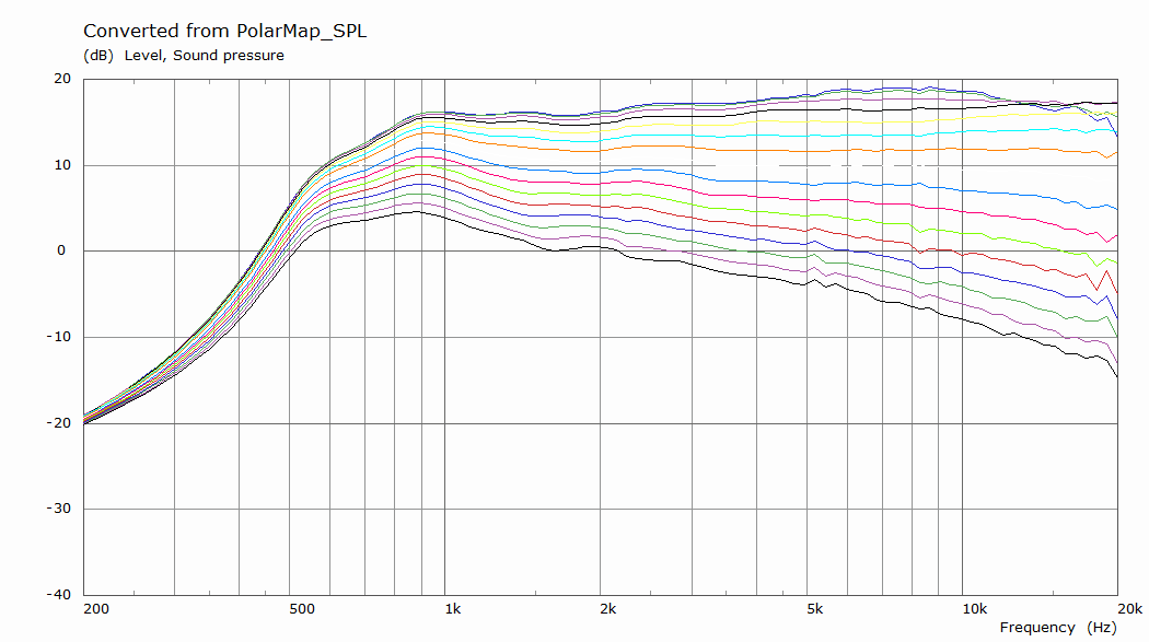

Earl those graphs are normalized polar plots converted to curves and so they will only show the directivity not the SPL gain of the extra RadImp at lower frequencies.
mabat could plot the SPL curves and they would look different.

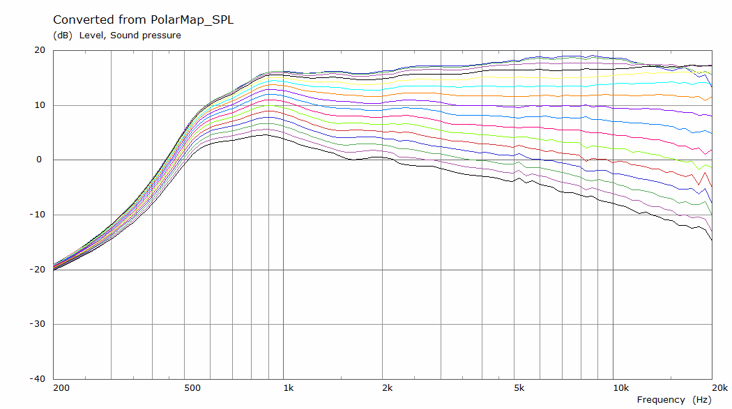

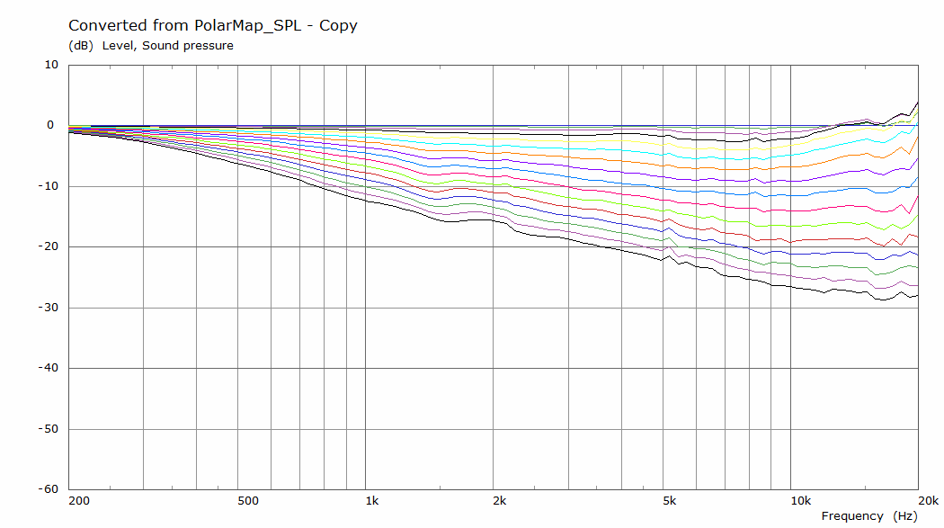

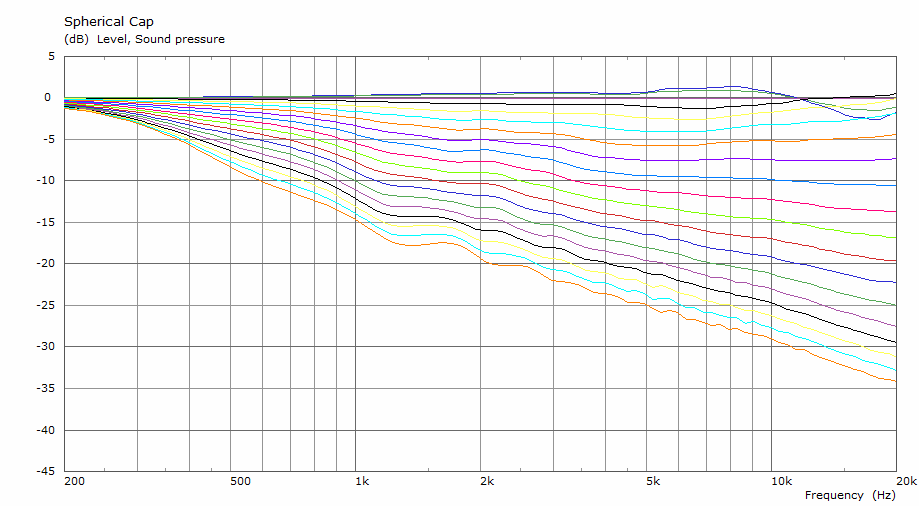

I don't see normalization as an answer. I thought about that and decided that it wouldn't be the case. The increased loading is band-limited and as such should affect even a normalized plot. But there is no difference what-so-ever around 800 Hz.
These are the non normalized polar curves where you see the effect of the extra RadImp on the lower frequencies.
We need to see a comparison between the two.
It's a comparison of quite different sources, one of them being purely theoretical. I was only interested in the radiation pattern for that kind of analysis.

Those curves are for a constant velocity source. I'm not sure it's very relevant either.These are the non normalized polar curves where you see the effect of the extra RadImp on the lower frequencies.
Best I can do is show normal vs non normal, third image is a gifWe need to see a comparison between the two.

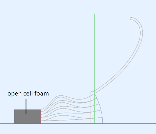

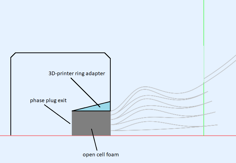

The idea is that at least some of the wavefront non-flatness produced by the CD would hopefully end up as evanescent modes, damped in the tube. Also resonances would get damped pretty well I guess. The higher-order propagating modes at least partly damped.I would also try to insert a straight tube (~2" long?) filled with open cell foam between the driver and the plug. Wonder what difference would that make...
That kind of thing may have been patented, as I said before. You might look it up under Meyer.
If you want to get really esoteric, you could manipulate the velocity across the spherical wavefront with channel widths. No idea what that would do, but now it's an option.
I can't find it. Do you have an idea which patent it would be? - Meyer Sound - Patents
Yes, there are quite a few degrees of freedom in this. I'm going to run a large automated batch with a random variation of most of it - it's fun to look for patterns in the results. Only need to adapt the tool a bit.If you want to get really esoteric, you could manipulate the velocity across the spherical wavefront with channel widths. No idea what that would do, but now it's an option.
