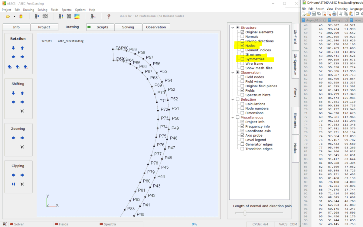

If the goal is to simulate an existing device, then no, there's no directly supported way of doing it.
In an axisymmetric case it's possible to simply overwrite the node coordinates by your measured points in the file nodes.txt. Just set the number of length segments to your number of points and then overwrite the generated coords in the text file by your numbers.

I do this quite often when I want to quickly try something - ABEC redraws the model immediately if you change something in the file, it's easy to get what you want by a simple cut-and-try approach (you may also need to touch the solving.txt to add/remove some nodes but more about that later) -

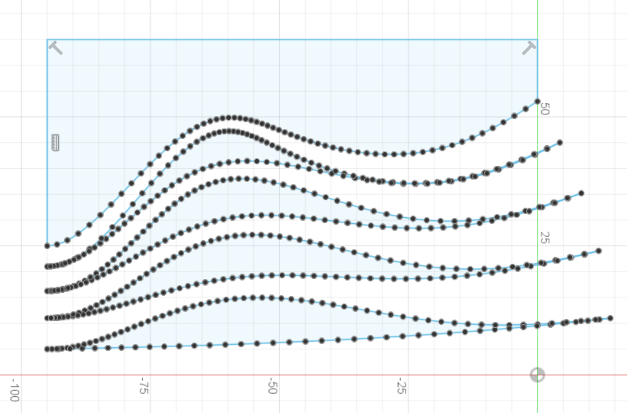

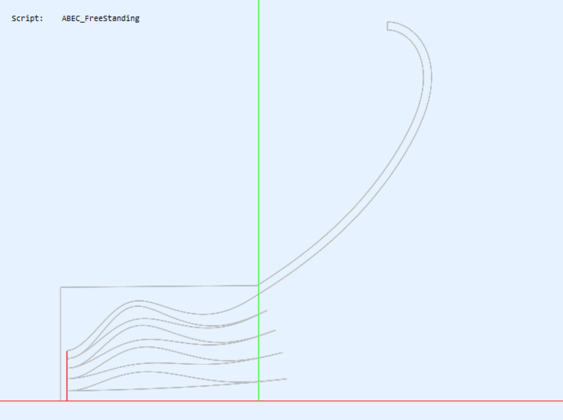

2" driver/5-channel plug in Ath ("*.afp") format for Fusion 360, including the necessary Fusion script (AthProfileImport).
This time these are the raw vanes with zero thickness. This is left to be dealt with somehow, probably depending on the manufacturing technology used. Provided "as is", without any guarantee.
BTW, the whole thing could be also designed and constructed so that all the vanes could be inserted one by one into the plug from the front. It only leads to a bigger overall exit diameter which probably would have its downside.
I tried that and it didn't make any difference in the simulation, other than making the whole structure larger as a consequence. Hard to say what difference could it make in a non-ideal situation. It's definitely possible, I'll keep it in the software as an option.[...] Maybe having a solid in the middle as most phase plugs do would help
Note that in the case of a regular CD phase plug there's an obvious reason for the solid center. I don't quite see a reason for it here.
That's great, and the import tool works perfectly. Is this designed for the same horn as in post #8742?
Yes, it should be interchangeable with the previous one.
