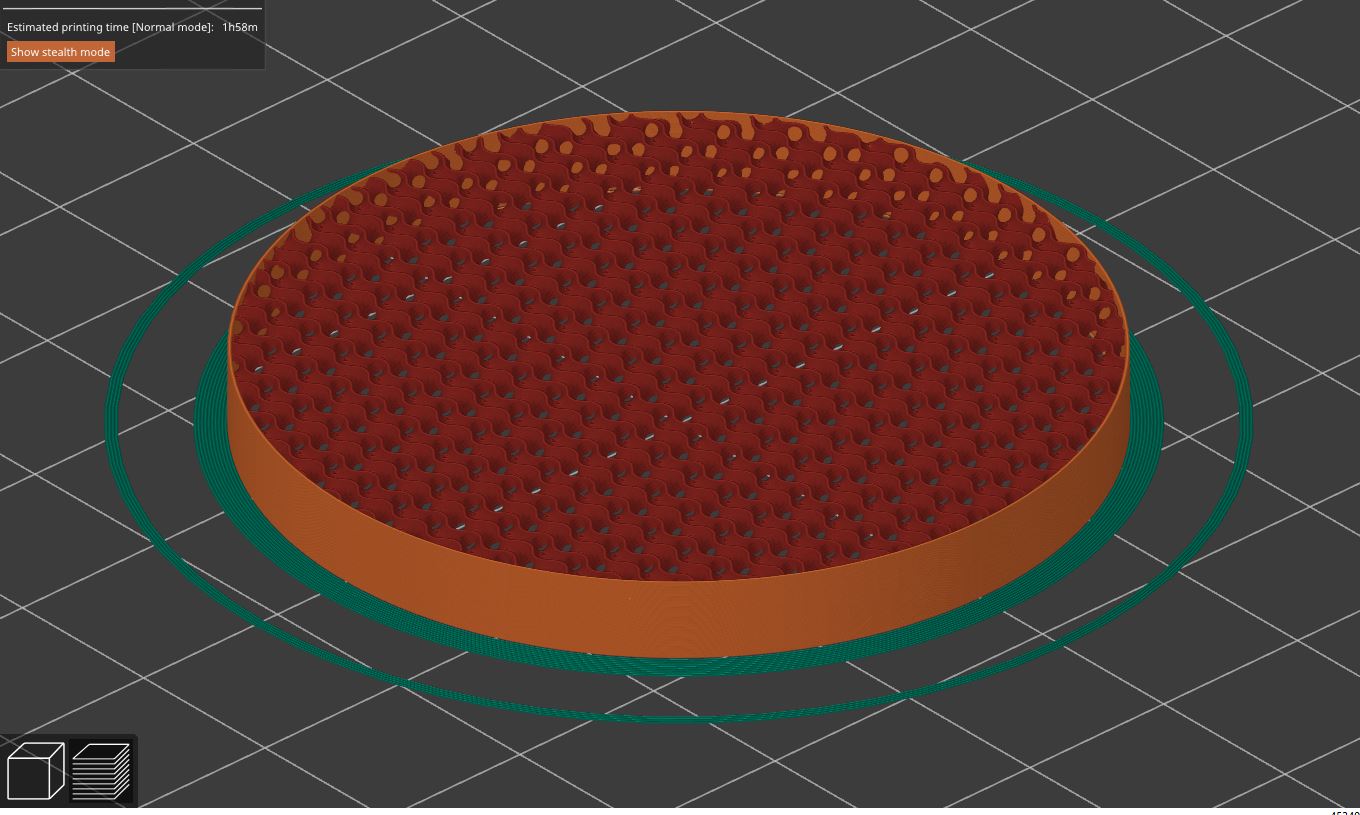

I'm giving this a go, to see if it would behave as foam as I finally got my .2mm nozzle to pring.
It's 0.5cm tall and 5cm in diameter (20% infill)
Dr. Geddes, could you measure any difference with and without on your builds?
There's a mention of this sort of thing in 'the horn book', with a note that it needs more investigation. It seems that adding layers of this sort of porous mesh at the throat has the effect of making the horn itself appear quite a bit 'longer' acoustically.
I'll be interested to see what results you get. If you have time and materials, perhaps make a few with varying hole dimensions and arraying, then layer them up while documenting the difference for each?
It's not the kind of thing that is easy to model without some serious CPU horsepower for the ultra fine mesh.
Yes, I did some measurements - more than a decade ago. I am not sure that I could dig them up now.
The "take-away" for me was that FR wise the effect was small, a few dB loss at 10 kHz. What stuck with me was that this loss, as viewed in the impulse response, was well after the peak of the impulse, i.e. the "tail".
This foam was deep, about 10", 30-40 PPI, hence very open. Put down in the throat this foam will have much more effect owing to the much higher velocities. Meyer had a patent on something like this.
That's an interesting point, I wouldn't have guessed that, i.e. that the velocities are higher at the throat.gedlee said:Put down in the throat this foam will have much more effect owing to the much higher velocities.
(That means that the pressure gradient is higher, right. I'm only thinking how to get this information out of the simulated data.)
