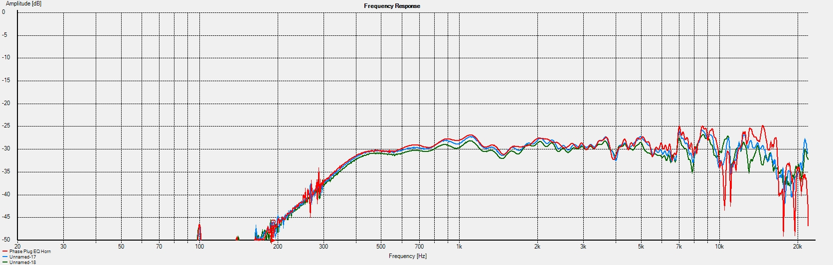

Red - Axi2050 in free air
Blue - Axi2050 in the horn with phaseplug from yesterday
Both are on axis measured at 1m
As I look at these results, I have to believe that they confirm what I expected. The wavefronts in the channels are going to be perturbed by the lateral acceleration necessary for them to stay in the channel. This will clearly have an effect on the wave impedance of the channel with each channel different. I don't see how they can ever sum coherently at HFs. To me any attempt to cause the wavefront to move in a manner contrary to what the physics say, will have this problem. Only when the wavefront is allowed to expand as the physics say it should will this problem not occur.
They have the right account with the right shipper and enough volume of business to warrant it. It is the same way that Amazon can ship anything next day for nothing or a 50 cent item can be posted from China for free when the item costs less than the cost of a stamp in any other country.How can the shipping be so cheap? I sent a small block of foam from Mich. to Calif. and the costs were $80 - $140.
That is the on-axis response that suffers from effects of axisymmetric diffractions, very much the same way as e.g. a suboptimally terminated OS waveguide. As aragorus also showed (#8694) at 15 deg off axis this already disappears. It's obvious that the tested waveguide is not properly matched to the phase plug so there will be a lot of secondary radiation at the outer edge of the plug. It's too early to make any conclusions, IMO. It would be good to have a full polar set to see the whole picture.As I look at these results, I have to believe that they confirm what I expected. The wavefronts in the channels are going to be perturbed by the lateral acceleration necessary for them to stay in the channel. This will clearly have an effect on the wave impedance of the channel with each channel different. I don't see how they can ever sum coherently at HFs. To me any attempt to cause the wavefront to move in a manner contrary to what the physics say, will have this problem. Only when the wavefront is allowed to expand as the physics say it should will this problem not occur.
Let's not forget that this is fed by a 2" throat and the exit diameter of the plug is around 4" - and at least up to 10 kHz this is without a hint of beaming or a noticeable diffraction so far. To me this is already a remarkable result.

The results I showed are far from perfect.
Next week I'll make a pair of horns that match the phase plug better and file the edges of the meanders to reduce reflection.

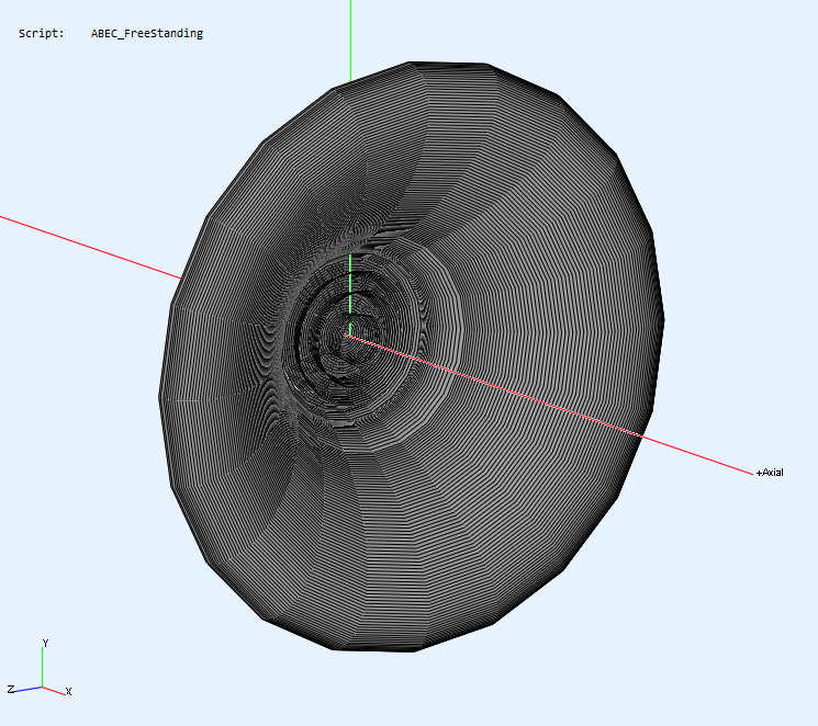

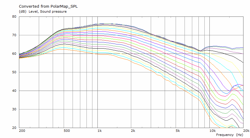

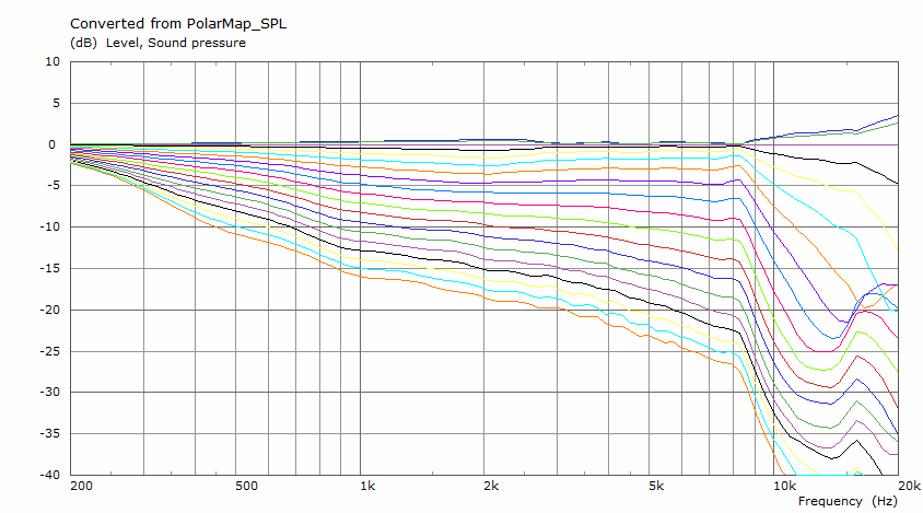

- This is a BEM simulation of what is aragorus testing (driven with a flat wavefront). To me the question is how close can we get with a real implementation & construction. I don't see a fundamental theoretical problem - wouldn't it show already in the simulations?

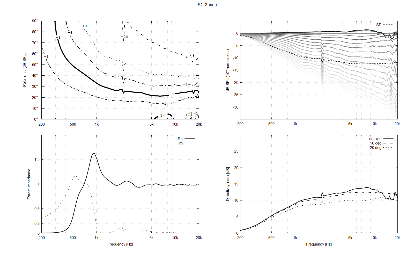

Here's the "standard" report. It's already a pretty complex model so it's not easy to get it all clean but if we reached that performance at least up to 12 kHz with a 2" throat, that would be just awesome. (The waveguide is still without any serious optimization.)
BTW, the 5-vane version could probably improve it further in the top octave.

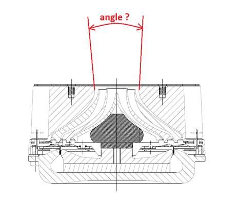

I would think that since the driver exit is 12 degrees, the wavefront isn't exactly flat... or am I wrong?

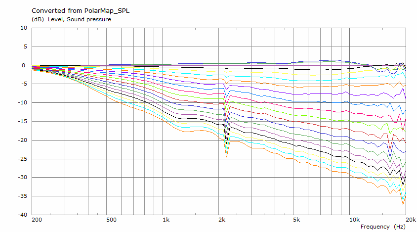

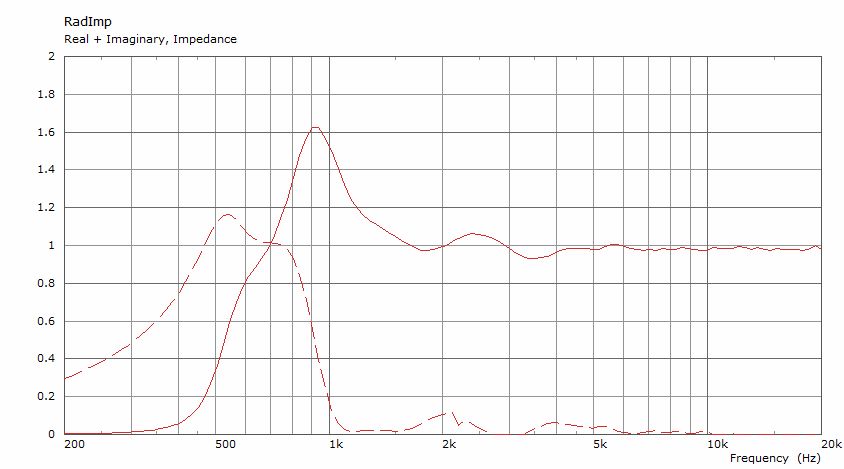

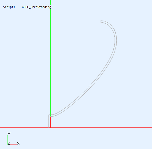

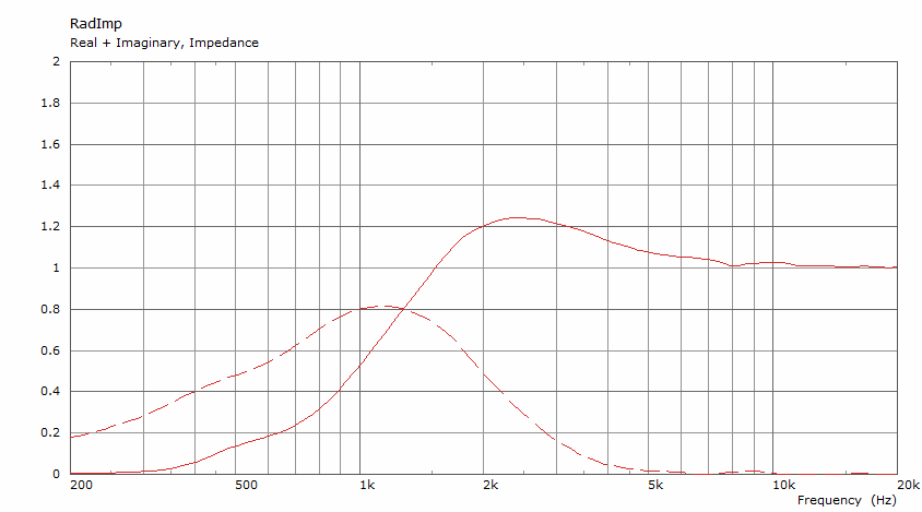

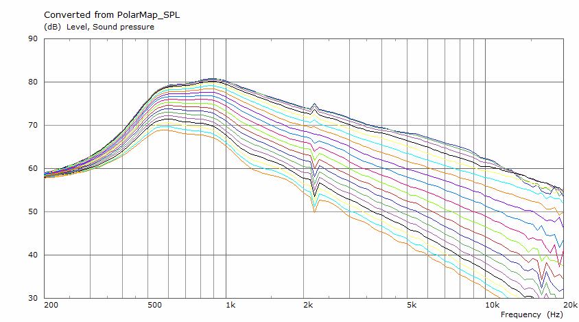

To put things into perspective, this is what happens if "the wavefront is allowed to expand as the physics say it should" - an OSWG with a 2" throat (ø486 x 150 mm).
Can we improve it above 8 kHz with the spherical wavefront plug? I believe we can.

I'm still not sure what's the best way to proceed in a case where there's a conical exit in the driver. A dampened straight tube directly from the exit of the phase-plug could be one solution.
