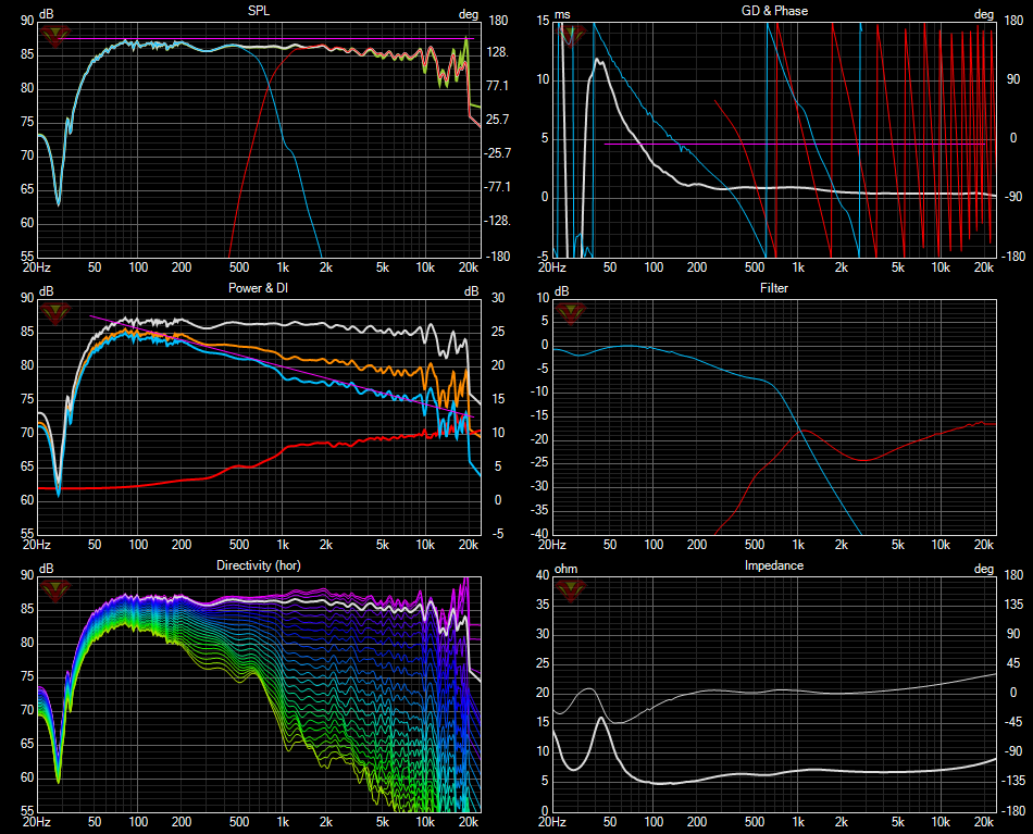

And this is an early simulation of Sandhorn + HF108 + DSA315-8 in the 74 liter enclosure with a passive radiator DSA315-PR.
This is not an ideal or the final, because it is based just on horizontal measurement of drivers and also there are visible resonance of cables inside enclosure, and reflections of the microphone stand in the measurements, but I'm posting this here just for an illustration how it could be...

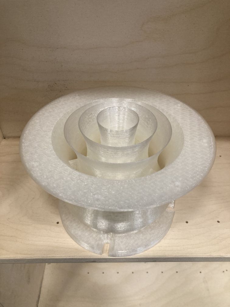

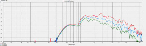

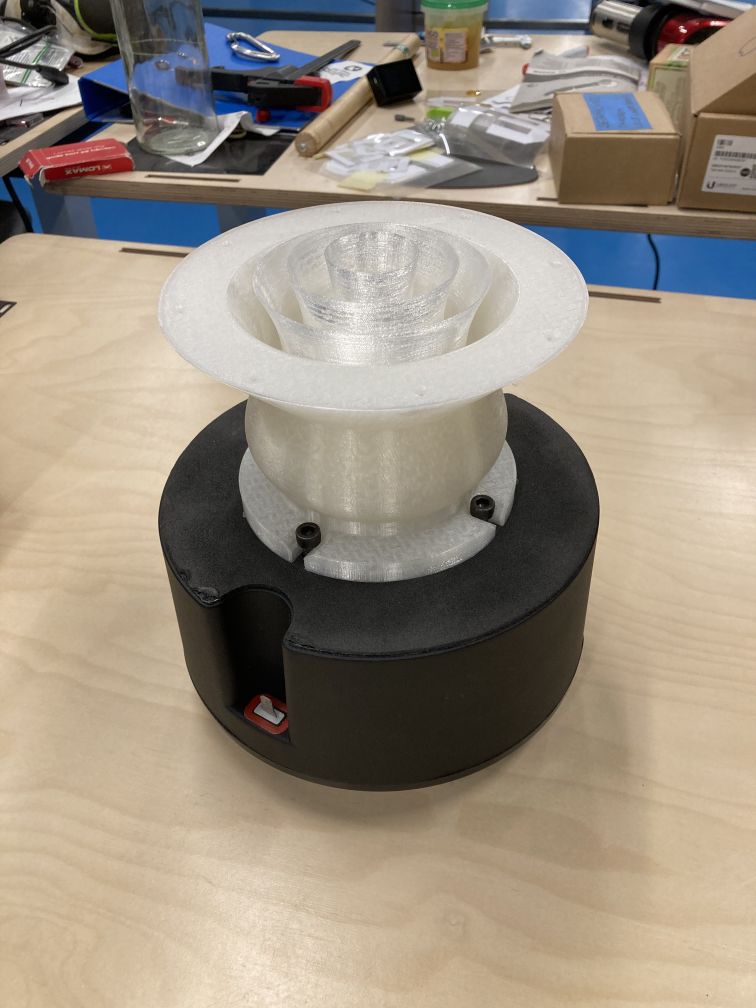

**Phase Plug Update**
So I have some good news and some bad news.
The good news is that the phase plug actually spreads the HF and improves loading.
Bad news is that it also introduces some peaks and dips. Especially on axis
Just the Plug - 0, 15, 30 degrees
The plug mounted on a horn 0, 15, 30 degrees

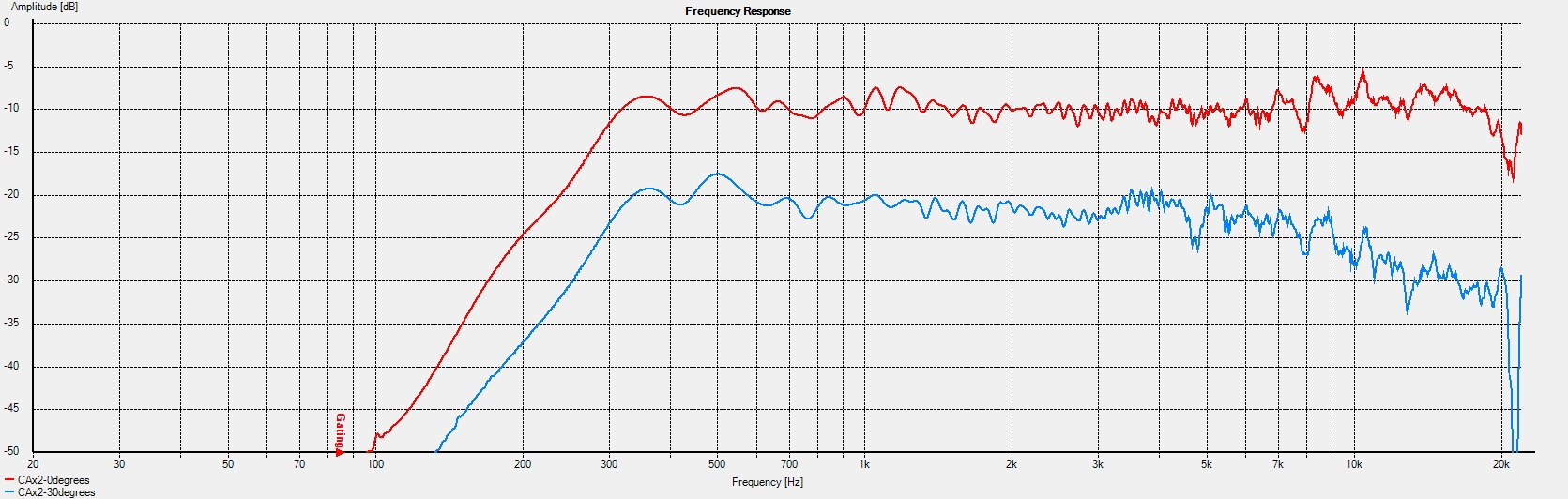

On axis comparison of the phaseplug-axi-symmetirc horn vs rectangular horn
0 and 30 degree plots of the rectangular horn
The measurements vary in level as they are taken in different days and I don't really have a standartized jig for measuring yet. However I think they still hold up for comparison purposes.

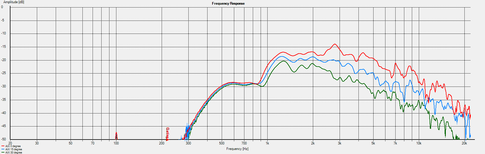

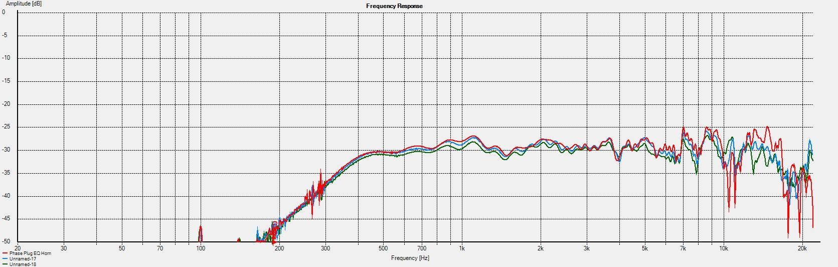

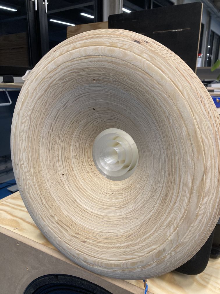

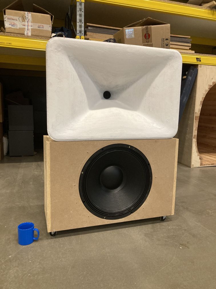

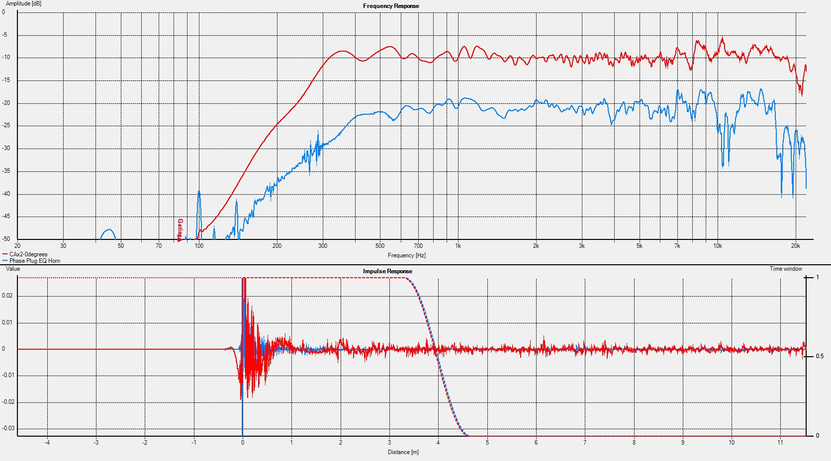

What is going on with the impulse response of the red trace, which combination is that?On axis comparison of the phaseplug-axi-symmetirc horn vs rectangular horn
Background noise. There is a 3d printer in the background and the room is very reverberant
Blue trace is the Phase Plug Concentric Horn
Red trace is the Rectangular horn
An additional thing-
Only the first plot is a raw response of the driver and the plug.
In the other measurements, there is a basic, eq to flatten the "hump"
I'm talking about the number of reflections within 1ms in the red trace. That is not background noise, a printer or reverberation.Background noise. There is a 3d printer in the background and the room is very reverberant
BTW nice job on the plug print 🙂
It explains why it looked strange, but it makes no sense to me to to look at an impulse response in metres 🙂Oh, the impulse is measured in distance, in this case meters.
I hope that makes more sense
