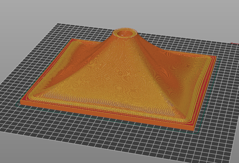

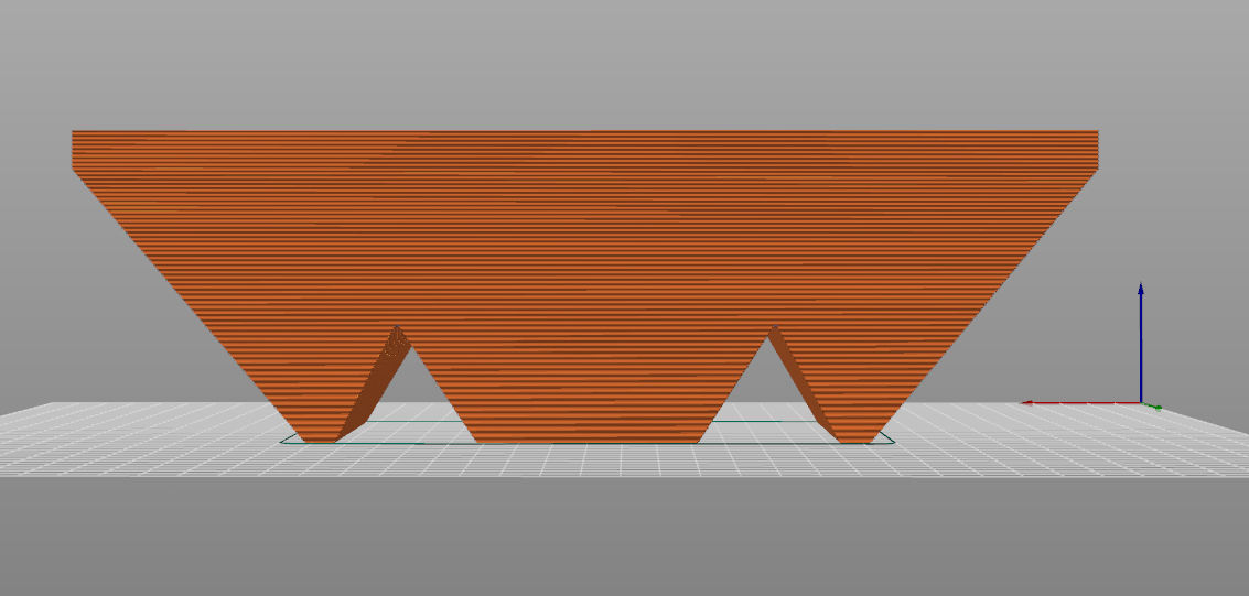

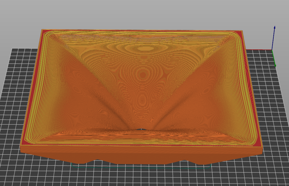

Tried to employ the "no overhangs" print method to a rectangular waveguide (280 x 242 x 90 mm) - on Chiron, at 0.8 mm nozzle/0.4 mm layer the estimate is ~20 hours, which is still acceptable. And this is not fully optimized yet, it could grow in something like fractal manner. I seriously consider giving it a try.

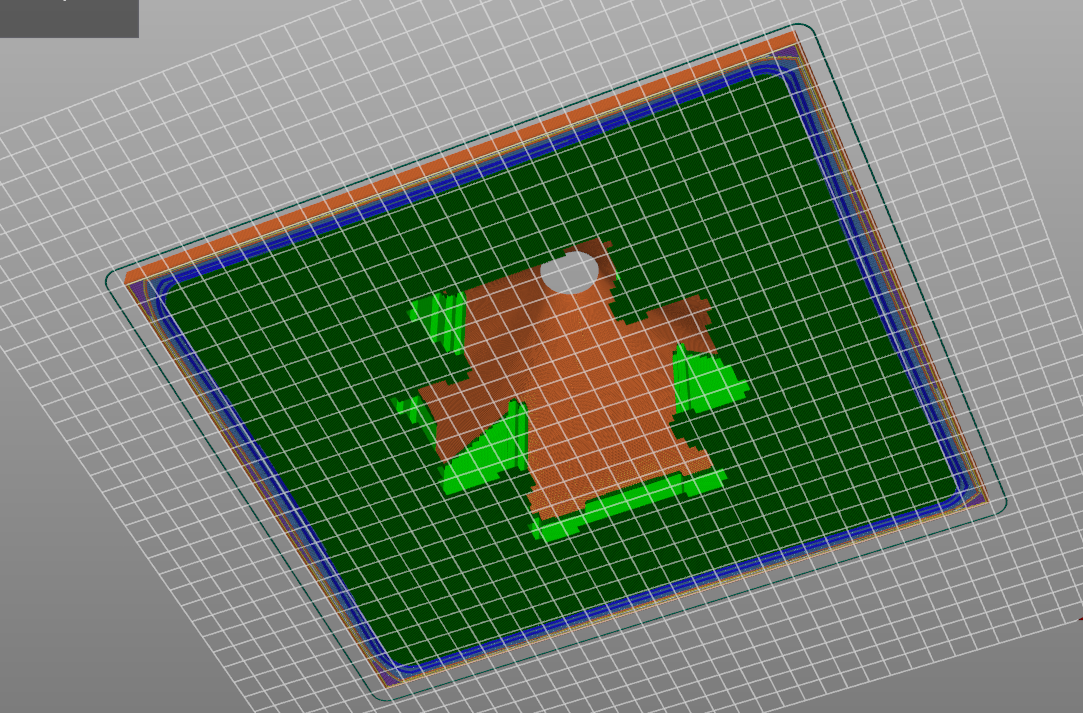

Joined 2004
Printing it face-down with supports, the time estimate is roughly the same and the waveguide body is much thiner. I guess it would be a nightmare to remove all of the supports (maybe not, I don't know, but my experience with supports hasn't been always good).

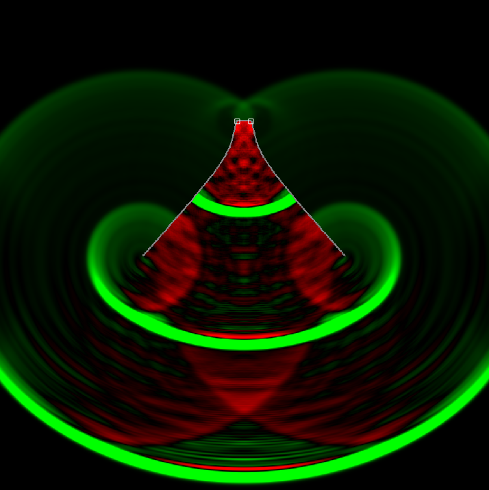

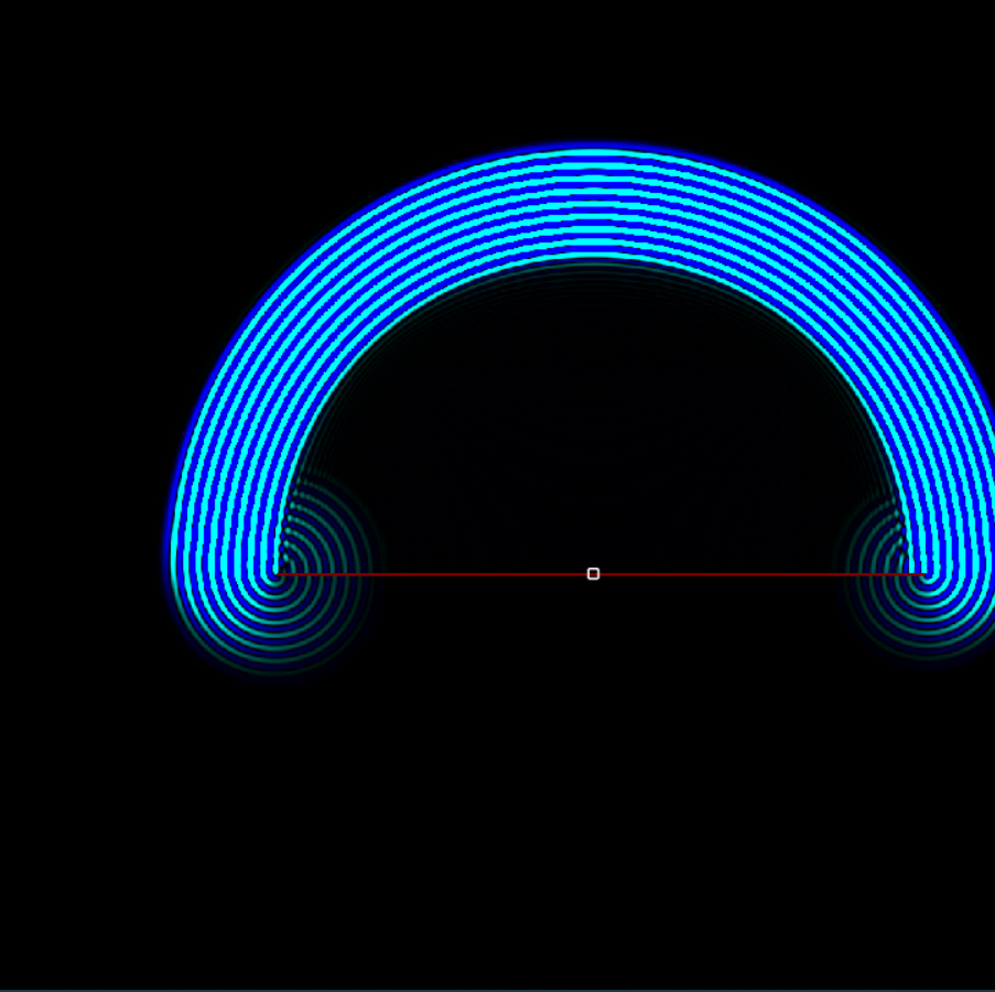

Joined 2004

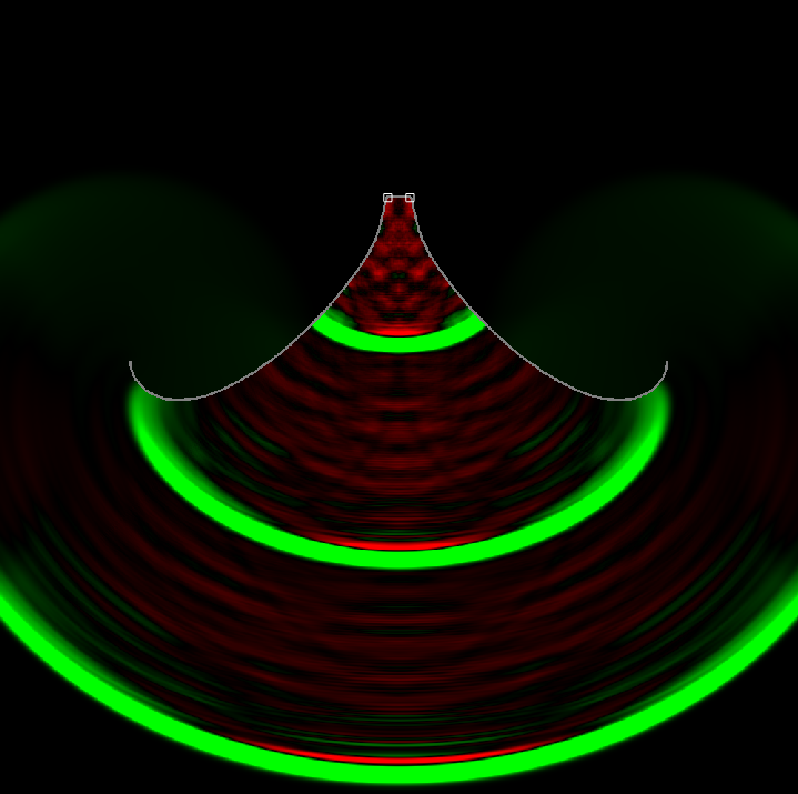

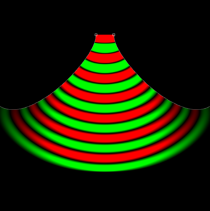

Oops, the above was for 30 kHz. This is more realistic, 10 kHz -
(It seems there's a slight reflection back when the wave leaves the screen area, so this clean wavefront pattern gets disturbed. I don't think it's correct but it's probably difficult to overcome this completely in a finite simulation, I don't know.)
Edit: Hmm, this can't be 10 kHz, based on the wavelengths shown. Is there a bug in the ripple tank?

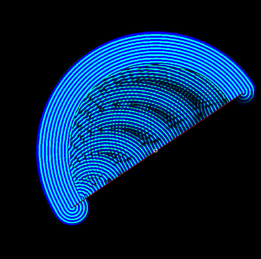

Rippletank has some problems, mainly it has limited resolution and reflection happens per pixel if you raise the brightness, try straight wall and packet source on it, brightness to full. All is fine, until you rotate the wall, now the wall is "pixelated" and million reflections emerge where in real world nothing changed (system was rotated).
Very fascinating but has its limits :) Asked mr Falstadt about it and seemed he has no interest do something about it. The source is available on github and found some other similar WebGL based sources by Googling. Tried to learn it for few hours but the shader programming was something I didn't want to dive into so left it.

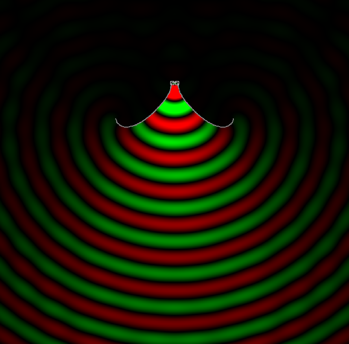

Yeah Paul Falstad. Here illustration what I was trying to convey.
Anything but straight line and there is extra reflections happening. Anyway, it is nice to see diffraction and stuff visualized. I tried to study baffle (and enclosure) diffraction stuff with it. The UI is nightmare but luckily the elements can be generated by custom code / UI :)

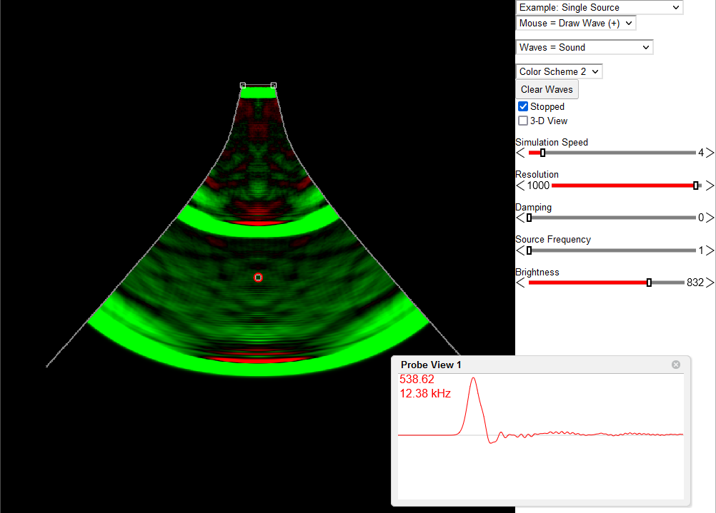

- It's raining outside again and I'm lazy to do complex math today, so I at least implemented export in the Falstad's ripple tank format. This might by fun. Here's the sandhorn -

No, actually I have never used Hornresp. Well it took me about half an hour to learn the ripple tank definition format and to code the export function into Ath - I'm pretty self-sufficient :)
- So can Hornresp show internal HOMs clearly when driven with a single pulse? That would be something. Falstad's ripple tank doesn't seem to be reliable enough, as tmuikku demonstrated.
