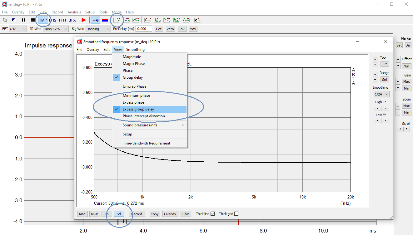

Well, Your Excess Group Delay is simply Group Delay then. Why call it something else?
For a minimum phase system (and the excess group delay is the way how to check that) this is simply an equivalent of its magnitude response. And of course correctable by EQ, all at once. We are talking about a waveguide alone, not a whole mutli-driver system with a crossover, which of course is almost never minimum phase. But then again, common crossovers with their all-pass behaviour are hardly a problem per se, regarding the GD. The Revel Salon 2, for example, is a four-way with 24 dB/oct filters and people don't have any problem listening to it (how many degrees of phase rotation across the audible band that represents?).

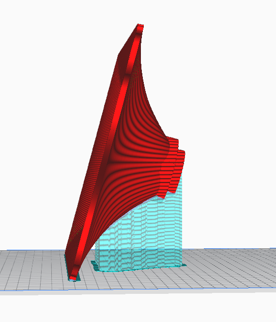

Preparing for my first big print on Chiron (1" version of Tritonia waveguide), wish me luck 🙂

Good luck, how long is the print?Preparing for my first big print on Chiron (1" version of Tritonia waveguide), wish me luck 🙂

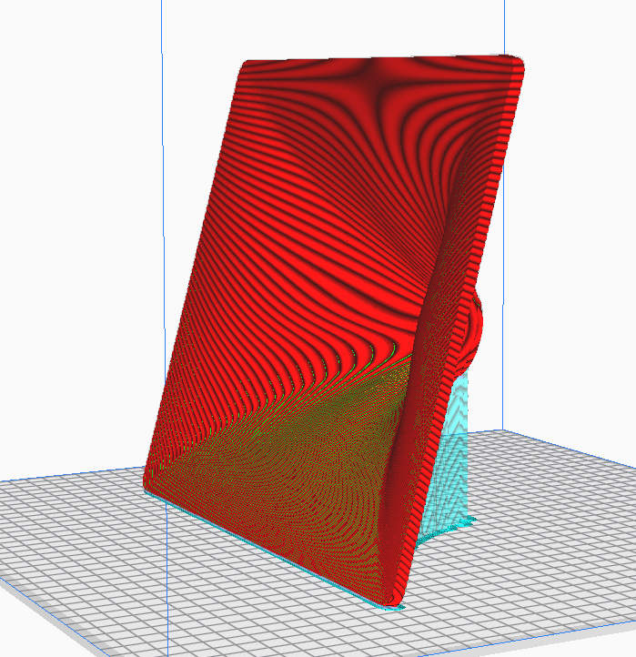

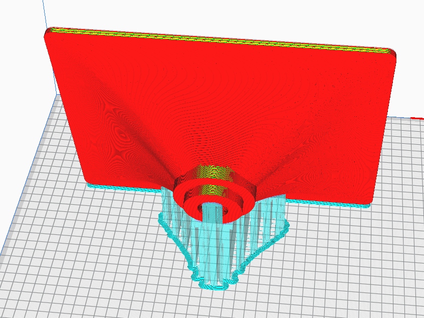

I wonder what the advantages are of this placement vs mouth facing down?
Around 9 hours, IIRC, but first I have to change the nozzle to 0.8 mm.
With mouth facing down it would virtually lay on supports, that would be a nightmare. This is probably the most efficient way of printing it in one piece, with only minimal support necessary.

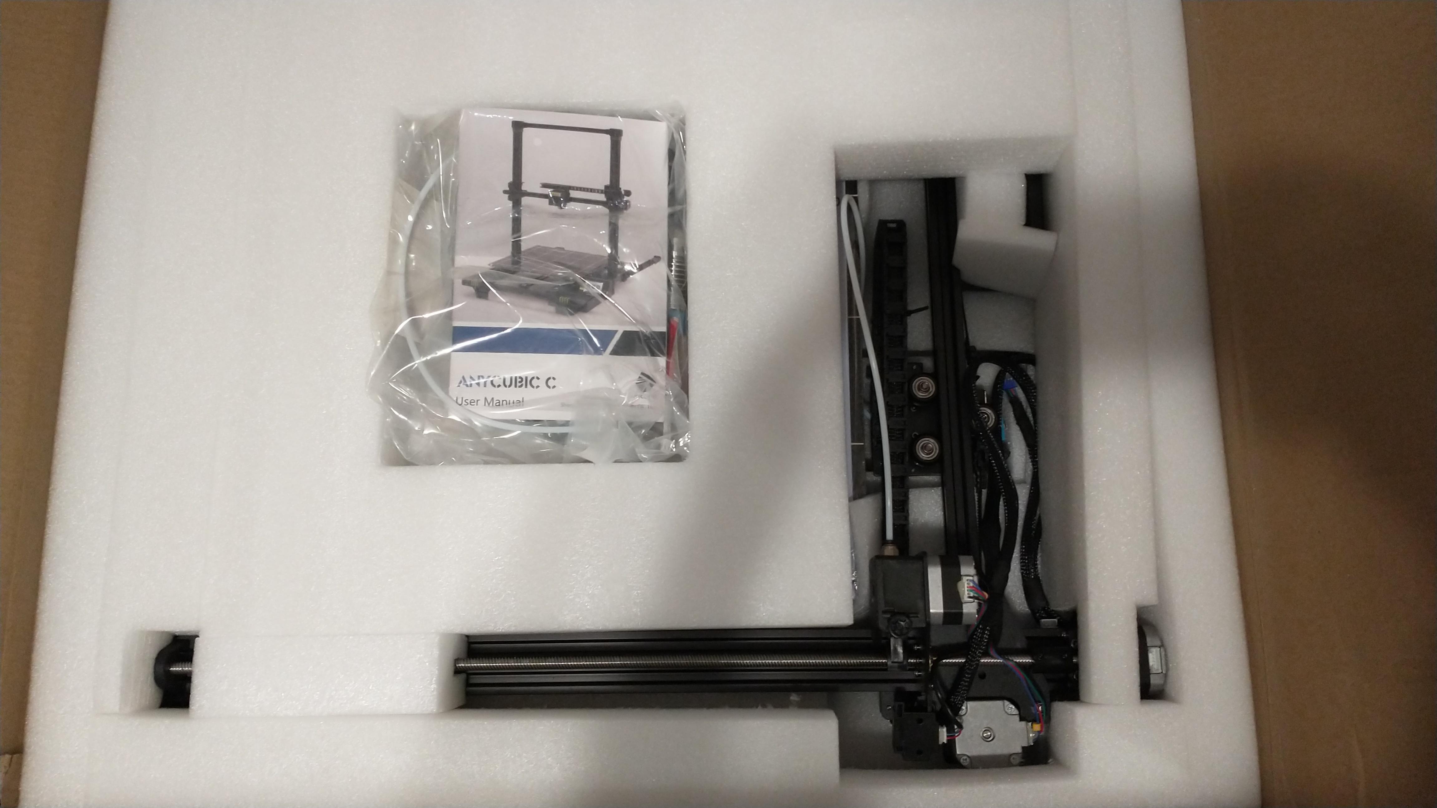

Just got my chiron this morning and unboxing now. Can't wait to print a full tritonia.
How do you like your chiron prints?

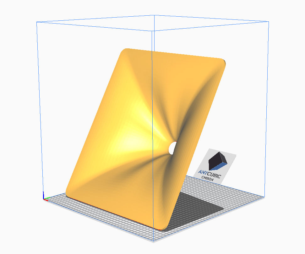

I'm just setting it up now, this thing is huge lol
Might take me a few days to tweak/level this beast and print a full size ATH horn...
The whole original Tritonia (422 x 364 mm) could be printed on Chiron -
