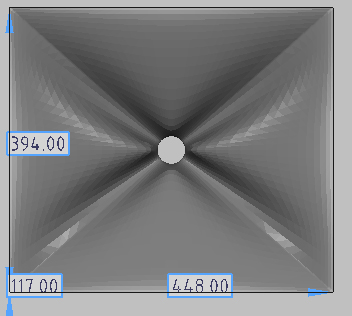

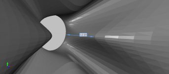

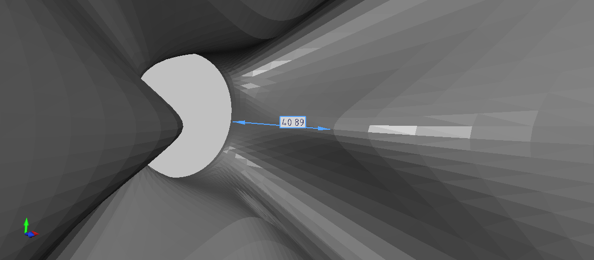

Yes, thank you very much for that, my corners are also much better now. This time I have forced the M2 dimensions along with a 38mm throat and 40mm knuckles, to the best of my abilities. The superformula butterfly shape doesn't seem to be very forgiving. It was a good exercise though.
After getting to know more about the M2 horn and its trickery, I am beginning to think that the 2352 is a much better choice, considering its depth and loading abilities. Afterall, the M2 horn is just a 40mm tube followed by a rather shallow profile, that maybe alright for use above 1.5kHz or so. I also feel that it may be possible to smooth out the 2352 flare rate around its "already not very intrusive diffraction slot", without losing much.

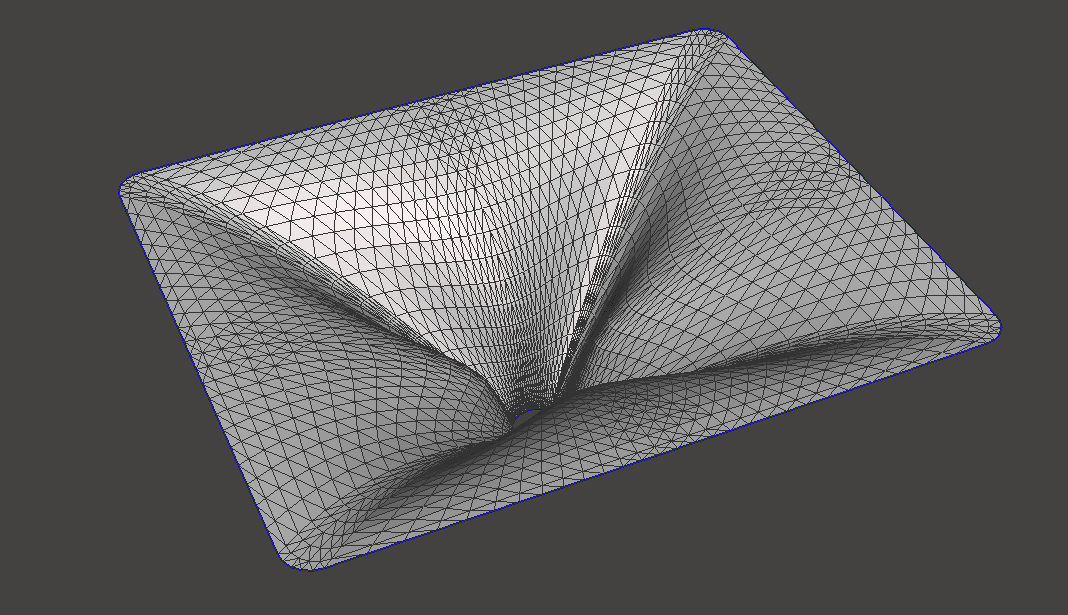

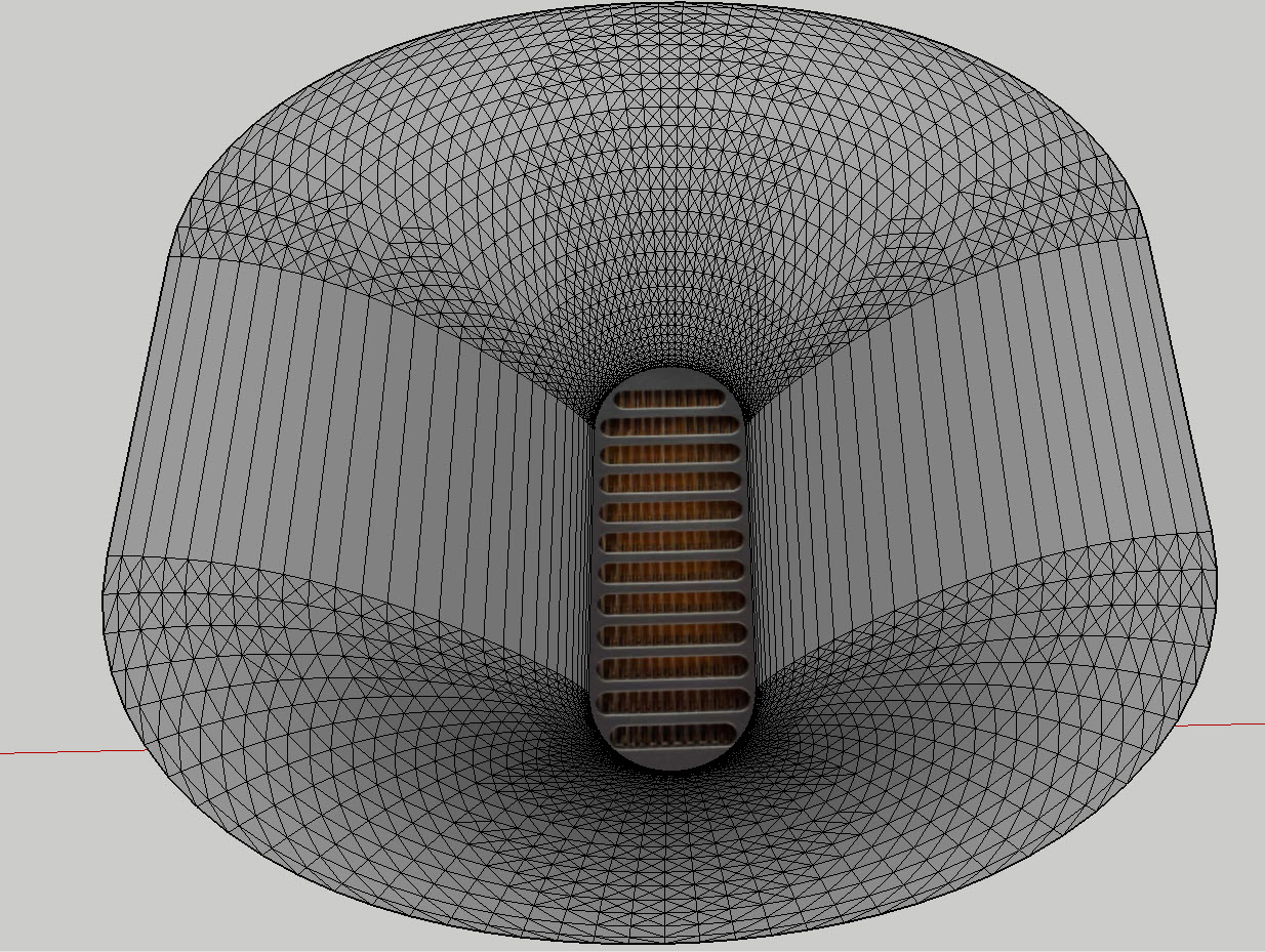

Horn for AMT with ath4
I am trying to create a horn for Mundorf AMT25CS2.1-R with ath4.
Therefor I will set the throat size to 34mm, because that´s the diagraph width of the AMT. Then I will just cut the exported STL in the middle, and move it away by the diagraph length and just connect the two horn segments with each other (see attached sketchup-screenshot).
To simulate the horizontal dispersion. Can I assume that a round 34mm driver will do the same as a long vertical diagraph which is also 34mm wide (like this AMT)? If only the diagraph width matters it should be or?
For sure the vertical dispersion cannot bet simulated because of the complete differnt diagraph length. In this case which exit angle you would use for generating the contour? Physically it should be "0" but as I have seen on most AMT horns/waveguides they already starting at a angle of about 30 degrees and up.
Would be cool to get some suggestions how to proceed here.

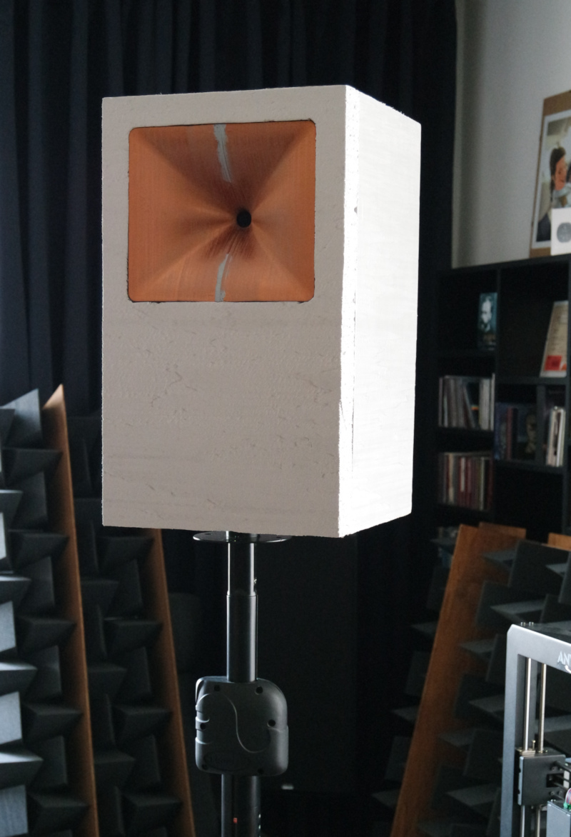

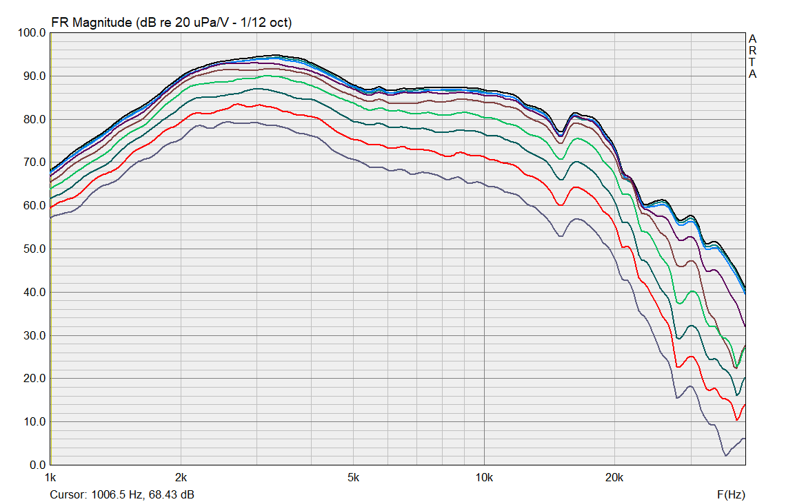

First quick measurement of the Tritonia model (~1:2 with B&C DE7, 0 - 90 deg) - horizontal polars:
attachment.php
I will measure all the polars properly and then try to round the edges. There seems not much to improve so I'm curious what will be the difference.

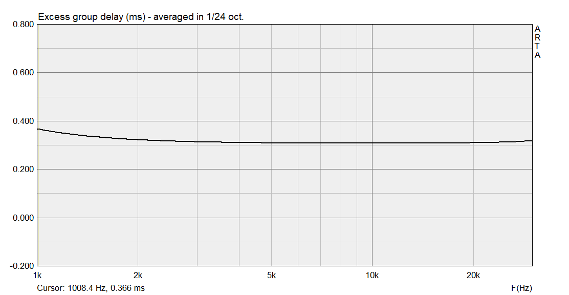

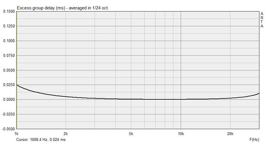

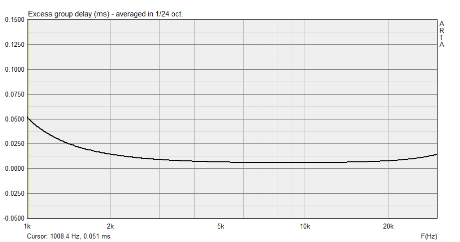

Measured excess group delay at some arbitrary off-axis angle 🙂
That doesn't look right to me, basically because it is still above 0.0, meaning that there is still an excess of delay of about .3 ms.

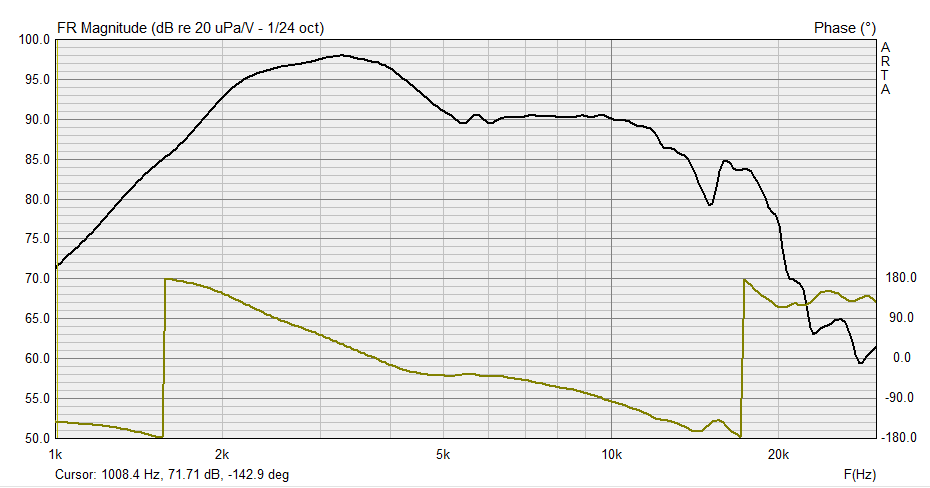

Could you post the frequency response that this corresponds to? If this is a near "ideal" device then maybe this is what I would expect. Now, what does a non-ideal device look like?

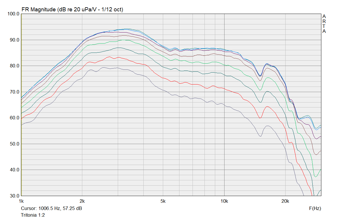

Yes, there's still some uncompensated propagation delay, I just arbitrarily chose the FFT window beginning. Here it is better compensated (may require sub-sample precision to compensate perfectly - probably also possible with ARTA, I'm just re-learning the program).
Frequency response:
attachment.php

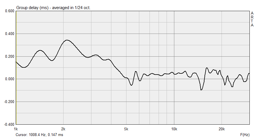

Group delay:
attachment.php
Excess group delay:
attachment.php
(I believe the rise on the sides is due to the minimum phase extraction.)
