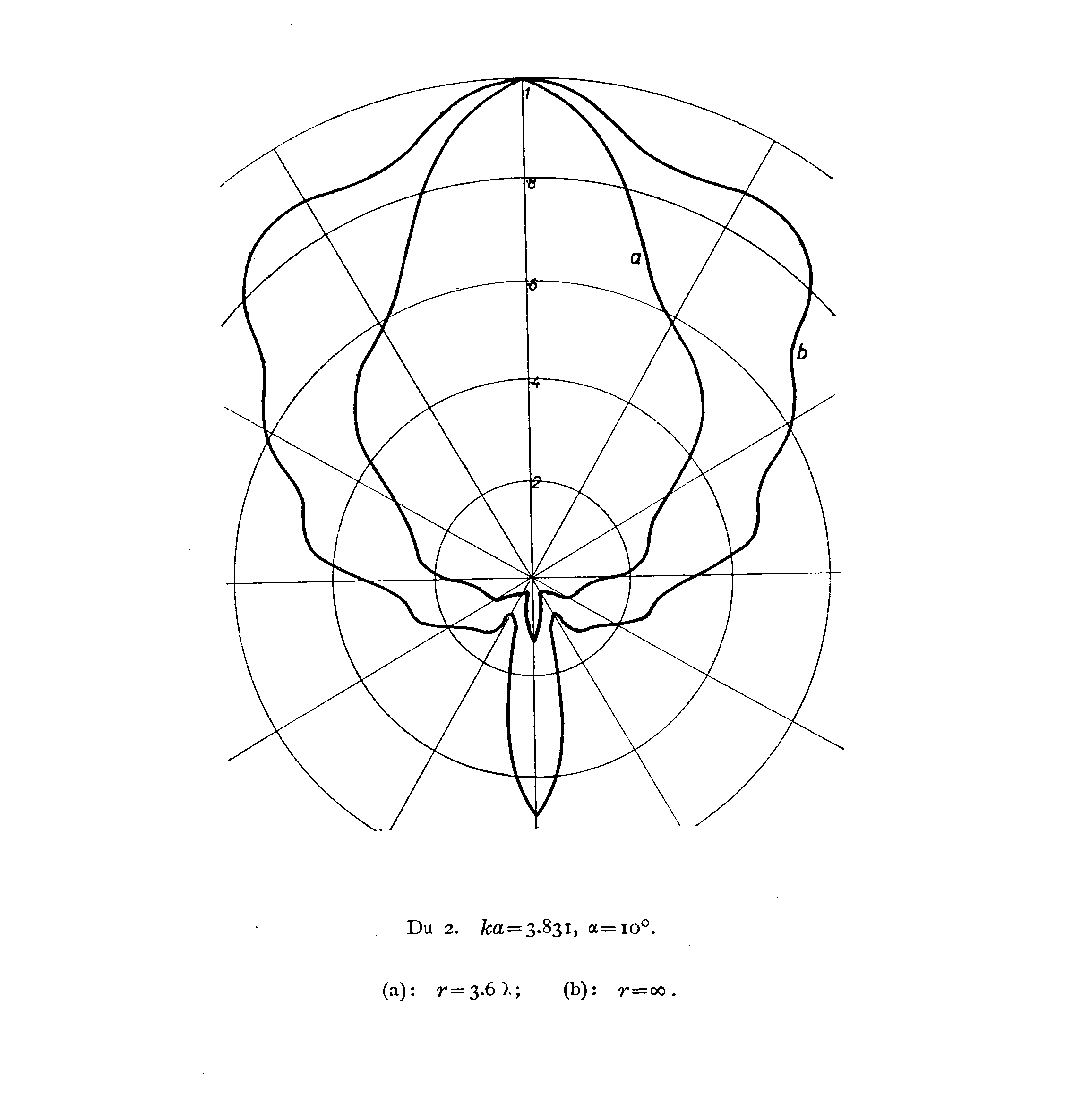

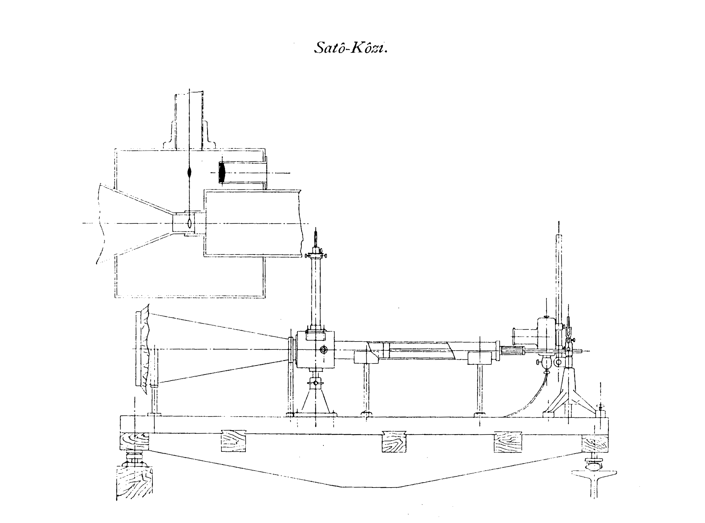

You seem to be knowledgeable and you're probably familiar with the research that has been done on the subject.
As B. Kolbrek puts it:
"Higher order modes describes the deviation from simple wave propagation in horns and sound fields in general. If the wave front in the horn is not plane, cylindrical or spherical, it can be described as a sum of mode functions. In one of my earlier blog posts, and also in the reports available under Horn Theory, I have discussed this in some more detail.
Since it appears that many believe that the existence of higher order modes in horns (often just called HOM) is a quite recent discovery."
Obviously, it's not. Kôzi Satô was the first to study the sound field of a conical horn as an expansion in spherical harmonics (modes in spherical coordinates) in 1929 (see attachments).
Makarski's "Tools for the Professional Development of Horn Loudspeakers" is probably the most comprehensive on the topic, according to Kolbrek.
Not hindered by a great lack of knowledge of fundamental physics, I have read all the studies mentioned by Kolbrek, and (many) more.
The problem with HOMs is their "nature": evanescent, frequency/pressure dependent, unavoidable etc., which not only makes them hard to quantify/model/predict, but - even more importantly, also makes it difficult to actually measure them, trace the sources and relate the results to observable (disruptive) phenomena.
In a recent study, Dong et al. concluded:
"Although the range of 8 to 16 kHz still falls into the design band and is below the cut-on frequency of the first axisymmetric higher-order mode of the waveguide (16:62 kHz), application of the measurement method in this range yielded a sudden increased reflection coefficient in a level much higher than in 2–8 kHz, which implies the propagation of the non-axisymmetric modes in the waveguide and the measurement method was therefore invalid. This may be caused by the defect of axisymmetry of the waveguide-horn system and excitation of non-axisymmetric modes by the compression driver."

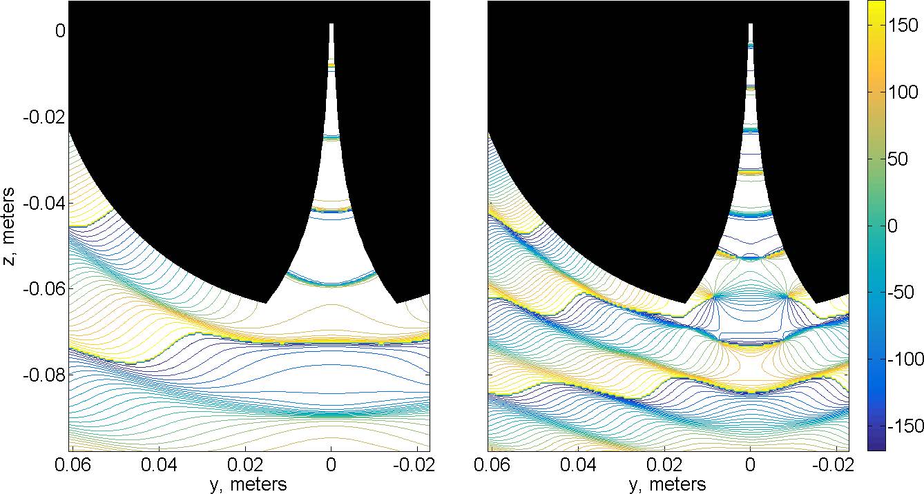

Regarding propagation of higher order modes in- and outside the (in this case exponential) horn:
"While an incident plane wave will excite higher order modes within the horn, these propagate towards the throat until the decreasing diameter raises the cutoff frequency and energy rejoins the fundamental mode."
Phase contours of the scattered pressure (degrees) in response to an on-axis source at 10.6 kHz (left panel) and 17.7 kHz (right panel):

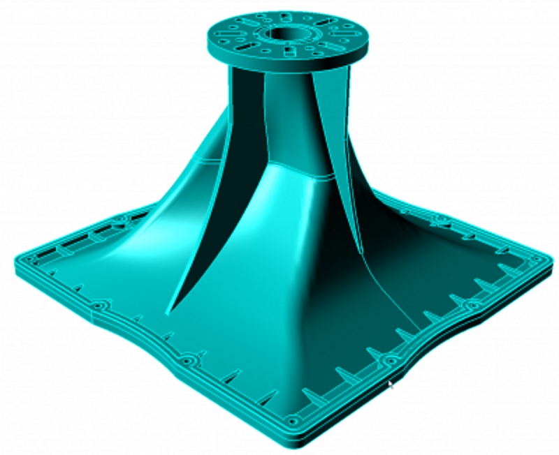

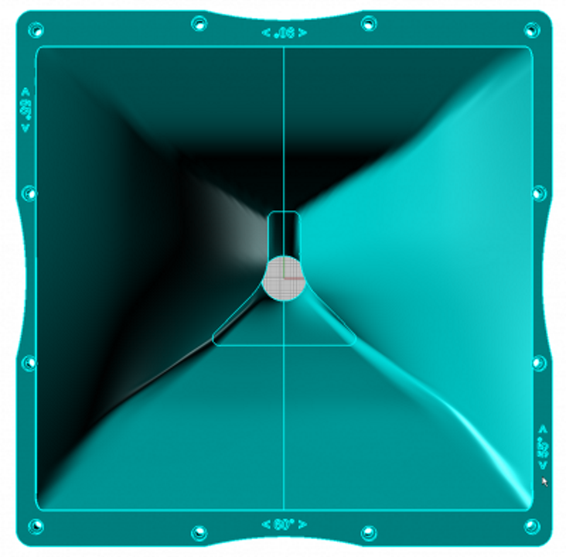

That's the same question as "If the sound reinforcement systems sounded bad, would anyone use them?"If HOMs caused by strictures / slots were unacceptable, would Makarski design such a horn?
- But you seem to hint that the answer is no. Why would you think so?
It's more of a matter of historically charged public opinion and misconceptions about modern horn technology, its implementation versus the variation in product quality of commercial Pro Audio.

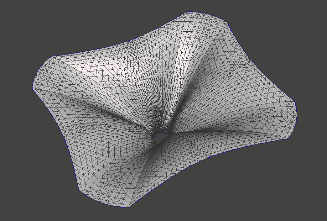

M2 clone - just got there

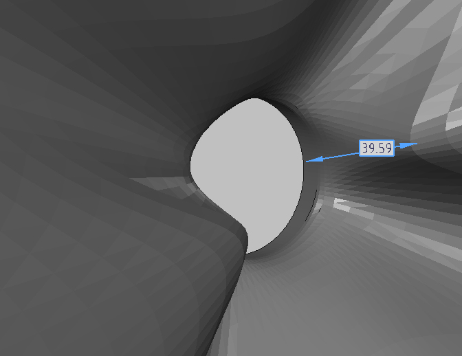

Managed to obtain the W20" x H18" x D4.5" dimensions. My parameters were
Throat.dimension = 38
Coverage.angle = 60
Depth = 108
Guide.curve.width = 68
Guide.curve.Distance = 0.5
Throat.extension = 6
Expand.rate = 1.5
The above results in a 40mm position for the knuckles that has been confirmed by sebackman on audioheritage.

Although the M2 horn looks slightly chubbier than the ATH clones (from photographs), the latter method is nevertheless very close, thanks to Mr Marcel (mabat) for sharing such a nice piece of computer software. The guide curve concept may also be used to approximate other curved wall waveguides besides that of the M2, such as the 2374 / 84, PTs, CMCD midhorns etc.

"A matter of personal preference", I guess.Why is the waveguide not flush with the body? 😕
I got the same effect of clipped corners when I tried to make a more highly asymmetric waveguide recently when someone was asking for one.I've just realized the morph feature doesn't work properly in 4.7 for some reason. I'll look at that, it is a long time since I tried this.
