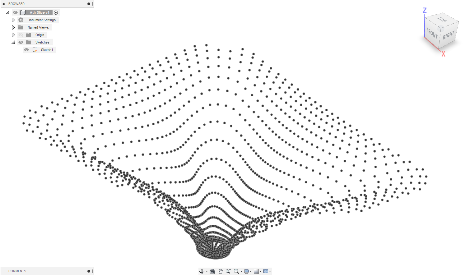

A Brep surface made from a mesh will have too many facets, you have more luck trying to thicken a regular surface. Can you create that guide using Grid Export or is it an STL you got from somewhere?
The only option I found if you only have a mesh is to use the Brep surface to cut a solid block then use solid modelling tools on the block to make the back however you want it.
I attached a guide describing what I did in this post before mabat released the Fusion scripts.
Acoustic Horn Design – The Easy Way (Ath4)
You need to create ("loft") the surface from splines imported via the Add-ins included in the Ath package. It doesn't work with STLs, I suppose.
This may be tricky sometimes.
Thanks, playing with ATH grid exported slices and profiles with Fluid's guide, see if I can figure it out...
In Fusion this is done via the "Ath4_SurfaceImport" add-in (open the exported slices). Or you can import only the slices by "Ath4_CurvesImport" and create the surface by the loft feature manually afterwards, which may be the more robust way how to do it. It's a long time since I did this.

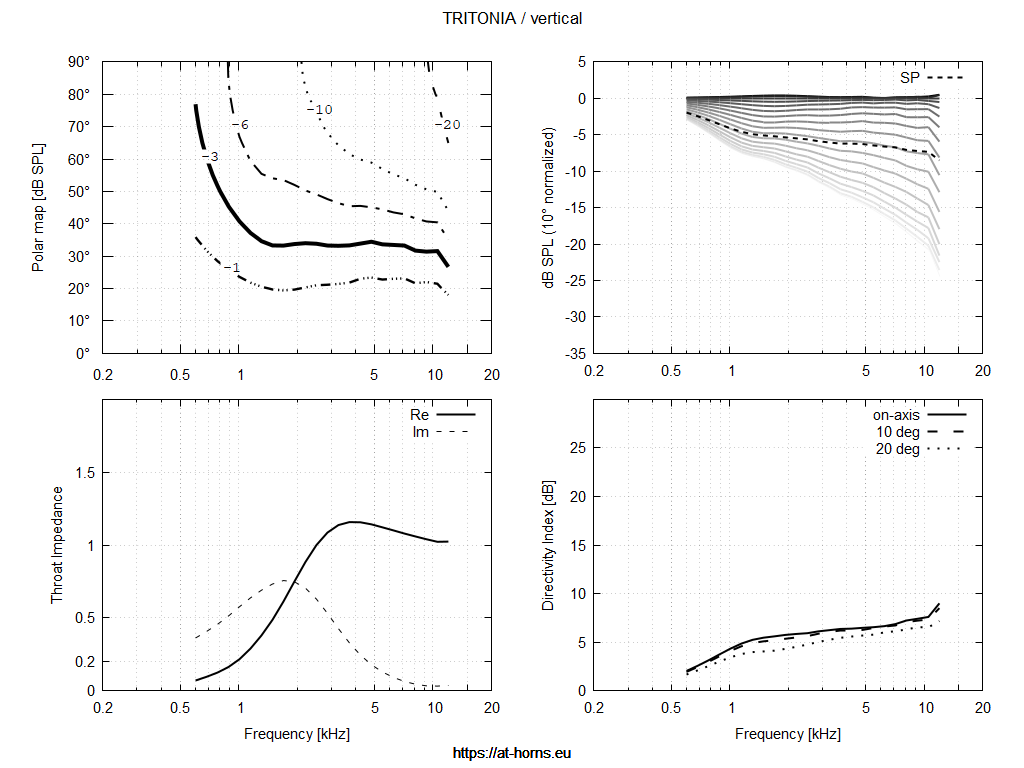

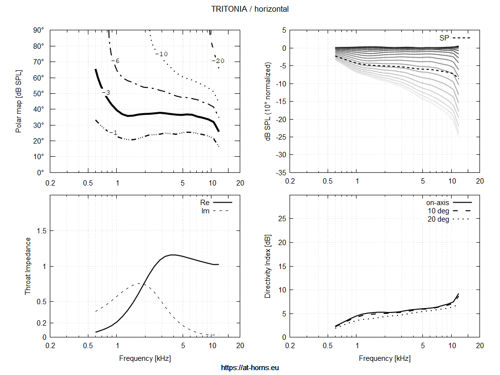

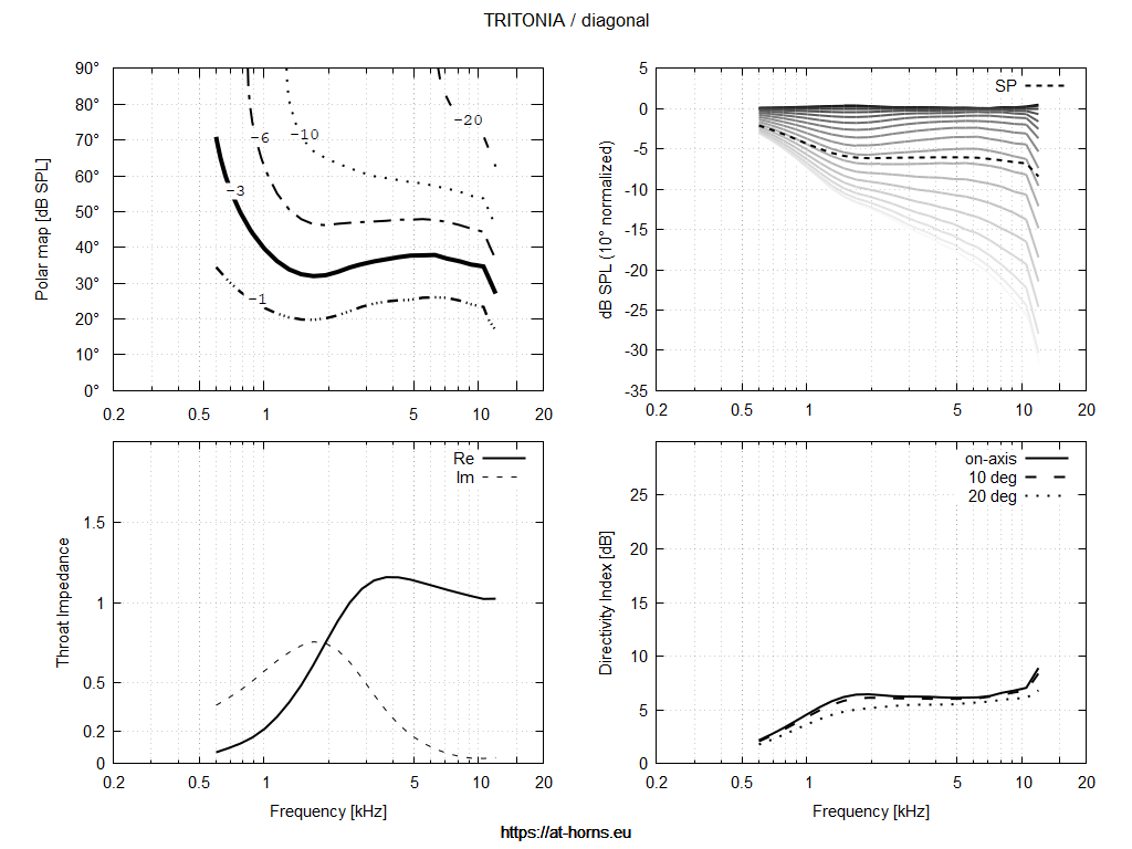

BTW, the reporting functionality so far assumes axial symmetry. Here are reports for the Tritonia waveguide, H, V and D planes separately (as if it was axisymmetric), half-space. Now I have to implement such report for a general non-axisymmetrc shape, composing the calculation of the total radiated sound power of more points on the (hemi)sphere - the more dense the spatial sampling the better.
Still scratching my head on this one.
Which is best to work on profile or slices?
I've imported into fusion and tried lofting, no luck yet...
Just want to loft then thicken. cant figure it out. spent a day on it figuring it out lol
The script Marcel made does it automatically and you end up with a body.
I personally make a solid object aligned with the mouth and use the "shell" body to cut the solid object into two.
Then work the back to make the object printable 🙂
You can also manually loft between every horizontal slice. (The second picture)
