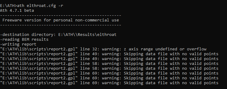

Beta version of Ath 4.7.1, including a demo: https://at-horns.eu/release/elthroat+Ath-4.7.1beta.zip
Thanks Marcel!
If you read from this post down it might help work out the problem, the graphs need to have the correct label for the report to find the data.

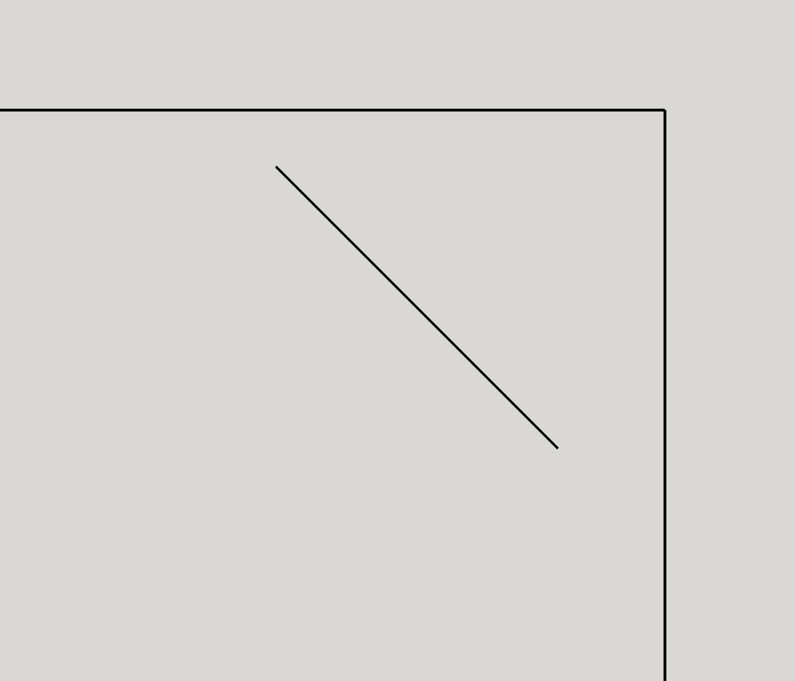

I've all but settled on a 24" round freestanding waveguide, a larger version of the sand horn. It will need to be in the corner of the room such that one edge will be 4 - 6 inches from the front wall, and the other will be 6 - 8 inches from the side wall. Is this such a problem that I'm better off going for a smaller WG that has more space from the walls?

Adding a GraphHeader worked. Thanks Fluid

I wouldn't go smaller, in that situation I'd go as large as possible.Is this such a problem that I'm better off going for a smaller WG that has more space from the walls?
