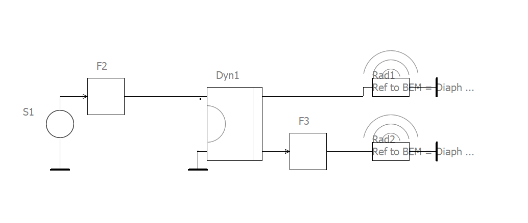

AFAIK, the easiest way to do this is to leverage the LEM aspect of AKABAK. The "Elec-Dyn Driver" has two outputs, one for the front of the driver, and one for the back. You the attach these outputs to two BEM radiator elements, one configured as a front of the driver, one as the back.
The magic however is, now that you have separated front and back of the same driver in LEM, you can independently process the front and back of the driver. Which means, you can low pass just the back wave as if you had put in damping material for the same effect.
Because you now have a back and front BEM element as well, you can also do things like simulate delay or dB loss to dial the ideal settings for achieving a cardioid-like pattern.
I can't confirm if the simulations match real world since its all in software right now, but I have successfully create a super-cardioid simulation using the same logic in the Meyer, Fulcrum, and Dutch patents.
I could also be dead wrong lol 😀

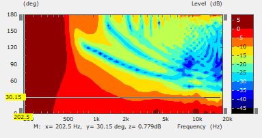

Are there "good" examples of purely passive cardioids?
Well I have the real XPS model (I say "model" because it is in 1:2 scale). I won't simulate it - "cut and try" it what I'm gonna do.
I found an old post where I tried that even without the rollback: #2647
That looked quite nice but now I'm not sure about its validity and will check that now that I have printed them.
Thanks that looks pretty smooth. I'm experimenting with Tritonia variant now, just waiting for my 400x400mm printer. Should have something to show/measure in a week...

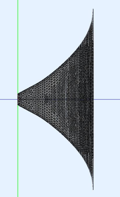

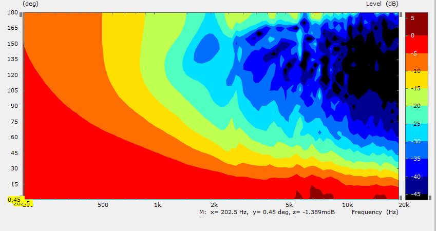

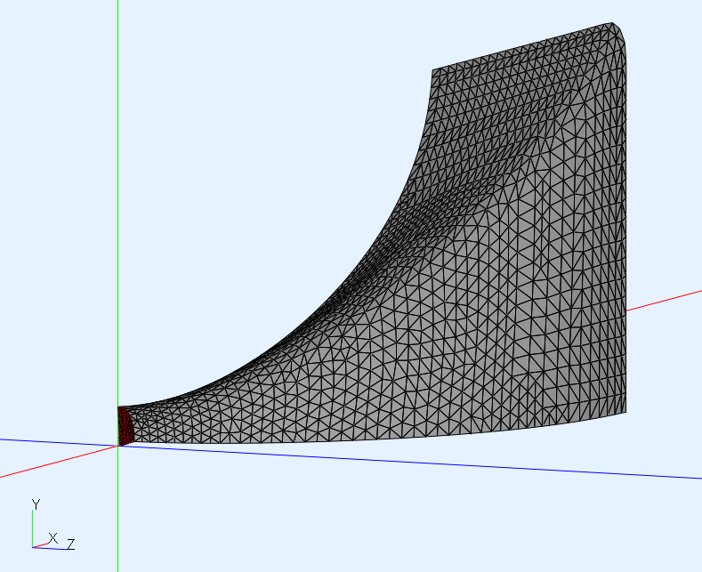

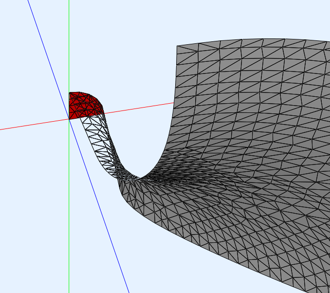

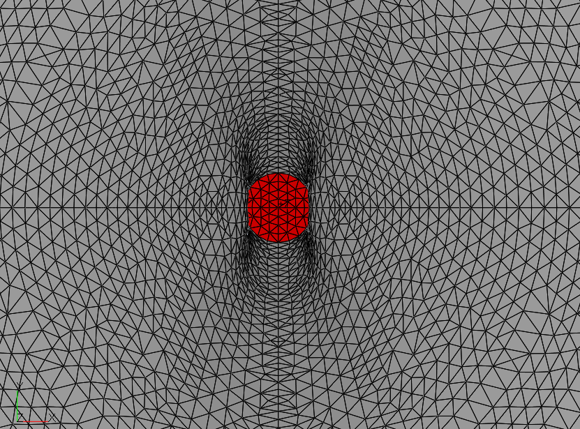

So I noticed that when I generate a horn with ATH and assign the type of simulation to be Freestanding - it still creates subdomains - interior and exterior and the interface in between.
If the horn has a Rollback, the interface happens to intercept both the horn mouth as well as the rollback and back as in the picture.
I did a comparison simulating the project as it was and then put all horn elements in 1 external subdomain and removed the interior subdomain and interface.
With 2 subdomains:
Only Exterior subdomain:
I have only noticed now, and was wondering why doing a rollback almost always made my simulations introduce more ripple.
Wonder if it's me that's doing something wrong, or the interface shouldn't extend through the back...
With 2 subdomains:
See 6.7 (and 6.8.1) in the User Guide. You can adjust the interface(s) or simply disable it altogether (as you did) by "Mesh.SubdomainSlices=".
In the free standing conditions it's probably the most reliable to disable it and use only one exterior subdomain. Sometimes ABEC behaves in mysterious ways, I don't know why.

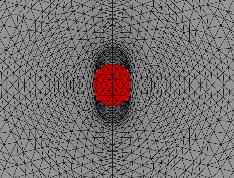

One more remark - in the CircSym mode don't hesitate to increase the "Mesh.LengthSegments". It doesn't cause solving time rise but can greatly increase the resolution of the mesh.

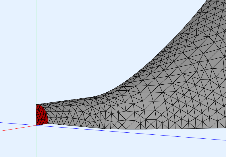

In terms of AKABAK/ABEC behaving mysteriously - The Interfaces are very picky with normals direction.
It took me ages to do the basic ported enclosure example. I just couldn't see pressure coming out of the port (as one would expect at the cabinet resonance)
Turned out my interfaces (Interior - Port and Port - Exterior) had the wrong direction.
I think that might be that the interface acting as a rigid boundary on it's back side...
Ok, so I tried disabling it using "Mesh.SubdomainSlices=0"
It still creates 2 subdomain and an interface.
This time the interface is located at the origin and has the same size as the source.
After editing the solving.txt file and manually deleting the subomain and interface it becomes "pretty" again.
My bad! Using
"Mesh.SubdomainSlices=" instead of "Mesh.SubdomainSlices=0" fixes it 😀

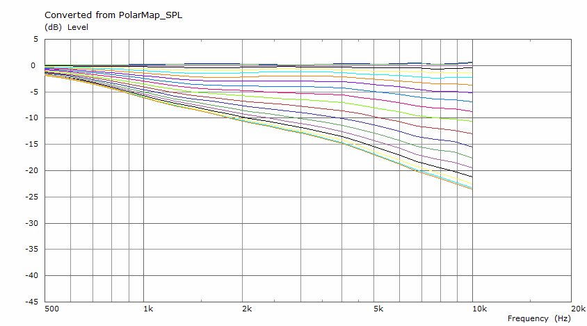

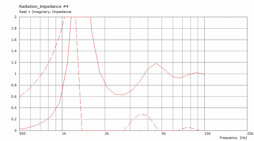

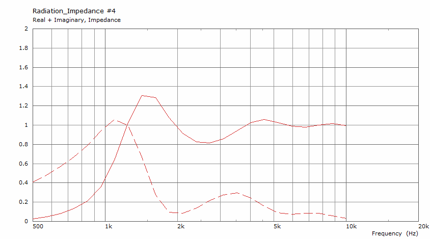

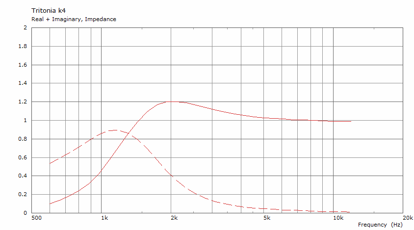

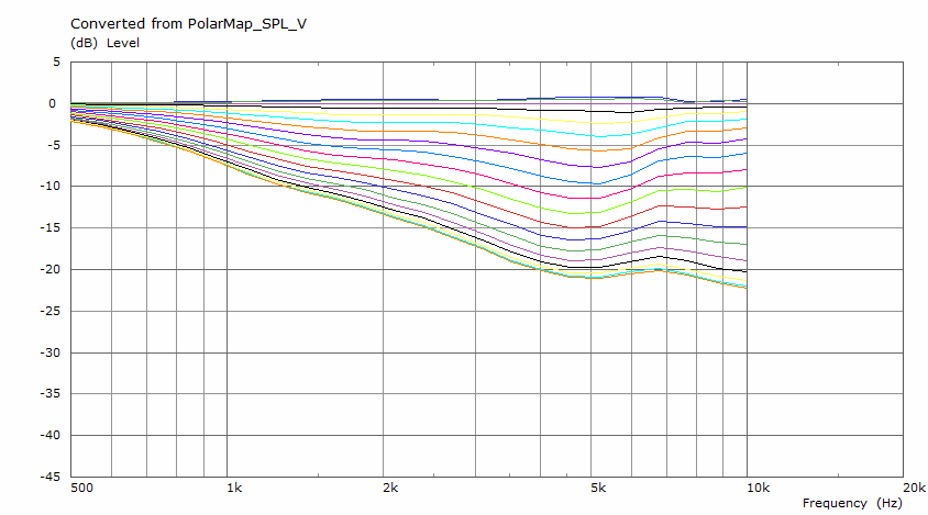

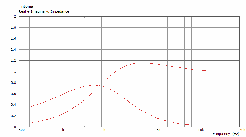

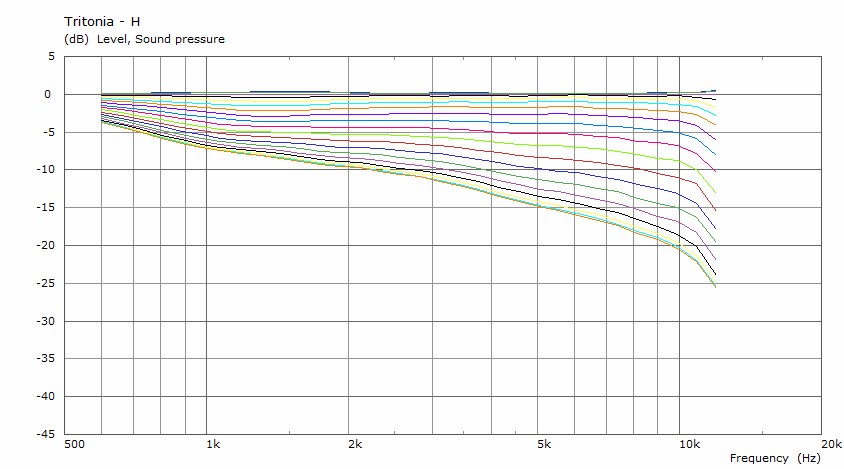

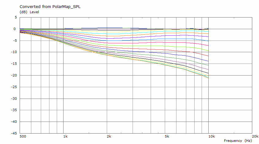

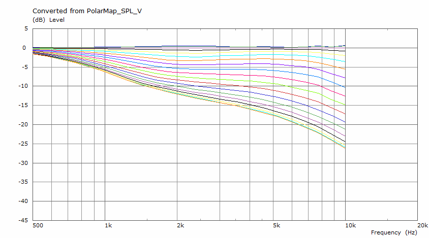

BTW, I tried to increase the 'k' parameter on the Tritonia waveguide -
This is the original (k=1) throat impedance and horizontal polars (10 deg normalized, 0-90/5) in infinite baffle:

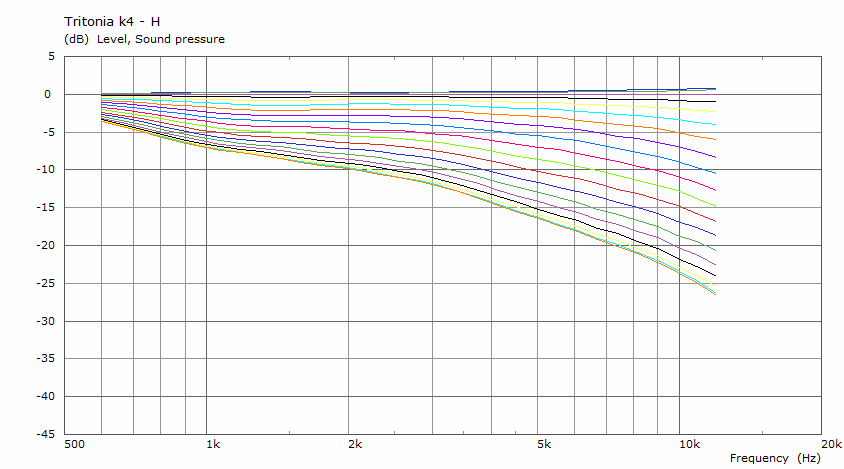

This is for k=4:
This is about what to expect when increasing the loading (still only a bit).
This is for k=4:

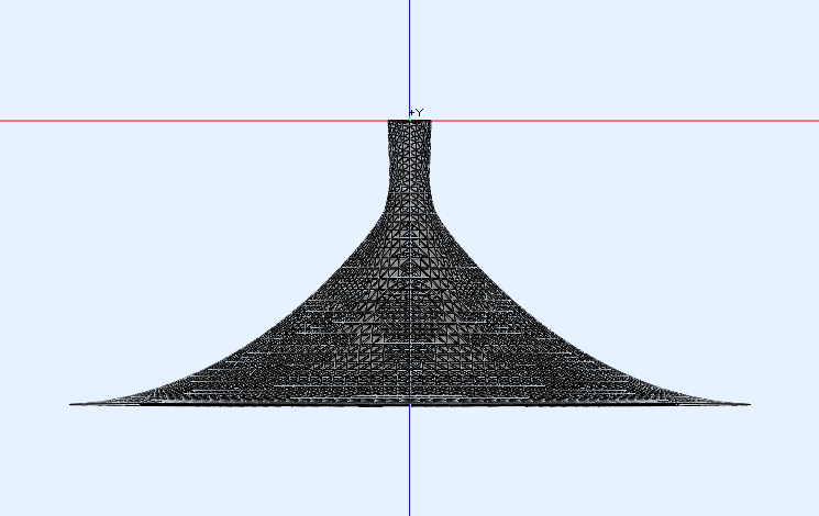

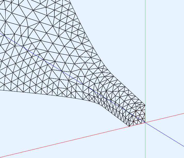

1" throat -> elliptical extension (available soon in Ath 4.7.1):
Throat.Diameter = 25.4
Throat.Angle = -5 + 15*sin(p)^2
Throat.Ext.Angle = -5 + 15*sin(p)^2
Throat.Ext.Length = 40
Beta version of Ath 4.7.1, including a demo: https://at-horns.eu/release/elthroat+Ath-4.7.1beta.zip

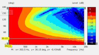

...more open vertically -
Throat.Angle = -2 + 30*sin(p)^4
Throat.Ext.Angle = -2 + 30*sin(p)^4
Throat.Ext.Included = 1
