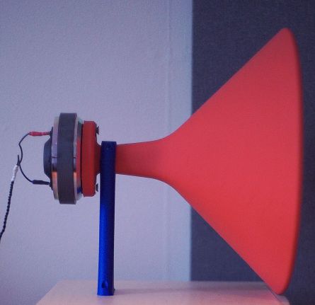

500Hz? That probably makes you the record holder 😉
I have never come across anyone who used a BMS 455.. so low, and definitely not with a shallow waveguide.
The red horn should load the driver extremely well. What is the length (throat to mouth)?
My 4554s didn't sound right < 700 Hz, even at low SPL. I changed one of the diaphragms, but it didn't make a difference.
Perhaps the throat size matters.
Once the walls are flat the length is irrelevant, so the only part that "loads" the driver any more than a typical OS waveguide is the first 1/4 or so...
Honestly I wouldn't expect very high loading - the more I'm curious to see the sims (and measurements of course).
Even though it doesn't look like there's an expo, or similar type of profile involved, the small cross-sectional area of the "extended throat" does restrict the passage of air and should present a fairly high acoustic impedance to the driver. It may therefore very well approach an exponential expansion rate.
Besides, there's a transition from round - at the entrance - to an ellipse, so there aren't any parallel sides.

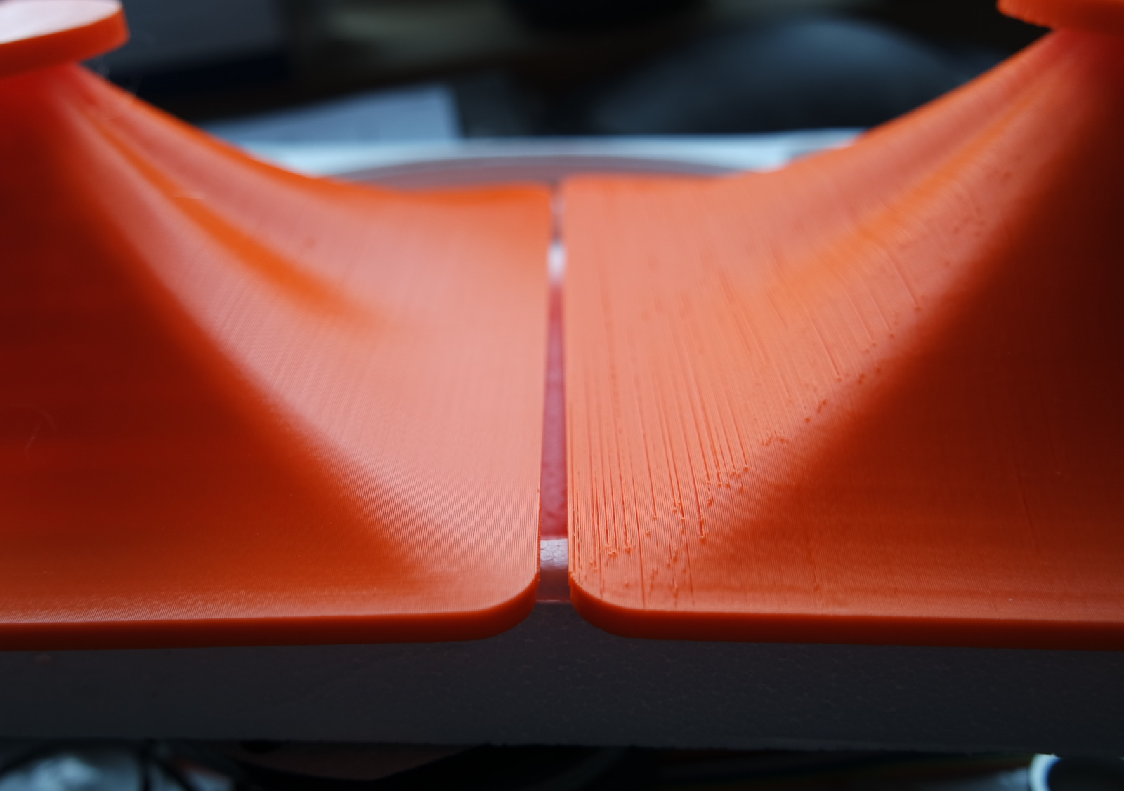

923551d1613586041-acoustic-horn-design-easy-ath4-horns1-jpg
Ro808, mind that the external contour is not identical to the internal.
The outside is just a 45 degree slope meant to ease my printer.

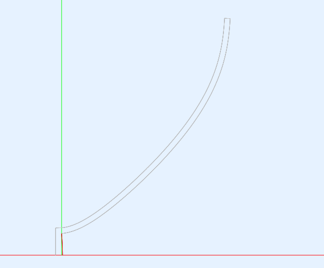

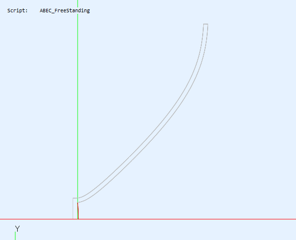

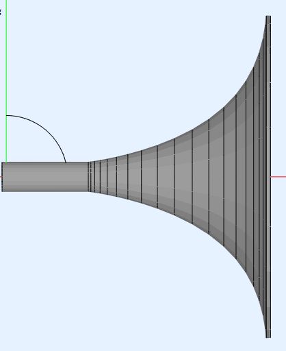

It seems like the newest version doesn't take the throat angle into account when extending the throat 🙁
It's exactly the first part of any horn that - to the utmost extent - determines loading characteristics.
I suspect the cutoff of aragorus' horn is at least twice as low as that of an OS waveguide of the same size as the mouth of the red horn
Plastic annular diaphragms in particular seem to be sensitive to loading.
...I suspect the cutoff of aragorus' horn is at least twice as low as that of an OS waveguide of the same size as the mouth of the red horn.
Again, size of the mouth doesn't affect throat impedance of an OS waveguide (20cm or 200cm, it will be the same for the same nominal coverage). The same holds for the conical throat extension used above - it's the angle that counts, not the length. The length will affect manifestation of the reflection that's gonna likely happen at the interface.

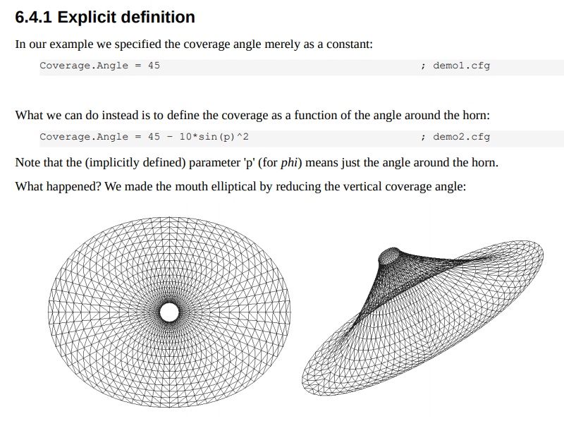

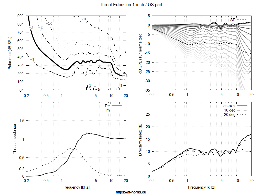

You are right. I changed the handling of this to easily and more intuitively model the conical extensions of the drivers, which are always circular. And now I see the parameter 'Throat.Ext.Angle' is taken as constant as well. I will allow this to be a function of 'p' in the next release so you should be able to create the same shape as before.

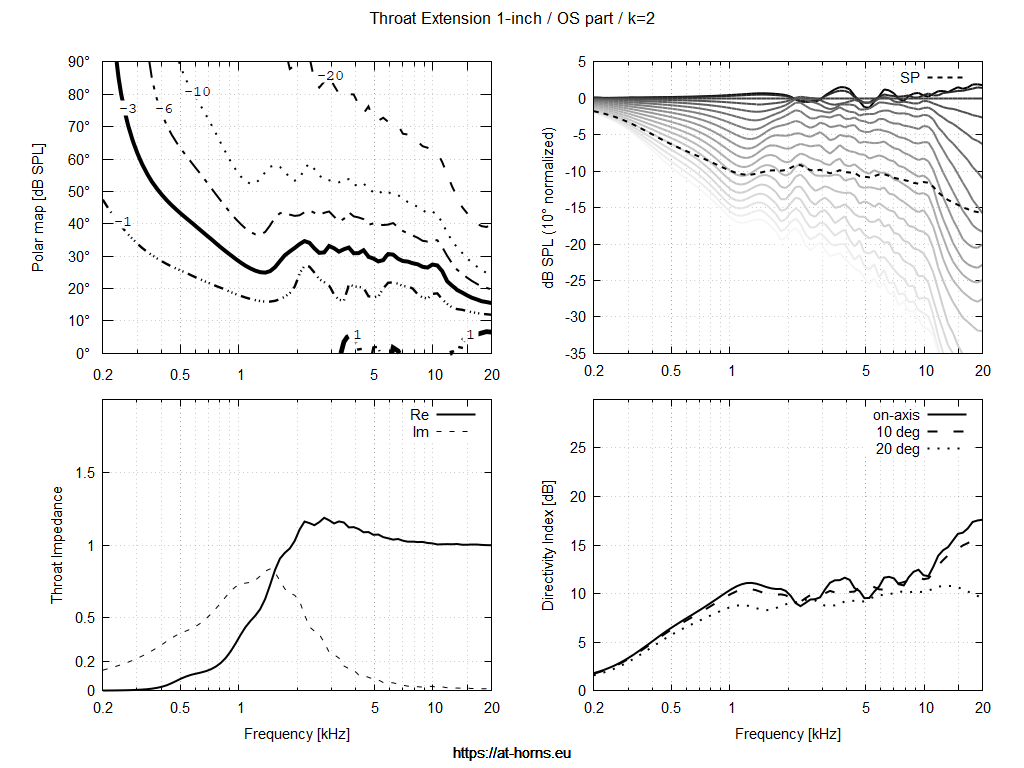

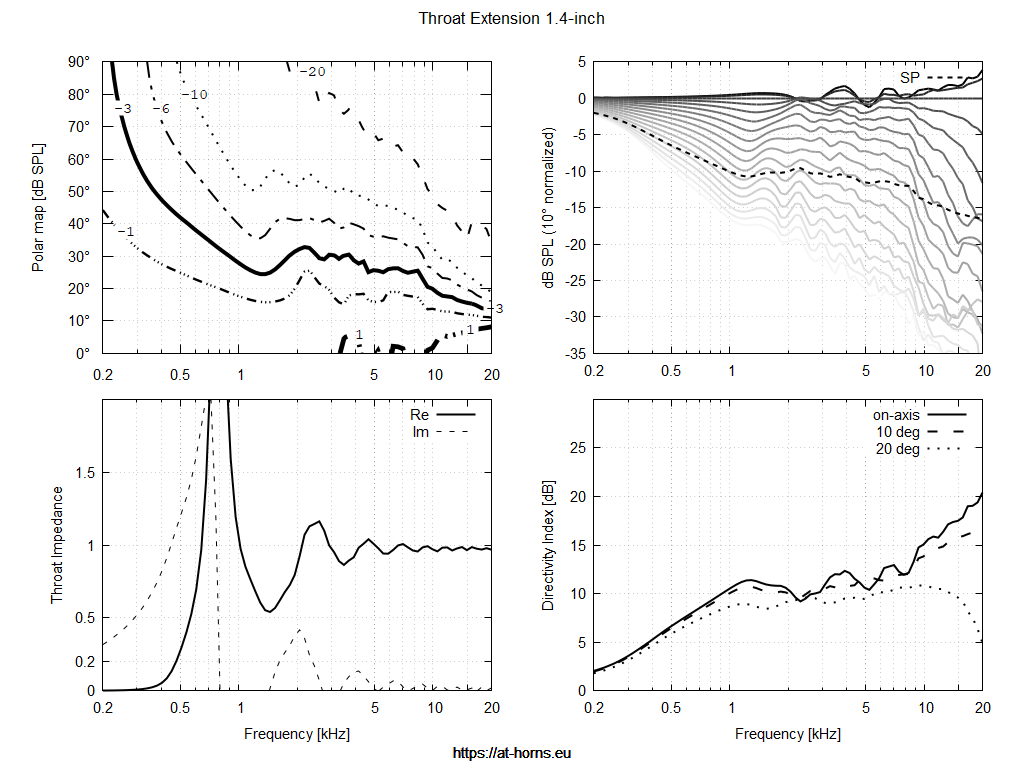

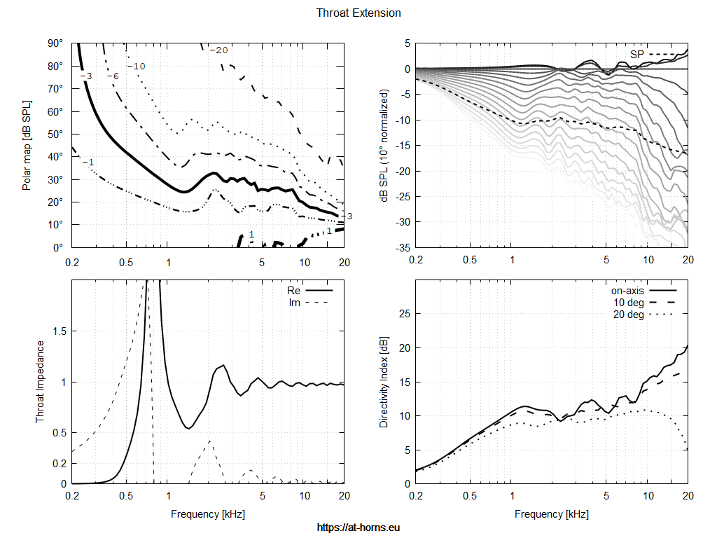

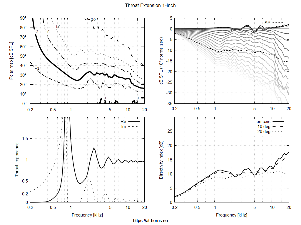

This is what I get for an axisymmetric shape. The throat impedance is indeed increased below 1 kHz by the means of the resonance. Is this a good idea? Maybe, I don't know.
Now the question is whether and how much can an elliptical shape improve this. Maybe it can.
