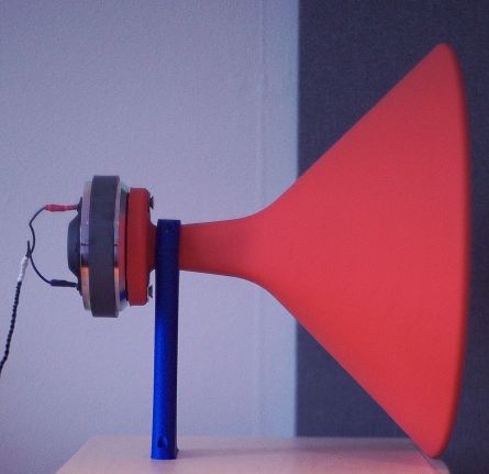

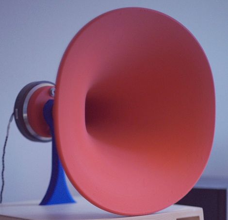

Here is some horns that I've generated using ATH and using with BMS4550 all the way down to 600hz.
I'm using an elliptical throat angle defined in this style
"Throat.Angle = 14 - 10*sin(p)^2"
which helps maintain loading and doesn't make the horn beam too much in the horizontal.
I unfortunately don't have access to my computer atm. and can't provide the simulation and measurements.
I print them standing and my printer really likes the oval shape, apart from the few cases when the throat didn't stick well enough and it got knocked out 50hours in...
The biggest challenge overall with 3D printing is finding filament that has a constant thickness as thickness variance causes the banding you were talking about Mabat.

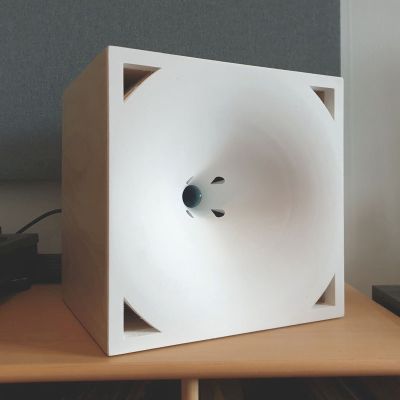

aragorus - That's an interesting shape. Was it generated in one go or is it a compound? Did you employ a throat extension (Throat.Ext)? I'm not sure how would I get a similar shape 🙂
I'm looking forward to learn more about it. Very nice finish, BTW.
From the photos I would be a little worried about its acoustical performance. Wonder what the simulation showed.

It was generated in one go by one of the older versions of ATH, and there is a horn extension of about 20mm I beilieve (which has the elliptical profile).
I have a feeling that the Throat.Ext doesn't work in the newest version.
Or maybe it just works with certain profiles.
I used matt PLA and that has coat of clear lack to seal and protect it.
I always use matt or wood filaments (the wood ones are easy to sand and stain afterwards.

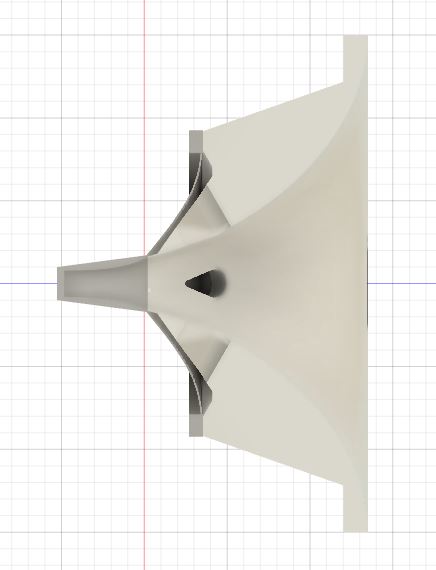

Another slightly modified version of the same contour features 4 midrange taps.
The dark grey is my simplified model of the coaxial driver mounted on it.
The whole thing sits in a ported enclosure.
PS: Regarding the acoustic performance - it's pretty smooth, but beams a bit, as one will expect from such narrow throat extension.
I'll post simulations and measurements when I get to my stationary PC.

This is super interesting! Have you looked at Danley's studio monitors? It's hard to tell from the pictures available, but it seems to me he might be doing something similar even though these are small 6,5" drivers.

Very interesting!
This is similar to what I have in mind.
It should be possible to parametrically define such a profile, even as an optimized "complete" 3D horn ("What does that mean?" 😉), but the math involved is killing.
How did you arrive at the throat length and the circumference of the ellipse?
Looking forward to your sims and measurements!

When I generated the horn I didn't think so much about the compression driver. Other than the throat diameter and exit angle.
Atm I'm trying to make a more inclusive model, containing the CD extension of the MEH horn as well as the ports and woofer membrane. But I'm no AKABAK guru.
In the future I'll try to model the inner works of the BMS4550, even though it looks like a tough challenge. For now I'm just trying to approximate the wave shape
