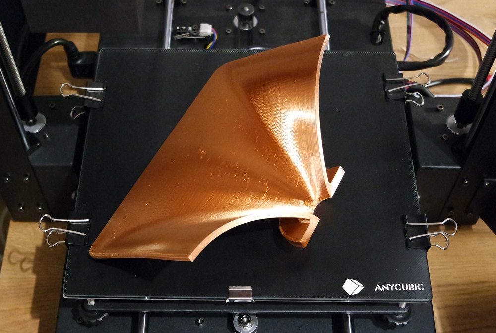

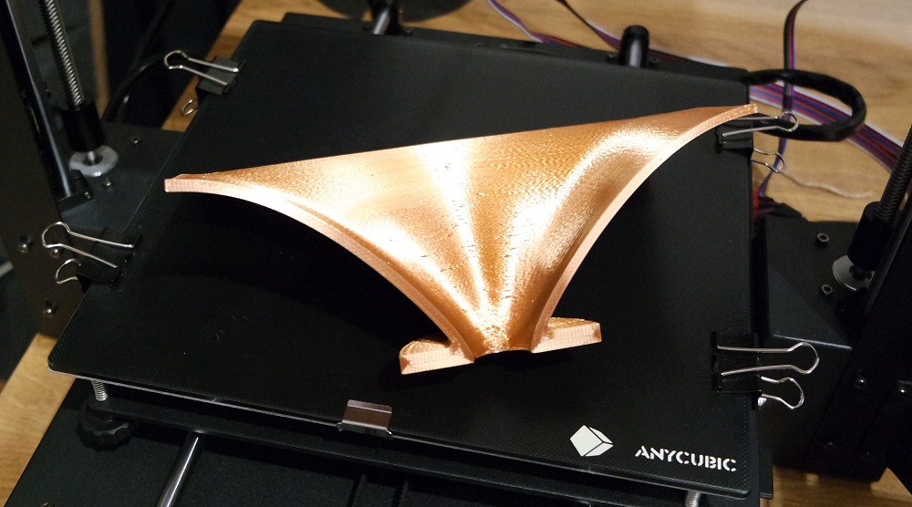

Looking good so far 🙂1:2 Tritonia model ready to print -

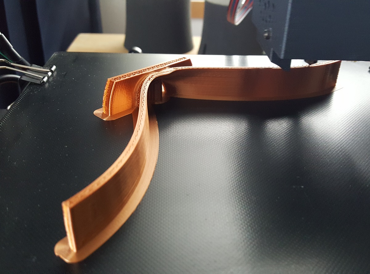

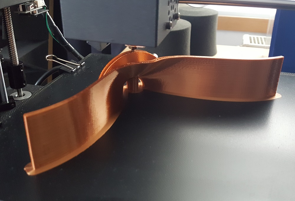

This is also funny: Today, solely by mistake, I tried something I didn't want (what could be considered as an error), but hey, the result is one of the best I have seen -
What would be this shape? What is its peculiarity?
I think that shape gave rise to the Tritonia waveguide you see above, with about the same performance without looking so weird.What would be this shape? What is its peculiarity?
Is that an ANYCUBIC i3 Mega S and if so, would you recommend it?
I'm no experienced printer, so I can't really compare. This is my first, it was cheap and I supose it's nowhere as good as the more expensive stuff. But the only thing I had to do was to rectify the axes a bit (drill a bit bigger holes, etc.), otherwise it simply prints what I need. No issues but maybe you have to be lucky about a particular piece, I don't know.
I think one belt is too loose but I always forget to fix that.

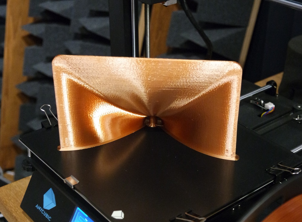

Tritonia in vertical and diagonal (infinite baffle):
I wonder how a Tritonia would work with a coaxial driver, such as the B&C DCX50 (of the newer DCX462/464). Is there a reason such a driver would not work? The DCX50, for instance, has a minuscule cone for the tweeter inside.
What I really like is the shallow depth. This would allow the waveguide to be flush with the rest of a cabinet and almost get time alignment between a woofer and the driver...
