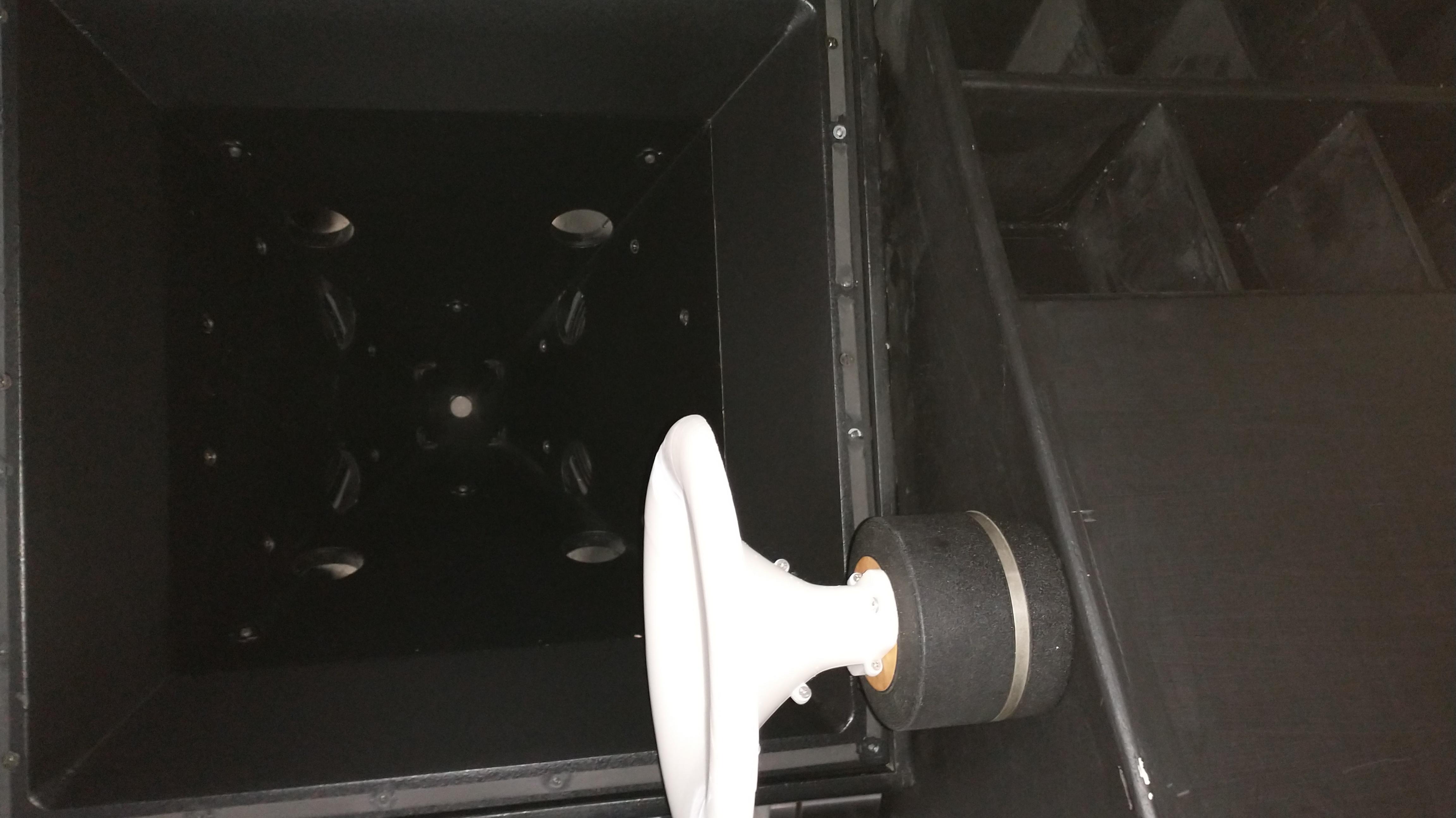

Using a closed back factory mid driver will limit the frequency they can reach down to and with the increase in the number of somewhat affordable CD's that can get to the same frequency on their own I struggle to see why anyone would choose that route unless they already had drivers from another project.
There is plenty of evidence that the ports cause changes to the polar and diffraction and that placing them closer to the throat to cross higher to the CD makes that progressively worse.
I made some simulations of a conical horn and the same horn with a secondary flare at double the main horn wall angle and it was actually much better than I thought it would be when terminated in an infinite baffle. There was no effort made to smooth the join between the CD exit and the Square entrance which I think is why there was still high frequency ripple.
Depending on how much effect the ports have on an Ath style horn it may well not be worth the extra construction difficulty if a MEH is wanted.
As I understand, for true synergy only conical profile is in consideration because the flare rate continuously changing from high at throat to lower toward the mouth.
Every frequency range has optimal flare rate so drivers are distributed along profile considering not only distance between them but flare rate as well.
Those last designs here are closest to hyperbolic profile.
Though from impedance plots is visible that some of them has short conical entry.
But always can be MEH
I think the tradeoff is with HF pattern control re the throat diameter of 1” or even .75” CDs being used with a co-entrant horn. A closed back driver is of course not a requirement in this scenario but it helps where a standalone axisymmetrical waveguide is desired.
As far as the HF-1440 is concerned, I was considering using slot loaded woofers on either side (flanking the standalone waveguide) as a way to low the directivity even further. It’s still just an idea.
I'm not sure that is a trade worth making, beaming above 10K vs disruption of pattern control and diffraction further down.
I have a 1" CD and 2" drivers that were bough for exactly this scenario, they are still in the boxes, maybe one day I will build them and find out.
I have had a very similar idea for the HF1440, not completely worked out or properly simulated yet either.

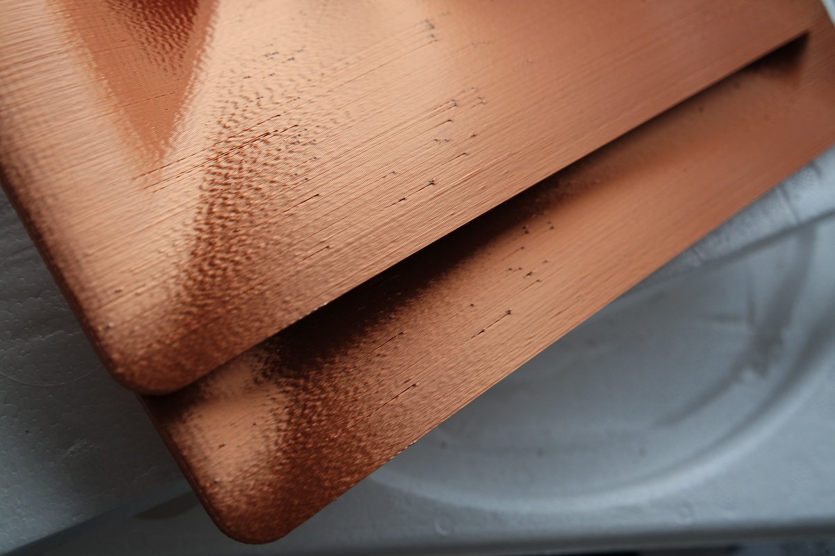

I'm really not experienced in 3D printing so what surprised me is that all the small surface glitches are virtually the same on both prints, which means this is actually determined by the slicer settings rather than by some random aberations. That would mean that the printer itself is capable to print it even better, which is encouraging. Right now it's printing the same with a different filament and 0.3 mm layer (it was 0.2 mm before - obviously an overkill).

The glitches shown in the 3D print look like beginnings of layers - you could place the seam to a certain place by choosing "aligned" instead of "random" or "closest". Then, there would be only one seam line. Also, the retraction settings could be tuned a bit. I had the best results with PrusaSlicer and Slic3r being second best. I was not able to make good quality in Cura.
