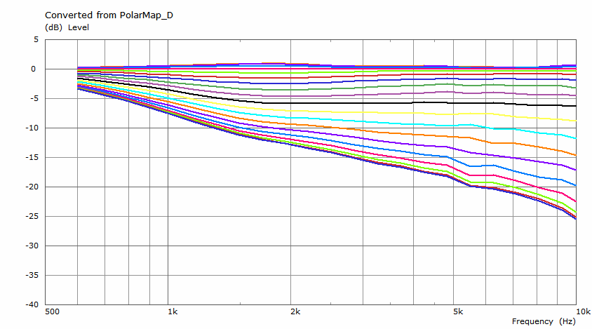

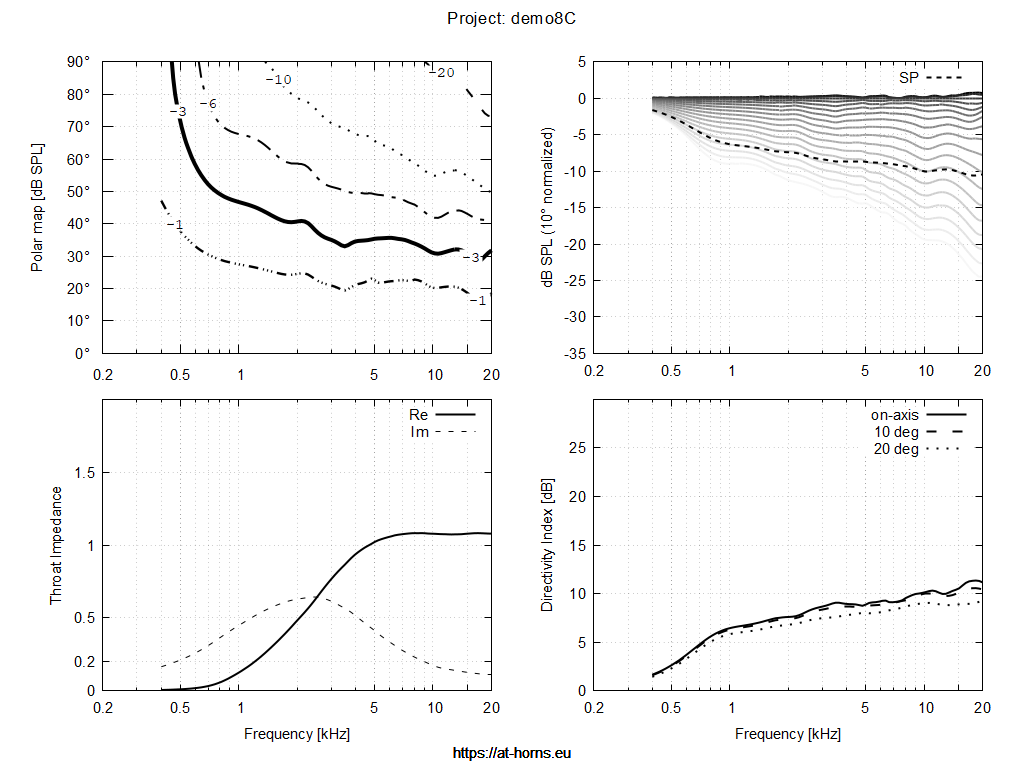

It can't be. All directions will have about the same DI at LF - they have to. So if the DI in one direction is higher than the others at HF then the total DI has to be rising.
Your argument seems to suggest that if the device has different beamwidths in different planes (H/V/D) it can't be CD. This makes no sense to me. And if the argument is that the DI is low (the same) at LF, no waveguide would ever be CD (which it really isn't but that's beside the point).
- What I see is a rock stable beamwidth in the diagonal plane and can't see how this could be a bad thing.
(This is an IB simulation so below about 1.5 kHz it gets wider because of that. In real it will be different/narrower considerably lower, we know that.)

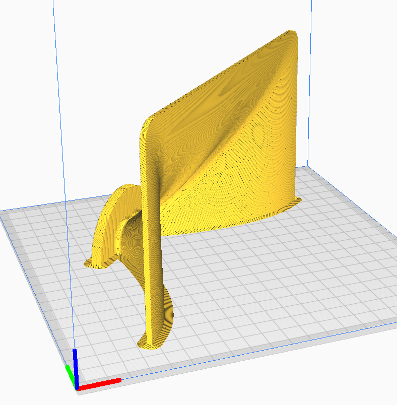

I have a 1.4" bms 4594he if the throat match? I could print it maybe in quarter sections.
298x257x96 should be printable on my printer,I can measure with DE500 or CP385/Nd.
Thanks. It occured to me that I still have B&C DE7 (0.75") so I can try to print it myself first. If I fail (which is likely to happen) I'll pass it to you.

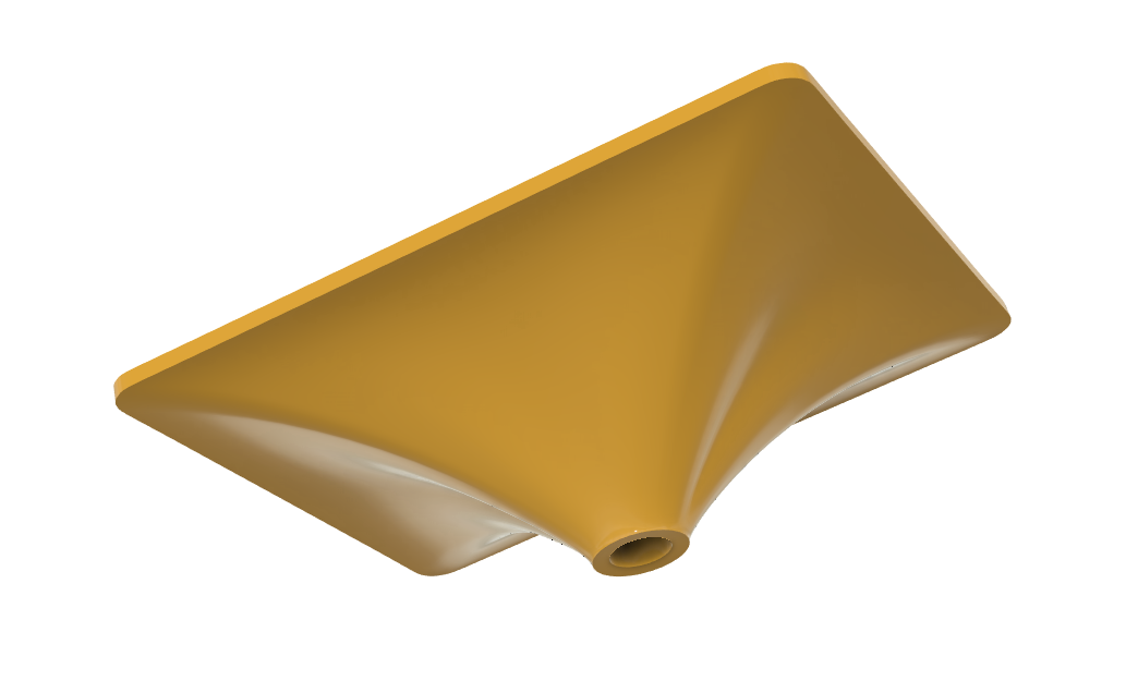

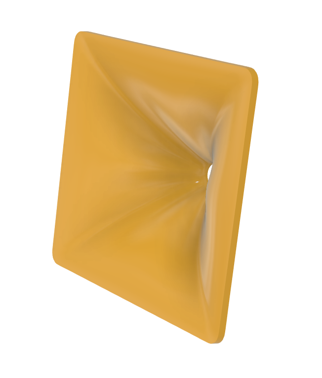

I guess I'm pretty late to the party but I've just found out that it's possible to easily thicken the lofted surface imported into Fusion from Ath simply by selecting the "Thicken" feature - basically one click and you have a printable solid, which is a lot easier than I anticipated :)
Nice. Btw, how did you come up with the dimensions of the Tritonia? Did you have a particular goal for an asymmetric pattern or did this just give the smoothest results? I'm asking because it's barely asymmetrical, but it also clearly is and I'm wondering what the reasoning behind that was.

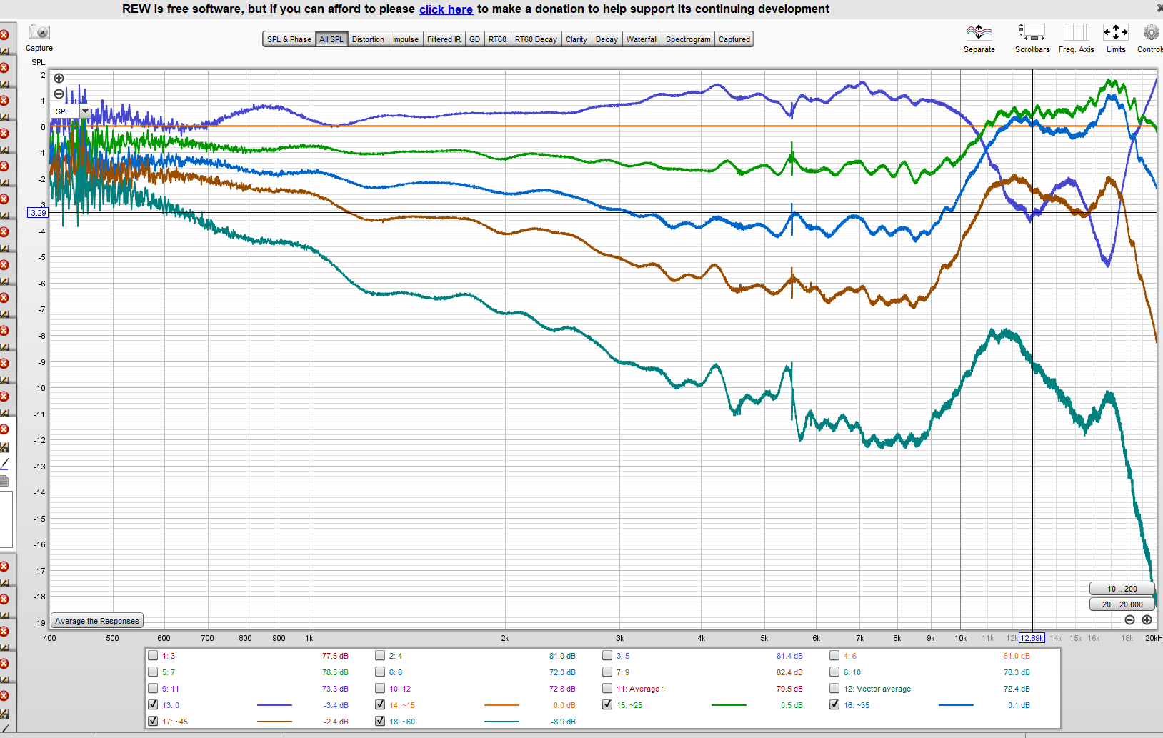

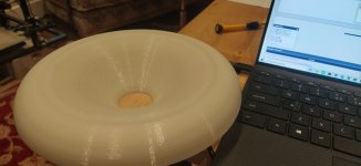

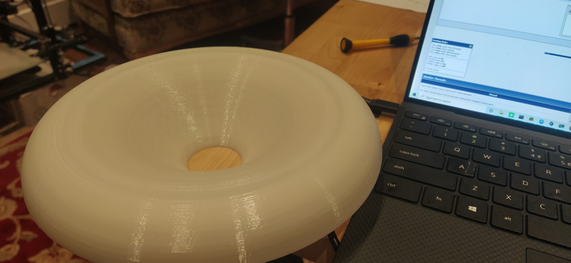

Sorry for the bummer but this is the "correct" result:
I think i'll brigade this thread as revenge for MABAT ruining my day with "reality" or whatever :mad:
It really is remarkable how close this is to the sim once i'd corrected it. I've checked the curves in vacs, and they are pretty much all within a db or two, and the general shapes are all correct! (up to about 16khz) I can't claim my angles that are in the REW plots are very accurate (no measurement jig yet)
By working at the sim a bit more, I managed to gain back some performance. I'll consider also make it a bit bigger. Overall I'm keen to try it out in a speaker because I can already see its DESTROYING the performance of the behringer truths when i do the same normalisation visualisation

The only reason was to make it "barely asymmetrical" - a guess, really. I'm not much in favor of asymmetrical devices, as you may have already noticed.
I have noticed that :) And I myself am a little torn as in isolation symmetrical devices clearly have less issues. But I also think it would be preferable to have a narrower vertical pattern in general if the drawbacks can be limited and the small forward lobe of symmetrical devices is less than ideal. And of the people who have a long history of building actual speakers Wayne Parham for example insists, that the sweet spot for a waveguide's vertical pattern is somewhere between 40 to 60 degrees. I recall Tom Danley stating that asymmetrical is fine, but the relation shouldn't exceed about 1.6:1, as the pattern flip becomes too severe to handle in the crossover beyond that point (could have gotten this wrong though). And I think even Earl has said that in theory he would prefer an elliptical asymmetrical (to what degree I don't know) waveguide, but building that just wasn't practical with what he had available. I hope I'm not misquoting him, but since he's active here, he'll correct me if needed.
I'm not saying you're wrong about preferring symmetrical devices, but there also seem to be good arguments for going asymmetrical by knowledgeable people (who in turn don't necessarily agree with each other).
The argument for narrow vertical is to avoid or minimize floor and ceiling reflections which is a good idea, the problem with narrowing the coverage is that the dimension becomes smaller and pattern control is lost at a higher frequency. So you can pick narrow coverage or control to lower frequencies. Integrating two drivers with quite different directivities is not easy, 1" dome and an 8" woofer vs 8" waveguide and 8" woofer. Lots pick narrow coverage because they don't want to treat the ceiling or their customers don't. Pick your poison :)
