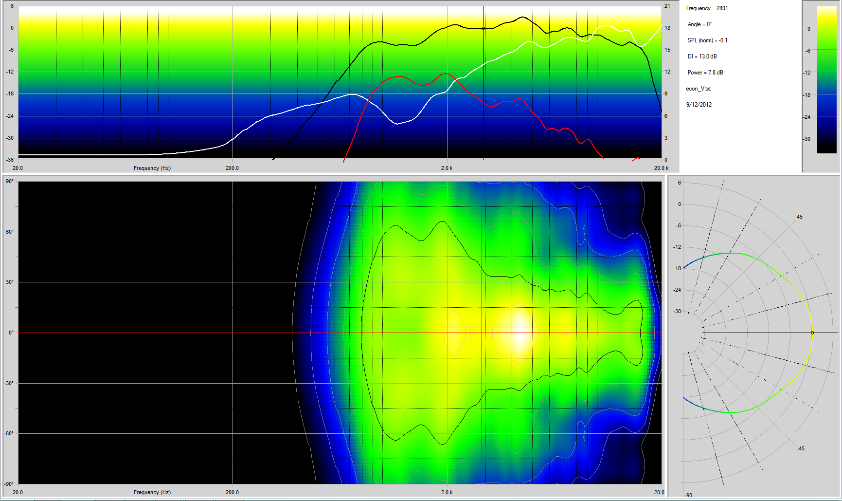

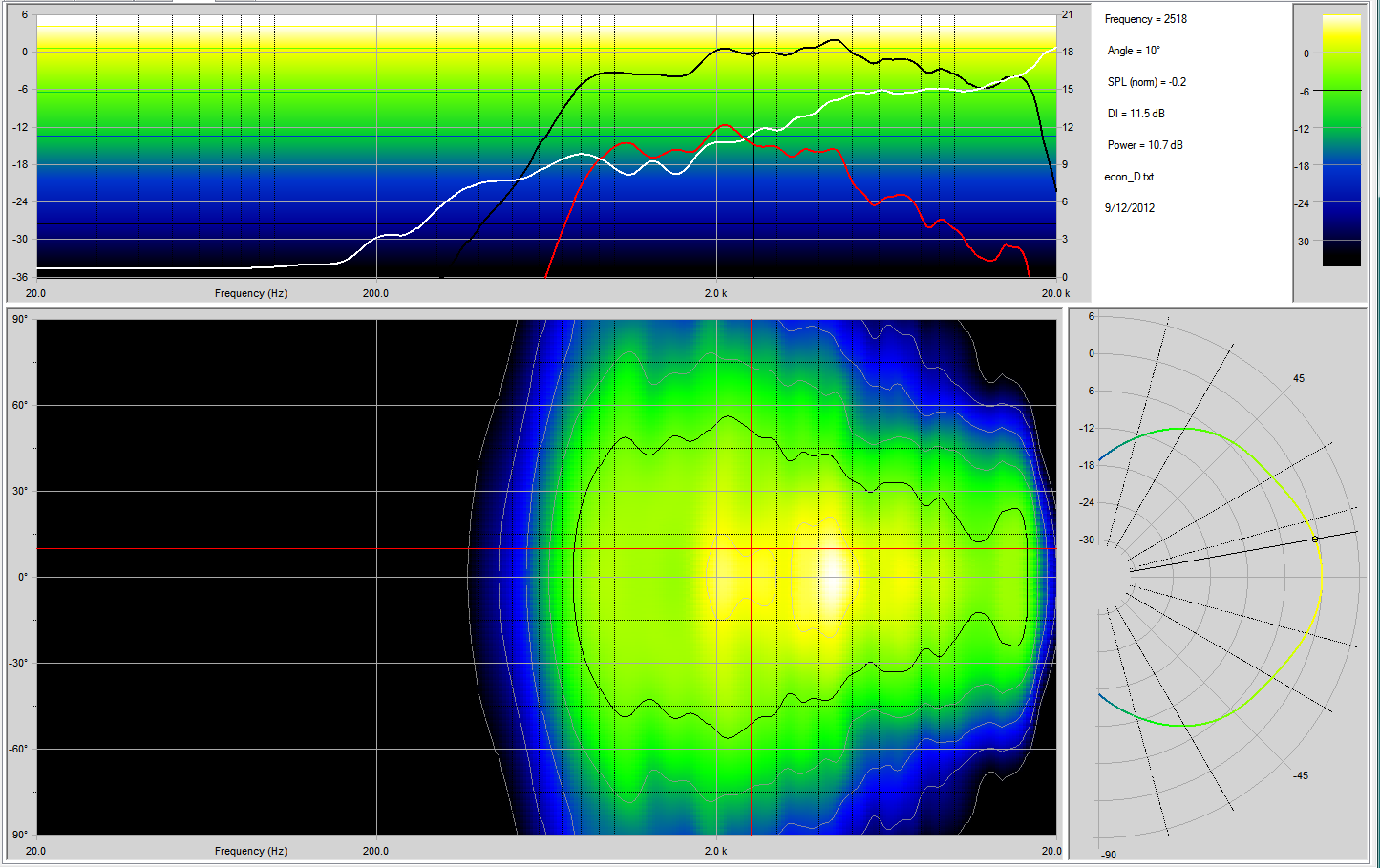

Hence, I stand by my claim. I only know what I have measured and those measurements support my opinion 100%. Until I see real measured data to the contrary (or even some simulations although simulations never trump measurements) I will not be changing my opinion.
Back when the SEOS first came out it was stated that it was based on some of my work. But I thought the implementation was poor and I objected. To prove my point I measured an SEOS H, V & across the diagonal. The diagonal was the worst of the bunch, but given the poor handling of the mouth, I wasn't real happy with any of them. I was severely chastised for doing this and so I simply bowed out of the SEOS clan. The data was shown there many many years ago.
But luckily I did find them (attached.)
I can't upload them as they are too big. Maybe I'll figure something out.
Actually they did upload!!?
But the horizontal was missing. In this case the vertical was worse than the diagonal which was worse than the horizontal. Still a problem.
Won't upload the horizontal for some reason.
