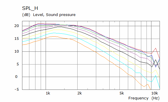

No I didn't, but here is the same waveguide curve forced to rectangular in an enclosure, I don't think anyone would argue this is better than the round one. Rectangular can work well but the overall enclosure needs to be tuned to work with it rather than against it as seen here. The diffraction in this one is low but it does not have a lot of extra asymmetric baffle to it either.

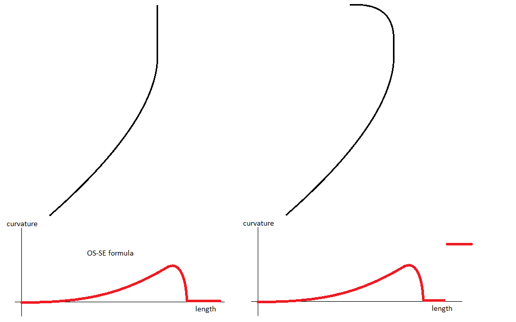

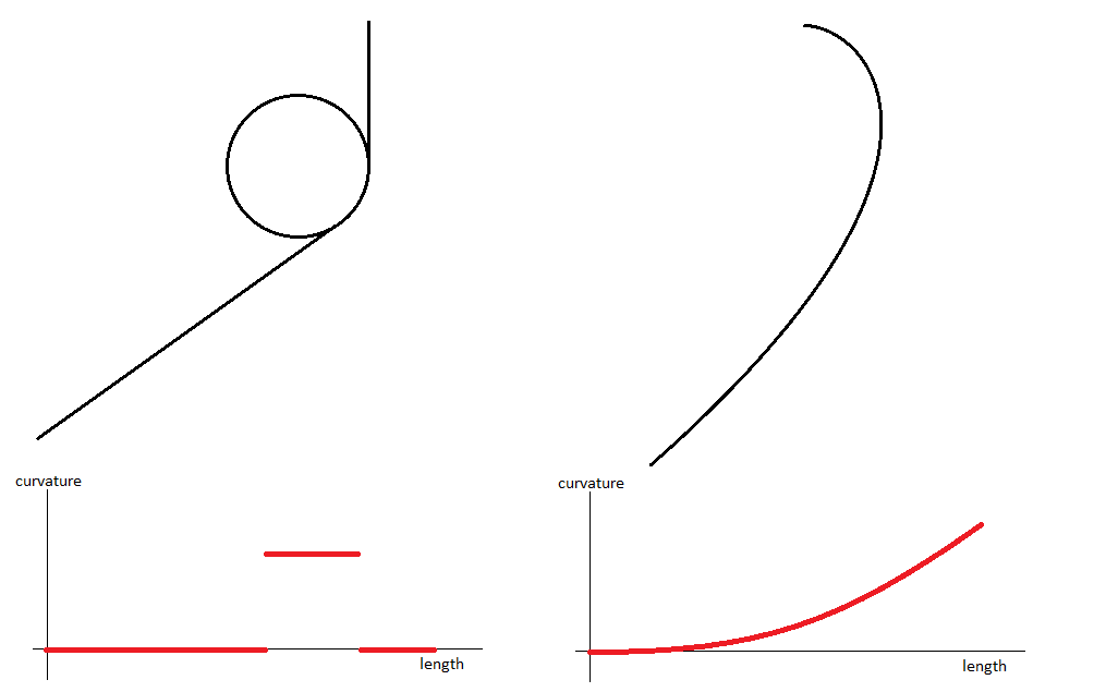

Are you mixing up "curvature" with "slope"?
No, I mean specifically change of curvature. From my observations a gradual change of slope (i.e. mere continuity of the first derivative) is not enough. All the unprecedented smoothenss of the newest free standing waveguides is achieved (IMHO) by a gradual change of curvature. This is an illustration of what I'm talking about (not to scale, it's a hand drawn sketch) - parts of two different terminations:
attachment.php

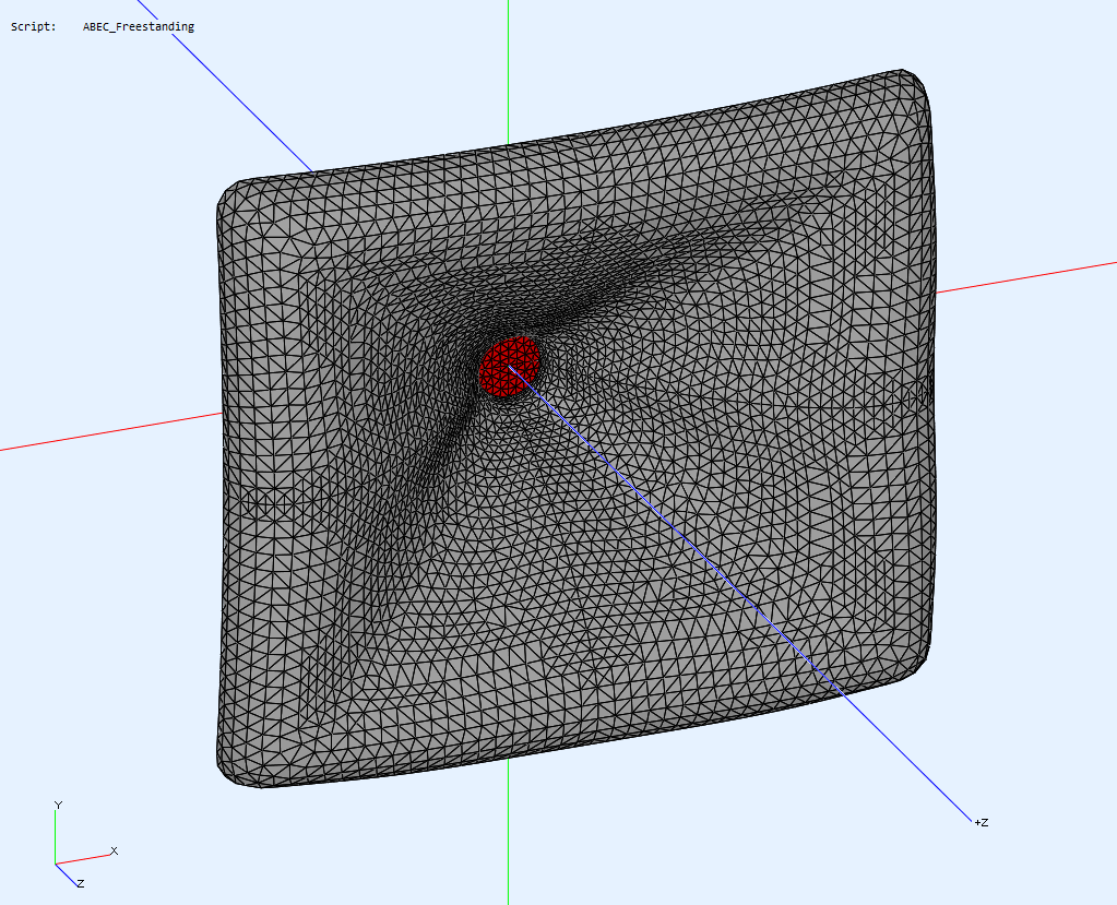

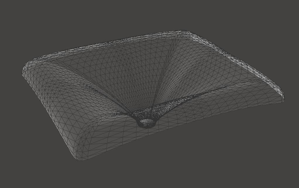

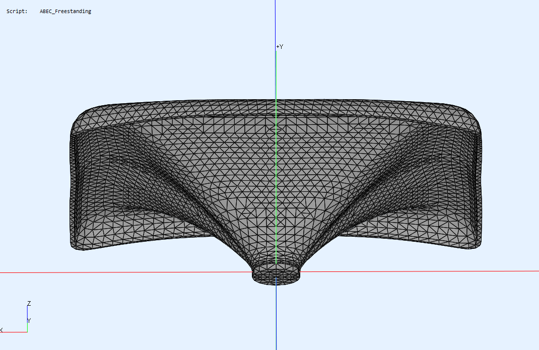

I think the word 'rectangular' might be wrong and confusing for what I'm trying to say. Is there a better word for something like a SEOS waveguide (regardless of their actual vertical vs horizontal proportion) where the elliptical or circular is abandoned and it is straight left/right/top/bottom but the corners remain 'round' so there's no actual edge?
Is there a best tradeoff-point for a shape on the path of morping a circle into a rectangle?

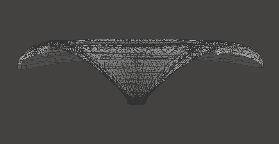

Could a freestanding Tritonia be given a rollback with the same curvature as your freestanding round one?
