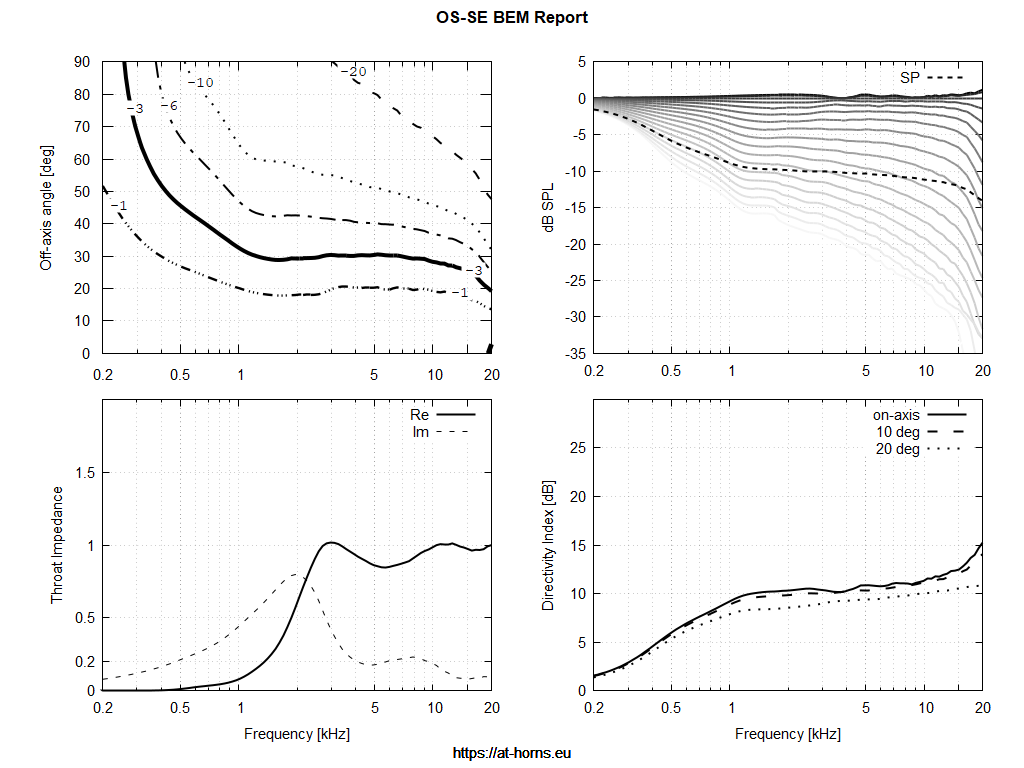

Basically, yes, that's one aspect. The second is that it really seems to me that the free standing waveguides reach somewhat lower with the controlled directivity than when in a box. For example this is the "sand horn", ⌀336 mm (~13.2") across. I don't have a simulation for a similar WG in a box but I would say it's pretty good result for the size.

Presumably the 336mm is the total dimension 'after' the roundover? That would equal something like maybe a 270mm waveguide in a baffle with large roundovers. Looking at it that way, it's actually tiny for 1000Hz pattern control.
Even if I interpret fluid correctly that large baffle roundovers have a similar effect as freestanding wg with rollback, it still seems to get more pattern control out of its small size.
... That would equal something like maybe a 270mm waveguide in a baffle with large roundovers.
What people still seem to miss somehow is that this is actually far from being equal. In a baffle you can have the same roundover only at a limited number of points (typically only three), the rest of the circumference just continues with a segment of flat surface, which is not as smooth continuation of the profile... For me that's the reason why a round waveguide is really not the best choice for a flat (rectangular) baffle.
