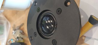

Making my attempt at using this tool. I've chosen the dayton 1-1/8 inch al dome tweeter (hoping that the first breakup mode is high enough) its got an easily removable phase shield + grill so i'm hoping it is pretty close to the models
I'm hoping to get to 800-1khz at lowish volumes without breaking the bank (its about 100$ AU for a pair here)
modeled the diaphragm using the script. I used the 8C demo as a reference.
Started the print now on my cr10s, should be done in just 22 hours!
Will be doing some measurements tomorrow to see how it turns out. fingers crossed!
If it looks pretty good i'll be integrating it with my Behringer truths as the woofer to see how a complete system might sound. I'm really keen to compare it to something which is known to be pretty decent like that.
Here's the config i've made if anyone else wants to try something similar 🙂

hmmm. clearly I should have been using the 2db plotting with the new tool. clearly could improve it. Mostly hoping that I get the extension out of it that the model shows. will clearly have to do a V2 though.

Very nice. Maybe I would try to aim for a lower DI with such a small waveguide (around 7 dB?). It would match better with a smaller woofer and made a more balanced DI curve overall.Making my attempt at using this tool. ...
Ok cool 🙂 will factor this into the 2.0 attempt! was kind of hoping to get a slightly less 'live' sound in my room by sticking to the 90 deg. but will easily be able to compare with a 7db horn as well.
Yeah, but as seen from the DI curve it's not possible to control the directivity very low in freqency with such small device - it starts to widen below 3 kHz or so. Hence, IMHO, it's better to have it all wider.
Now I noticed you made the same mistake as almost everyone else - when simulating a dome tweeter, you have to set the axial velocity of the driving elements (the default is radial):
Source.Velocity = 2
Sorry for the bummer but this is the "correct" result:
It will be interesting to see the measured results anyway, as the simulation can still be way off the reality due to the non-pistonic movement of the diaphragm.
Source.Velocity = 2
