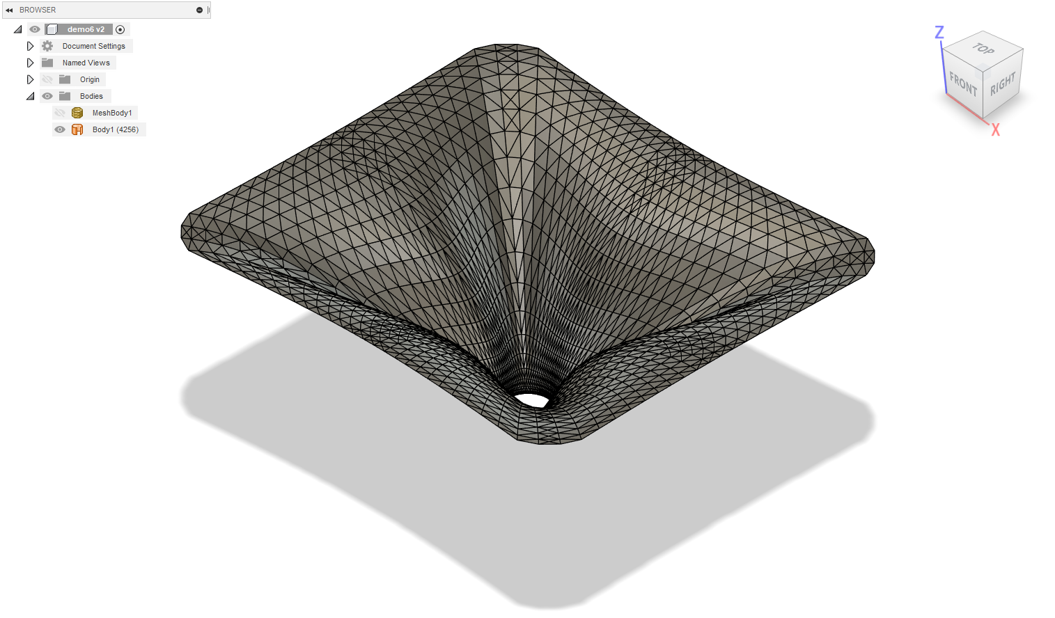

"The script Marcel made does it automatically and you end up with a body."
Are you talking about the output.stl?

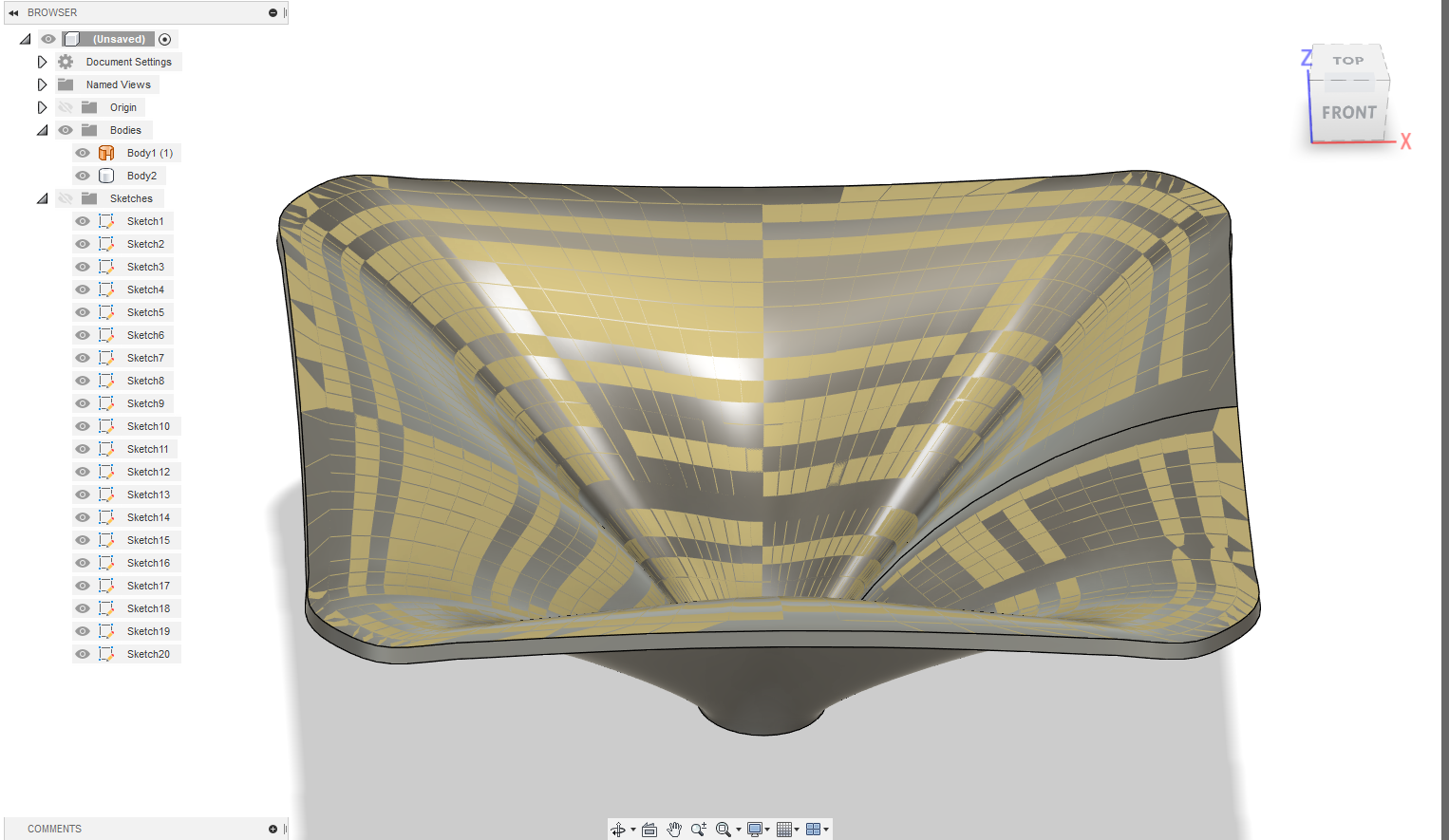

I've imported that stl and converted to BREP, still could not thicken. see image
I must be missing a step.
Axissymetric horns are easy with Marcel's FusionRotaryProfile.
I'm just stuck on thickening the Tritonia.
If you have, could you share a screenshot please? thanks

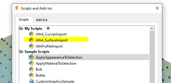

It's actually extremely simple. I will add this to the User Guide.

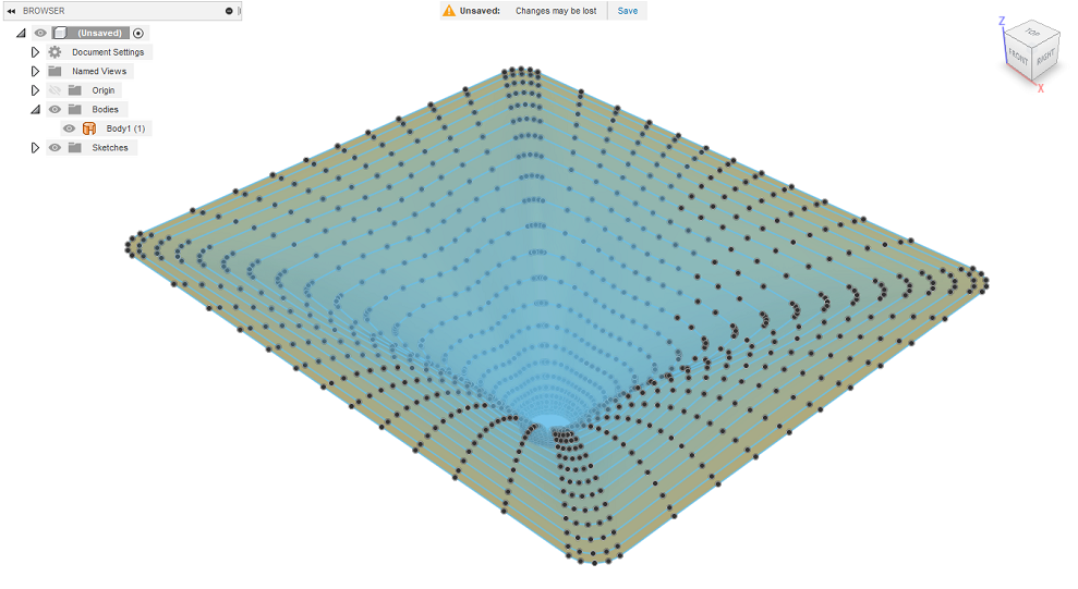

1) Export the slices from Ath.
Try to use as low mesh resolution as possible to preserve the shape fidelity. Fusion will interpolate splines through the mesh points.
This is what I used here:
In this case this will create a file Tritonia_slices_f360.csv in the project output directory.
2) In Fusion install the Ath scripts(s):
3) Run the "Ath4_SurfaceImport" script. In the "File Open Dialog" select the exported csv file.
4) Add thickness to the created body (Solid - Create - Thicken):
Code:
Mesh.AngularSegments = 60
Mesh.DepthSegments = 20
Mesh.CornerSegments = 5
GridExport:f360 = {
ExportProfiles = 0
ExportSlices = 1
Scale = 0.1

Yesterday I fought a bit with adding the scripts to F360. First, they are scripts and not add-ins (first confusion) and second, the folder names must be exactly the same as the script name and manifest (second onfusion) to show up in Fusion when copied to the proper directory. I would humbly suggest to rename the folders in the ATH package and add a line on how to install them. (sorry if I missed it in the docs)

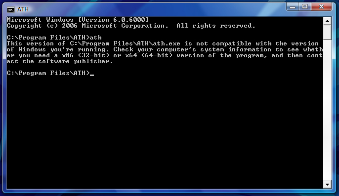

Dear Mr. Marcel,
I am getting the following message (image attached) when I try running the ATH software on my computer.
If this has anything to do with the word-length (32/64 bit) of the computer, kindly share a 32-bit version of the program (if available). My operating system is 32-bit Windows Vista Home Premium.

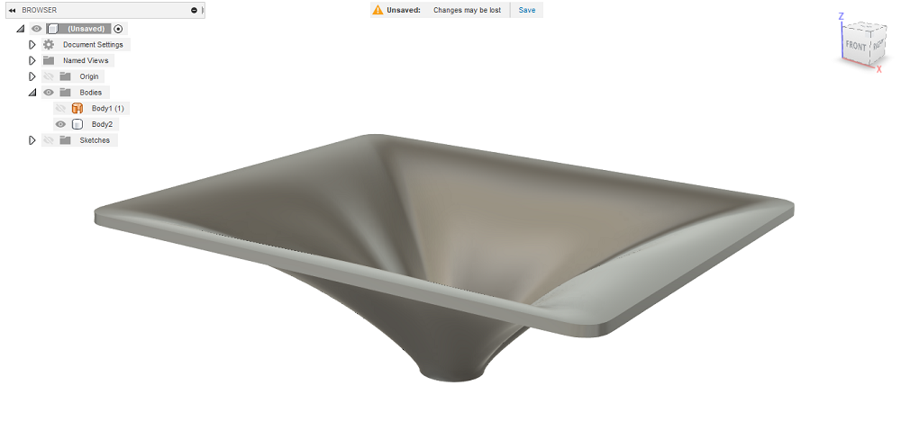

It's working now, took only 3 minutes following your instructions.
Instead of me cursing for 3 hours 🙂
Thanks a lot Marcel, much appreciated!

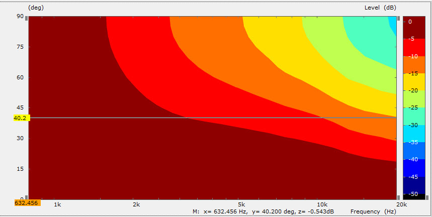

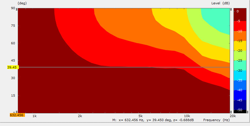

I am trying to achive a wide horizontal coverage for an 33mm driver and just playing around with differnt settings in ath4. Independent from the settings which one of those two coverage version is to prefer?
The first one is constant between 2-10khz but but then falling rapidly after 10khz. The second one does not have constant coverage between 2-10khz but coverage is falling smoother over the complete range 2-20khz.
Try this, it should be a 32bit executable. I had some difficulties compiling for 32 bits in the past, so I hope it works: https://at-horns.eu/release/ath-4.7.1beta-32bit.zipDear Mr. Marcel,

32-bit version
Yes, the one you gave does compile on a 32-bit computer.
However, when I tried enabling the circular symmetry function, reducing the number of slices and angular segments, sampling frequency etc., the same did not reflect in the output ABEC project file.
Incidentally, other ABEC examples seem to solve and show spectra on VACS.
Is the 32-bit executable designed to have only the set parameters in the user guide PDF file? For example, the length of the horn is always 94mm.
Sorry about the above post. My path was wrong. Changes to script do reflect well in the ABEC file.
Now I think I need to begin learning how to reduce the computation time - mesh resolution etc.
Thank you very much Mr. Marcel.
If you really enable the circular symmetry (i.e. set 'ABEC.SimProfile') you don't have to worry about the computation time, it will be always pretty short. So there's no reasons to reduce the number of slices. Also, keep the mesh (sampling) frequency high, certainly above 30 kHz. This way you will get stable and quite accurate results up to 20 kHz.... However, when I tried enabling the circular symmetry function, reducing the number of slices and angular segments, sampling frequency etc., the same did not reflect in the output ABEC project file.
