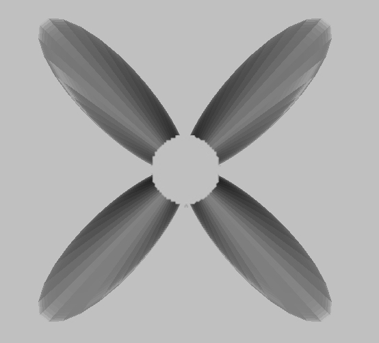

Guide curve smaller than the throat outline would lead to a negative coverage angle which is not allowed.
Maybe you could try to use the explicit expressions instead (parameters as functions of 'p'), which offers by far greater freedom in overall design.
I do not mean a negative coverage angle but the horn becoming like a pipe (clipped at throat diameter), like in the picture below.
Yes, the superellipse formula could be written however, I get NaN errors whenever the throat is bigger than the curve. So I don' think it would be any different from what it is now.
One option I see is to make the horn with a smaller throat and then obtain the larger throat using CAD. Then maybe import the CAD into ABEC, solve and verify. Complicated.

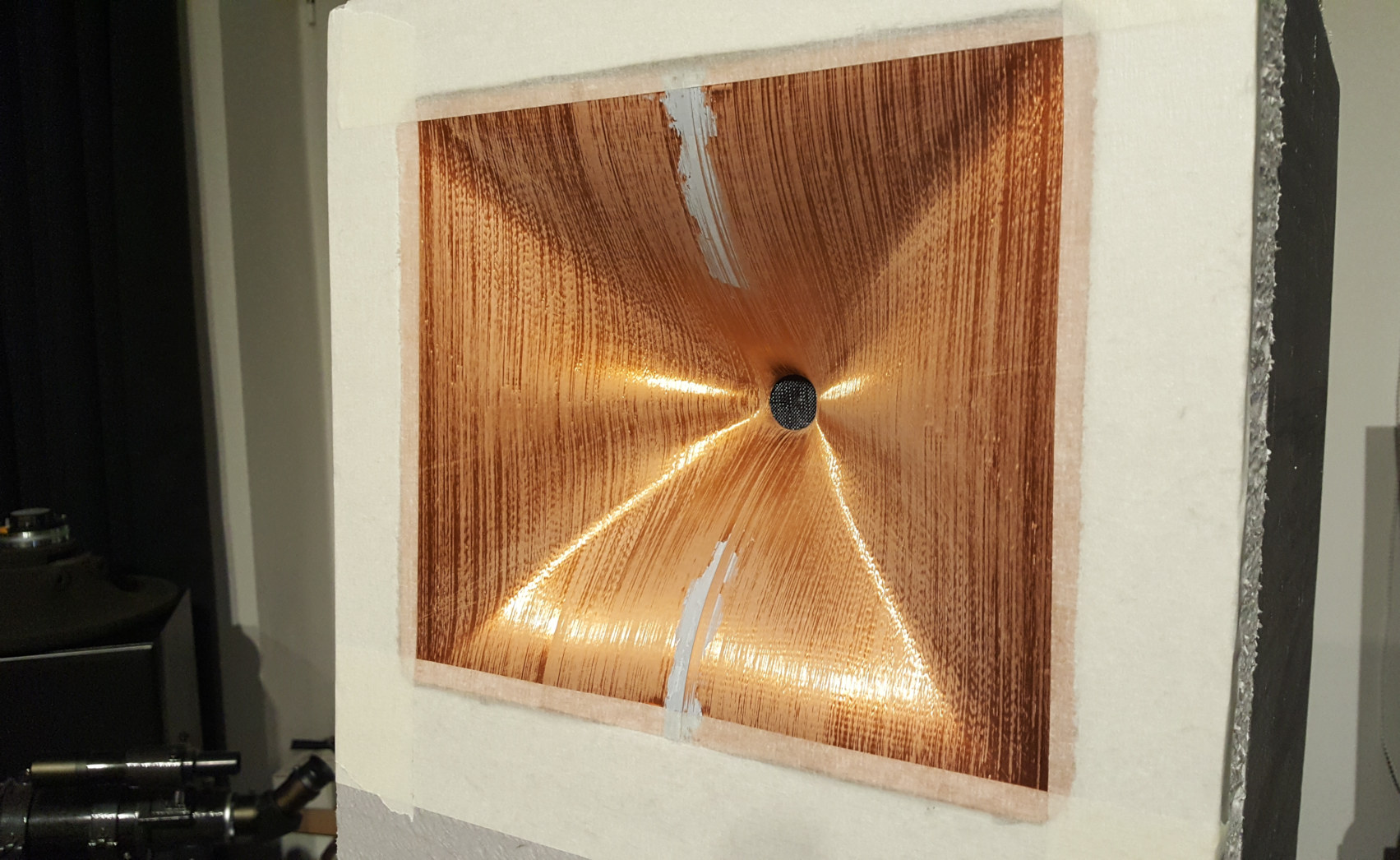

Yes, a cheap printer (Anycubic i3 Mega S) but it serves the experiment well. I'm yet learning the stuff along the way.
Anycubic Chiron was delivered today - I'll be able to print it in the real scale on that one, both halves in one go 🙂
