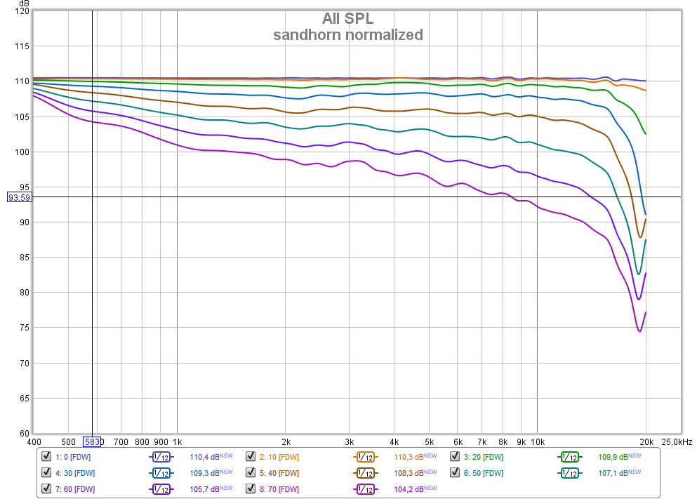

For years I’ve just been assuming what raw vs normalized is. But could someone please give me an actual explanation? I did a search of the forum but didn’t find one.
From VACS help "Normalization
Performs a division by the reference value or data-set"
Normalizing to on axis sets that as reference, 20 degrees uses that as reference. When the reference is divided by itself you get a flat line.
I'm talking about the data/plot, not a usage of the horn. No constant directivity waveguide can ever be used unequalized. That would sound awful. Some EQ is always part of the crossover, no matter if passive or active or via DSP. In fact, that's one of the most important things that a proper crossover does.I'm not so sure its the dominating way used. I suppose many listen to horns un-EQed. But rate is increasing as DSP is getting more and more obtainable..
The important point is that the normalized response stays the same no matter what EQ you apply or what driver you use. So it describes the basic and driver-independent behavior of the waveguide alone (the directivity and possible diffractions), and also shows what you would get if you EQed the on-axis flat (or whatever off-axis angle was choosen as the reference, e.g. the optimal listening axis).... Normalized is basically off-axis relative to the on-axis (as it's typically used) - that's not theoretical, that's also the reality.
I'm talking about the data/plot, not a usage of the horn...
Hmm, but what does "dominating way used" in the context mean? That was what puzzled me...

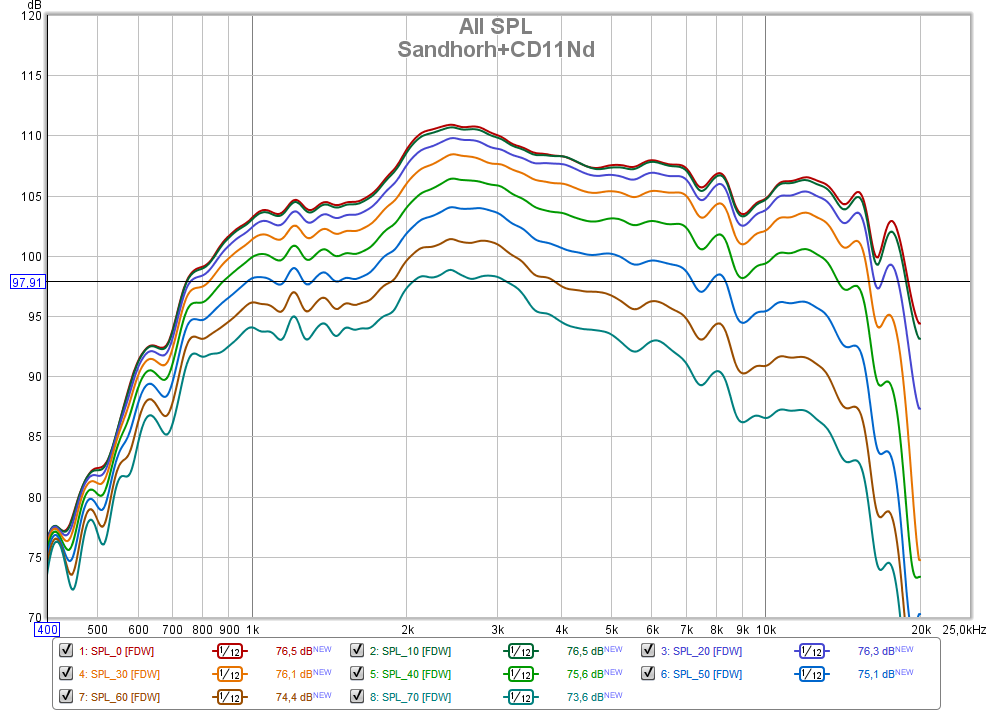

Sandhorn measured with Beyma CD11Nd, raw and normalized (courtesy of BV) -
Exit angle of the CD11Nd: 17.02º.
What's the throat angle of the Sandhorn?
