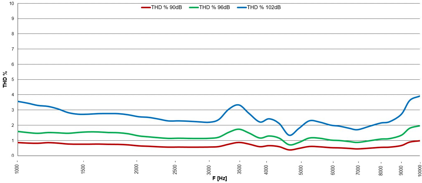

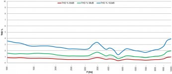

An example of (BS) marketing-induced nonsense engineering versus high quality / price ratio.
Left is the ScanSpeak ellipticor tweeter. Right is the tweeter I referred to, which costs less than 6.5% of the SS (yes, you read that correctly).
Assuming that both tweeters are deployed around 2 kHz and should be able to play loud, THD in the upper midrange and treble is most relevant to the perceived sound quality.
Respectfully, I'm not sure that THD as a measure of SQ is something we should get into in this thread. I know of no new scientific evidence to support or refute it since the last time it was discussed to death, or the time before that.
Agreed, my point was to give an example of the futility of some "exotic" drivers and it ends right here 😉
(The rising THD > 8 kHz is most likely related to modes / IMD due to the elliptical dome, which should affect SQ)

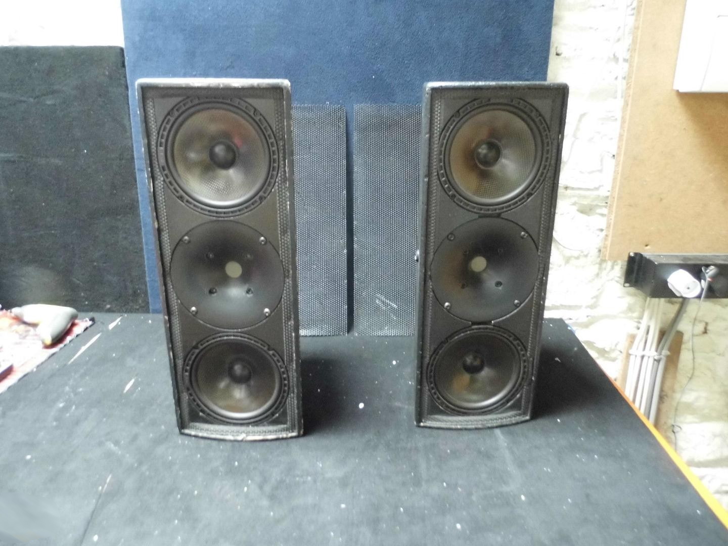

It is certainly interesting to investigate to what extent the - scientifically demonstrable disadvantages - of a diffraction slot actually influence the (midfield) rendering.
The 2380A should be an example of a "bad horn," but it is precisely this one that is used in, what many professionals consider, one of the very best studio monitors ever made.
The maker (Jürgen Strauss) is extremely focused on impulse / phase and radiation characteristics.
According to the pro's in the recording business, despite the analog technology, the MF-2 is superior to it's (FIR optimised) competitors.
Also interesting is Strauss's view that separate subs are a big no-go in a stereo studio setup.

What's so great about it?...one of the very best studio monitors ever made.
It seems the question "What's not so great about it?" is more appropriate.
You should ask the people who work with these, or the AES Swiss Section.
I've yet to come across a negative comment on these beasts.
Unfortunately, it's impossible to get hold of measurement data.
