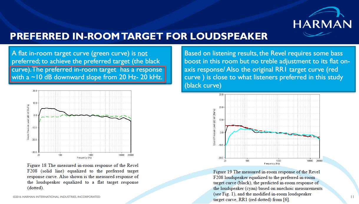

This is linked with the research based on the in-room EQ AND the headphone target curve research both conducted by Harman.

check the PREFERRED IN-ROOM TARGET FOR LOUDSPEAKER.png attached

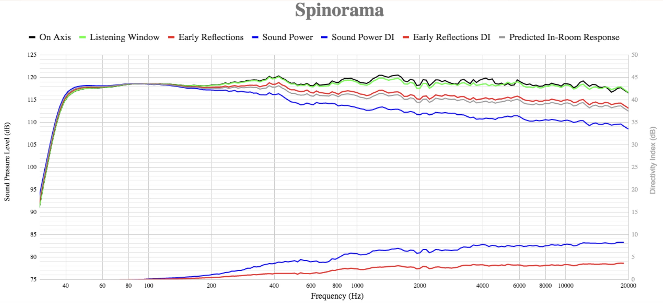

Spinorama of the F206: https://2.bp.blogspot.com/-xqKYdRmEzKk/XJVUr5bdR6I/AAAAAAAAAD0/nxBS8IBGnLwrq86HJeqn9MAn6QTFSw8aQCLcBGAs/s1600/Spin%2B-%2BRevel%2BPerforma3%2BF206.png
The catch is that most speakers do not have controlled directivity down to 100Hz therefore the PIR regression being linear, the score tends to favor a line with a negative slope (-6/-10dB from 100 to 16000Hz) although, at the limit, it would favor a flat PIR as seen above.
Even speakers with CD much lower that usual say 200-300Hz to will still yield a slope for the linear regression and score lower while they are closer to the idealized target. i.e. the Revel Tower speakers F228 as the example showed above.

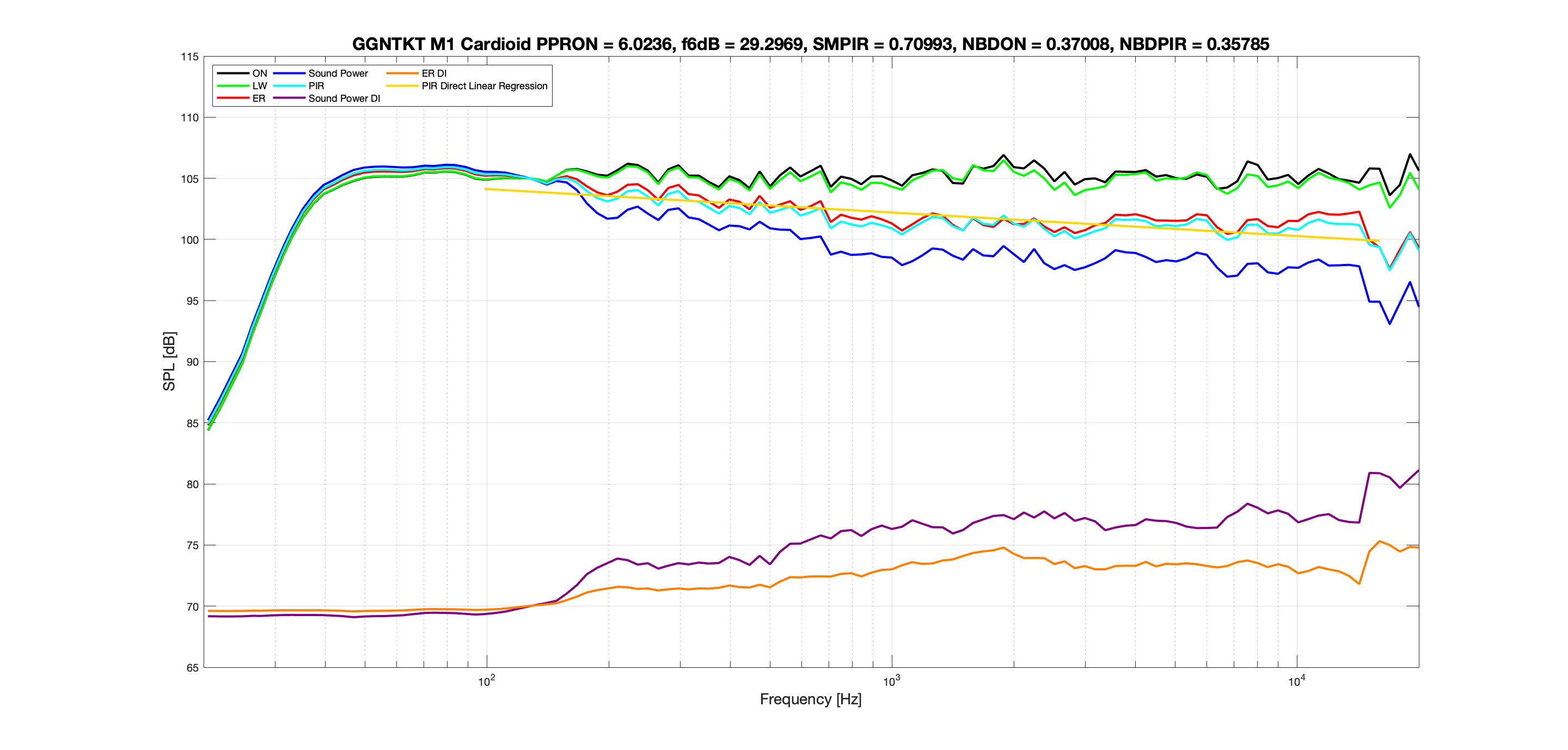

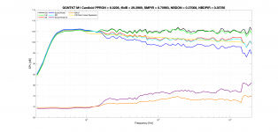

One example is the
GGNTK M1 in cardioid mode Spinorama I have generated attached with score and attributes in the title. The PIR regression does not fit the PIR well although it looks like it is a better approximation of the preferred In-room response
vs

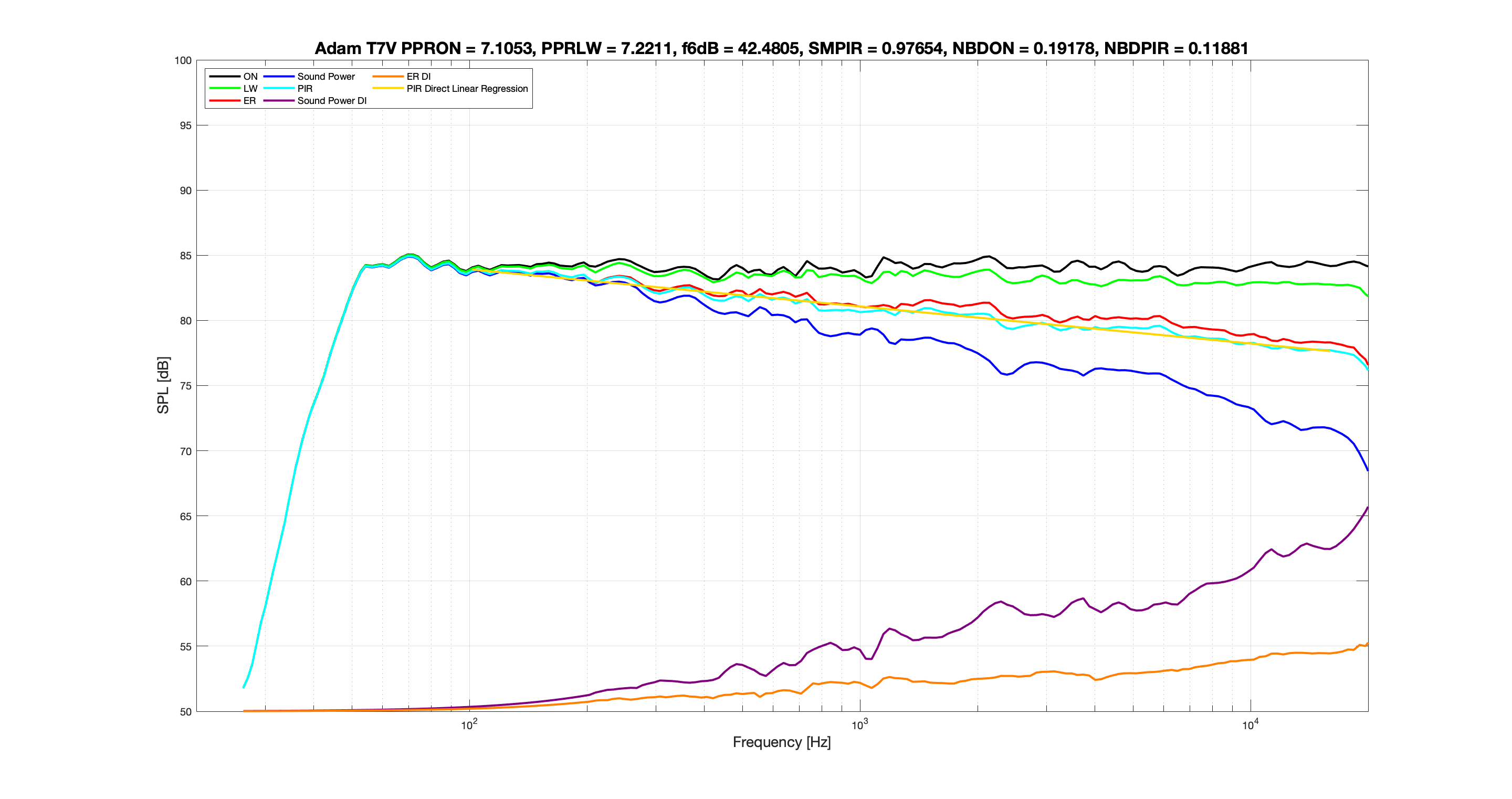

The EQed Adam T7V (EQed) almost text book slope. Spinorama I have generated attached with score and attributes in the title

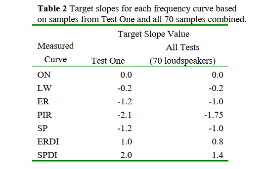

The same with me. What catched my attention this time is this quote from the Harman study (page 6):
"... Target slopes were determined separately for Test One and for our larger test sample (70 loudspeakers) used for the generalized model described in section 5. The target values are based on the mean slope values of speakers that fall into the top 90 percentile based on preference ratings. Target slopes are defined for each of the 7 frequency curves (see table 2). The ideal target slope for the on-axis and listening window curves (0 and –0.2) is identical for both test samples, which indicates that the on-axis curve should be flat, while the off-axis curves should tilt gently downwards. The degree of tilt varies among curves for Test One and the larger sample. [...] This suggests that the ideal target slope may depend on the loudspeaker’s directivity."
If I understand the units in Table 2 (see Eq. 5), for the PIR ("predicted in-room") slope this would be a downward tilt around 4 dB between 1 - 10 kHz (and around 2.5 dB for power response alone). Is that right?
Of course this may be due to the fact that no other loudspeakers (i.e with more flat, and maybe also higher, DI) were present in the test. Would loudspeakers with more flat and high DI be rated even higher in this test? That's what we still don't know, I think.

Just a point there:
It is believed that the table is wrong: probably a clerical error that swapped the SP line and the PIR line.
1. The PIR and the ER are almost identical so one would expect their slope to be also quite similar
2. It seems odd that the slope of the SP is lower than that of the PIR
There are some open questions regarding the paper but for our purpose here we don't need to get into them.
Yeah, you are most probably right. As the PIR is a weighted sum somewhere between LW and SP, it should be the other way.
My point is that even the best rated loudspeakers in that study didn't have flat power or in-room response (or DI for that matter). Yet the model simply assumes that the flatter the better. It can still correlate well for the particular set of loudspeakers (it could be simply because the flatter were also much smoother or with better LFX) but it doesn't necessarily mean that loudspeakers with "flat everything" would be really rated higher in actual listening tests. This is still only an assumption (and kind of extrapolation of the results) that was not experimentally tested.
