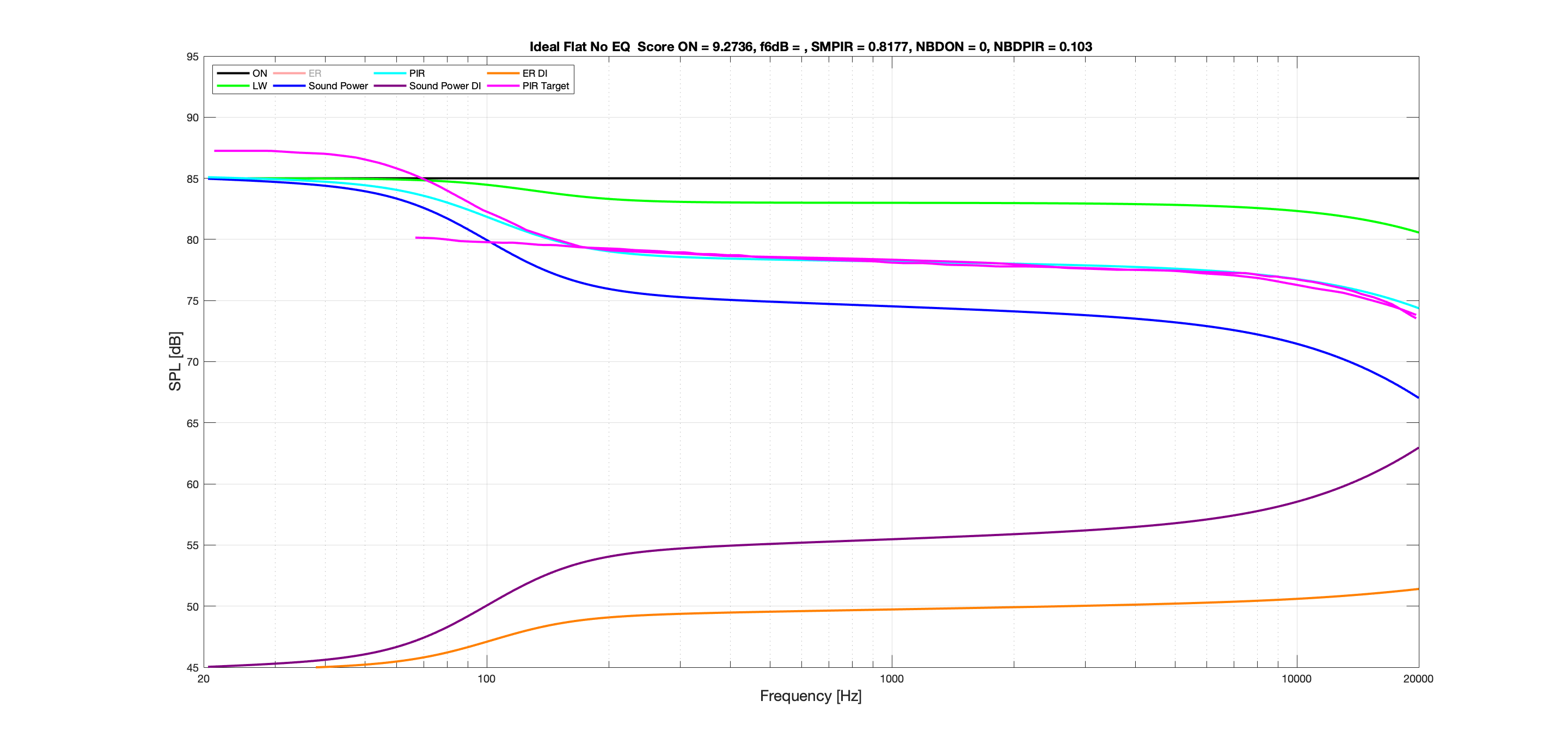

- I'm pretty sure that the new waveguides optimized for the following DI targets would behave as desired in all other aspects as well:
The point I was trying to make is the following:

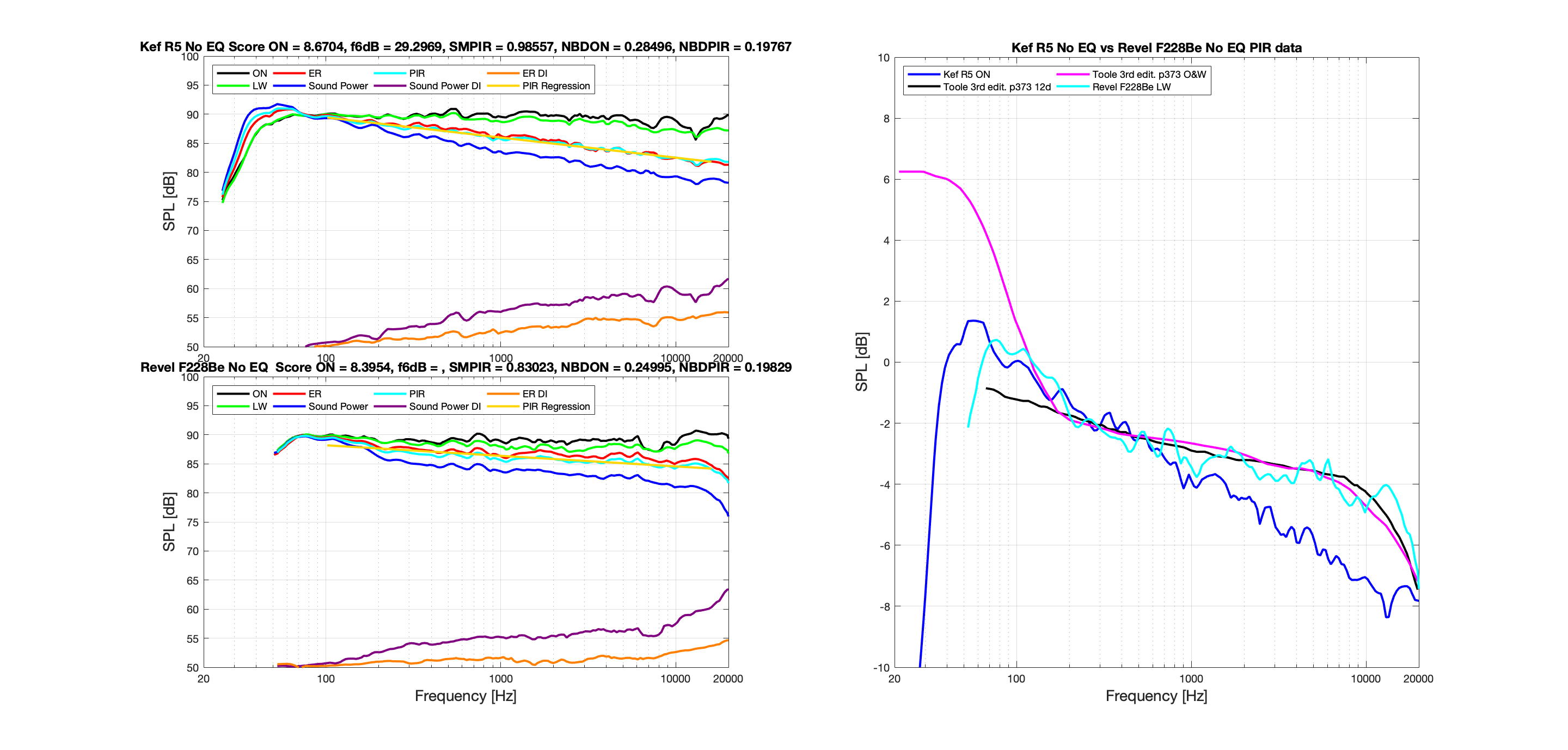

- According to the Harman research, there exists a preferred PIR response, see the PIR graph hereafter, the different version of the target are labelled Toole 3rd edit. p373 xx
- A model predicting the preference rating of a speaker should test against this PIR target and rate a speaker higher when closer to the PIR target, that’s my assumption but this is basically how the current model works albeit with the “target” being described by a line with a slope.
- The current model when applied to a speaker that exhibits a PIR very close to the target returns a lower value for SM_PIR than that of a speaker that exhibits a pure slope PIR (the former PIR target, as used in the current model) in the example Kef 0.986 vs Revel 0.830.
This is true for ALL cases except when the model is extrapolated to its limits i.e. when everything is flat, in which case the flat DI yields the maximum value SM_PIR = 1.
- It seems that in the general case the model has a built-in bias towards a PIR that is not the current preferred PIR response.
Therefore I am wondering if we could somewhat disregard the SM_PIR as currently calculated by the model.
The smoothness being still, at least partially, described by the NBD_PIR.
The NBD_PIR parameter working towards a flatter PIR over the 100 - 12000Hz range with seems to bode well with the observation made on the Revel speaker PIR and DI.
One more point, it seems that the DI should be designed higher, closer to 10dB rather than 5dB and down to about 200Hz or slightly lower, and close to omnidirectional below.
This should yield a closer LF output to the PIR target while keeping the rest of the spectrum untouched.
A very gentle slope will help as you showed with your hand drawn regressions compared with the KEF much steeper DI.
On the other hand, just boosting the LF by the 5dB below 100Hz would do a very similar job but the ON/LW is no longer flat.
The current model is simply kind of chasing its own tail (going as deep as into the full circle of confusion, in fact), that's the crux of the debate - is there really an optimal DI, all other variables as good as they can be? Nobody really knows because of the limited range of loudspekers tested, which were all still quite common. The "optimal" assumed PIR may still be simply a result of that.

I think the answer is in the preferred PIR curve...
The preferred DIs are those providing the flat ON/LW and a PIR close to target.
The DI should be flat and smooth perhaps with a very gentle upward slope.
Tellingly this is what Revel and JBL (and some others as well) have set as a target for their own speakers.
I have attached a mock up of that.
It more of a sketch to illustrate my point than a real design though.
