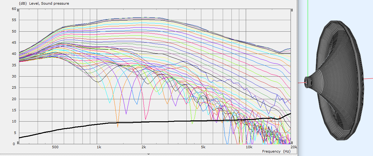

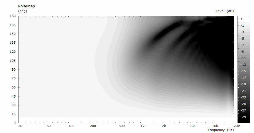

There is a trick, that allows you to calculate acoustic power response and DI using VACS just in few clicks. Firstly, you need set "Farfield" condition in the Spectrum script to calculate the Contour plot in VACS.
Code:
BE_Spectrum
PlotType=Arc
GraphHeader="nonnormalized"
BodeType=LeveldB; Range=50
PolarRange=-180, 180, 72
BasePlane=xy
Farfield
100 Inclination= 0.0 ID= 2000

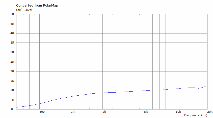

When the Contour plot is calculated in VACS, click the right mouse button on it, select "Projection..." --> "Power spectrum" tab and set tick to calculate acoustic power response and adjust it to the point source SPL. In the the "y-Integration" tab select desired angle to average SPL. Then you can calculate DI simply as difference ("Processing"->"Calculates curves n->1"...) of averaged SPL and Adjusted power response to the point source.
P.S.
Similarly, you can calculated DI of any non-symmetric 3D source by using "Baloon" graph.

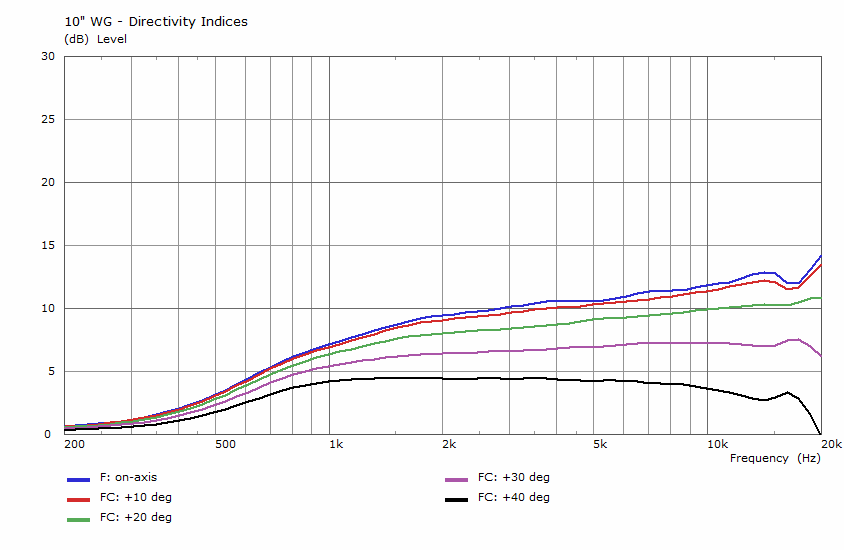

I just need to note, that DI of a flat baffled piston has exact analytic solution and theoretically it's DI should not decrease below 3.01dB at very low frequencies. However, numerical VACS solution for the same model showed a slightly lower value, ~2.3dB, although otherwise the both analytic and numeric solutions were very similar (the results can be find in this post Acoustic Horn Design – The Easy Way (Ath4) ). It would be interesting to know why and where VACS lost ~0.7dB
Simulated DI (10 deg) for the 10" waveguide presented before (#3796), where it was taken for 0-90 deg only.
