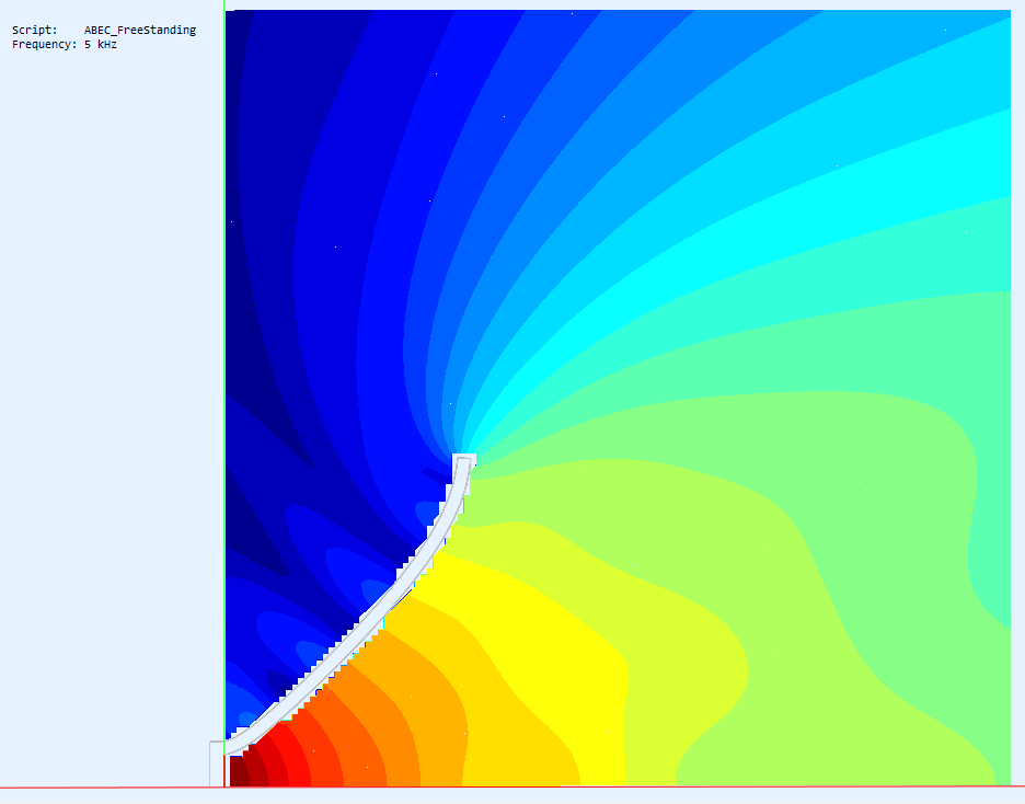

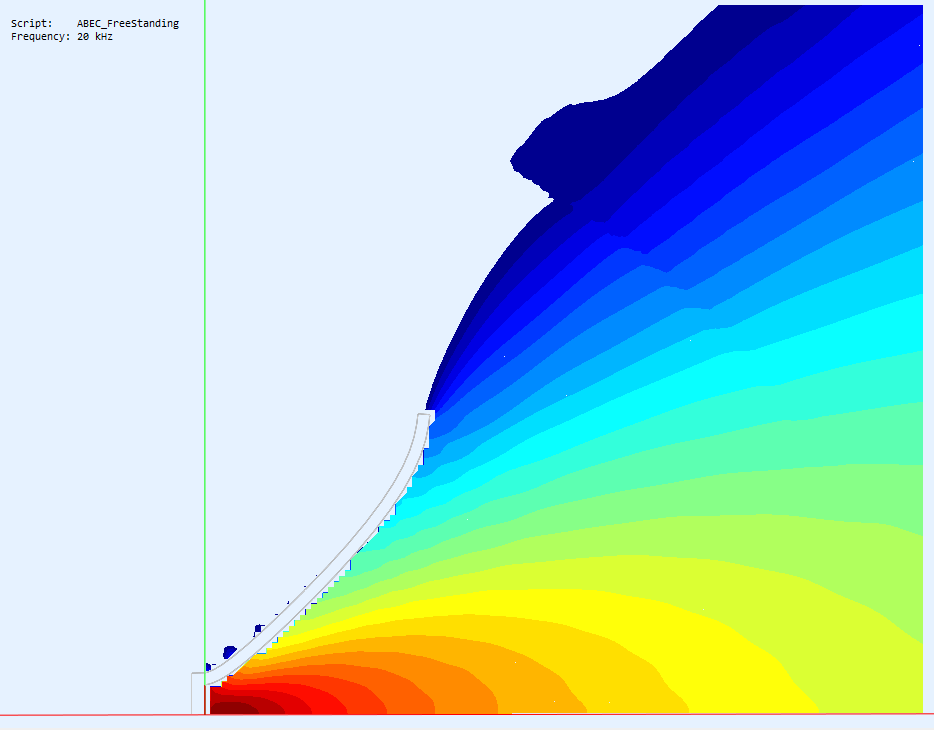

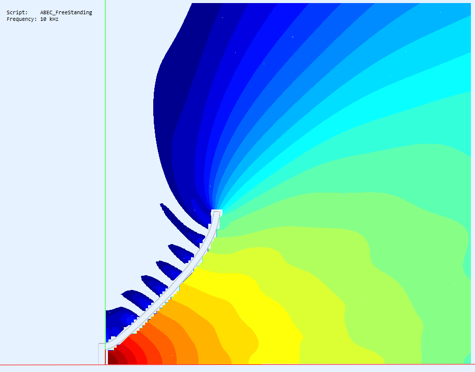

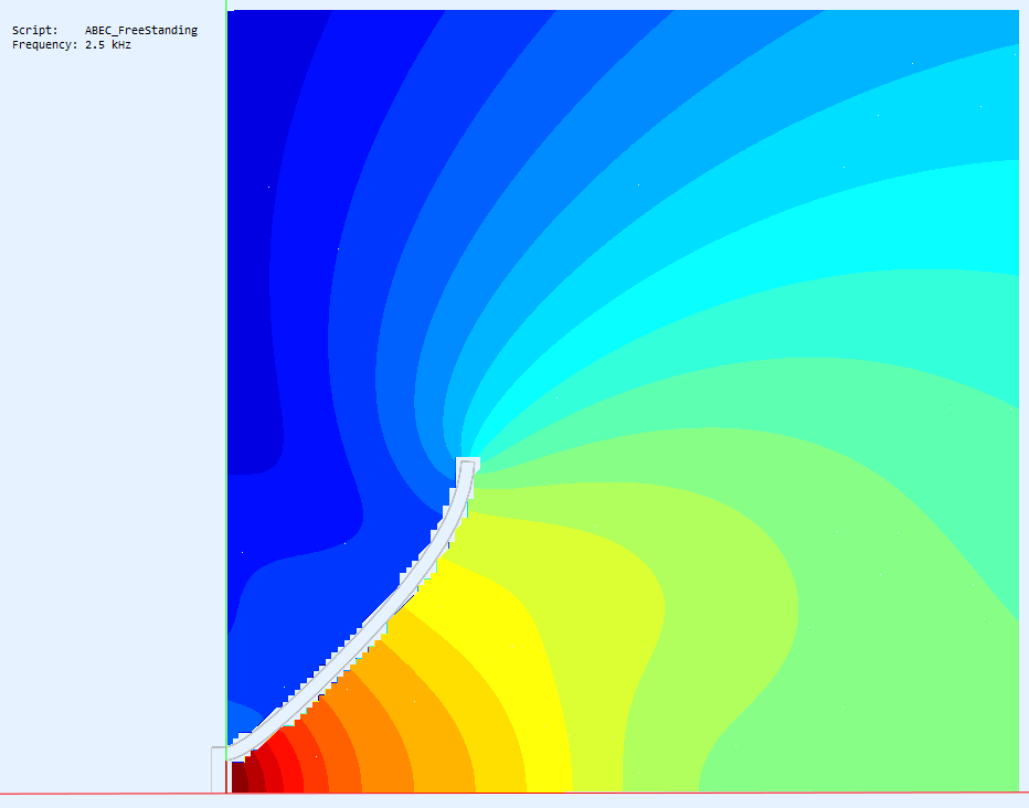

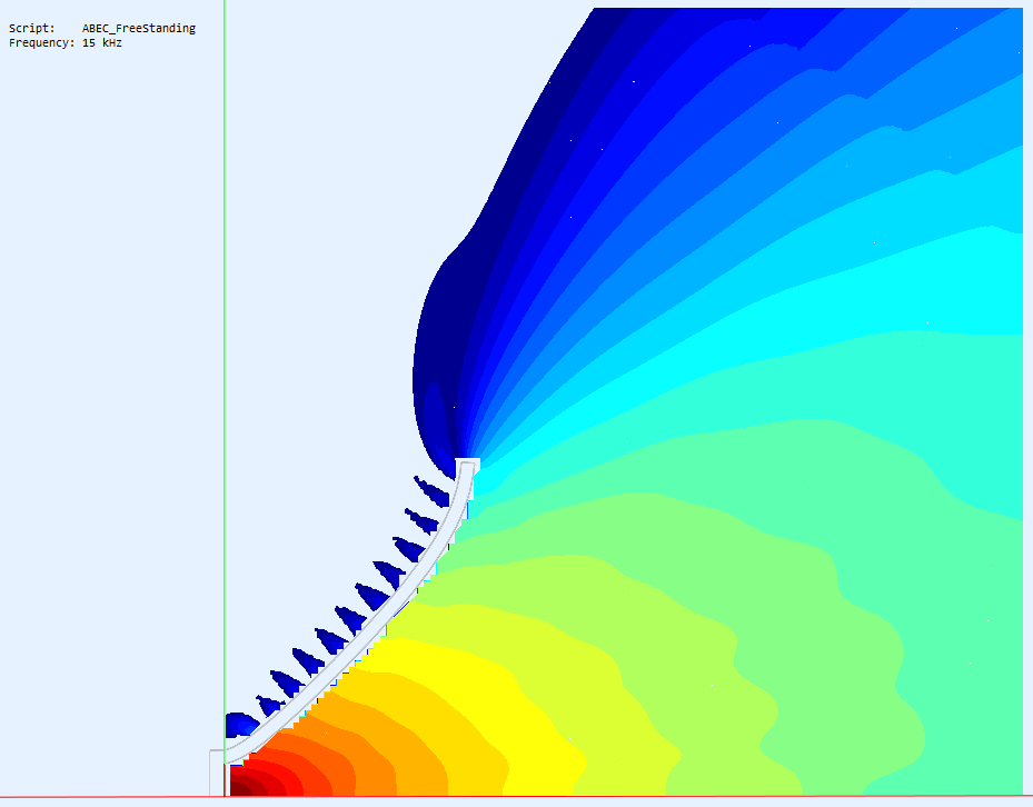

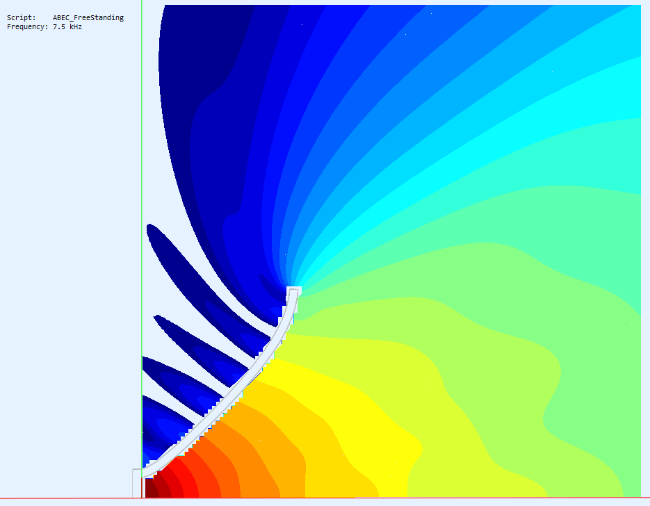

- Some pretty pictures (2 dB step) 🙂
Linear frequency abscissa...
I think that for an axisymmetric waveguide development we can't wish more.

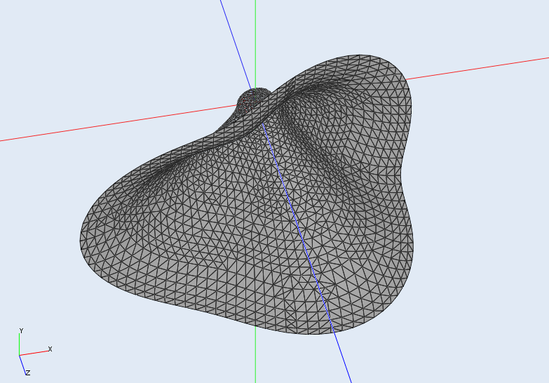

Any dirty way to make ath generate half a mesh in stead of 1/4 one?
The idea of messing around with asymmetric designs is so compelling 🙂
Like this? Wait for the next release... 😉
There will be four options, finally (no matter what the underlying shape is):
a) quadrant 1 only (currently the only possible)
b) quadrants 1+2
c) quadrants 1+4
d) all four/no symmetry

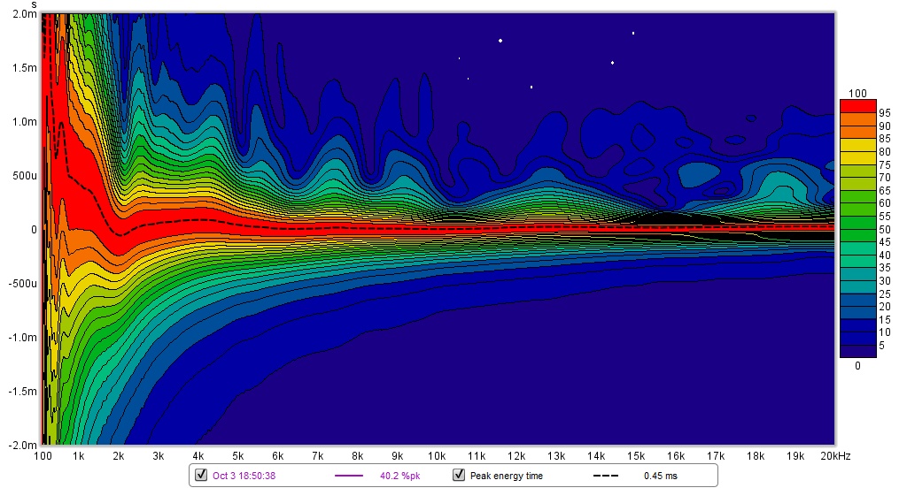

Do you know if there is an idiots guide to understanding what is the expectation in a wavelet spectrogram.
1/12th resolution
6ms before peak
10ms after peak
Or what ranges to use on the chart in order to see what needs to be seen? ;-)
1/12th resolution
6ms before peak
10ms after peak
