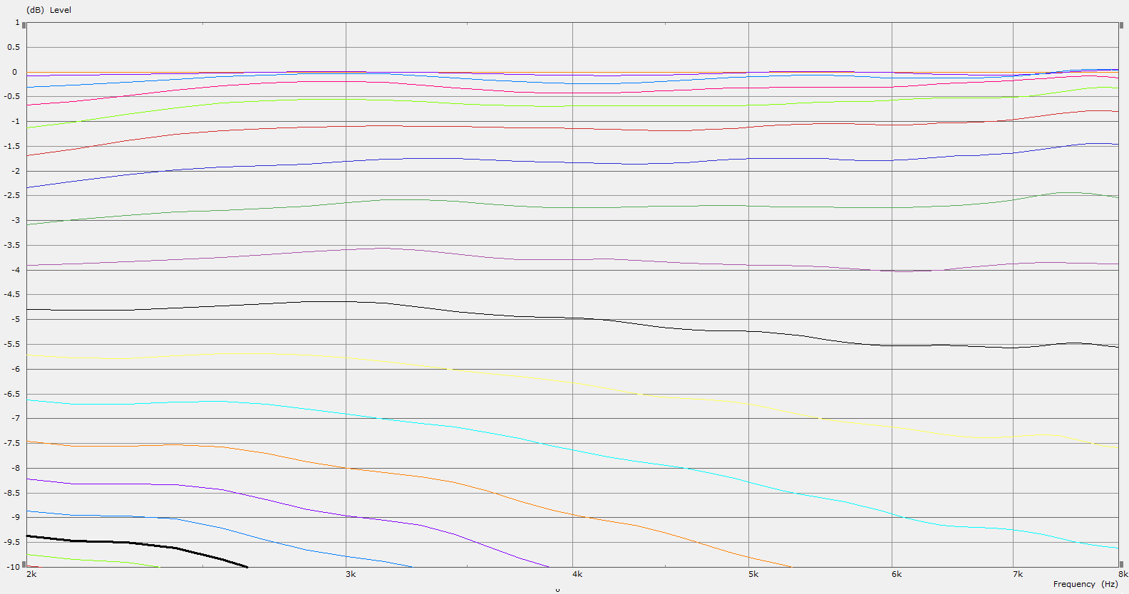

Iteration 39, 2k to 8k region zoomed. Looks good?

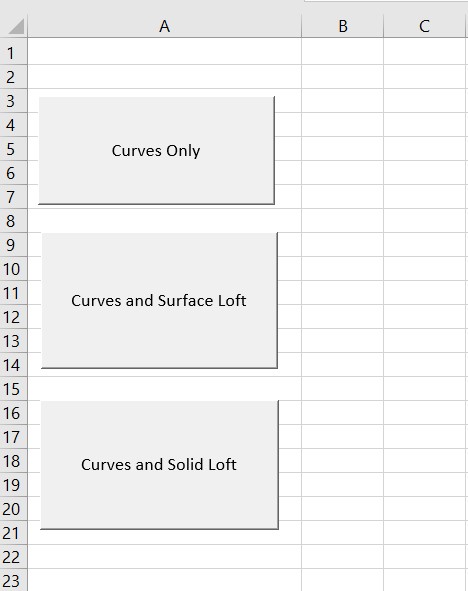

Updated Excel Macro Full Auto Loft
I've managed to hack together some more code to make the Excel macro a one click import and loft to curves, surface or filled solid via three buttons.
attachment.php
Updated Instructions to follow.

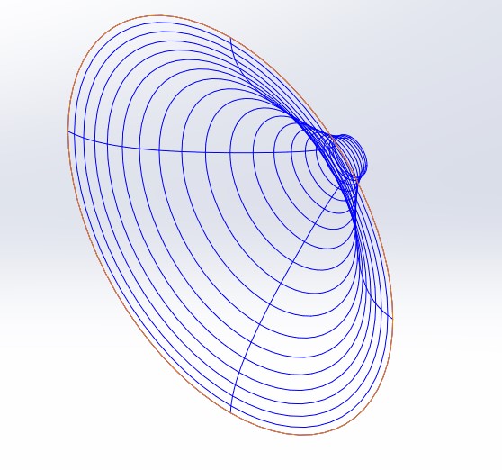

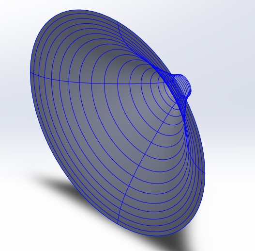

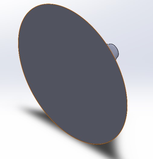

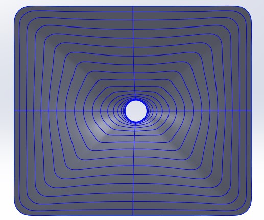

Back to the Ath 4.6 for a while, this is a simple example how different profiles can be blended together.
This is the definition file with both profiles blended:
