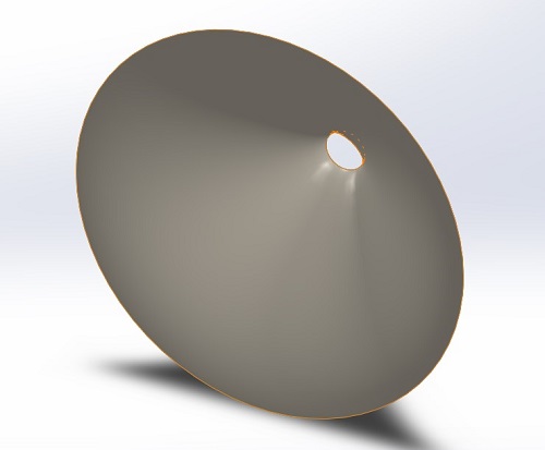

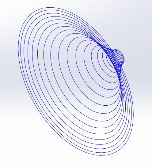

I've found a way to get the Coordinate Slice Points into Solidworks as a curve.
I have made a macro by hacking together some other macro code I found online. It works quite nicely so I thought I would post it here in case it is useful for anyone else.
Each file has to be imported separately which is a pain but it is in reality a few clicks per curve. Functions that can import more than one file are considerably more difficult to get working.
Instructions included in the zip file.
Macro Button Added to Toolbar
Curves
Surface Loft

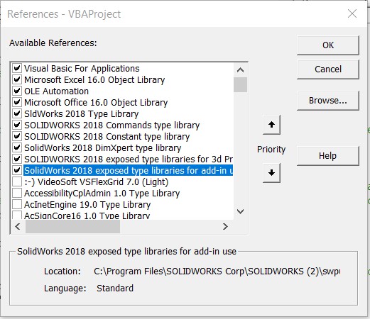

This is a fully automated way of importing all the curves at once but it needs to use Excel to leverage it Multi File Selection abilities.
The macro is attached. It took me a while to work out that I needed to include the solidworks references. This will be need to be checked as each system might have different reference versions.
In the Developer tab of Excel (Hidden by Default) click the Visual Basic Button which will open the editor. Then click Tools>References
Check if the Solidworks references have been checked. Without them this code will fail. Should look something like this
Follow the instructions in the Readme from the previous posts zip attachment as they explain how to process the text files.

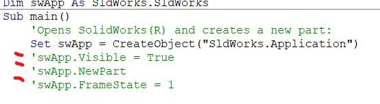

The code as it is here expects a new blank part to be open in solidworks. It can be made to open solidworks and make the part by uncommenting the three lines shown here. Just remove the ' from the front of the line.
Otherwise it is as simple as pressing the Run Macro button in the sheet 🙂

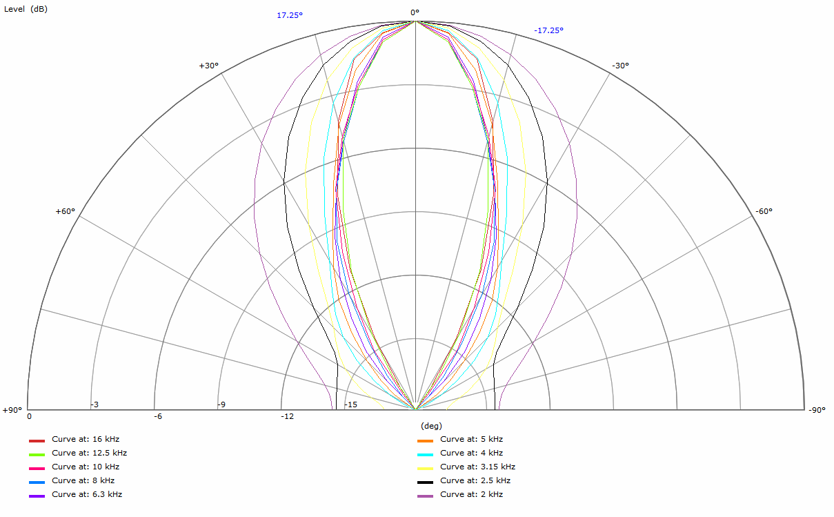

Out of cusiorsity for you use these settings for that chat chart back then? Trying to compare my version to yours.
ABEC.Polars.Step = 7.5 ; [deg]
ABEC.Polars.Points = 8
ABEC.Polars.PMapNorm = 10 ; polar map normalizing angle [deg]
Current iteration for 1" with following ABEC settings. A few more iterations should have the curves slightly flatter, I hope.

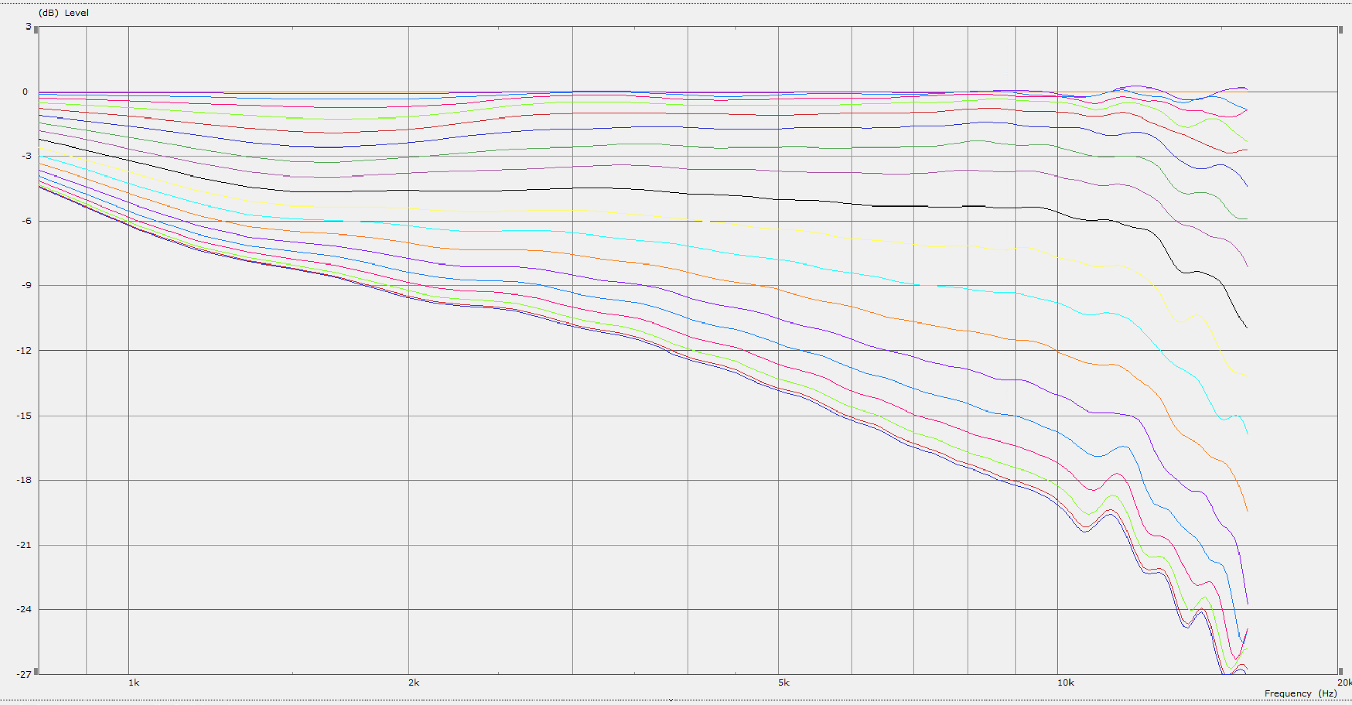

Interation No.28
30deg and 40 deg off axis. Comments welcomed.

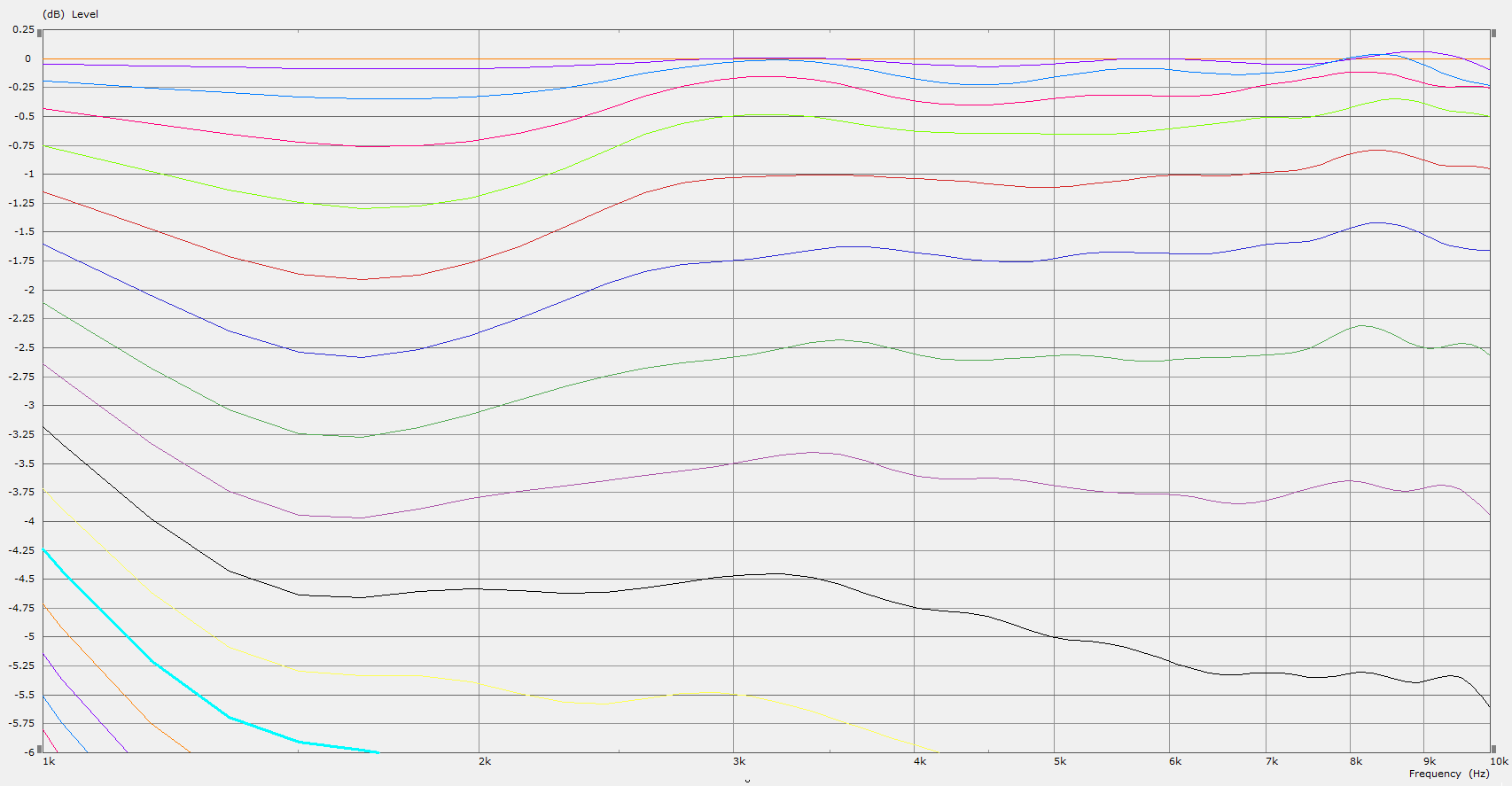

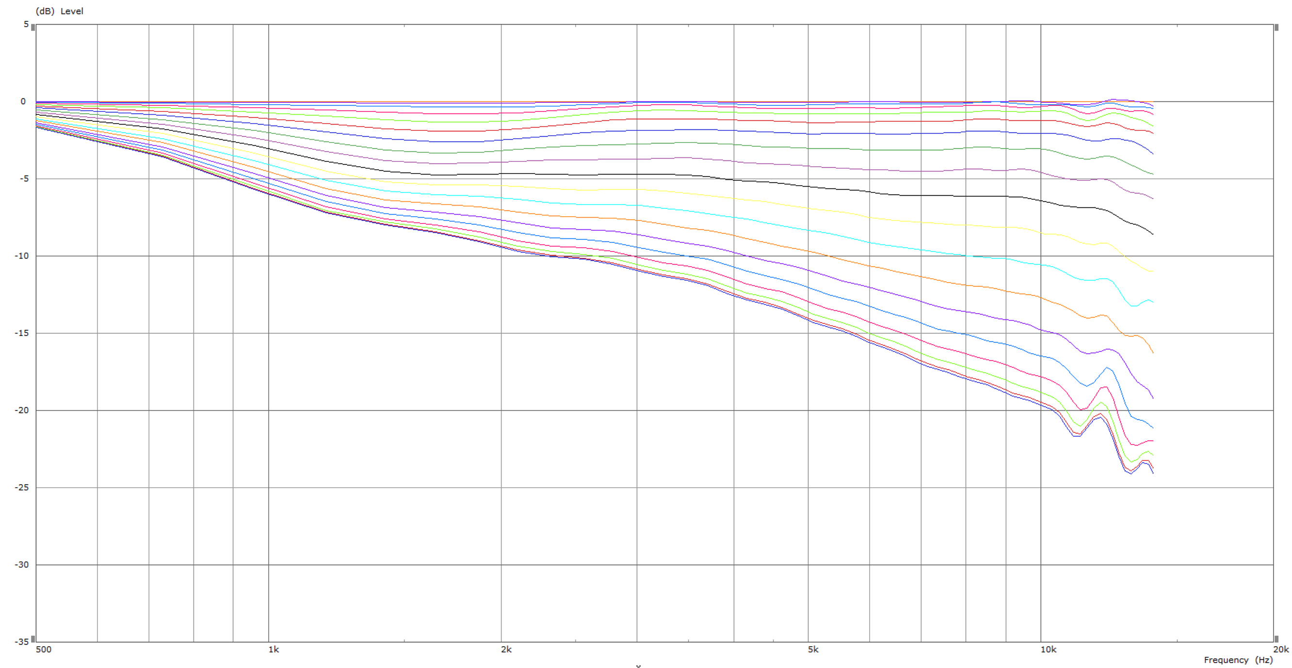

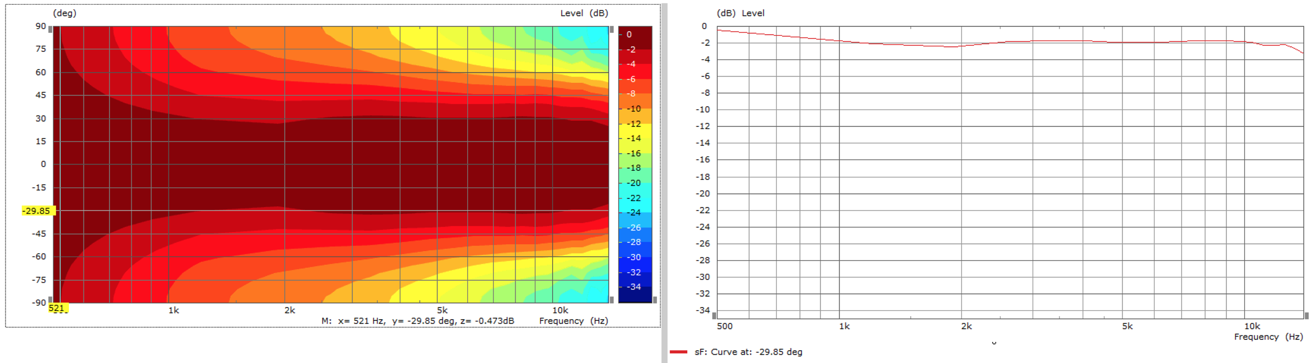

Iteration 29. Zoomed in. Fairly flat to within 0.5db 800 to 12.5k including off axis. I want that 3k bump flatter. Crazy talk.

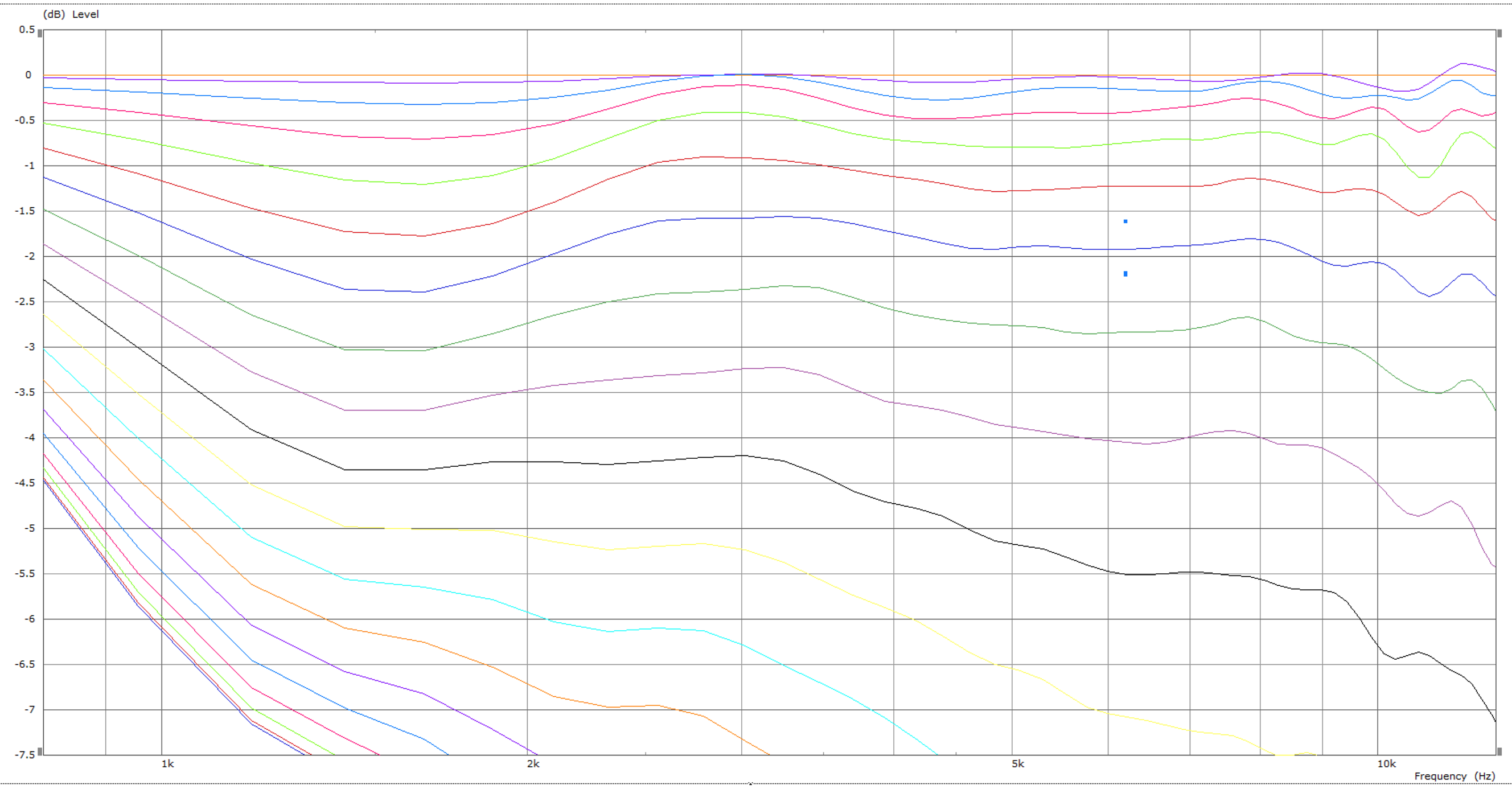

Iteration 31.
Improved flatness 3.5-12k. Next task that 1.7k 1db dip.

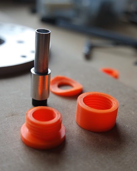

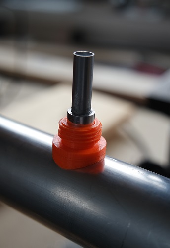

I'm making prototypes of the PWT mic mountings - this is actually my first attempt to 3d-print anything useful. I think I'm going to drill the big 8 mm holes into the tube and make it all 3d printed. It's much easier after all.
You're almost there 🙂

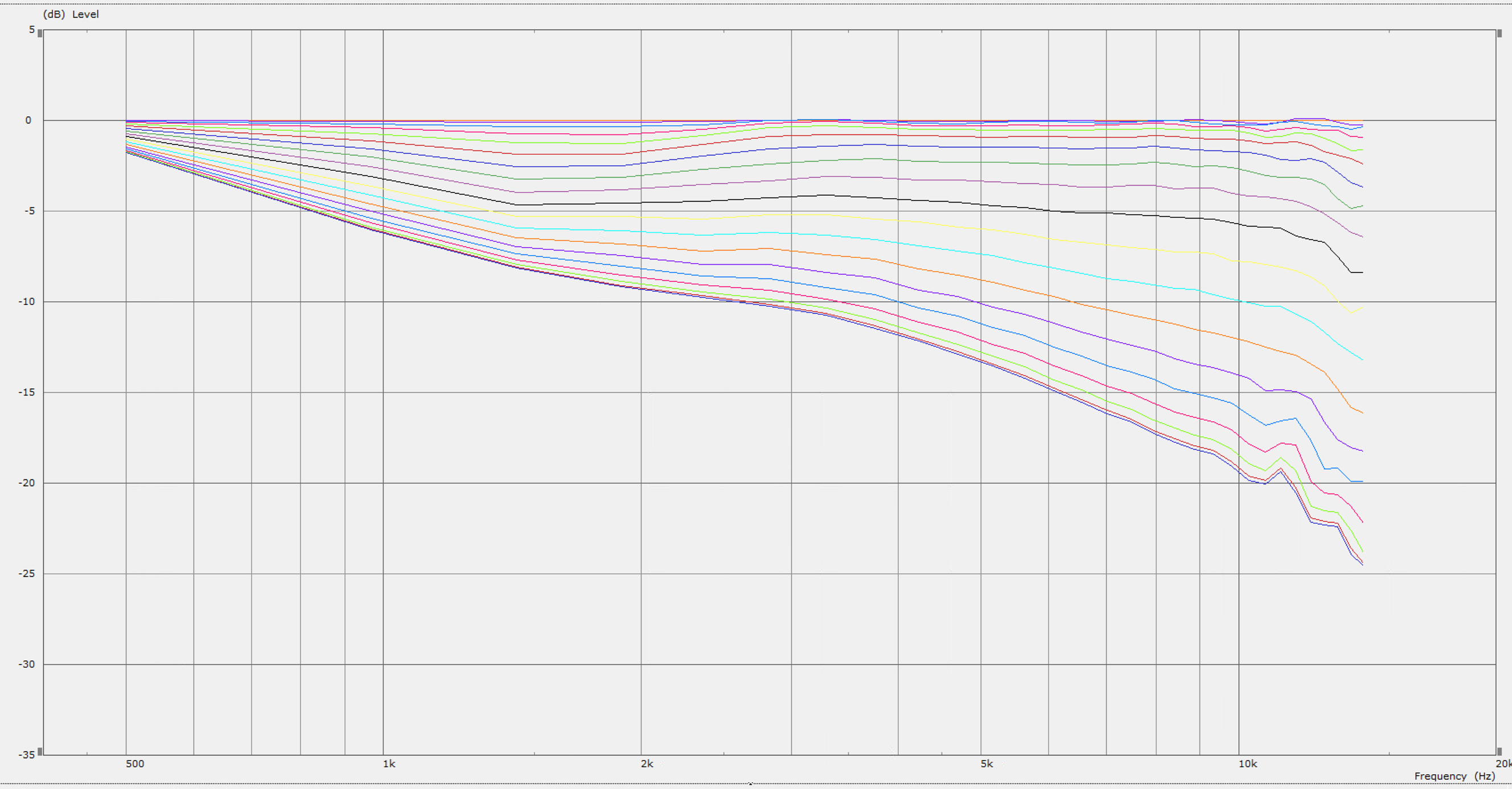

So close - iteration 32 zoomed. When is close good enough?

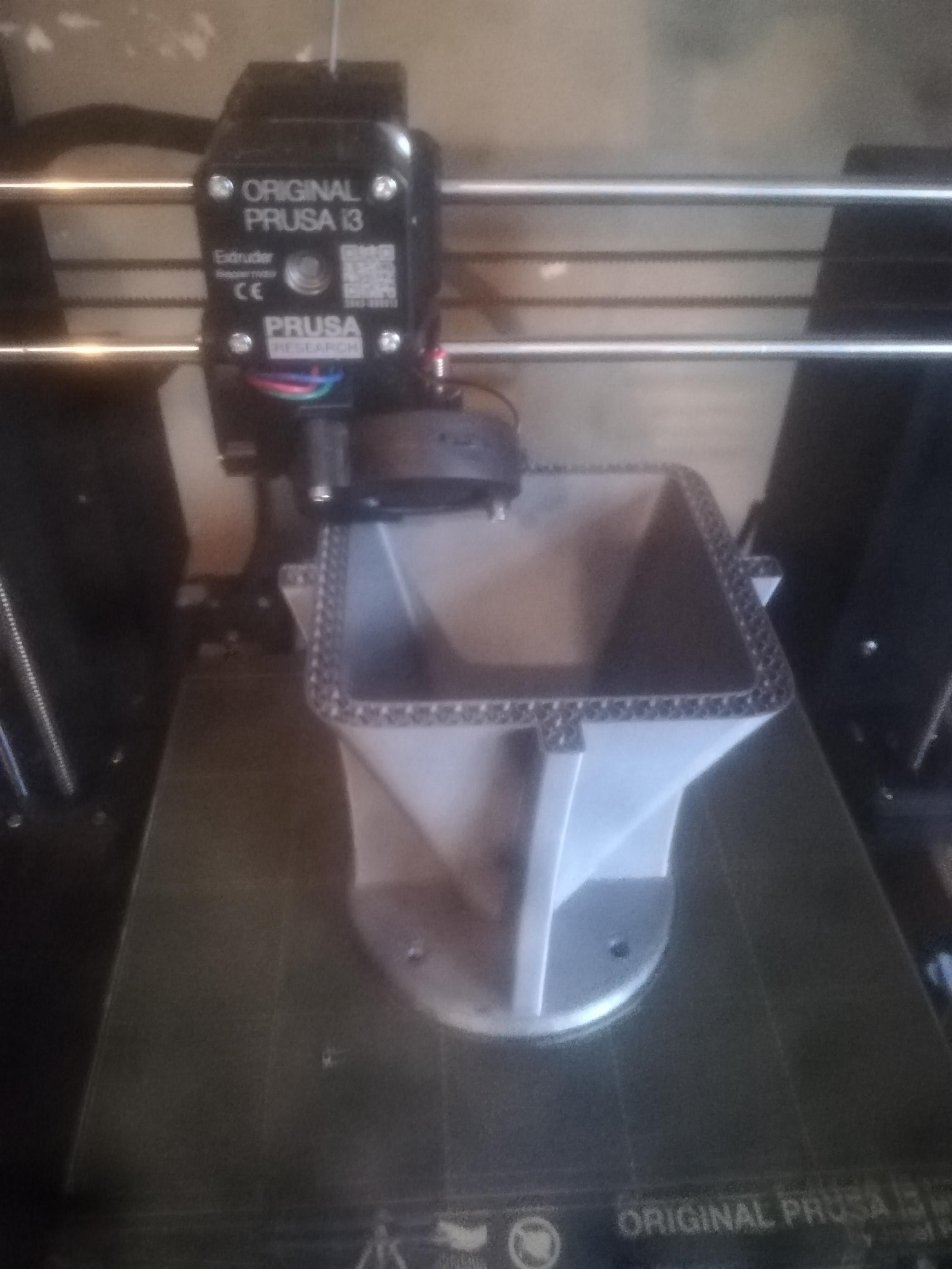

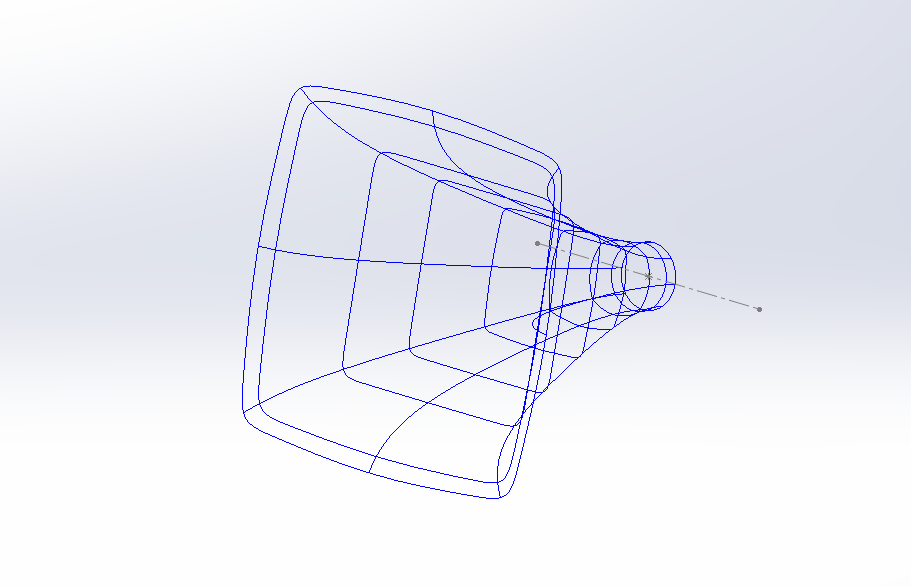

Hi everyone,
First contribution on Diyaudio, I'm a long time member but only reading until today 🙂
Just wanna react about solidworks. I don't use Fusion360 I really don't like (even If I use autocad a lot, fusion360 is not for me)
So I tried to import Ath data (slicing and curve) into solidworks, and it worked perfect (after few iterations).
Here is how I do it:
- First of all configure output in my ath script
Output.Coords = yes
Output.Coords.NumProfiles = 8
Output.Coords.Scale = 1
Output.Coords.SeparateFiles = 1
Output.Coords.FileExt = txt
Then open all profiles txt files in notepad++, and remplace(Ctrl+H) ";" by Tab ("\t").
Do the same with slice txt files, but you don't need all of them. The first one and the last one are crucial (and not enough), and take some slice between this two. Remplace ";" by tabs, saves all the files.
Run solidworks, create piece.
Go to Function>Curve>Curve with XYZ coordinate (I'm not sure of the exact name since my version is in french)
Import all the files (yes It's a bit long)
Go to Surface>Lofted Surface
Select profiles for profiles (yep, logic) and slice as guide
And done, now you are in a surface model.

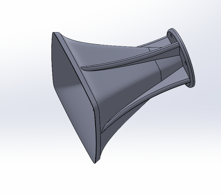

Here are some image of the waveguide I'm working on.
This prototype is printing at this exact moment

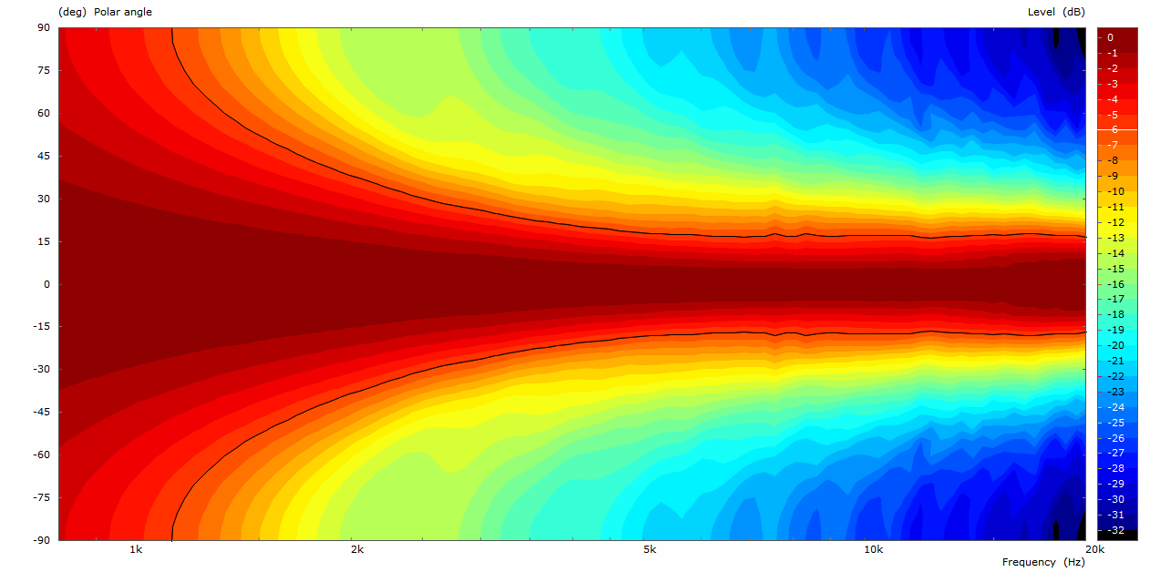

Result!
Iteration 37 is flat to +/- 0.4dB 1k to 12k, 0 to 43 degrees off axis.
Size - 15" x 11" x 108mm
Now looking at vertical dispersion / height to see I can compact the design for smaller C-to-C.
