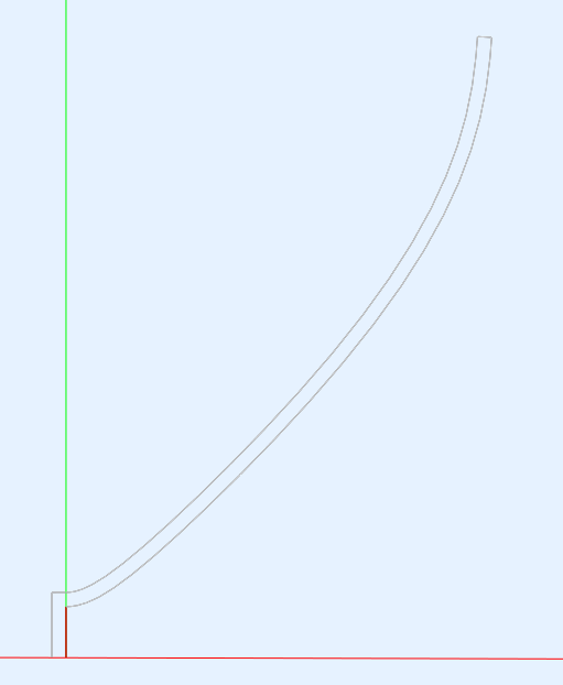

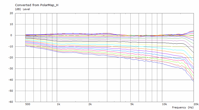

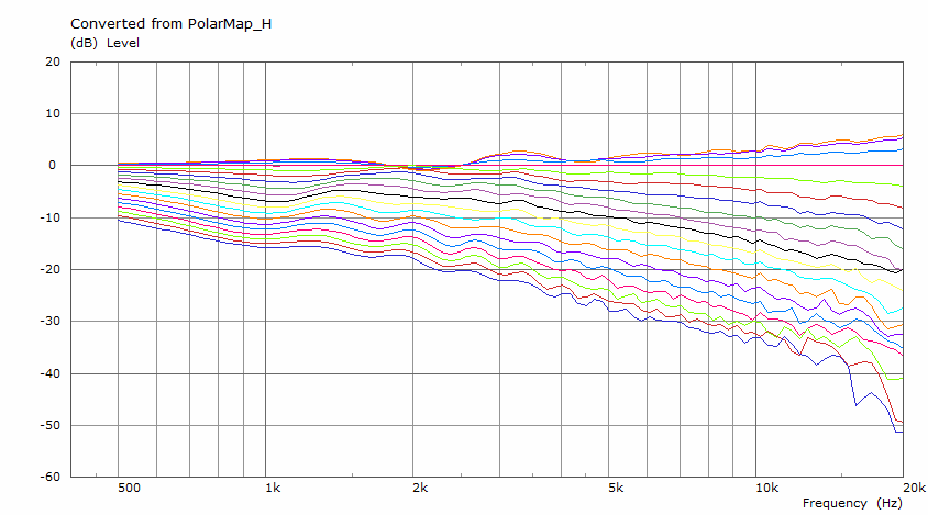

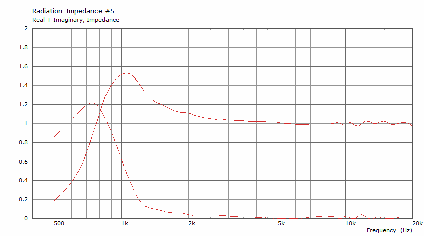

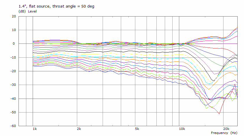

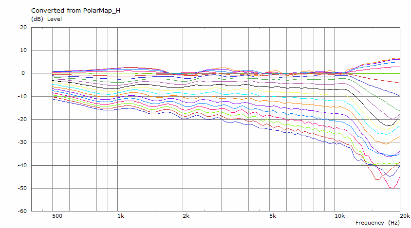

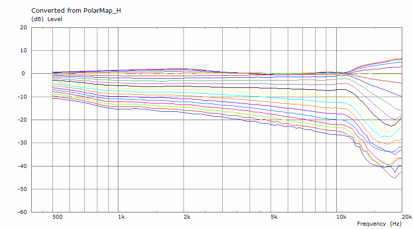

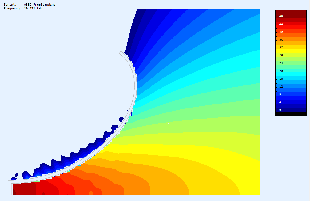

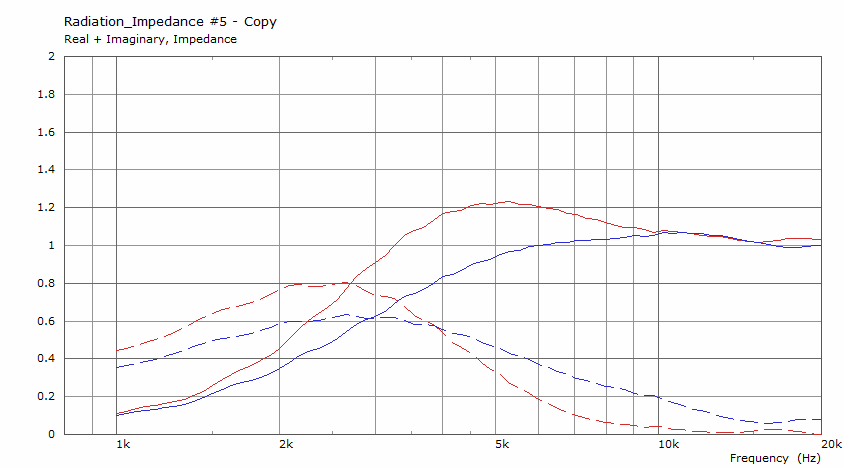

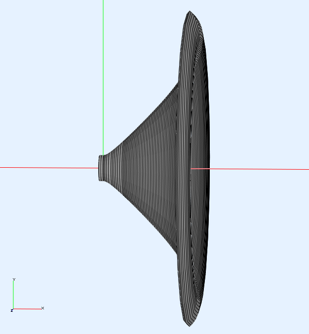

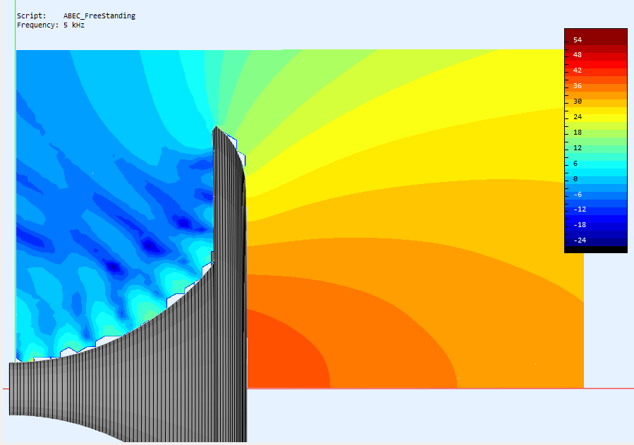

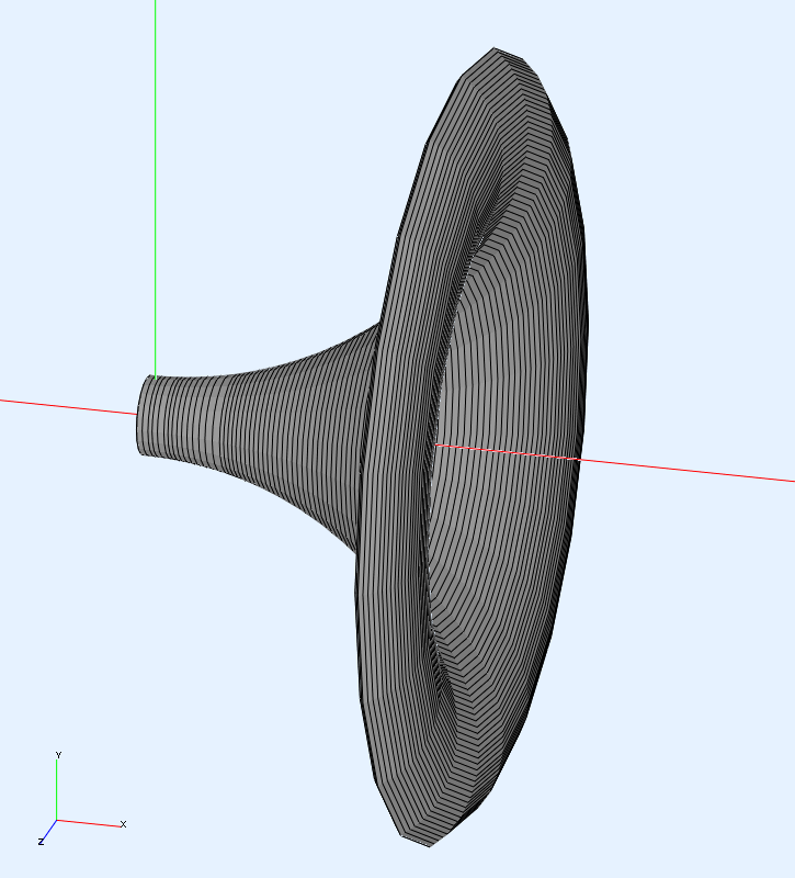

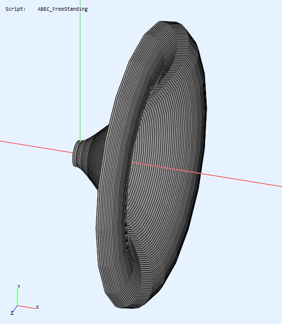

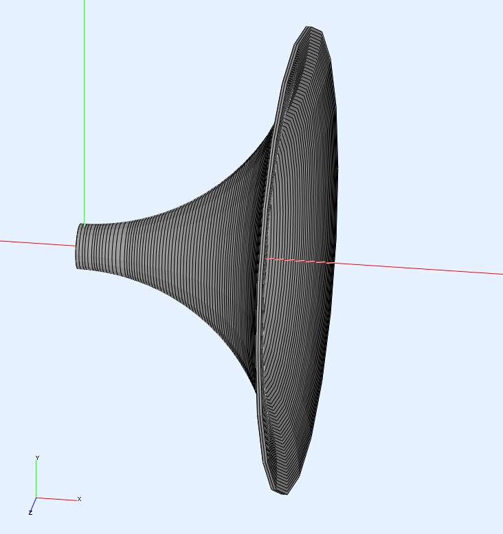

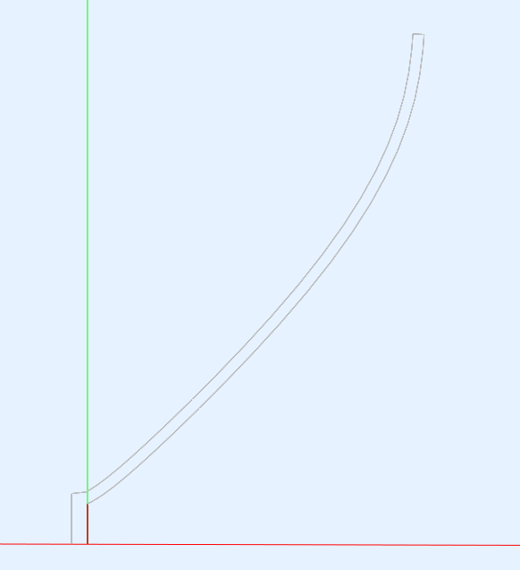

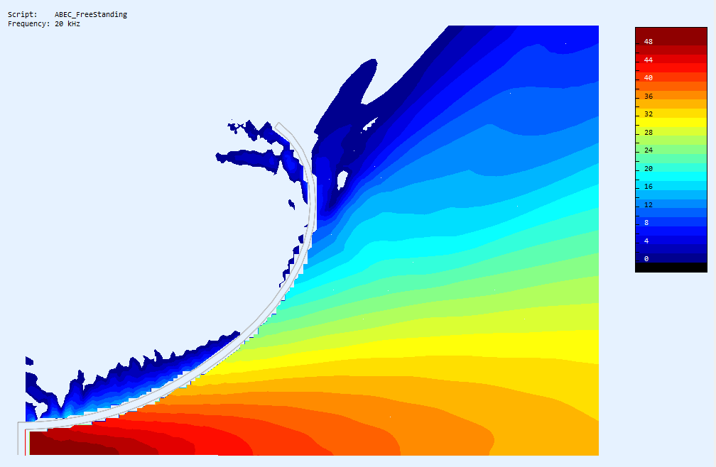

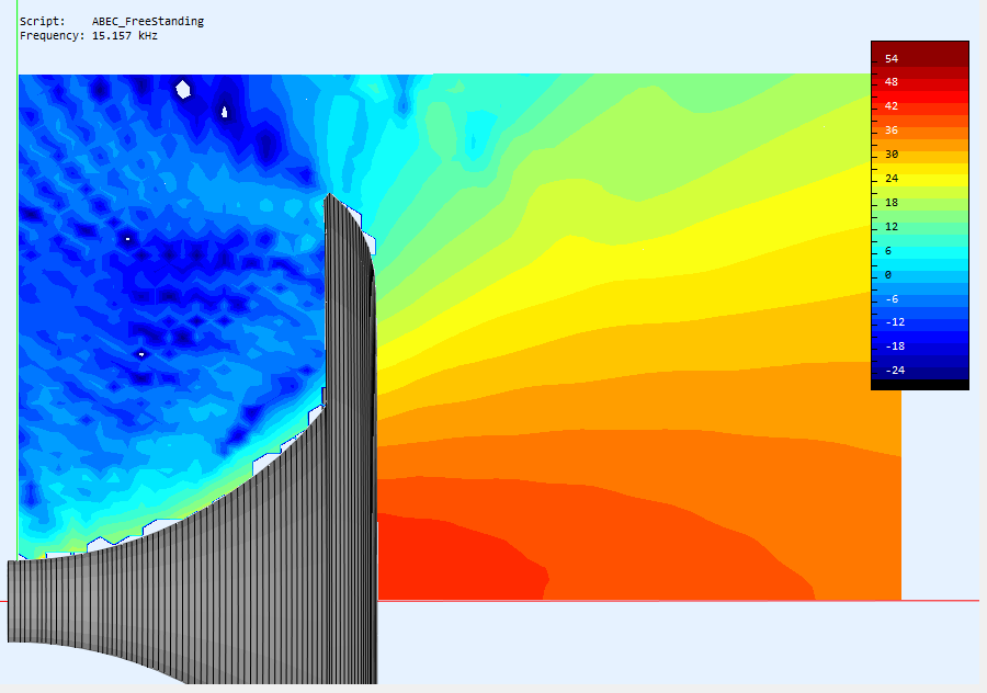

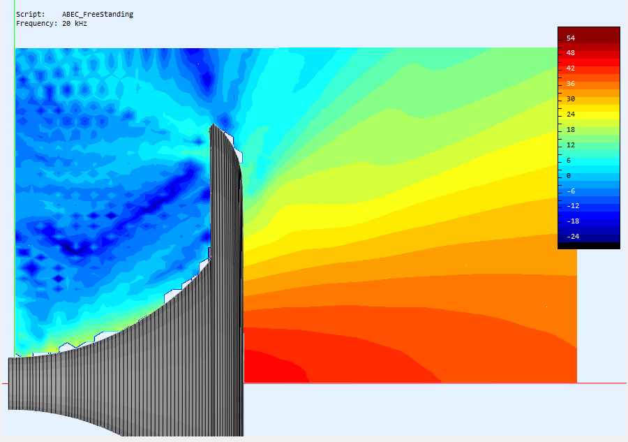

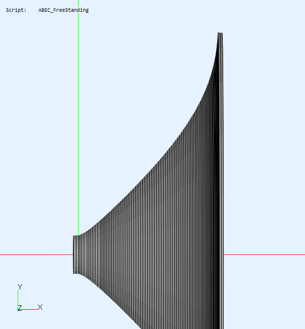

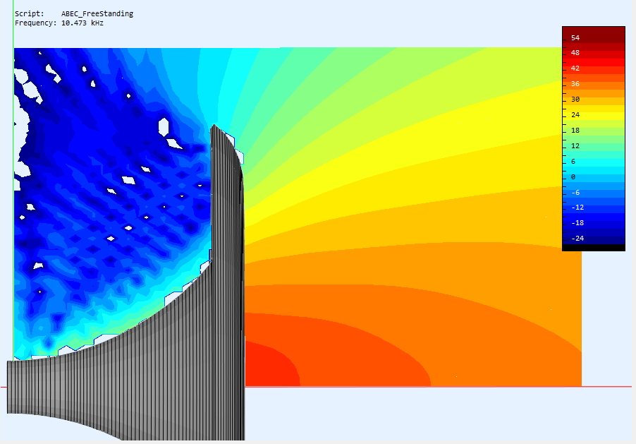

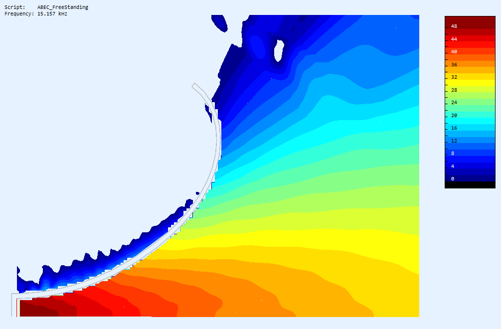

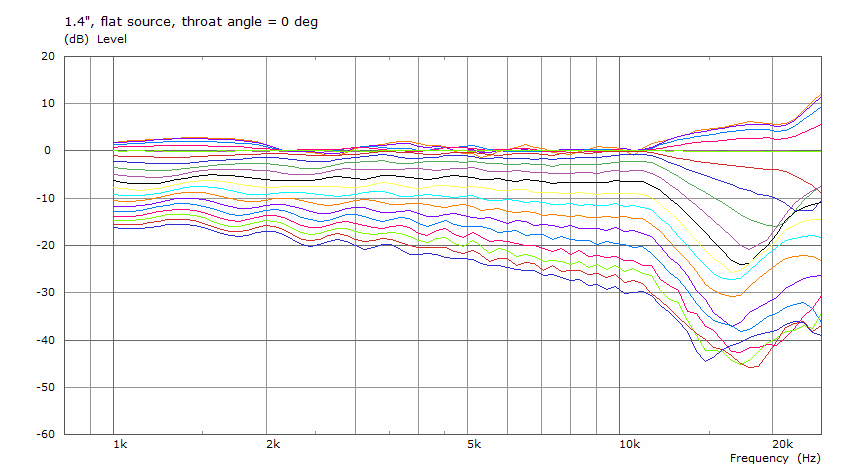

Just an experiment - 1.4" throat driven by flat wavefront (axisymmetric free-standing waveguide ~ ⌀450 x 150 mm):
a) throat angle = 0 deg
b) throat angle = 50 deg

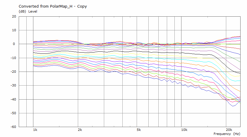

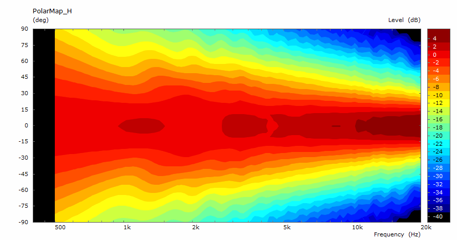

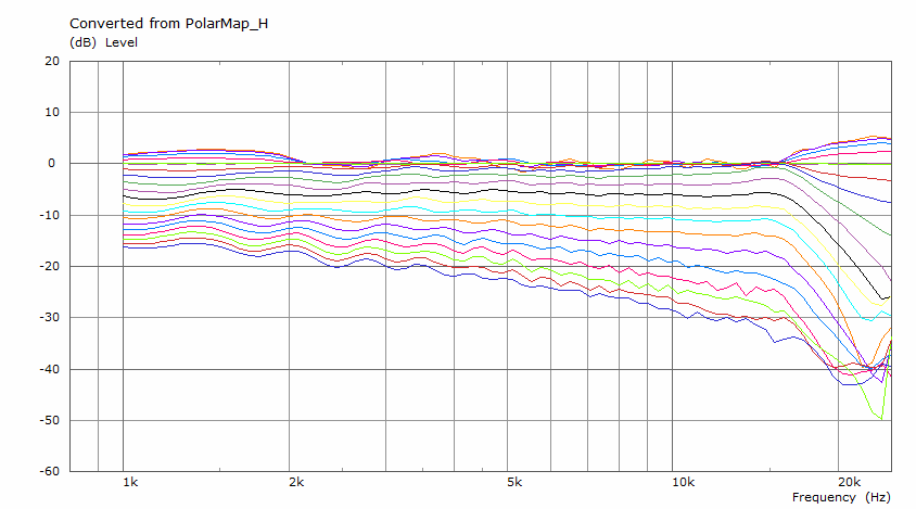

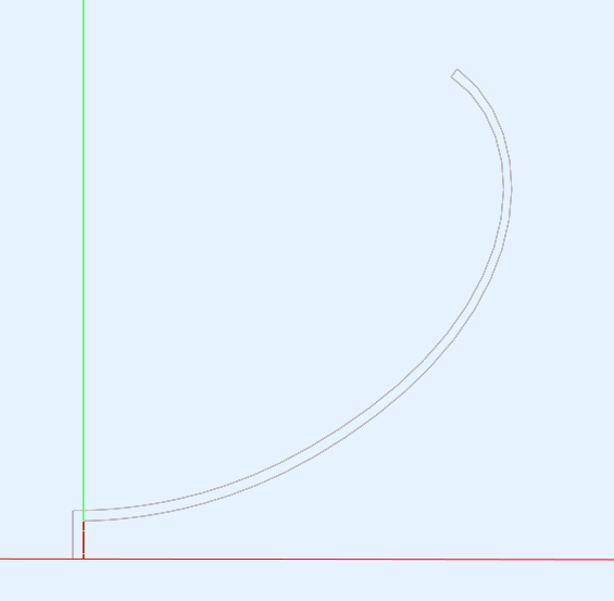

1.4", ⌀500 x 175 mm including rollback.
The time of huge enclosures is over 🙂

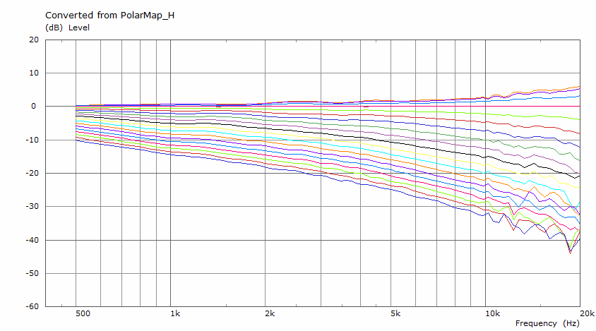

I have no clue what it could be compared to - it's simply a rolled-back circular arc. It beams, that's for sure, although very gradually. In the end it isn't any more directional than the other ones in the highest octave, which is interesting. Don't ask me what's better.
Once again, little more.

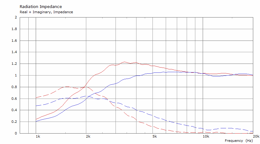

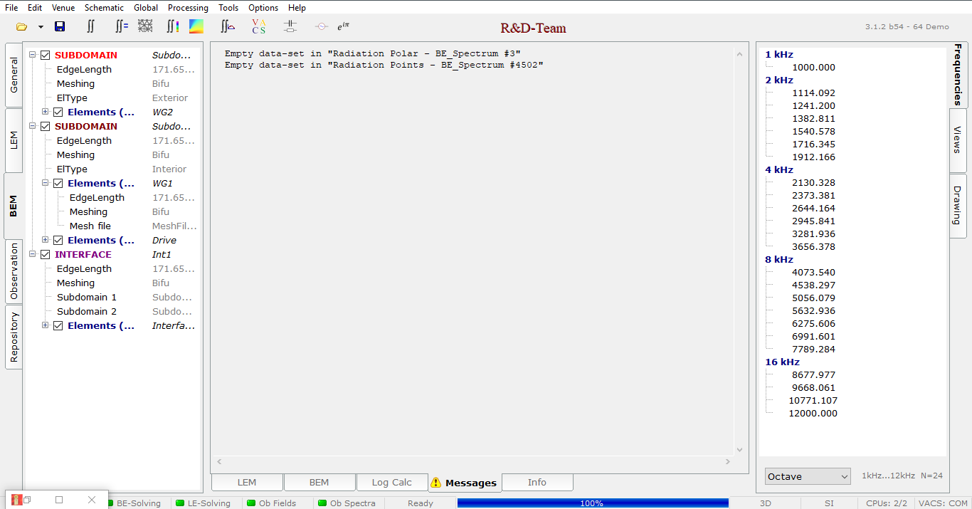

A question:
I tried to run a modified demo11, but got these messages.
Any ideas?
Any ideas?
Good to see the experimental profiles mabat!
These are the answers to my questions, so to speak.
To me personally, the horn in post # 3429 is most interesting, but who am I? 😉
The directivity, while not optimal, is still nothing to sneeze at.
I like this already:
Smooth HF rollof is preferred in a room? One could plot acoustic power vs. Harman's curve.
