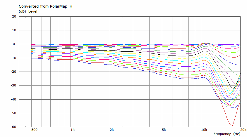

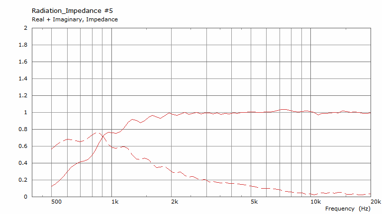

BTW, the circular profile is quite sensitive to the actual shape details. It is not automatically this smooth. If it was possible to make it slightly more CD, that would be awesome. Definitely, there's still room for experimentation.
Once axisymmetric, it should be really easy.
The great thing is that all these high-resolution simulations take less than a minute each. I should have started with these...
BTW, the circular profile is quite sensitive to the actual shape details. It is not automatically this smooth. Definitely, there's still room for experimentation. If it was possible to make it slightly more CD, that would be awesome.
You seem to be making my points for me 😉
That said, the last horn should already provide satisfactory results.

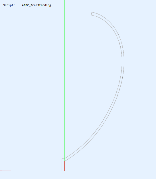

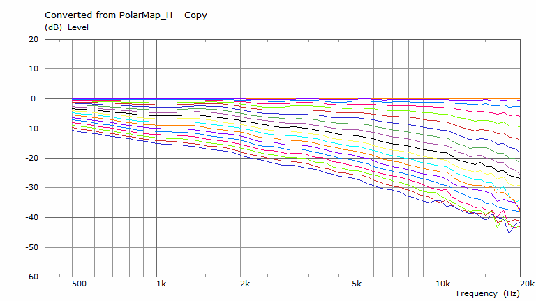

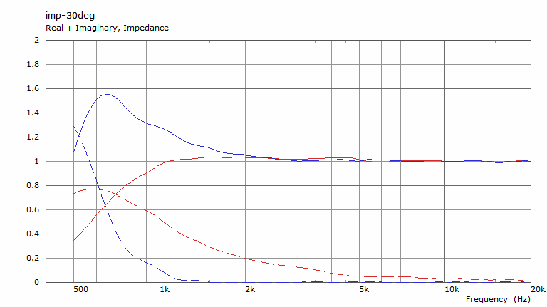

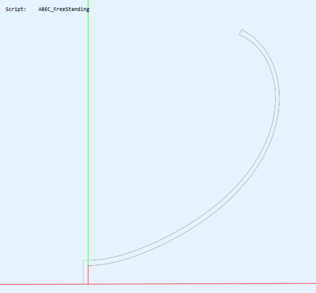

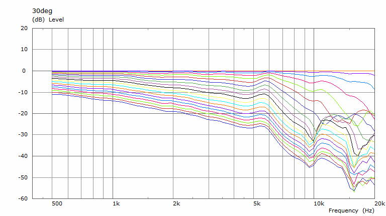

The last profile rotated 30 deg (anti-clockwise on the picture, i.e. "opening" the waveguide).
Seems like a strong higher order mode(s) cut-on above 10 kHz due to the throat wavefront boundary mismatch, perhaps?

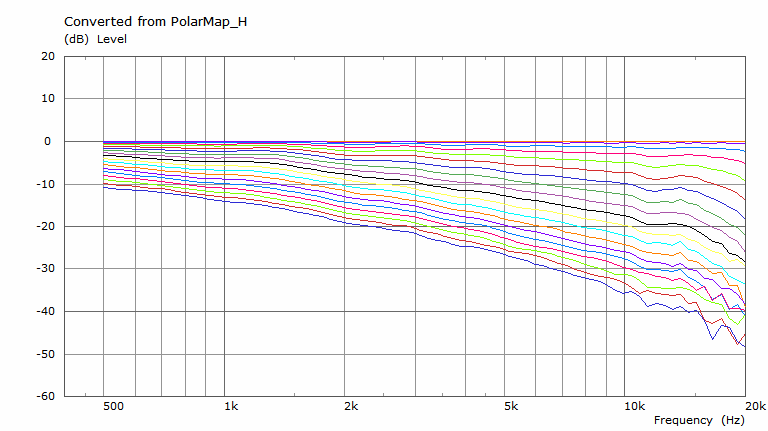

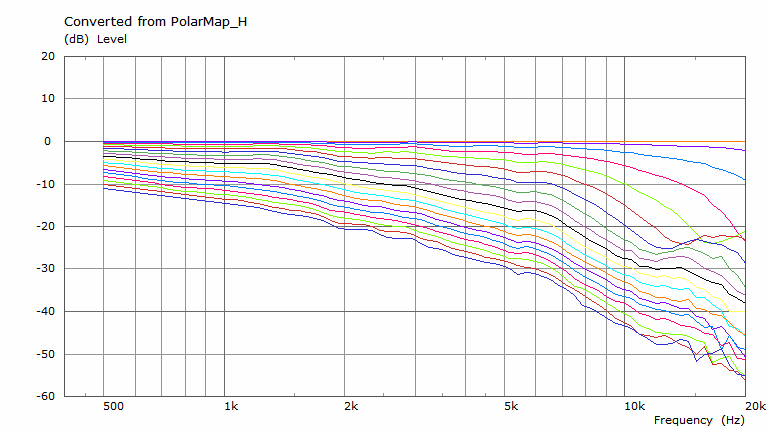

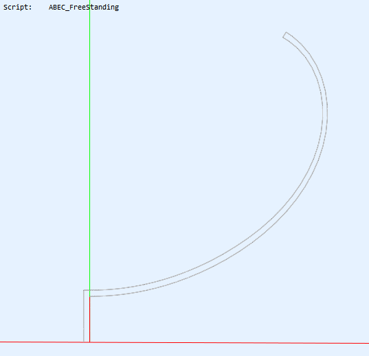

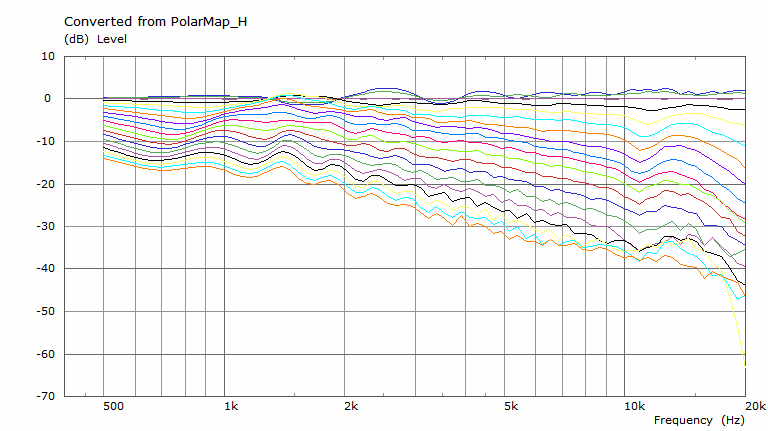

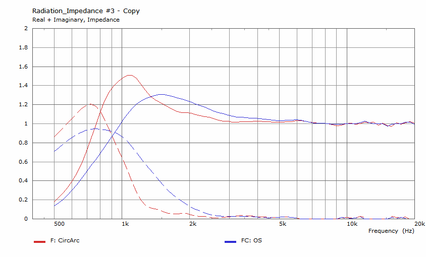

I tried a similar overall shape but with an OS throat - it's basically the same, if not even slightly better. The beam simply "breaks up" at some point if set too wide for what the throat size and the source wavefront allows.
Circular arc:
OS throat:
Circular arc:
OS throat:
That bump at 5.5k is 'problematic'.
OS vs flat wavefront interference?
An 1" throat maybe better.
I should have probably shown the raw curves instead (not implemented for the CircSym yet), as these data are converted from normalized polar maps - by nature it will be more likely an axial hole than a bump off-axis. Don't forget this was for a 75 mm (3") throat to exaggerate it a bit.
