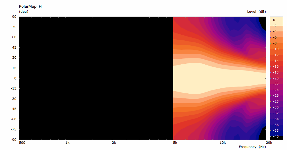

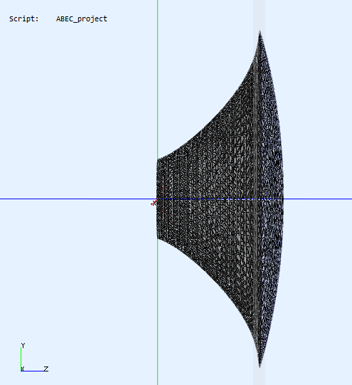

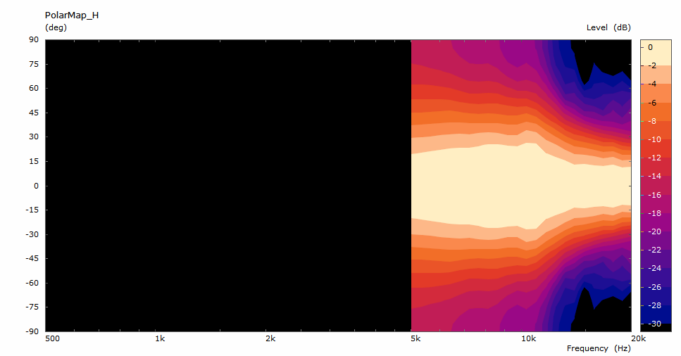

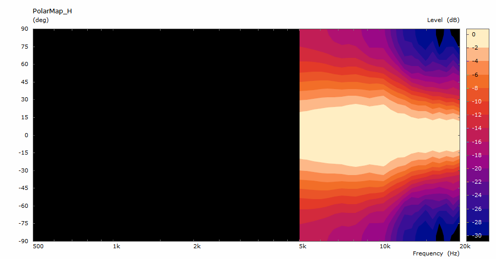

Another comparison:
1" OS throat driven by a plane wave (still the same as the original one, throat angle = 0)
vs
1,4" OS throat driven by a conical section 1" deep, 24° included angle
vs

The maximum reliable frequency that can be measured in a PWT is a function of its diameter. 1,22c/d, meaning a 2 inch exit driver measured in PWT will only provide us with a reliable result below 8,4kHz. However, as you can see, the length of the PWT is not a parameter in this function, so it will play a role in the drivers exit as well. This is not surprising as we commonly see 2 inch drivers are not capable of exceeding useful output past 14kHz.

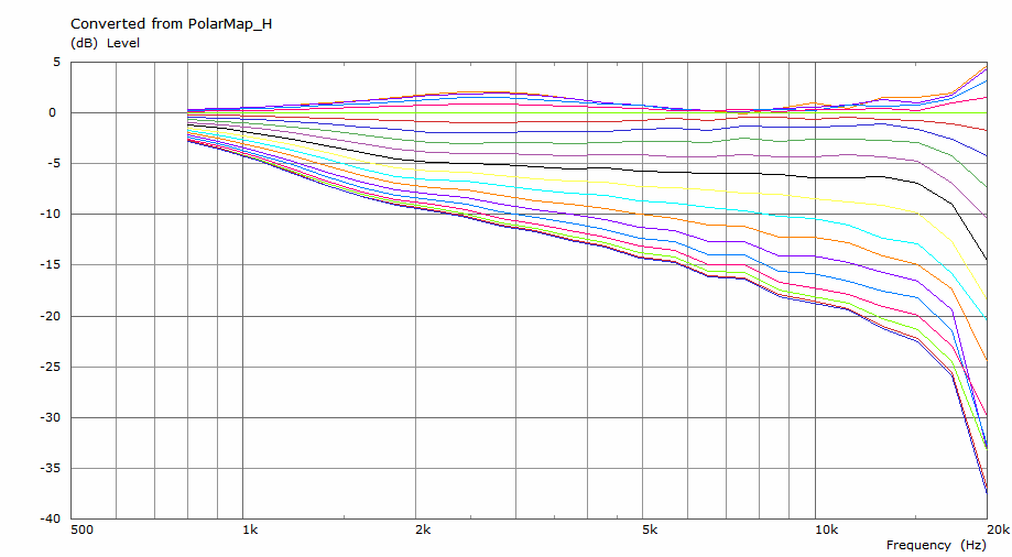

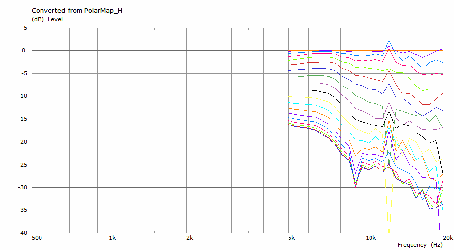

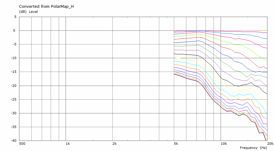

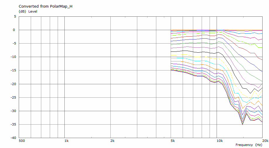

To me, this is useful enough:
Three different throats, each driven by a matching spherical wave:
a) 1,4" @ 9°
b) 1,4" @ 27°
c) 2" @ 36°
a) 1,4" @ 9°
b) 1,4" @ 27°
c) 2" @ 36°

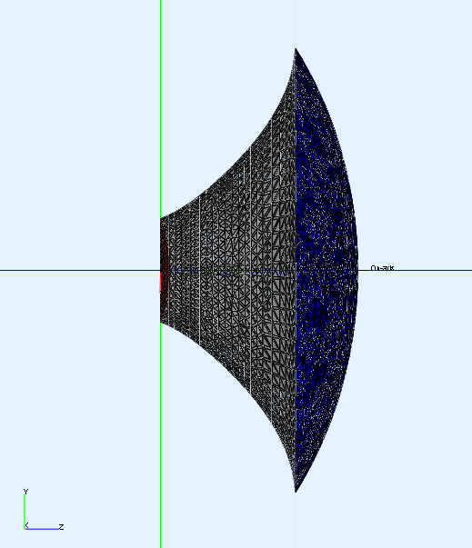

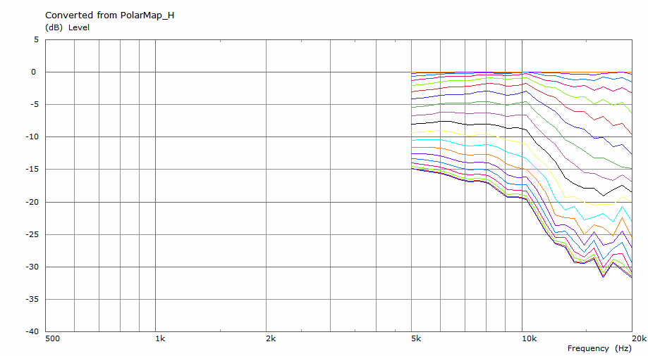

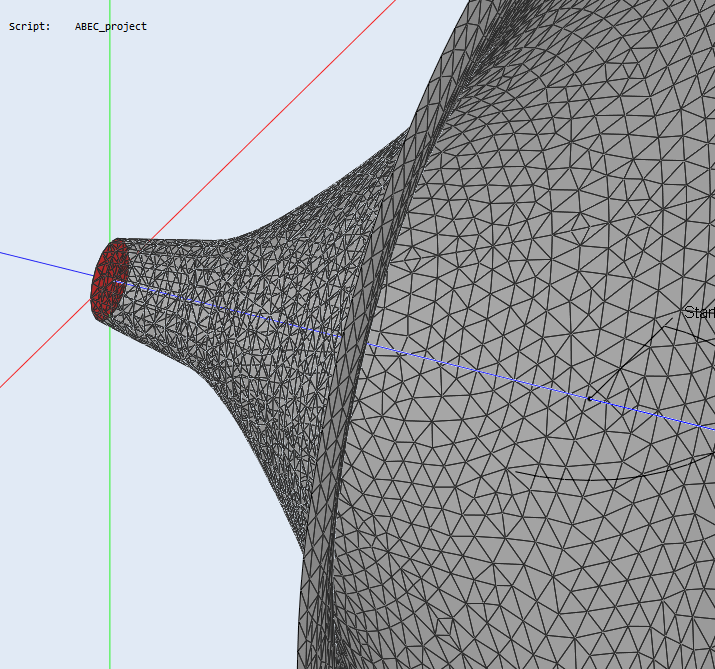

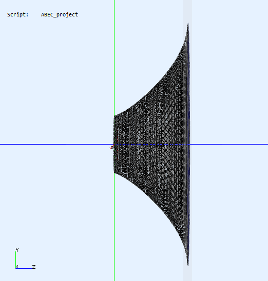

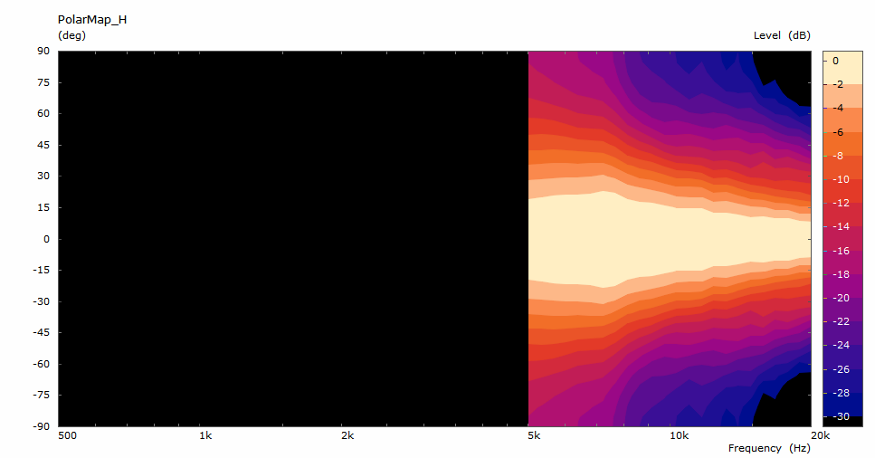

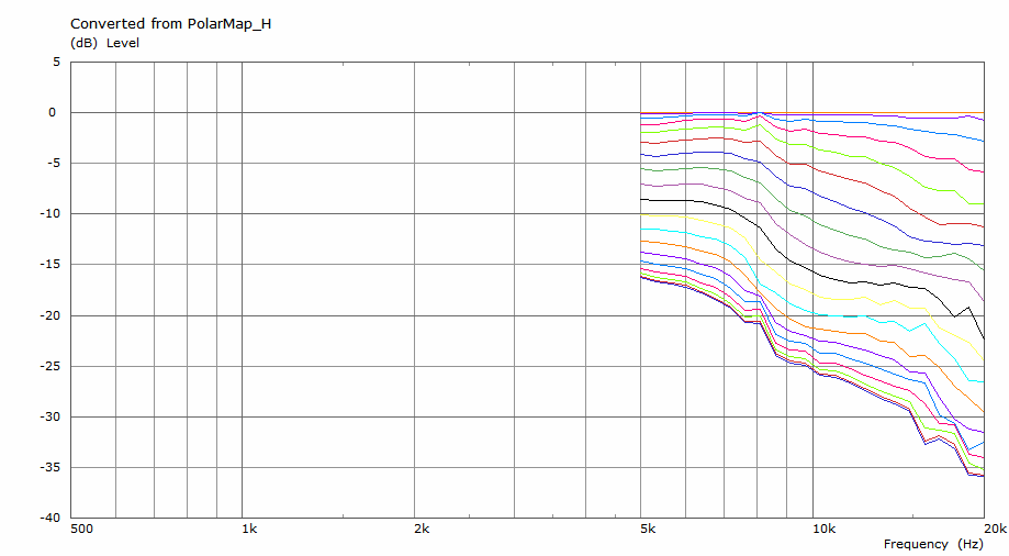

Now something for BEM/ABEC alone. There is always a boundary interfacing the interior and the exterior of the horn. This is a good opportunity to show a possible effect a particular shape of this surface has. What follows are three different shapes for the 2" throat from the above example:
Flat surface:
15 mm spherical draw:
30 mm spherical draw:
- I think I will leave there an option of setting the draw manually. It can help in case of a numeric trouble - it happens from time to time.
Flat surface:

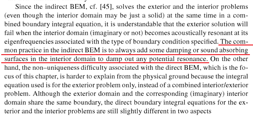

I suppose, that it is common non-uniqueness problem. You can also try to add a some small amount of damping to the wall of the internal interface
source (p. 412)
source (p. 412)
Yeah, this does something. But is it really what we want?

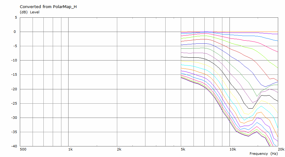

- you mean like this:
WallImpedance "I1"
ImpType=Damping
RefElements="Horn"
Value=0.1
Value = 0.1:
Value = 0.5:
https://www.diyaudio.com/forums/attachment.php?attachmentid=857053&stc=1&d=1593601625
WallImpedance "I1"
ImpType=Damping
RefElements="Horn"
Value=0.1
Value = 0.1:
Value = 0.5:
Ah, did you mean the "interface" (as in ABEC terminology)?...You can also try to add a some small amount of damping to the wall of the internal interface
In the above the damping was added to the walls of the waveguide.
