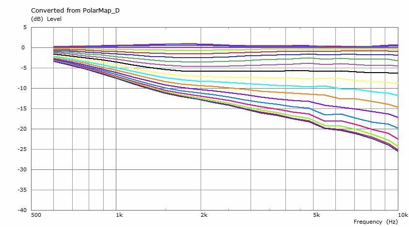

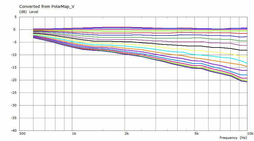

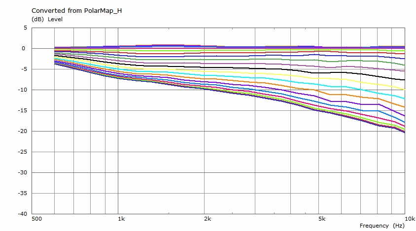

Right now there is this waveguide being made (422 x 364 mm; 1,4" throat for 18Sound ND3T) -
I'm really eager to see how it turns out, it's probably my best so far. Two different loudspeakers will be made with it, the second one with BMS 4554. Hopefully, we'll see the measured data soon.
