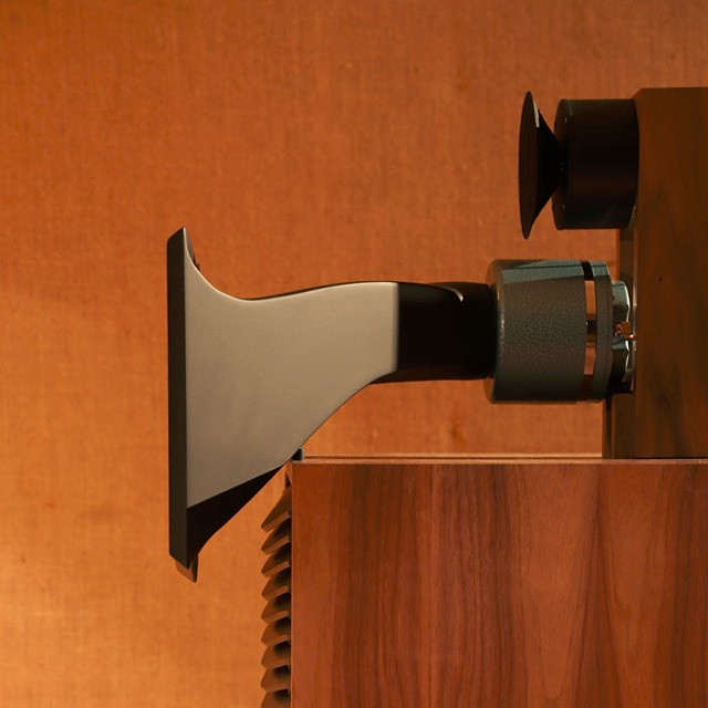

It's funny that you referred to the Vox Olympian, because that trumpet also occurred to me while composing the profile.
However, it is different, actually a straight-walled (conical) pipe, with hardly any mouth termination. At least, that's how it looks from the outside.
The cast bronze LV trumpet (+ TAD 2002) is supposed to provide a kind of diffusion-layer between the Vitavox S2 + R300W and the TAD ET 703 supertweeter.

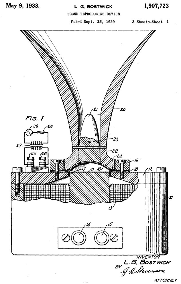

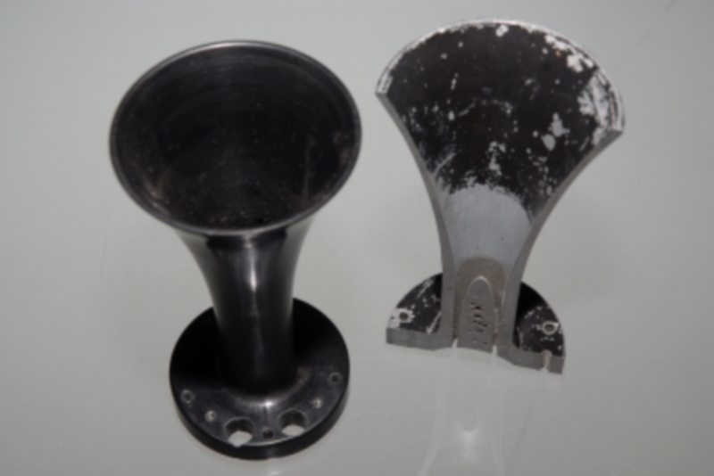

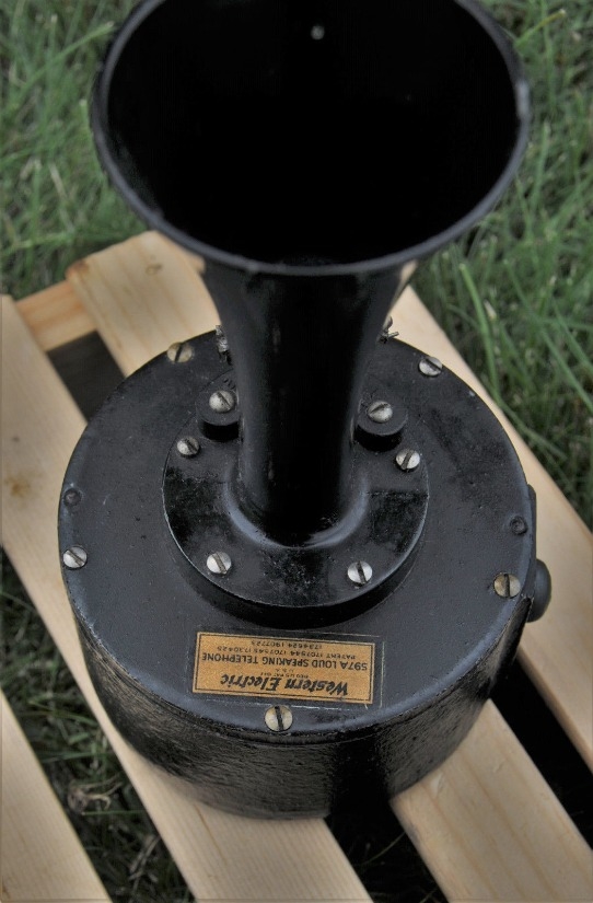

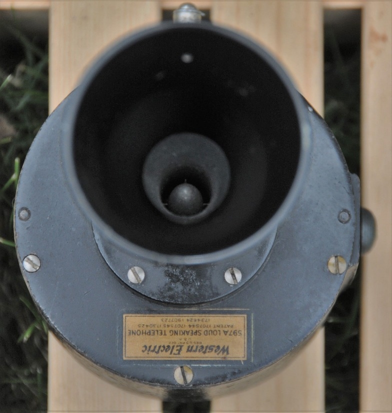

'My trumpet' is somewhat similar to the WE 597A Bostwick tweeter, although the latter features a forward-radiating diaphragm and a bullet-shaped phase plug.
Btw, the asking price for the single 597A in the last 2 photos was $ 32,000.00.

BTW, the bronze cannon in the design above covers the range 5 - 18 kHz, according to specs. The game is called catch your high frequencies.

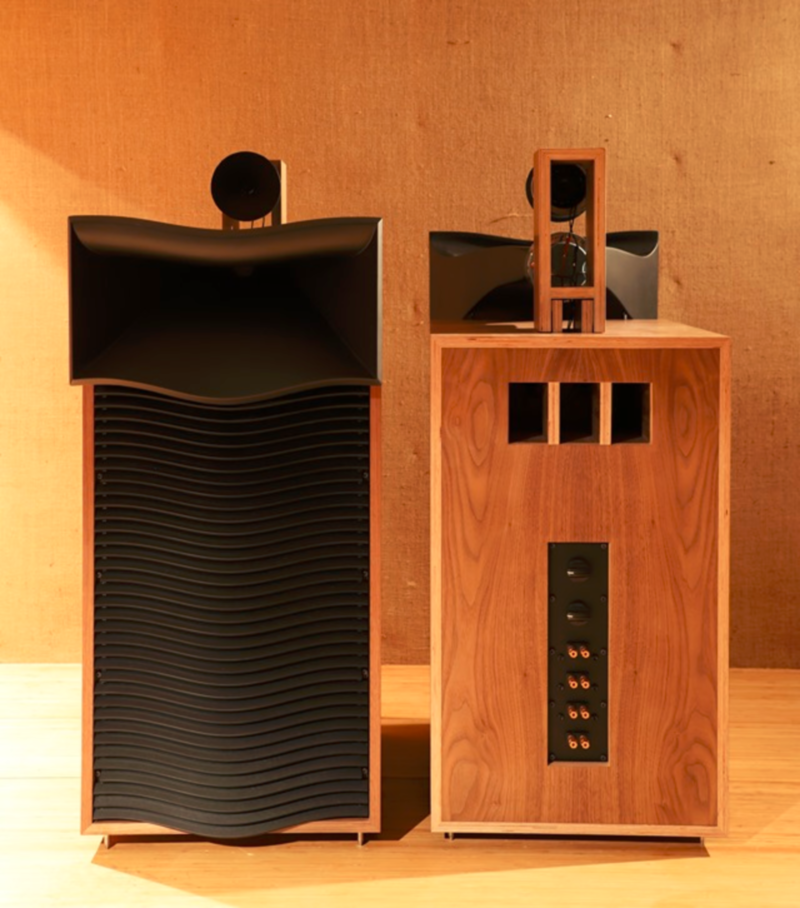

For 1/5 of the price of the Vox Olympian, this seems a more sensible approach. The same Vitavox S2 is used for the mid-range, but with a much more advanced LF section.
It's a simpler design, actually not that different from a JBL 4365/67, except that the LF-section is horn-loaded.
With the Vox Olympian you'll need to buy the gigantic $180,000 Elysian subs (which are lab horns in disguise) in order to have decent bass.
Besides, I think that double tweeter solution is expensive overkill.
