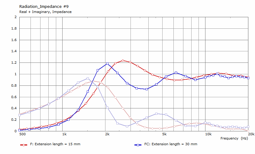

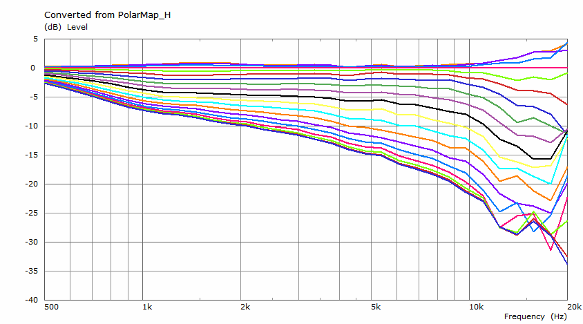

The throat extension again - I tried one half long as the previous one:
attachment.php
Hmm, I would not expect such rise from the polars, but looking again, I suppose it could be correct. But is it really? As the power response corresponds to a polar at about 45 deg off-axis, could be.
45 off axis at 5K is about -9dB in ABEC and the power curve is -9.4dB in Vituix so I would say it is right and follows the rule of thumb closely enough.
I was aiming for a smooth but rising DI in that one, perhaps steeper than intended.

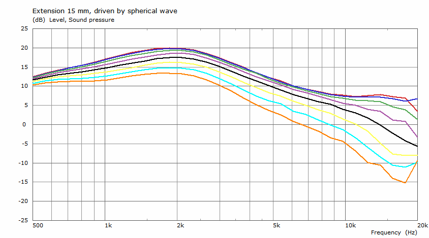

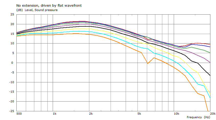

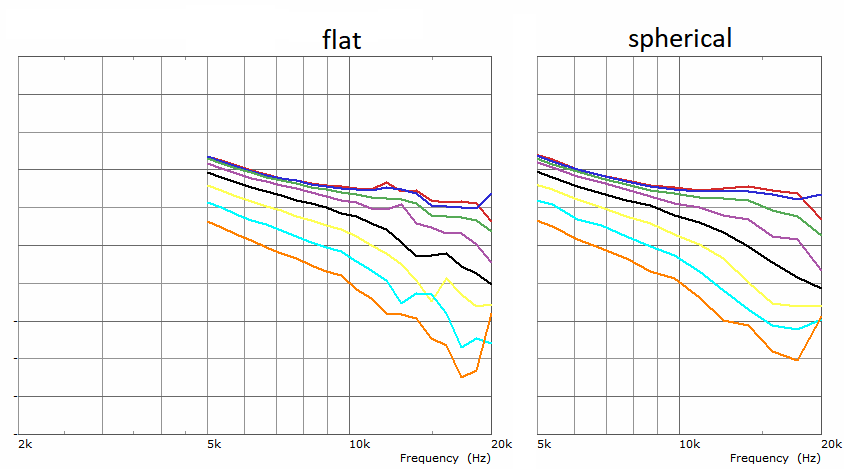

Interesting is a comparison of radiation patterns above ~8 kHz. Conical extension could have a slight advantage in the highest octave, if driven by a proper wavefront, it seems (which is easier to do with a smaller driving diameter I suppose).
a) 36 mm OS throat driven by flat wavefront, zero throat angle, no throat extension:
attachment.php
b) 36 mm throat extended by a conical segment 15 mm long, 27° throat angle, driven by a matched spherical wavefront:
attachment.php

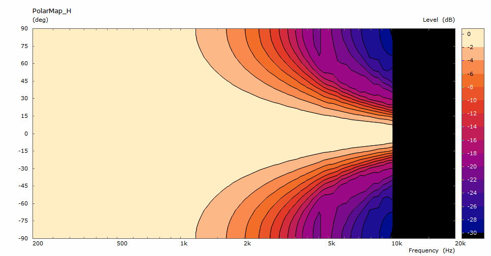

mabat, 'request' profile attached.
