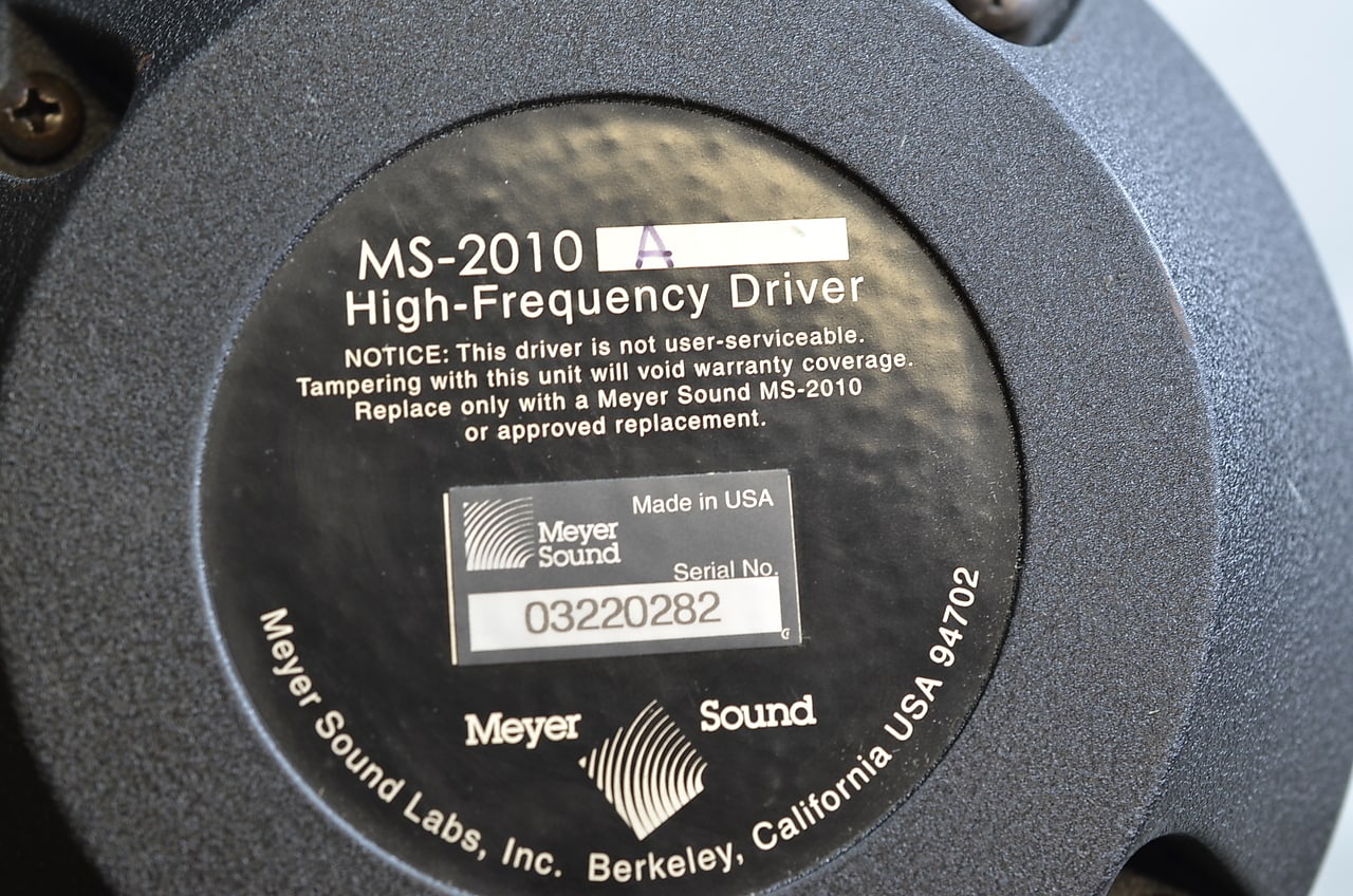

Actually, I was too impressed with MS-2010, so I don’t remember how good it was. It may seem unexpected, but I was also impressed by Beyma's 755 driver (bearing in mind its price) .
It's not unexpected at all, because both the Beyma and 18Sound are on top of my list.
No doubt about the quality of the MS-2010, which is manufactured by Radian.

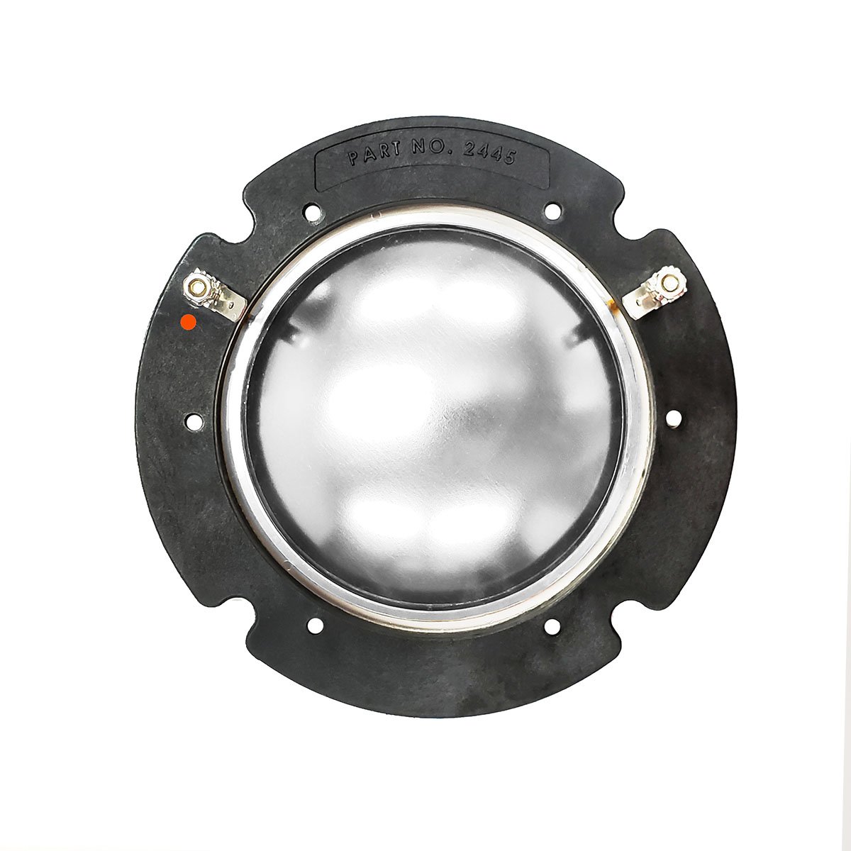

The Aluminium replacement diaphragm will set you back > $500.
I read on some forums that the earlier driver models were actually produced by the radian, but the ms-2010, as far as I know, is produced by Meyer Sound.
Perhaps MS assembles the parts inhouse, which are obviously different from the regular Radian drivers.
The diaphragms however, are definitely made by Radian.
One of the reasons why you liked both the Meyer and the Beyma may - at least partly - be related to the Mylar suspension of the diaphragms.

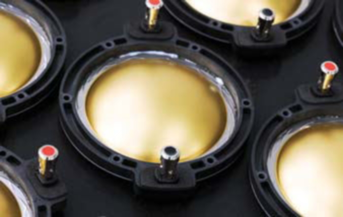

This is also my concern regarding the NSD 1480N, which is the driver I referred to in post #2330.
Despite the Tin coating, the diaphragm is still all-Titanium instead of an assembly composed of a (Nitride coated) Titanium dome sandwiched to a polyester suspension unit.

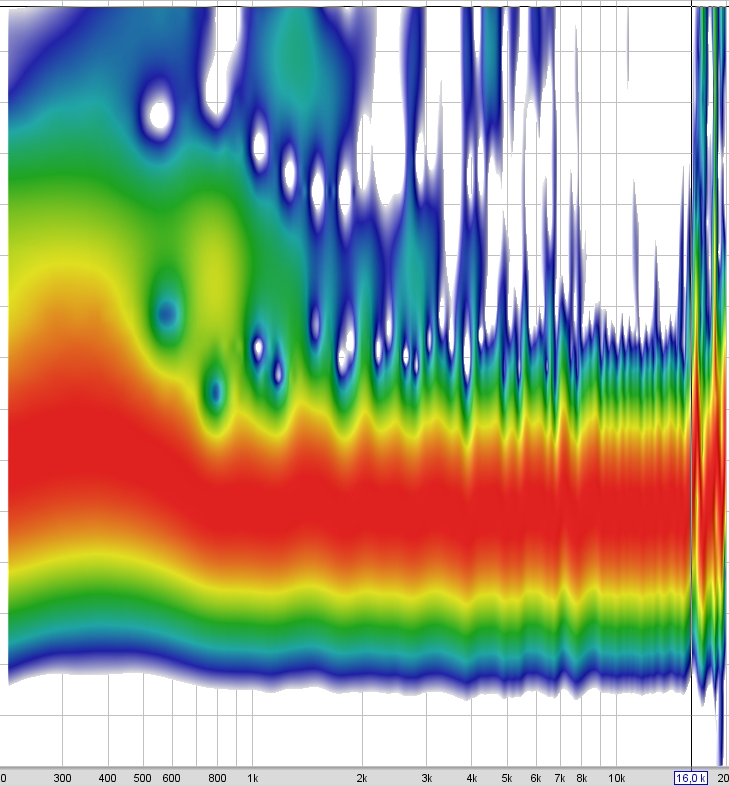

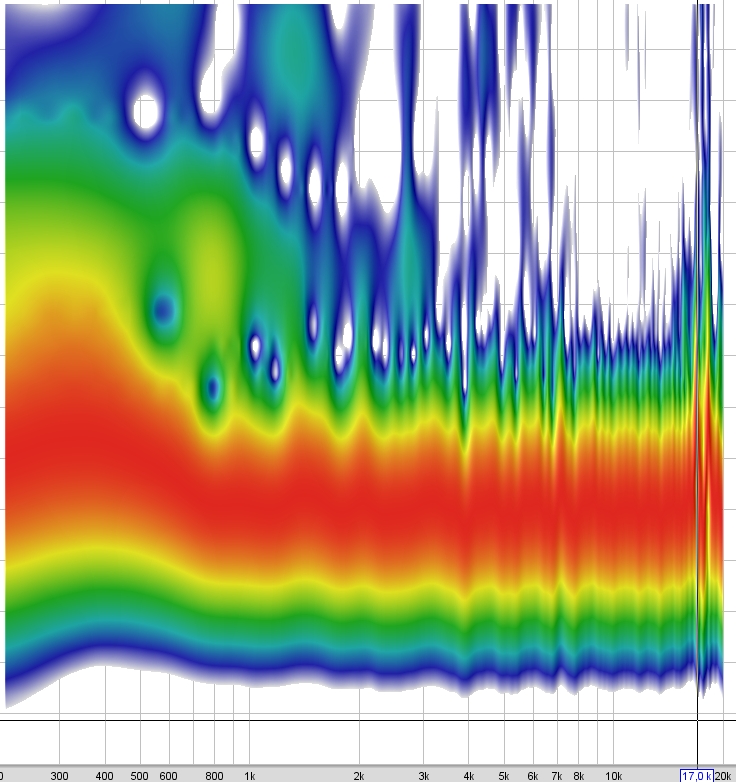

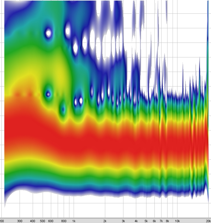

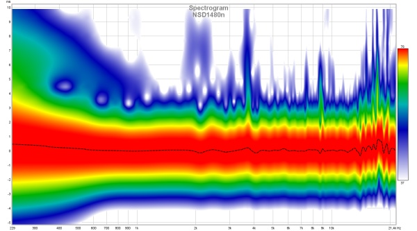

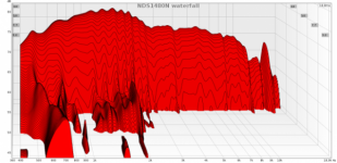

Some (badly scaled) spectrograms, from left to right: 18Sound ND2080, ND2080 A(luminium), ND2080 N(itride).

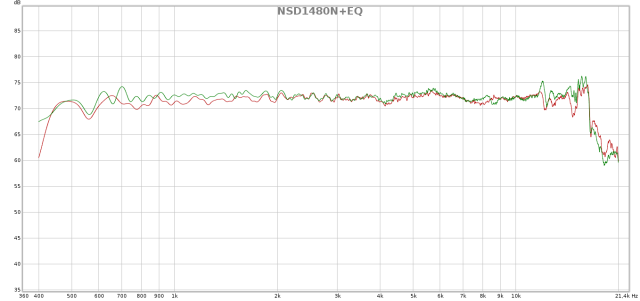

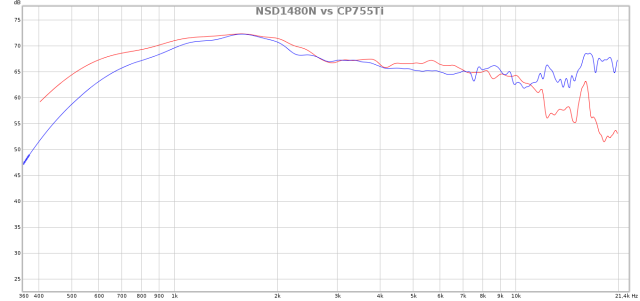

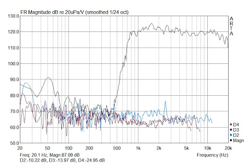

A comparison between the Beyma CP755Ti (blue) and the NSD1480N with the XT1464.
The CP755Ti is the ferro magnet version of the 755 and half the price of the NSD1480N.
Which one is which?

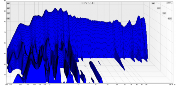

Wow, those distortion levels are pretty unbelievable. What's the reference level?And something ridiculous: the Beyma CP380M with the tiny RCF H100, high-passed at 600Hz.
Famous from 30 years this Beyma , remove the 2.5 to 4k nasty (flat it) and that's a musical cd according many... halas needs a 3 way system.
