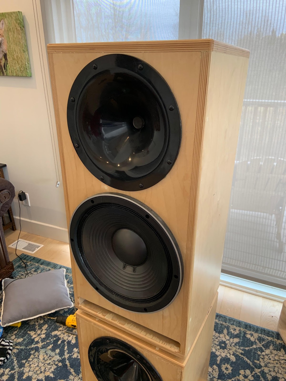

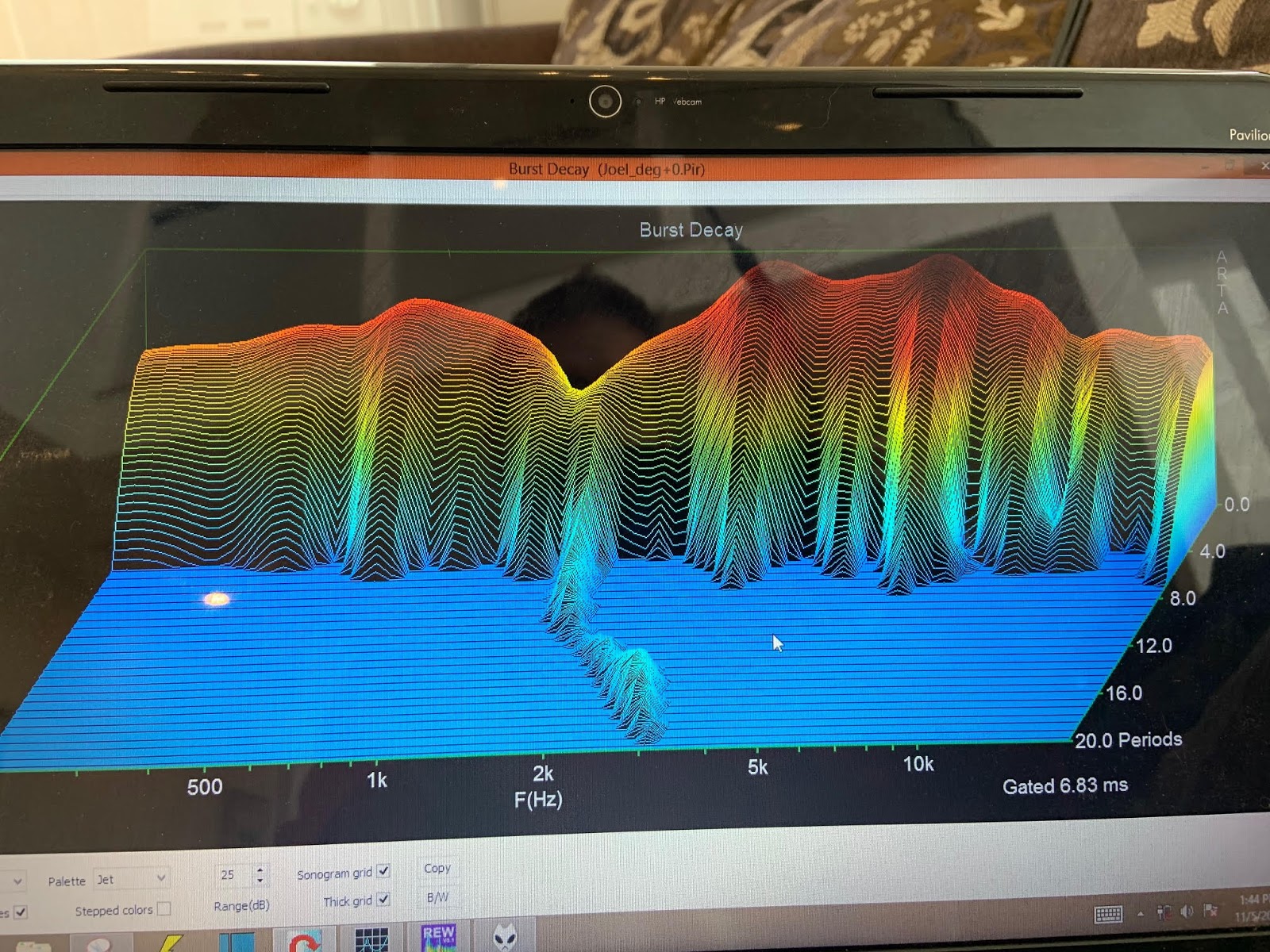

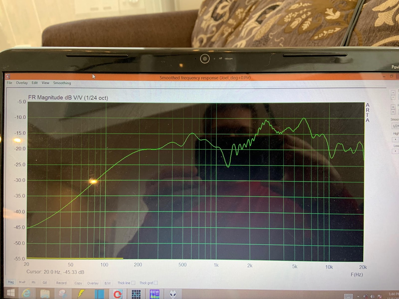

These 2 ways with a OS waveguide (DDS, I believe) and TAD TD-2001 were brought and measured by Joseph Crowe.
