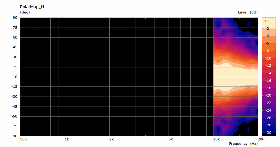

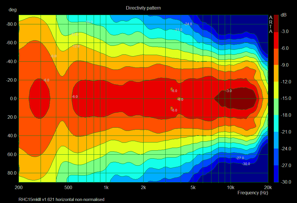

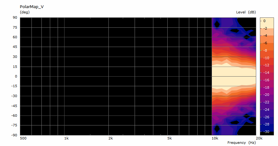

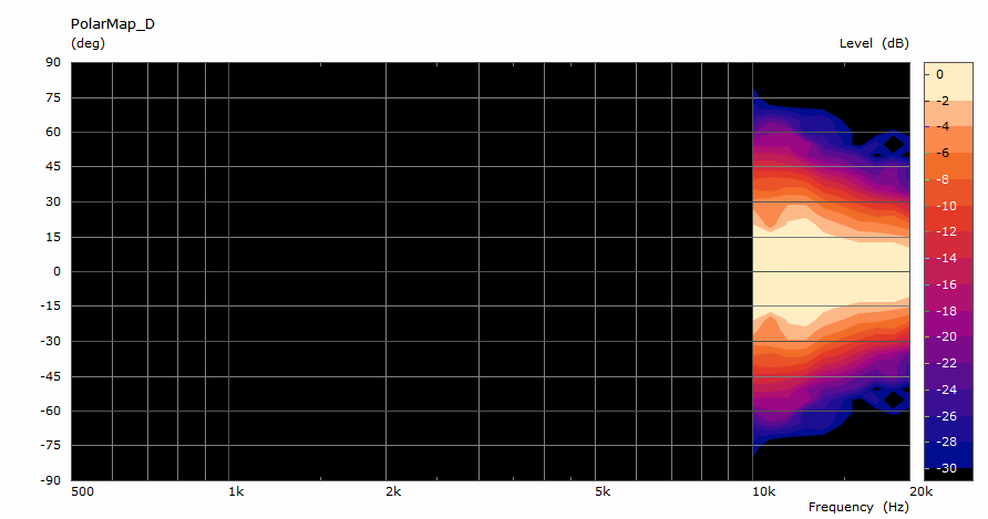

10k - 20k with the same mesh, for the previous horn, already quite a lot of noise off-axis. It is a 1.4" throat and starts to beam noticeably at about 12.5 kHz... (at least according to the simulation).

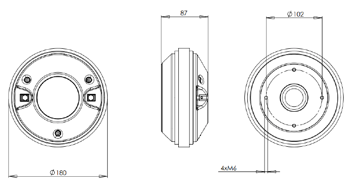

Contrary to expectations, some 2" drivers aren't particularly beamy, as Jef111 has shown with the B&C DE75 + (modified) Megaton C8045.
The exit angle of the DE75 is 34.6°, which helps.

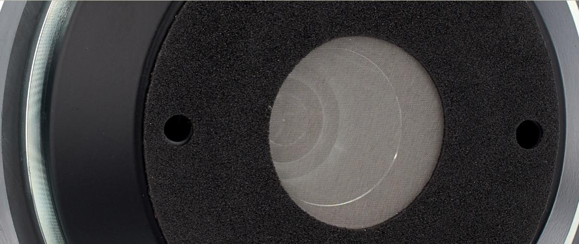

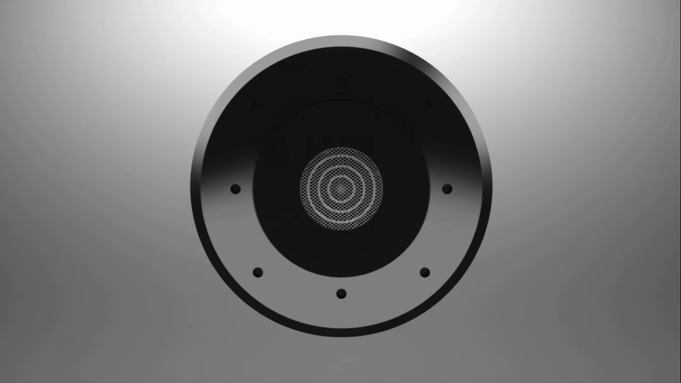

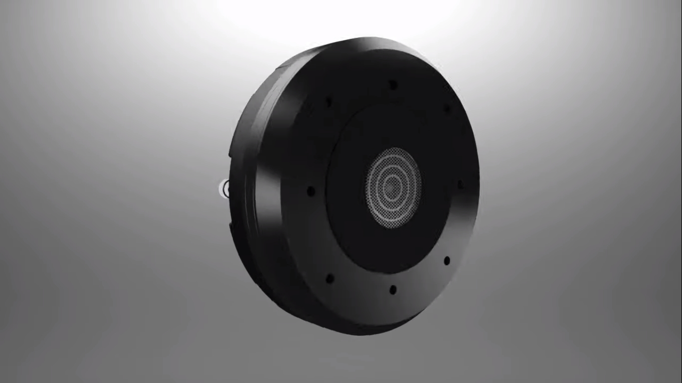

That's an interesting observation. How much different is it from DE750? Shouldn't it be considered more like 1.4" with a conical extension? I wonder how OS starting right at the phase plug exit would perform in comparison.
The DE750 isn't just a 75(P) with conical exit, its motor structure is slightly different as well.
The 85, 82, 700 are similar to the 75, in that these are all pancake drivers.
The original DE75 doesn't have a shorting ring, but this apparently doesn't affect performance.

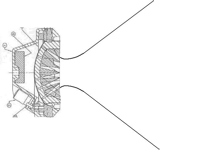

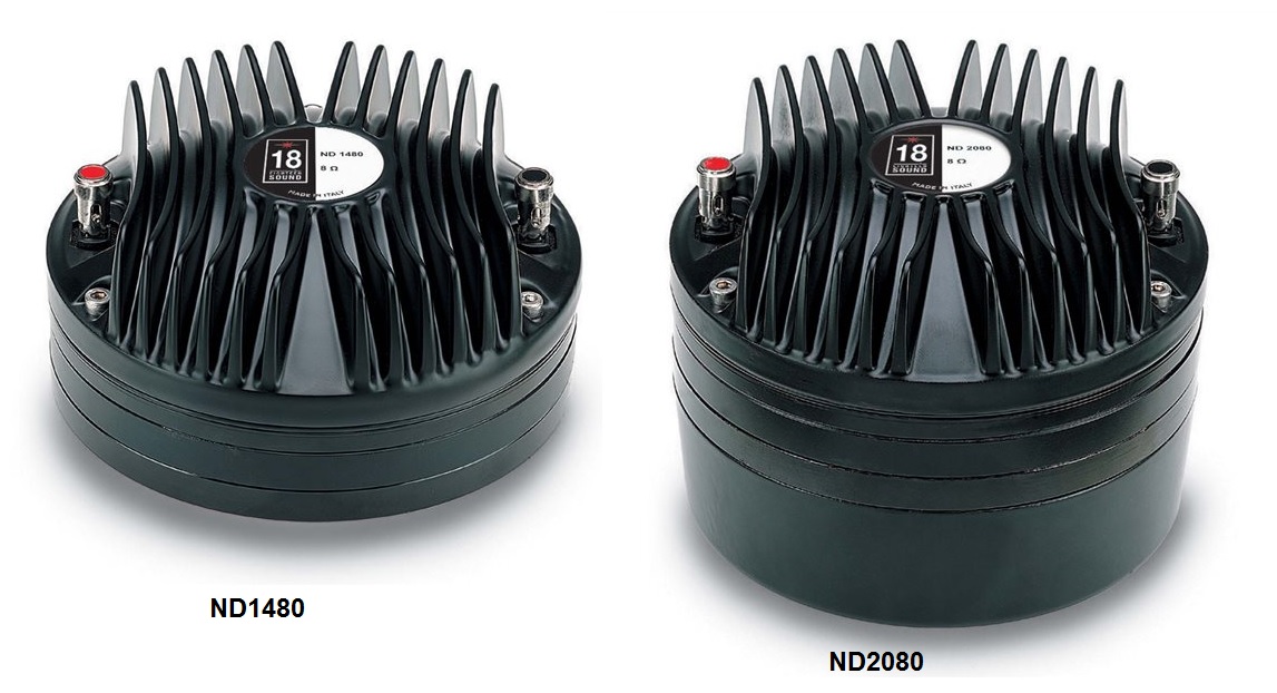

That's not what I meant. Looking at the exit of the DE750, there's a substantial conical portion whereas the exit of the phase plug structure itself terminates on a smaller diameter inside. But I guess this would be the case for a lot of drivers. For example 18sound ND4015* I would regard as a true 1.5" driver.The DE750 isn't just a 75(P) with conical exit,...

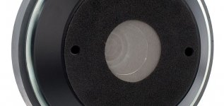

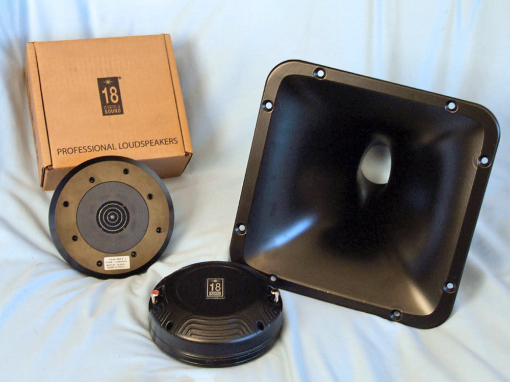

There's an additional 'step' in the exit of the DE750, yes.

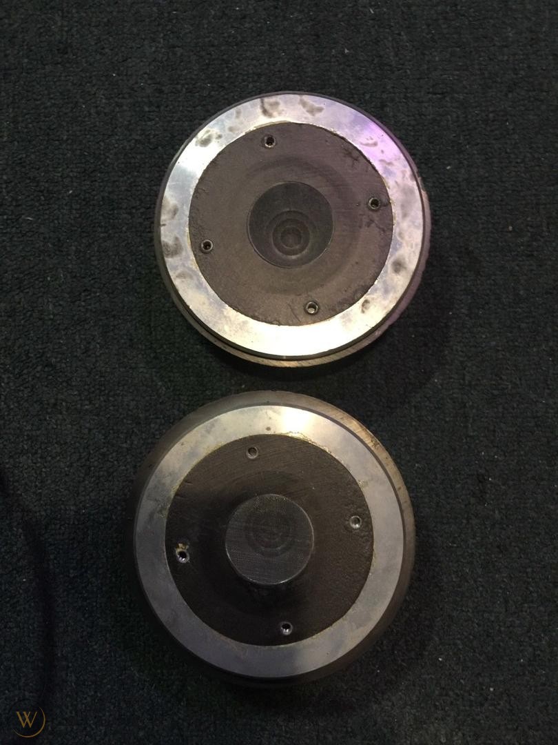

The conical exit of the other drivers (64mm height) is shorter and the angle is quite wide, as visible in the pictures.

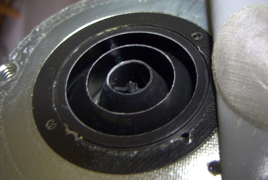

Evidently, a phase plug that ends at the exit isn't a guarantee for excellent power response or directivity in the top octave.
The design of the phase plug as well as the interaction with (an eventual exit section and) the attached horn are decisive.

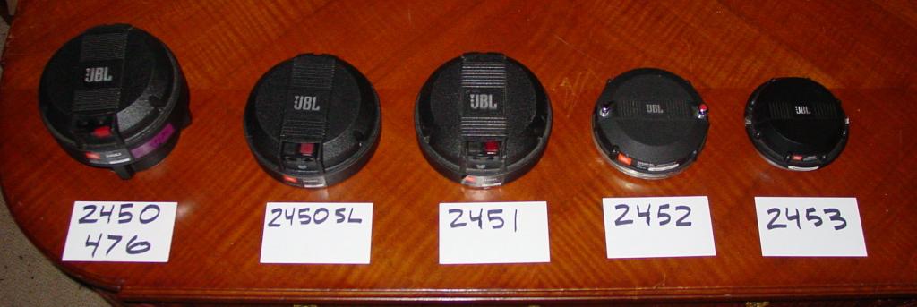

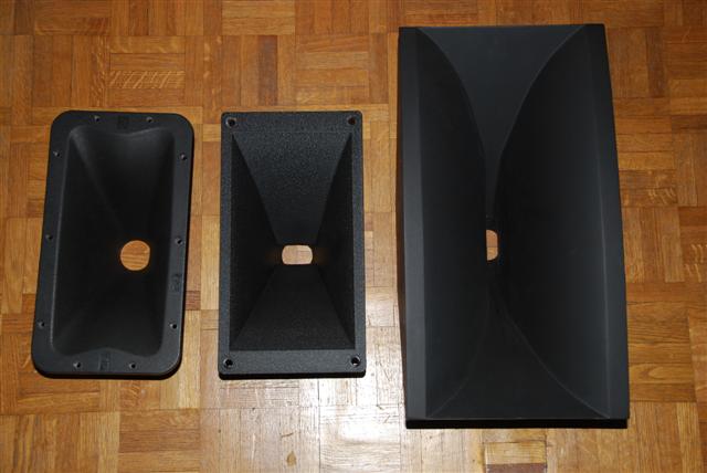

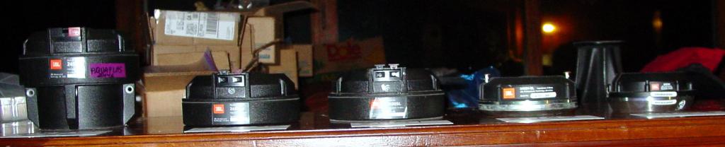

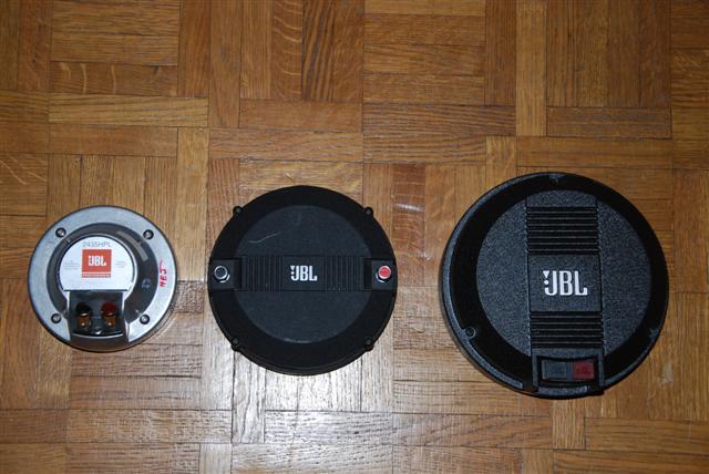

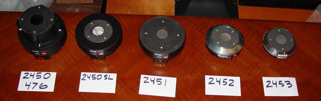

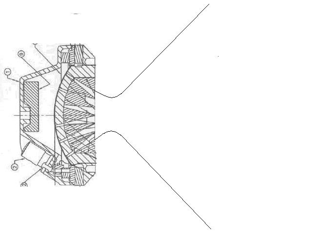

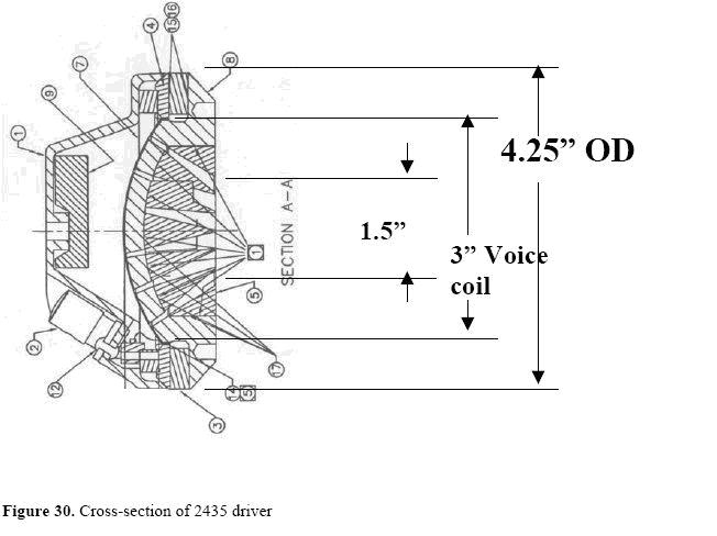

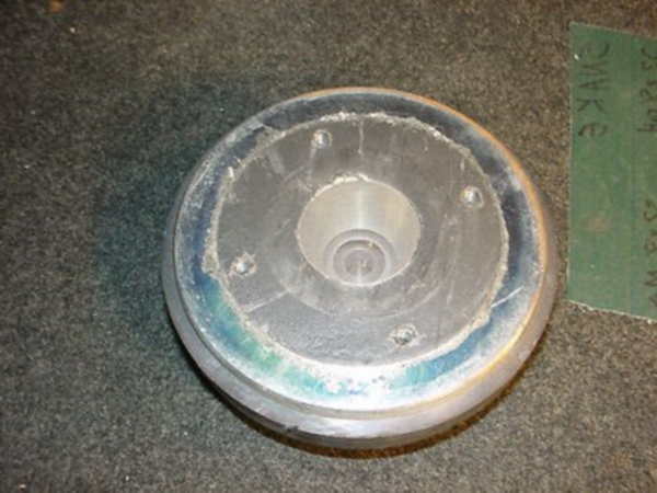

JBL has made a large variety of 1.5" exit drivers, some with conical 2" extension. JBL was also the first manufacturer to explicitly refer to differences between classic (WE 594A based) and modern pancake style drivers in their technical literature.
JBL adept 'pos' (also developer of rePhase) has measured many JBL drivers and published his findings primarily on audioheritage. This is an interesting remark:
"It is well known that the 2435 short phasing plug has a "problem" with the PT-F95HF that results in a dip at ~13khz (as well as very poor off axis behavior). This problem does not exists (or to a much lesser extend) on the H9800 and some other horns (the off axis behavior remains bad in the UHF tho, because of the 3 slits phase plug)"
